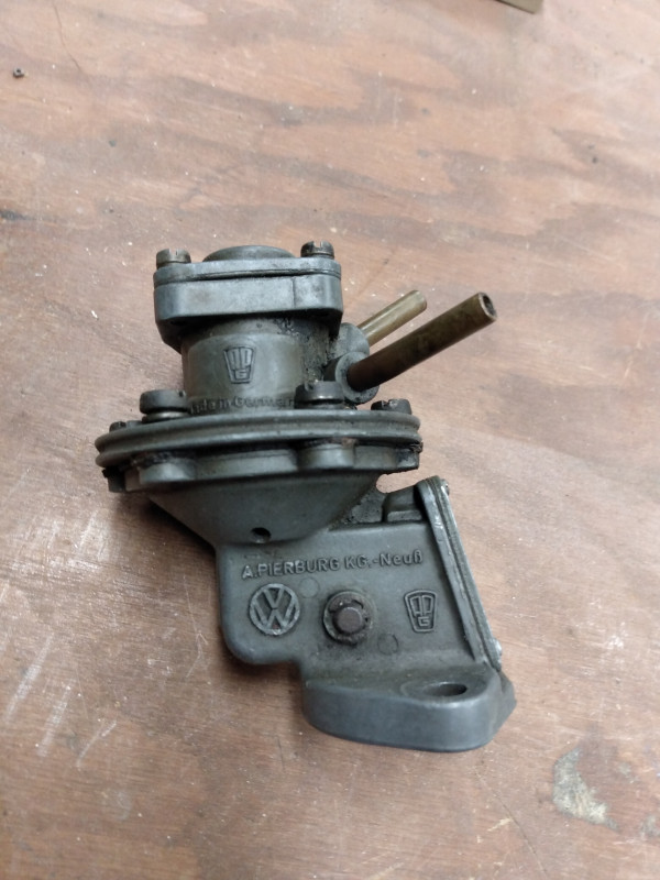

This was a miniature project I could do in the basement. Last Fall, I got a Pierburg fuel pump at a swap meet. Then, about two weeks later when I was cleaning out my garage, I found two more -- probably from about 35 years ago. I decided to buy one of the WW rebuild kits that everyone complains about to see if they really are as crappy as people say. So, a little while ago, I rebuilt one of the pumps in the warmth of my basement -- figuring that the cheap pump I have in the bus will eventually jettison the lever arm shaft.
Pump before disassembly.
