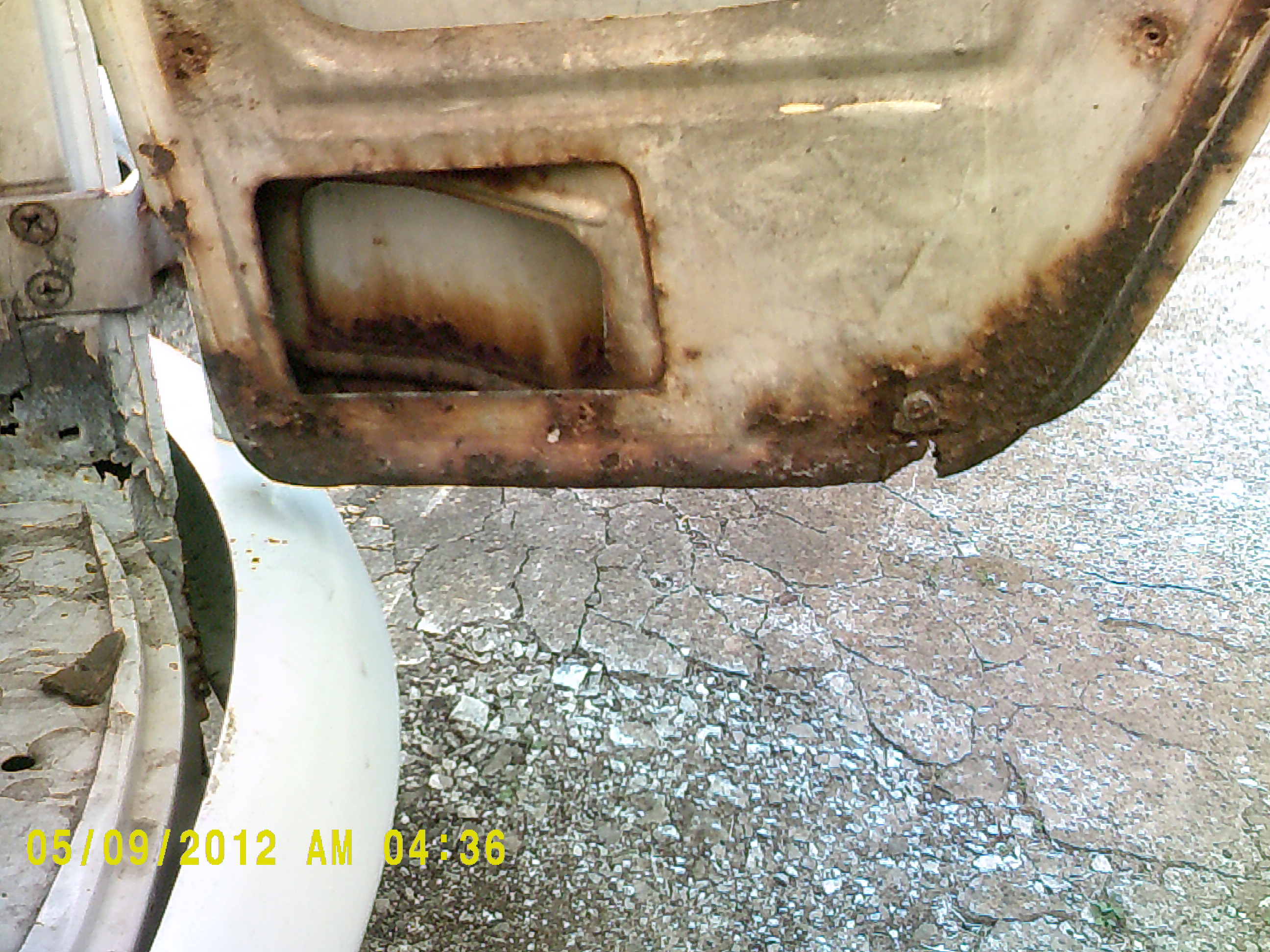

rear cargo door. still need to order this piece
Have this inner piece, B pillar needs some lovin' below the hinge

with the door skins off, you can see that I will need new lower inners and door skins on both doors, as well as A pillars below the hinge
also need to address the front floor, as the previous repair is not so much
