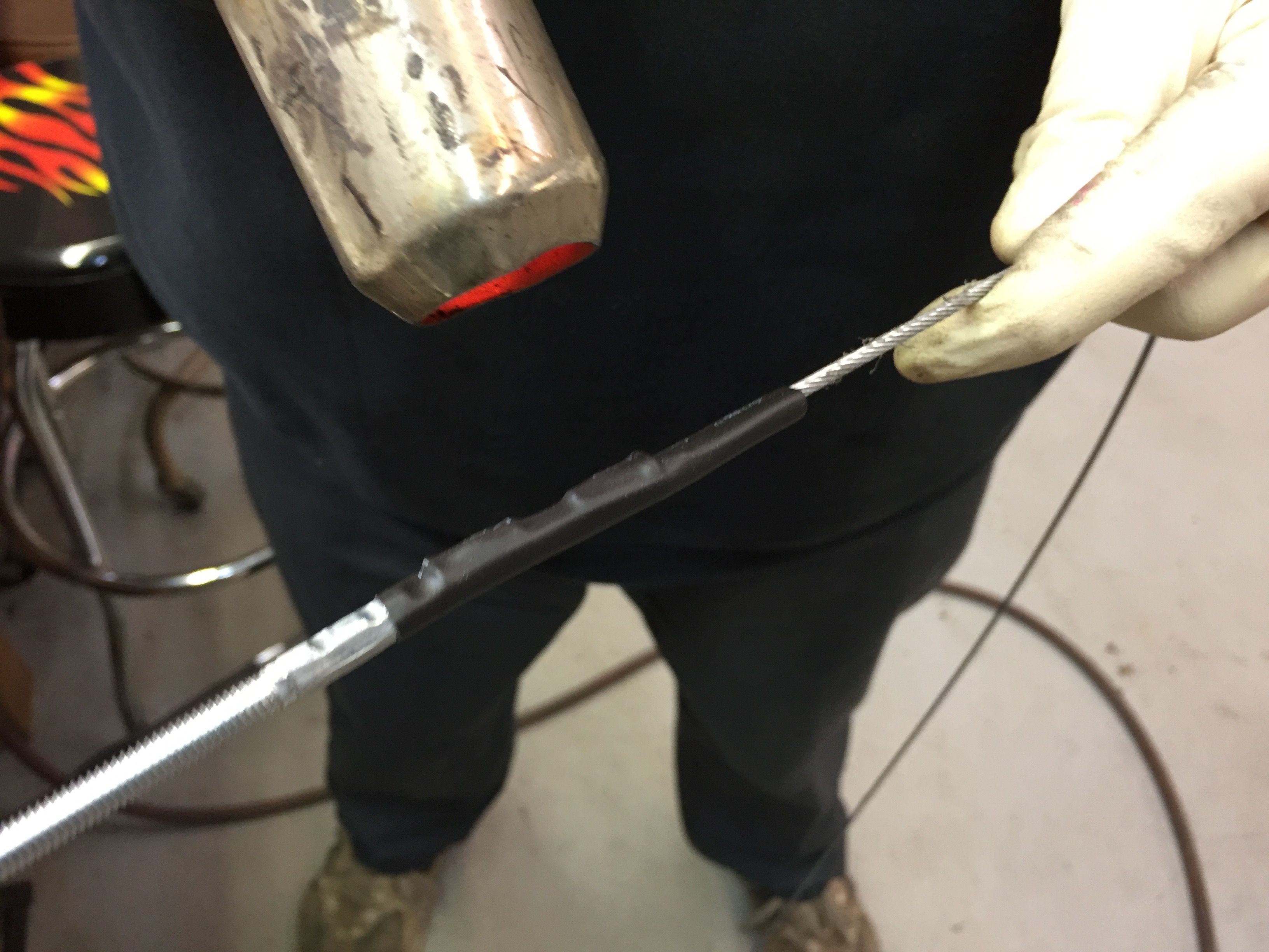

During the course of this upgrade I picked up a "swedge kit" to shorten the cables so they (hopefully) work in an emergency. I got the tip from Aaron (Widefive) and a guy that goes by the name "Glideking" on the samba. He recommended an aircraft supply house who sold a nice little kit with 3/32 swedges that work well with our sized brake cables.
The good news is the kit came with plety of swedges, so if you need to try this in the future I've likely got you covered.
To give you an appreciation of "fit," here's one of Bruce's 185/14 Hankook's next to one of my Thialand 195/15 radials. You wouldn't believe how much bigger these tires are without seeing them next to each other.
The swedge kit is pretty straighforwarded. We doubled it like Glideking did and it fit nicely. Here are a few pics.
