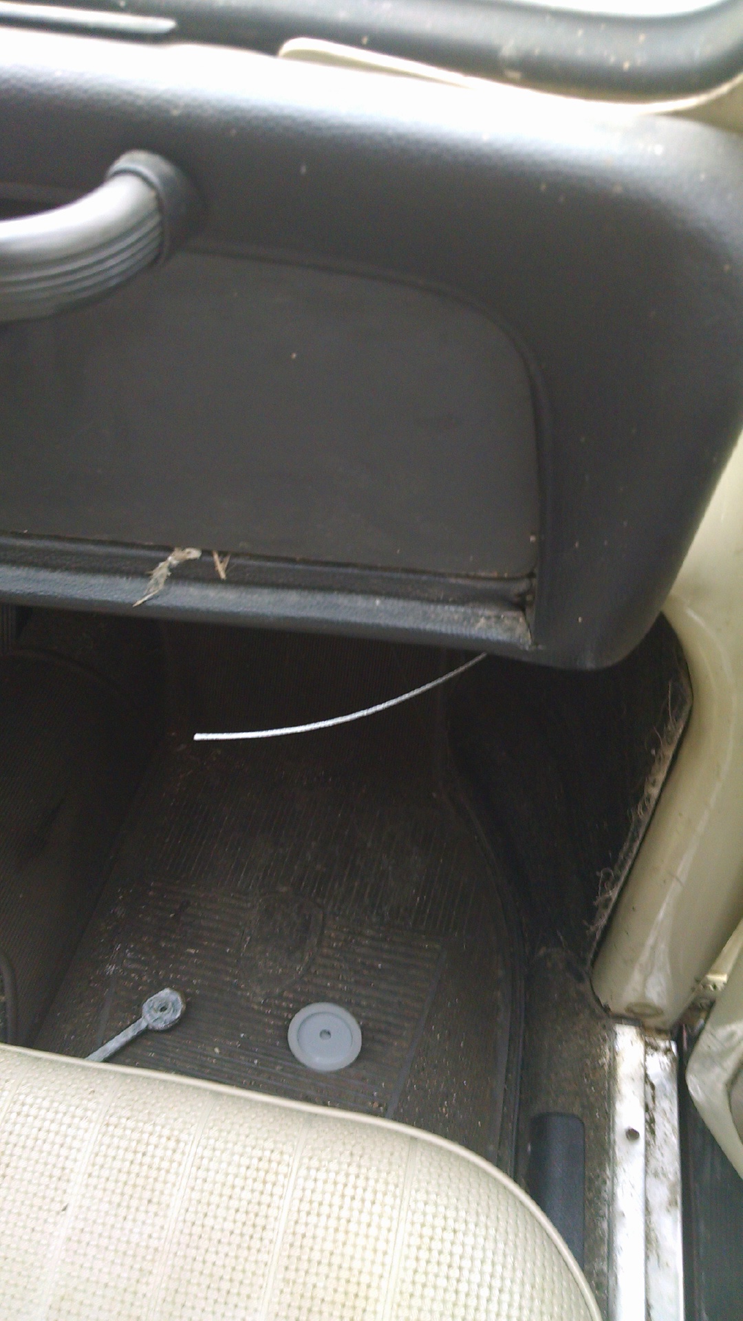

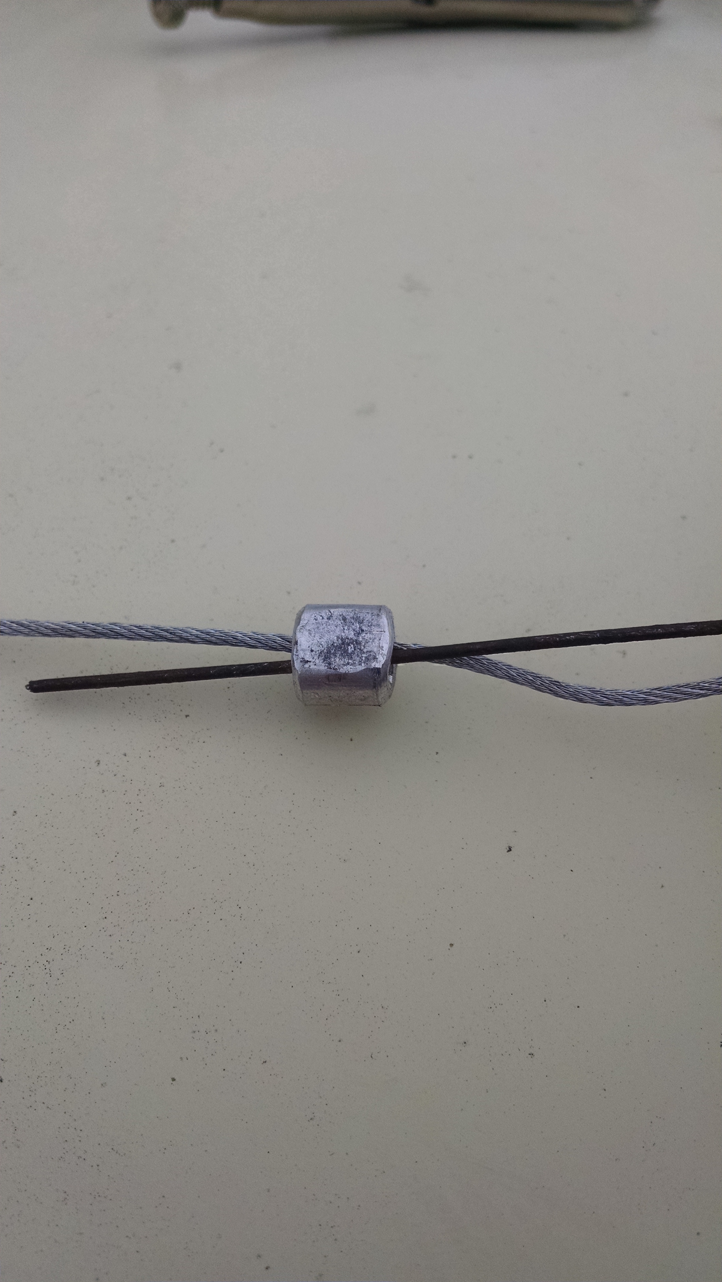

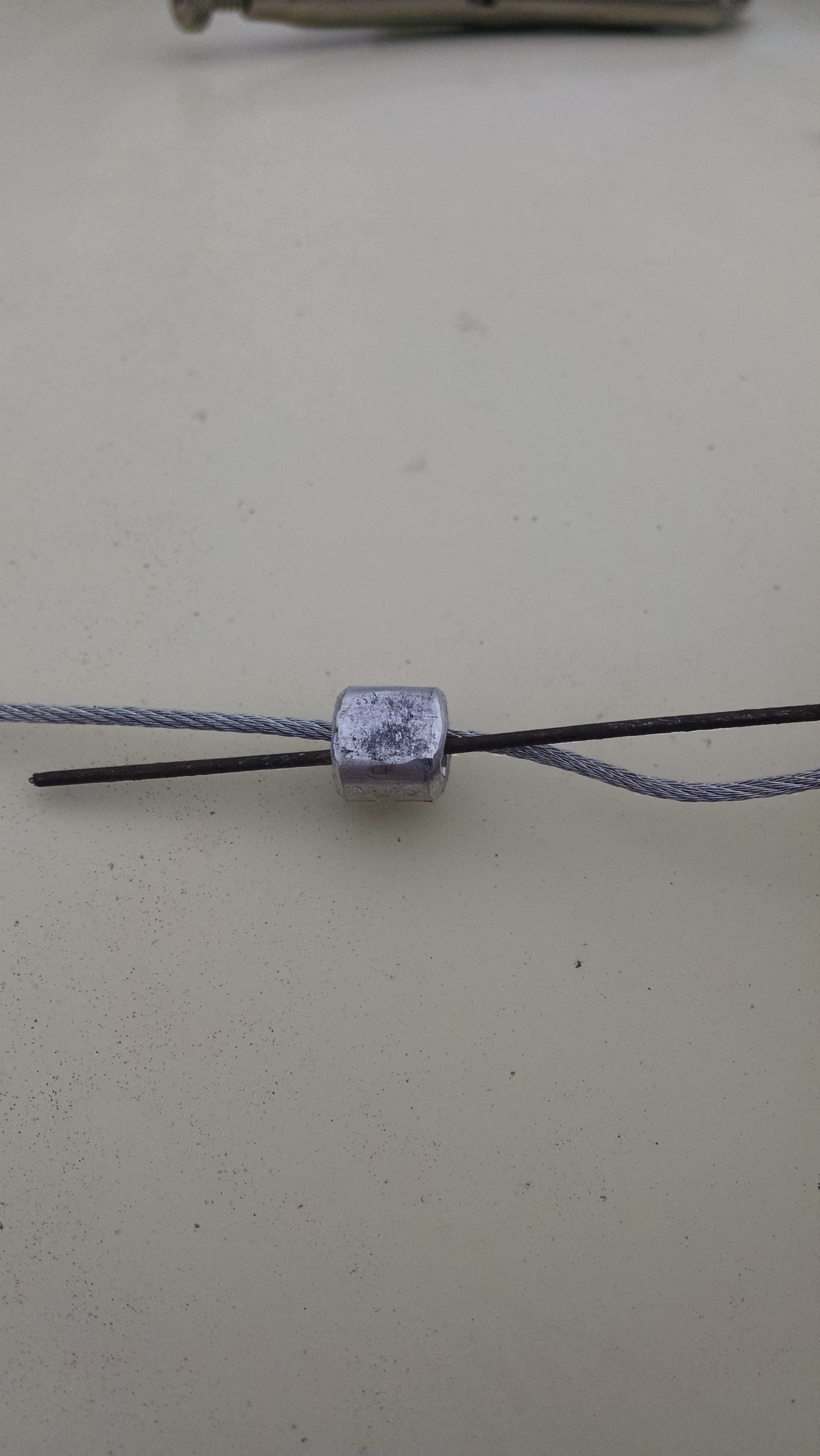

SO the gas door opening cable on the 71 super is broken so it doesn't enter the car (it still can open the door if the trunk is open). After looking around I am NOT spending $90 for a two year only release, nor am I opening the trunk everytime I need to get gas if there is a door present.
https://www2.cip1.com/ProductDetails.as ... 13-809-939
I found a cable stop to use as a crimp and some braided cable to make an extension that goes into the car. A foot was more than enough for my needs, thus I'll need to trim it down.
I just have to figure out how to attach the original handle I found in the trunk to the end of the repaired cable.
Total cost of my jerry rigged engineering fix: under $2
