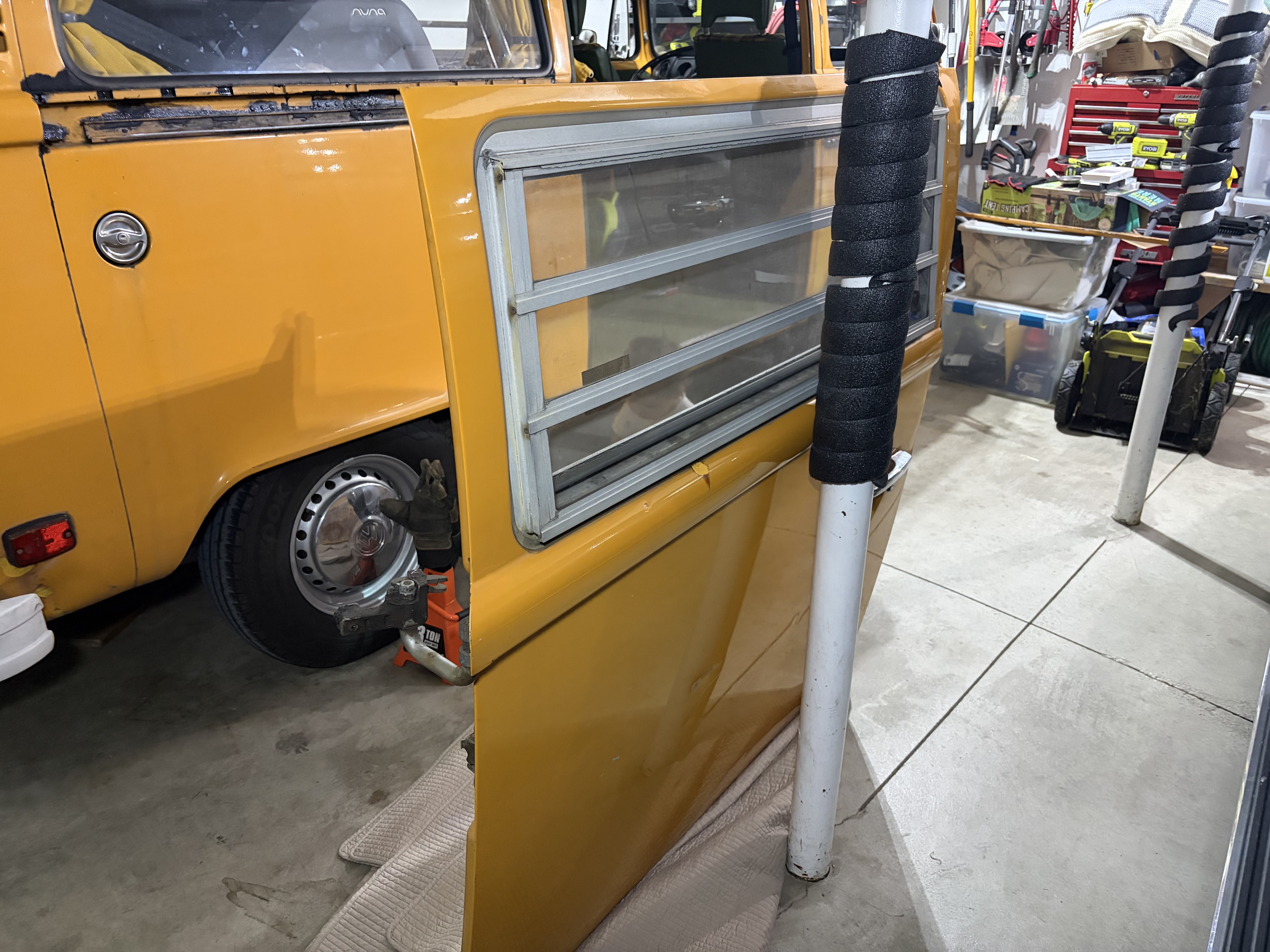

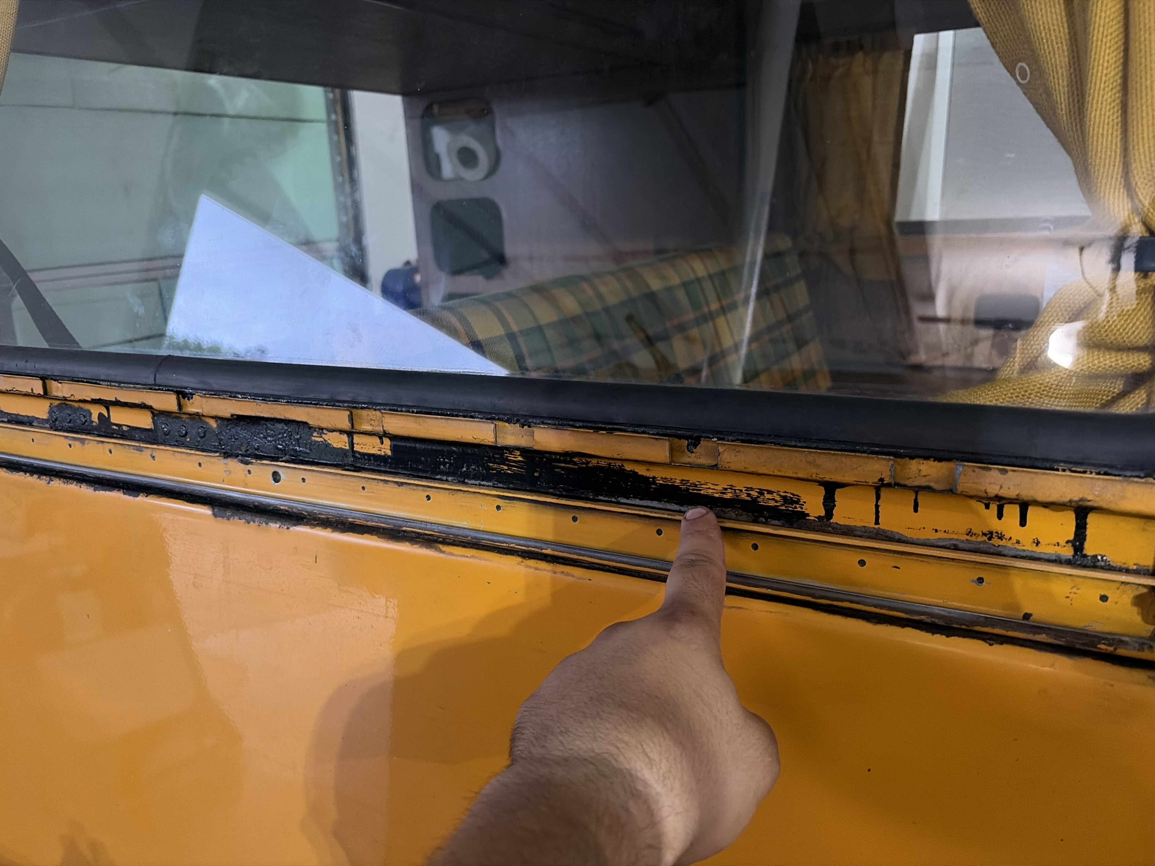

:twisted: Sliding door has needed attention for a while. Pulled the door and inspected everything. It took a few hours to clean up the old icky grease in the track rails. As well as clearing away the old glue from the door seal. There was some surface rust hiding in a few places under the seal and rail track. As well as Rust converter paint touch ups from the PO. I cleaned a lot with a wire wheel and applied POR-15 rust converter and paint. Then spent some time cleaning and servicing all of the mechanical parts of the door. Re assembly on the next post.
