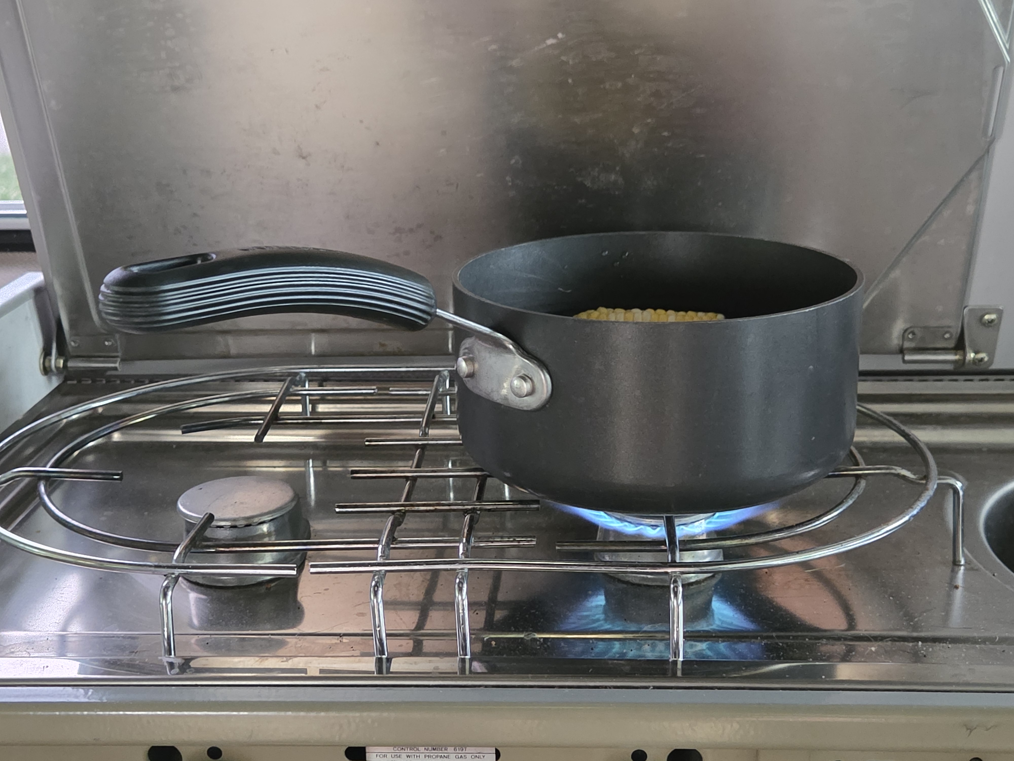

Now that the tank is complete, Rob had it filled and it works great!
I hope to see you at Volksfest, and next month I’ll continue talking about oil temps, see you then!
It works great!
It works great!

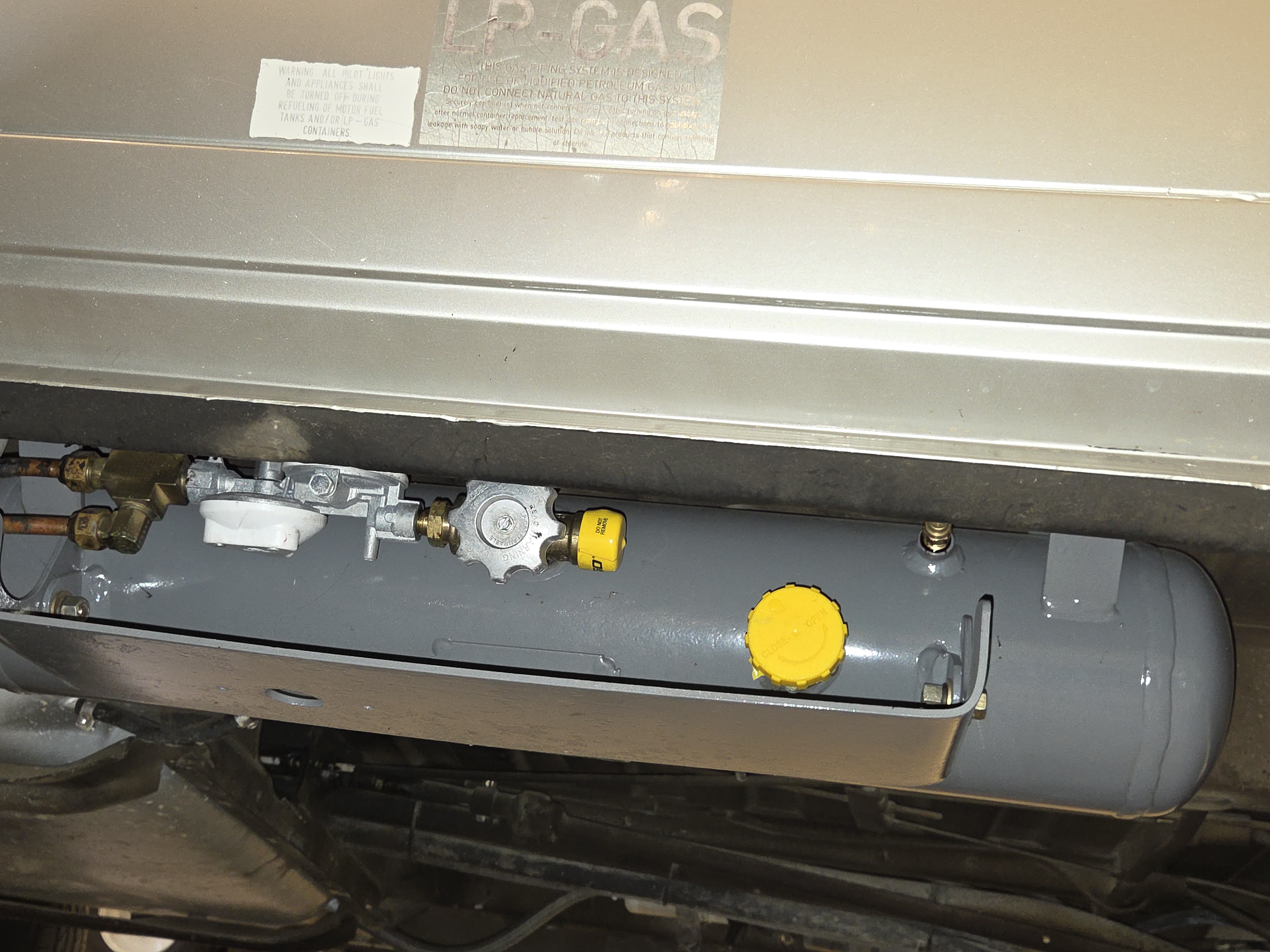

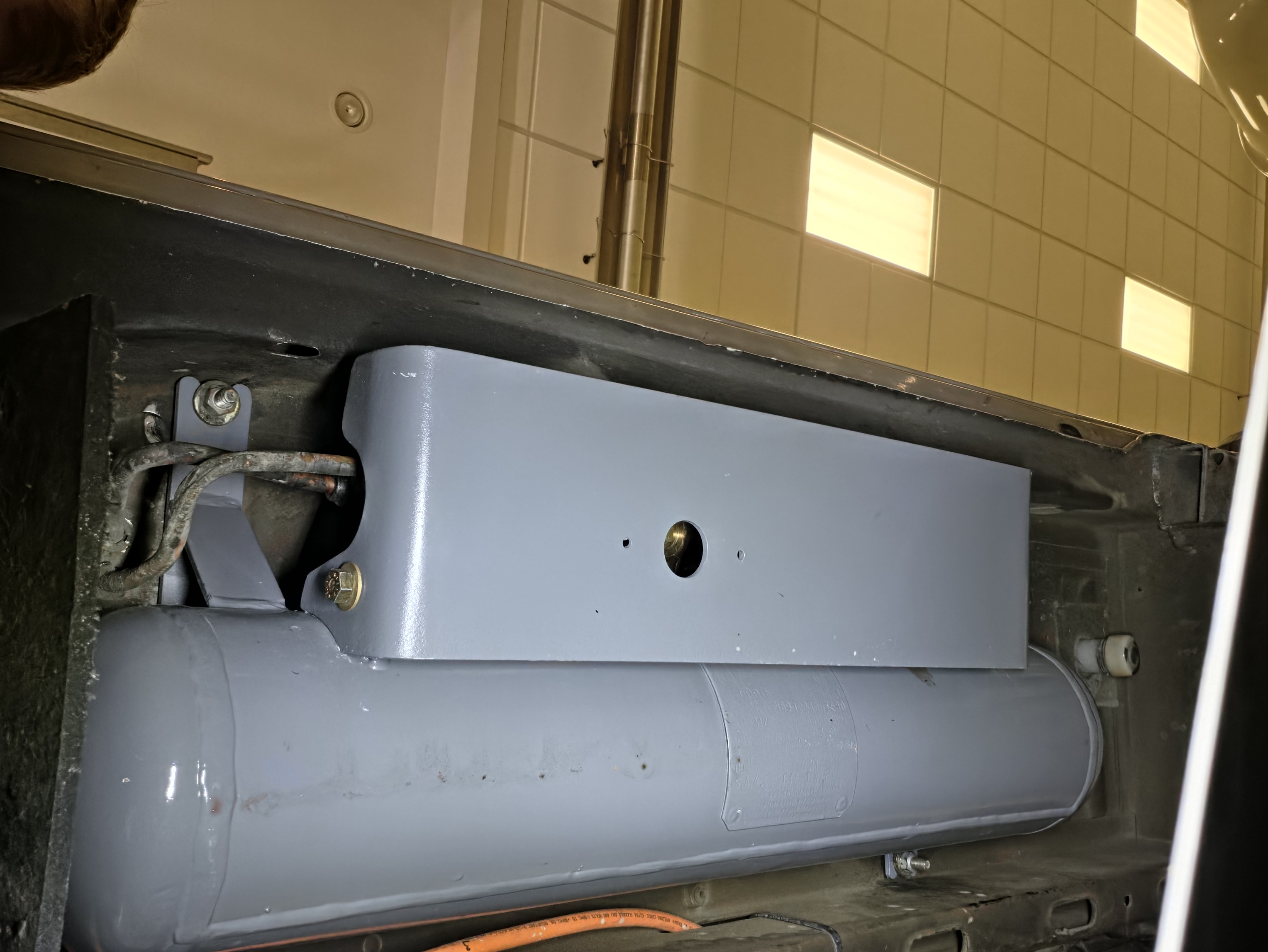

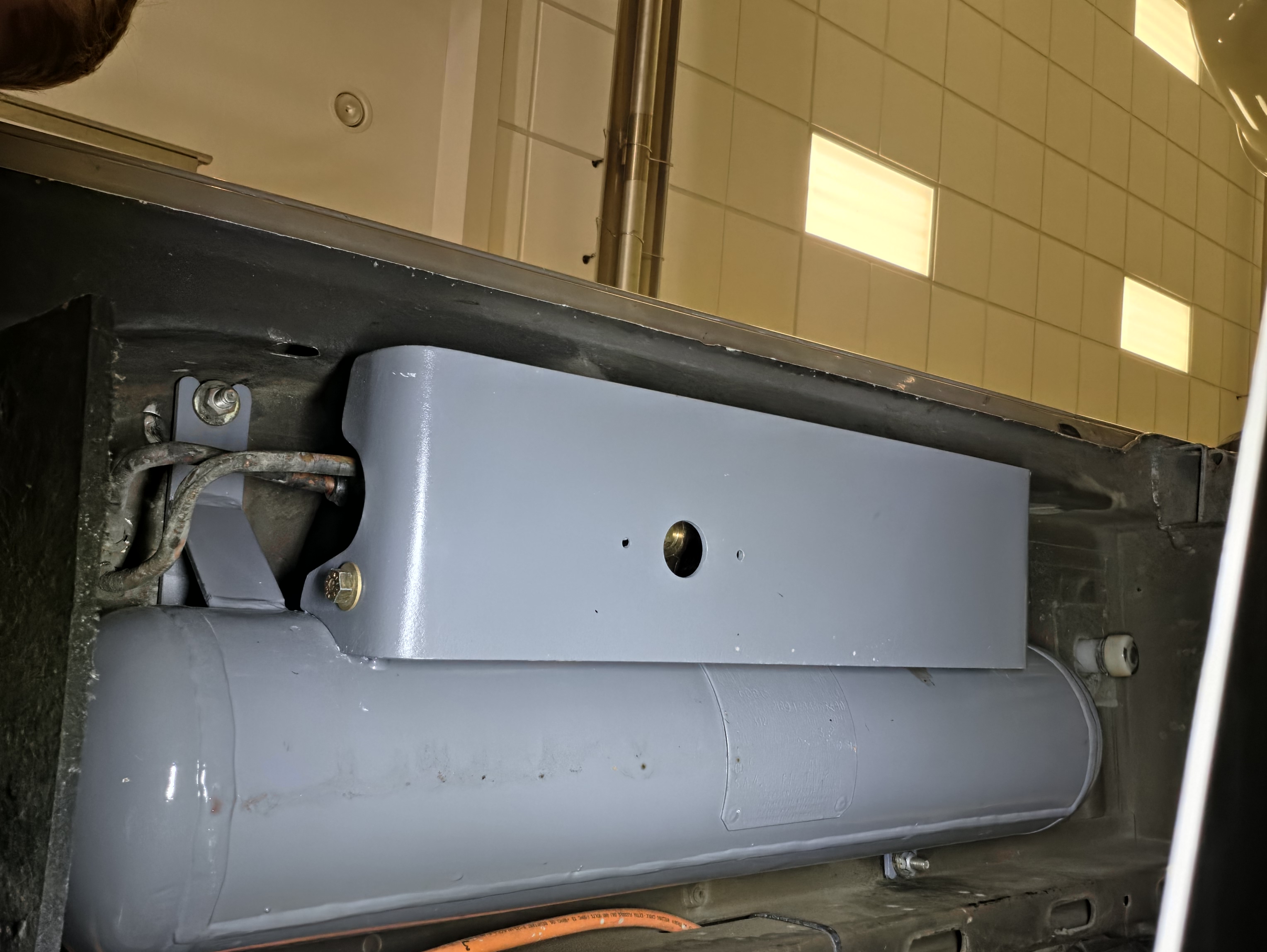

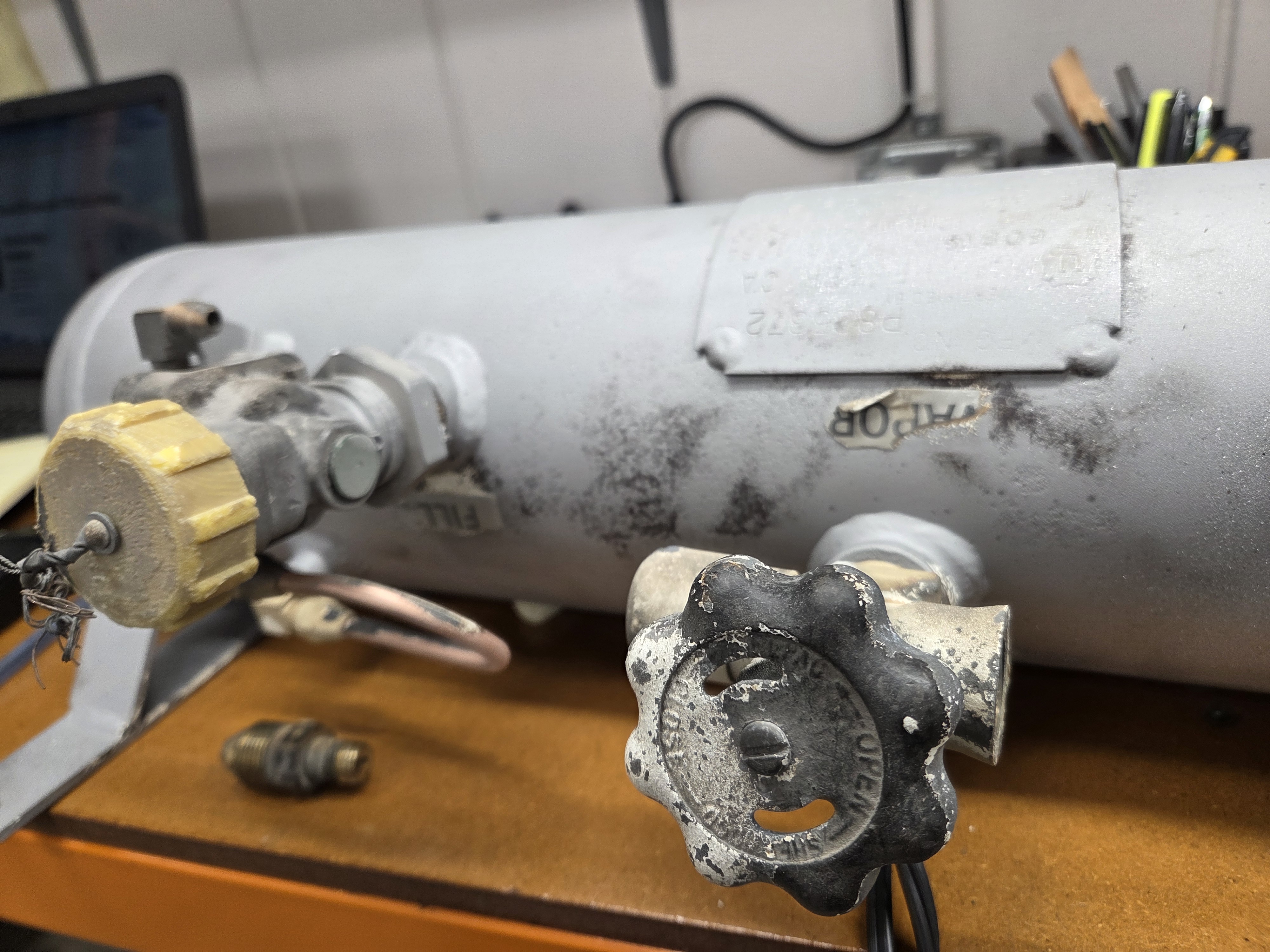

Painted and mounted.

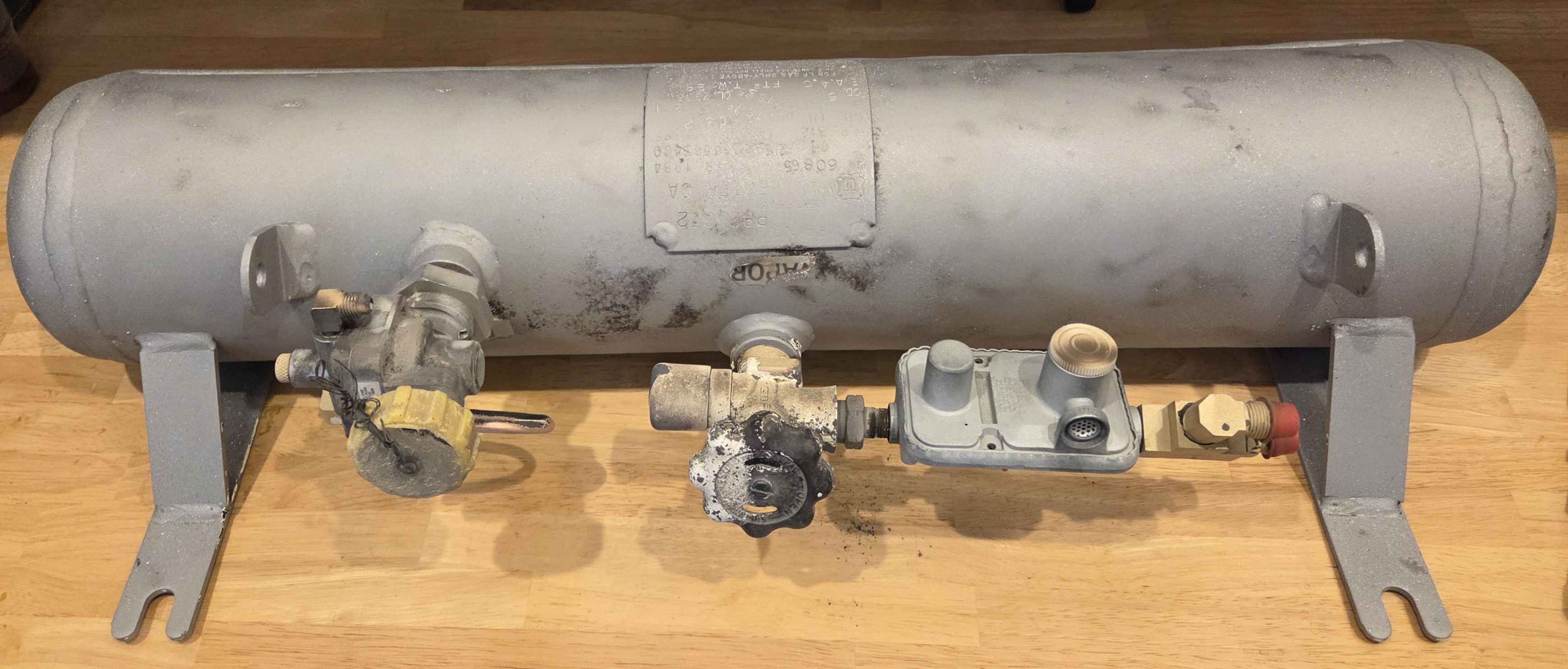

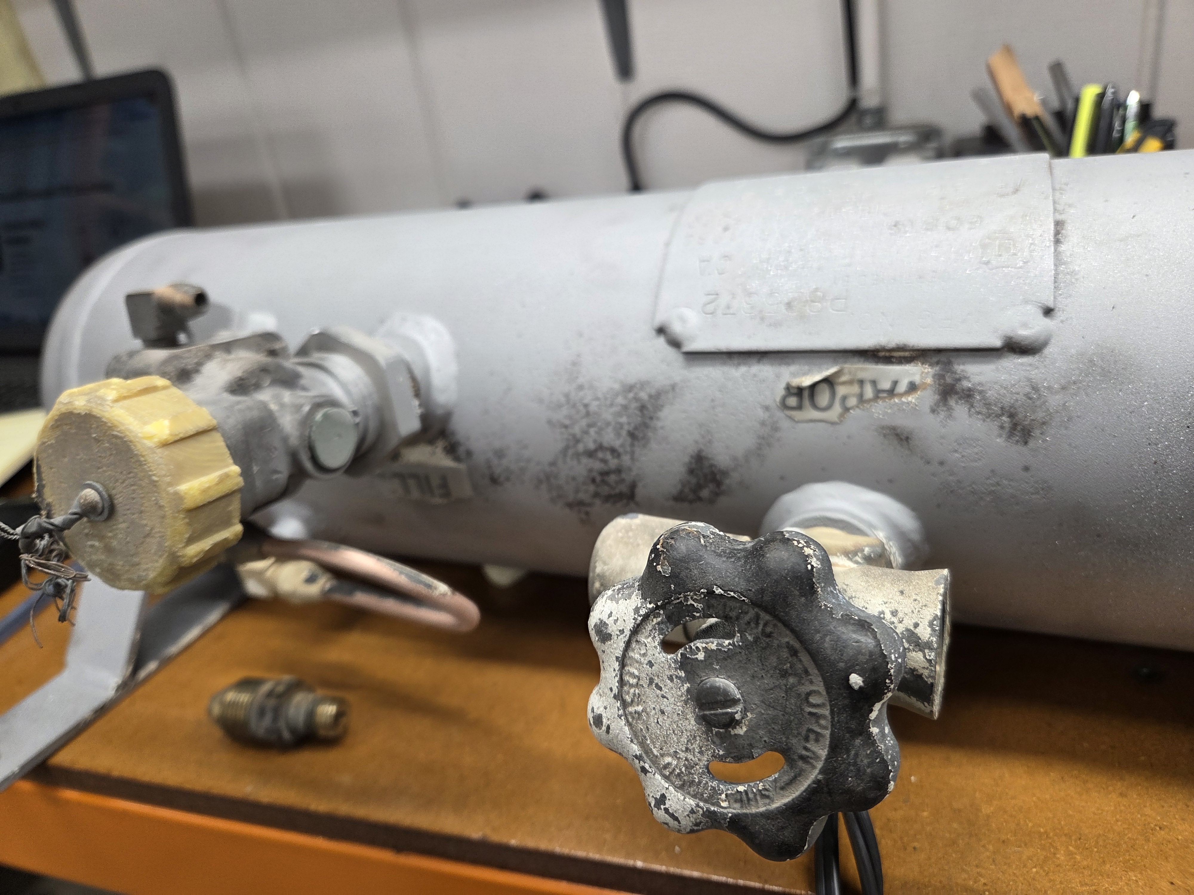

It had an auto-bleed feature which we eliminated and went back to manual bleed while filling.
After sandblasting.
After sandblasting.

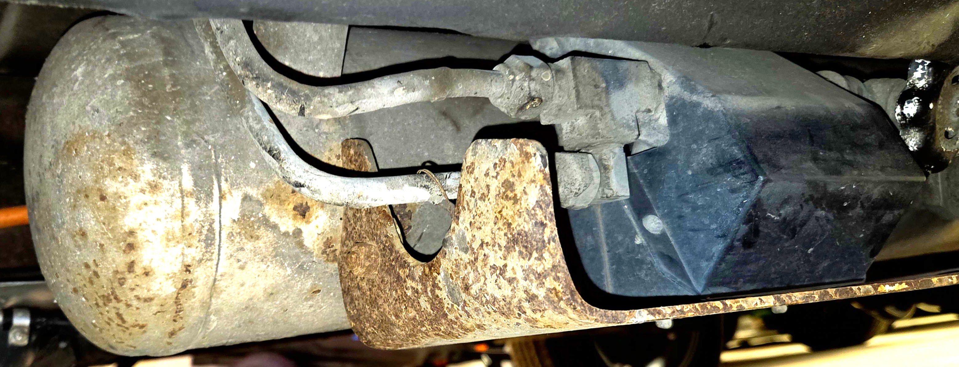

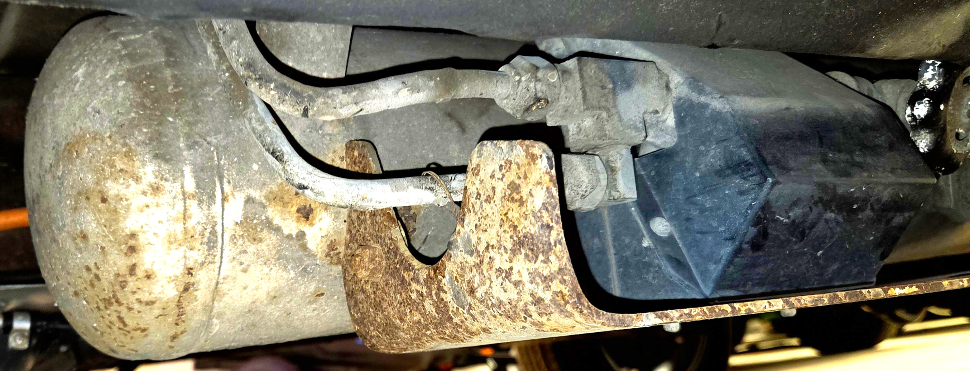

The tank was looking pretty ratty, and would not fill.
