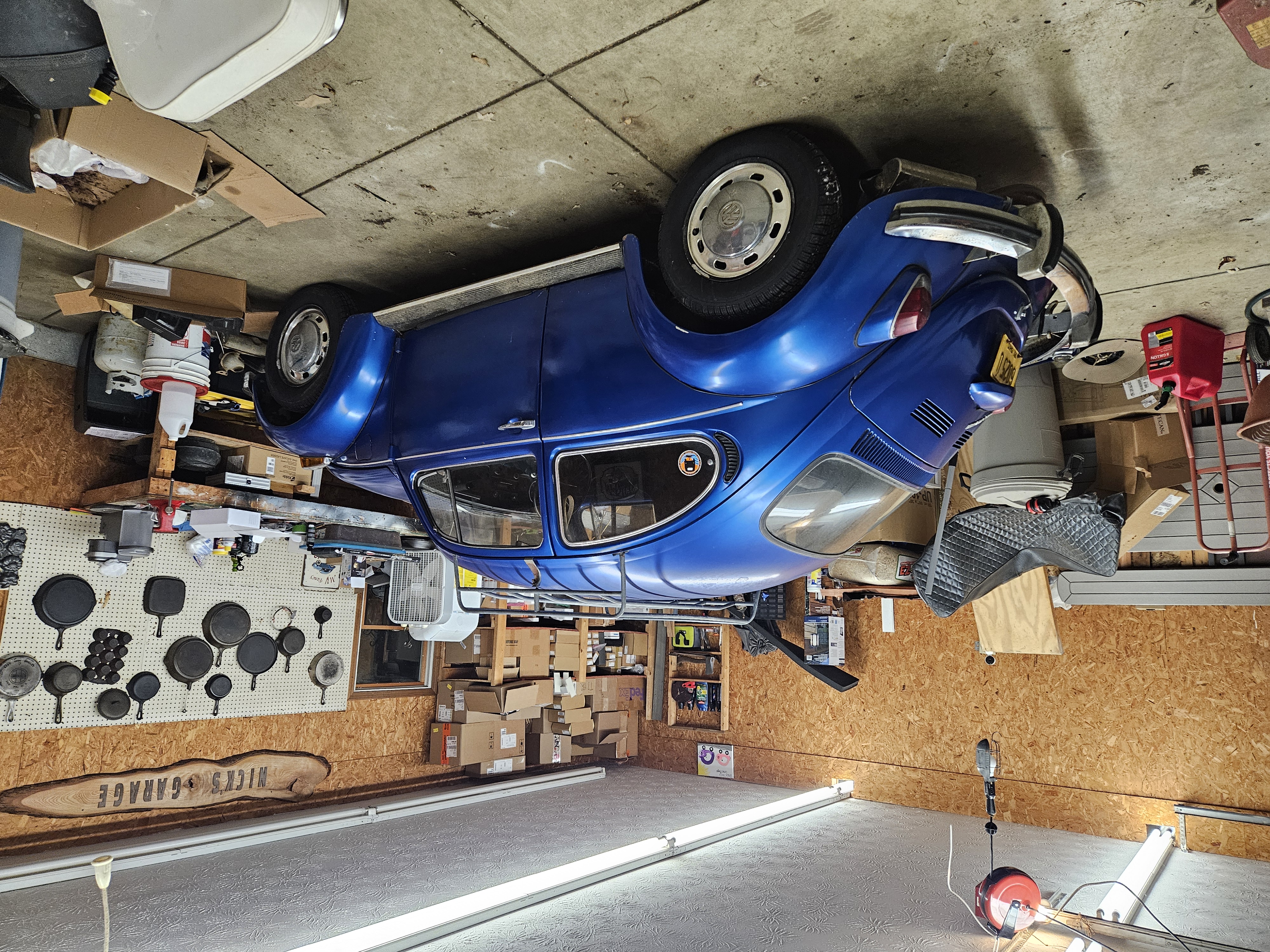

Hans is at my new house and now partially torn apart to redo the interior after some floor pan patches. Getting new TMI seat covers on is a PITA. Bill had the patience of a saint.
Re: Hans and Olaf
Nice to see you getting back at it. Good luck with that interior. I’ve heard Bill complain the most about headliners. Hopefully you don’t need to do that.
