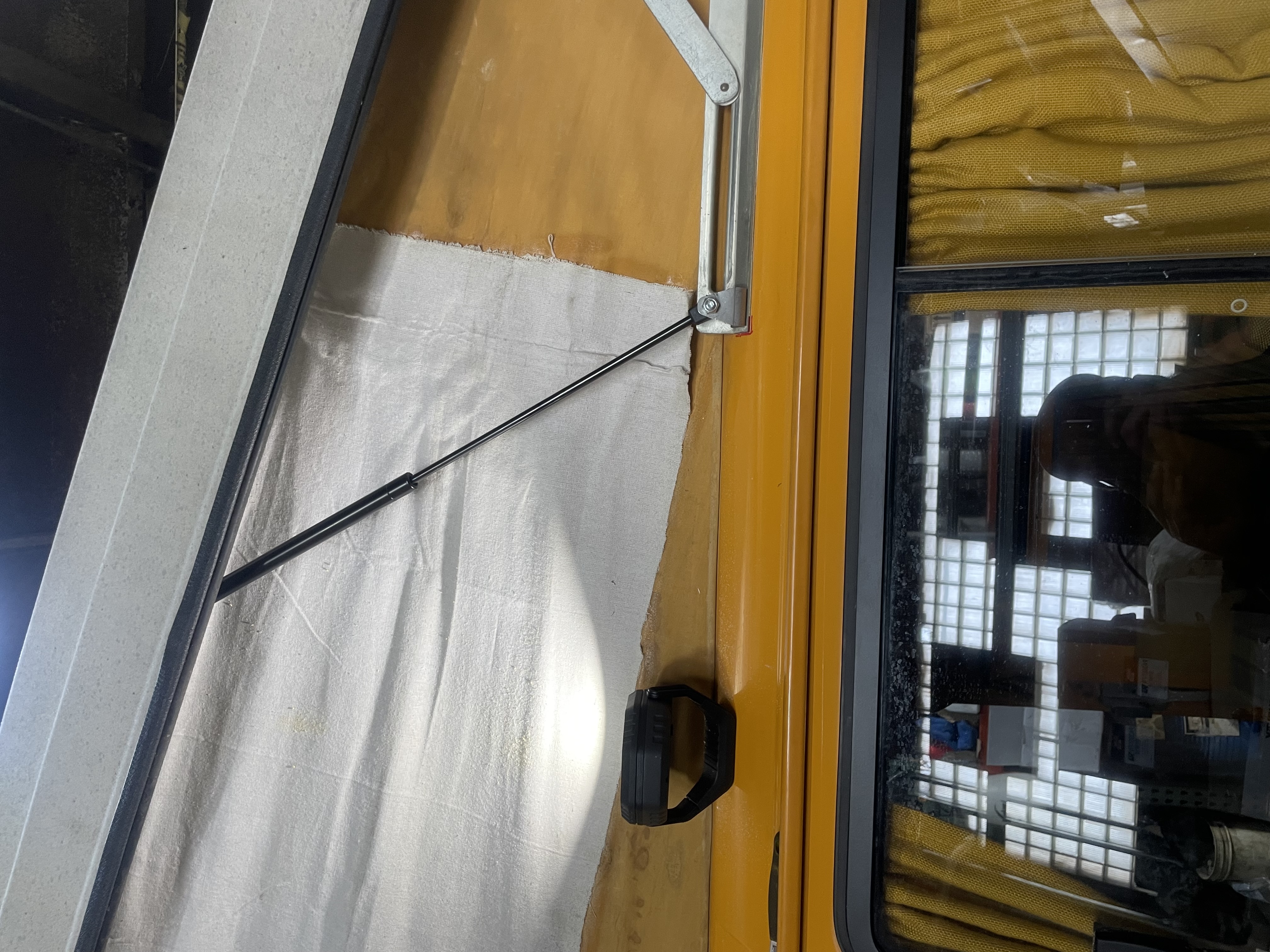

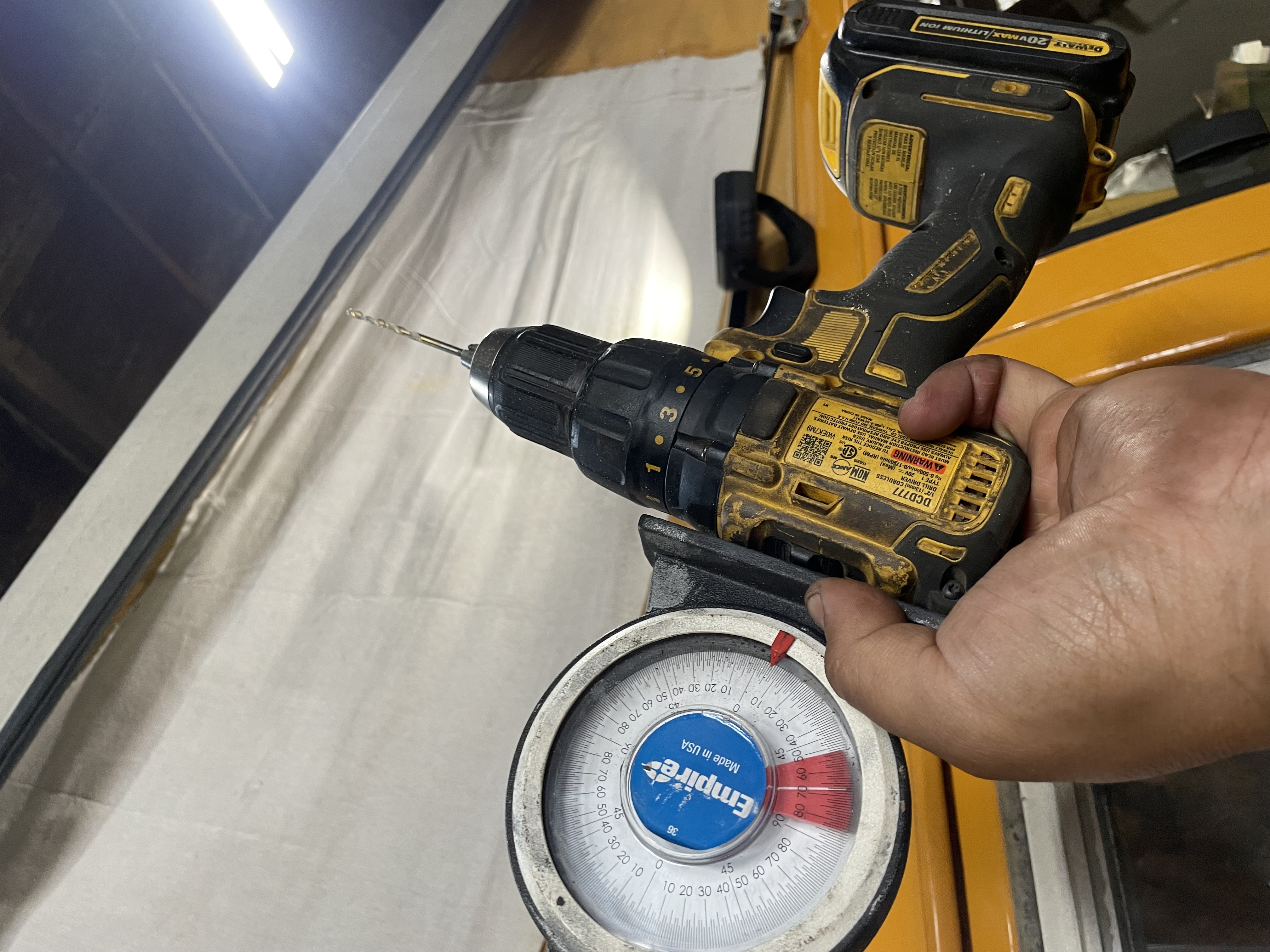

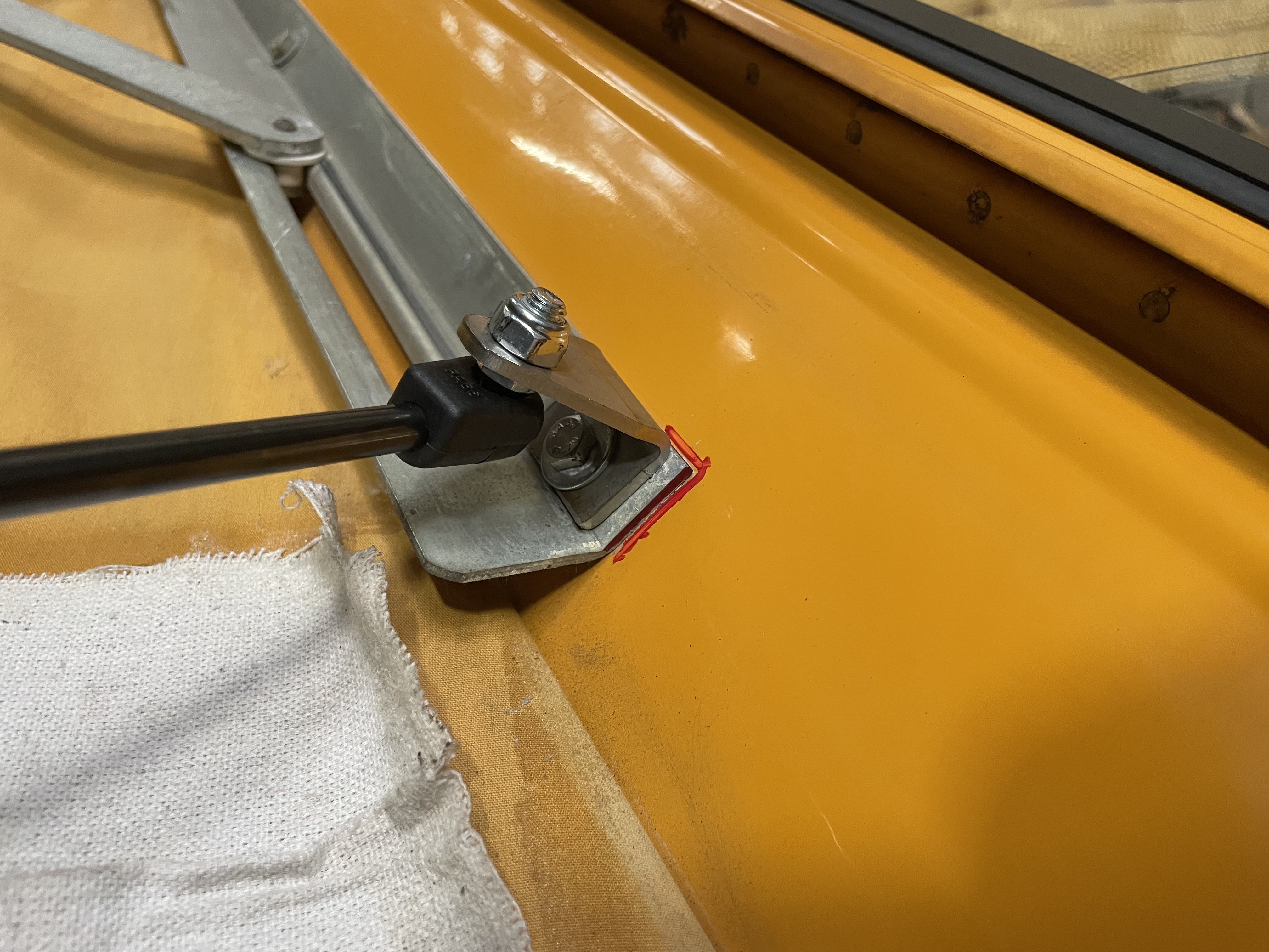

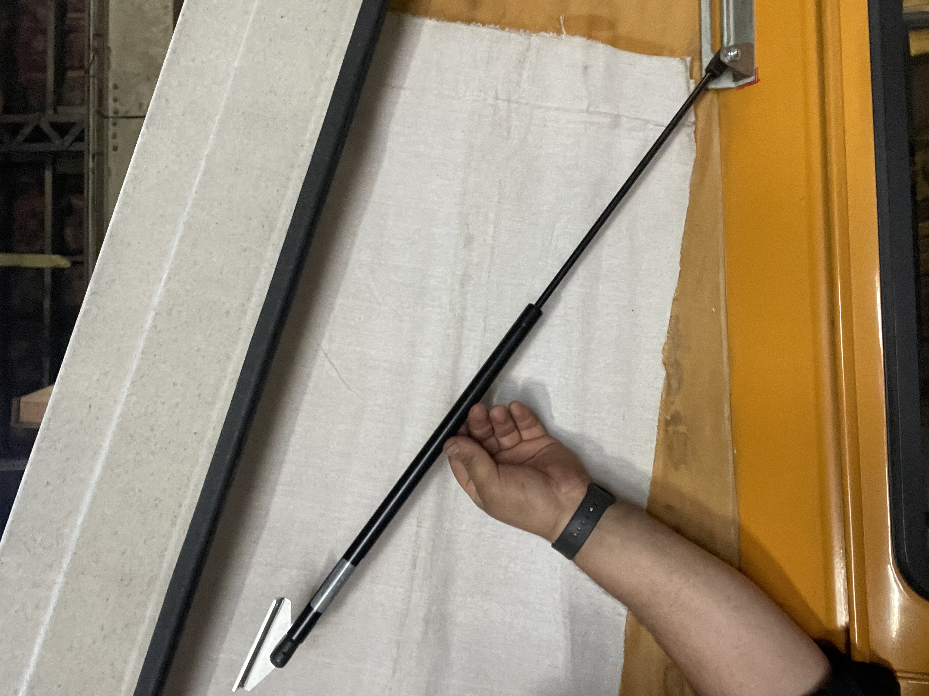

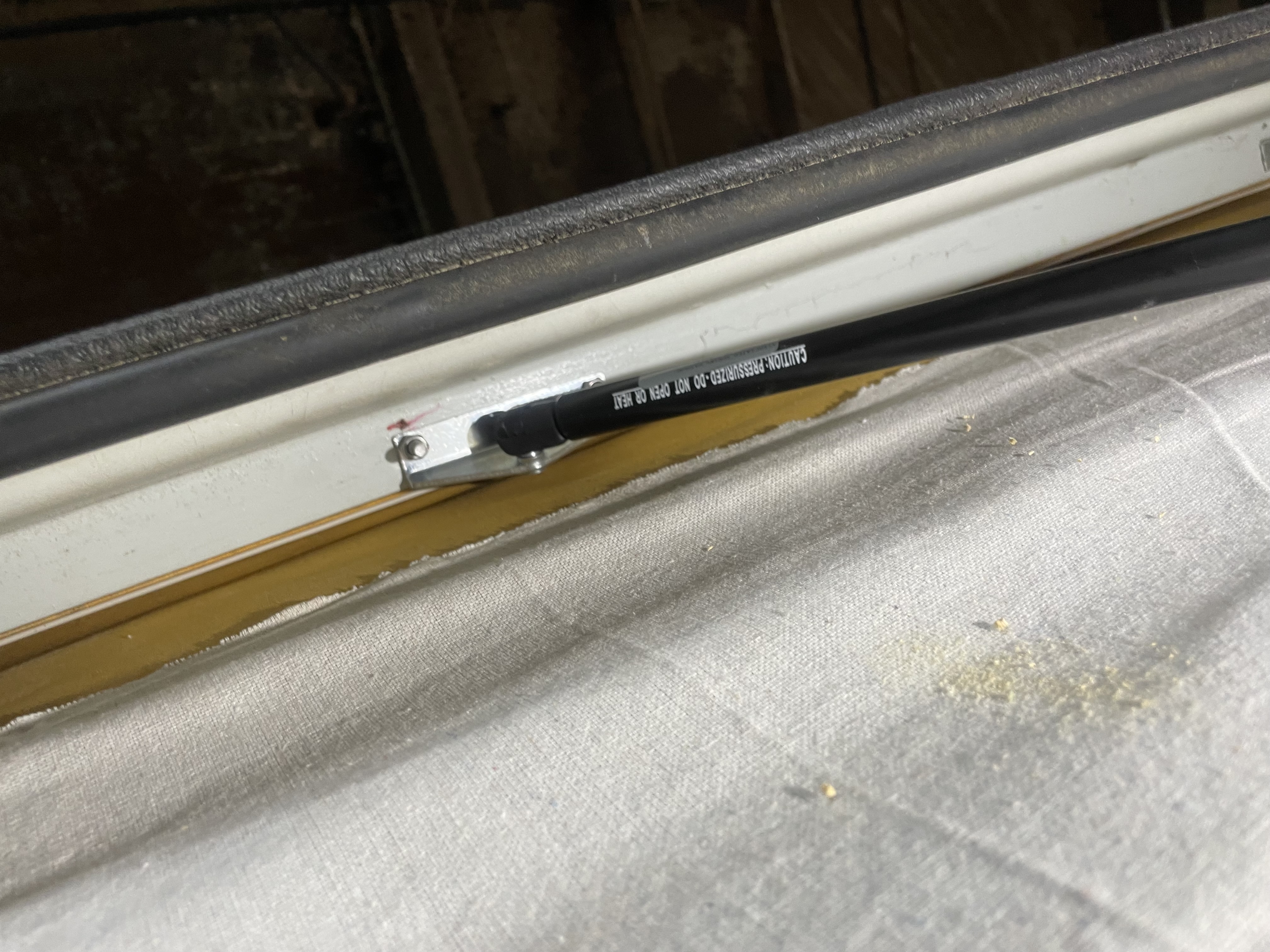

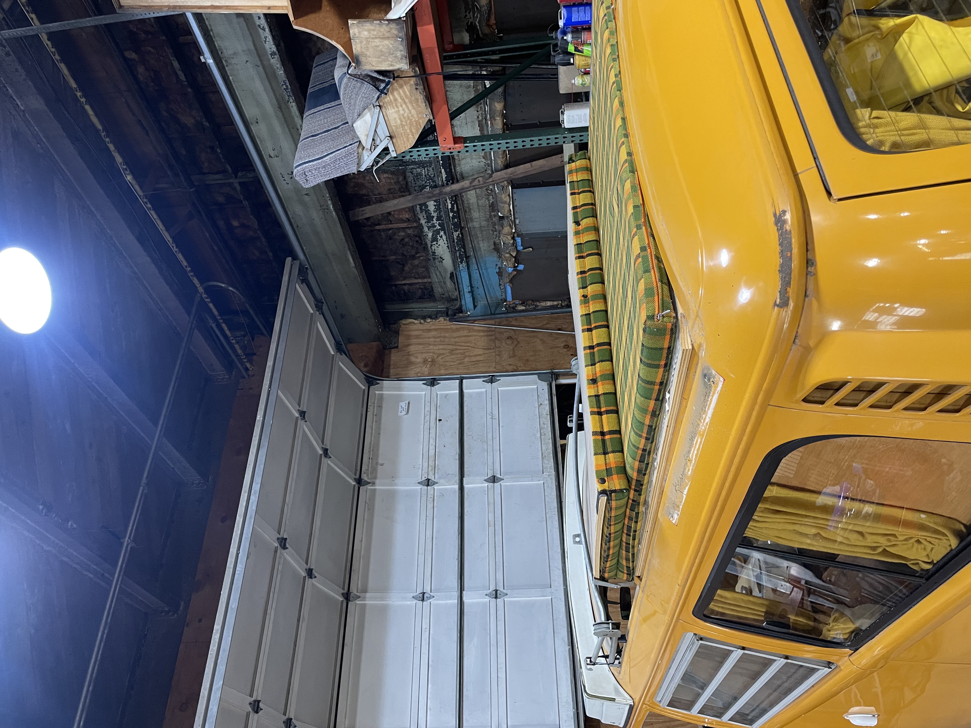

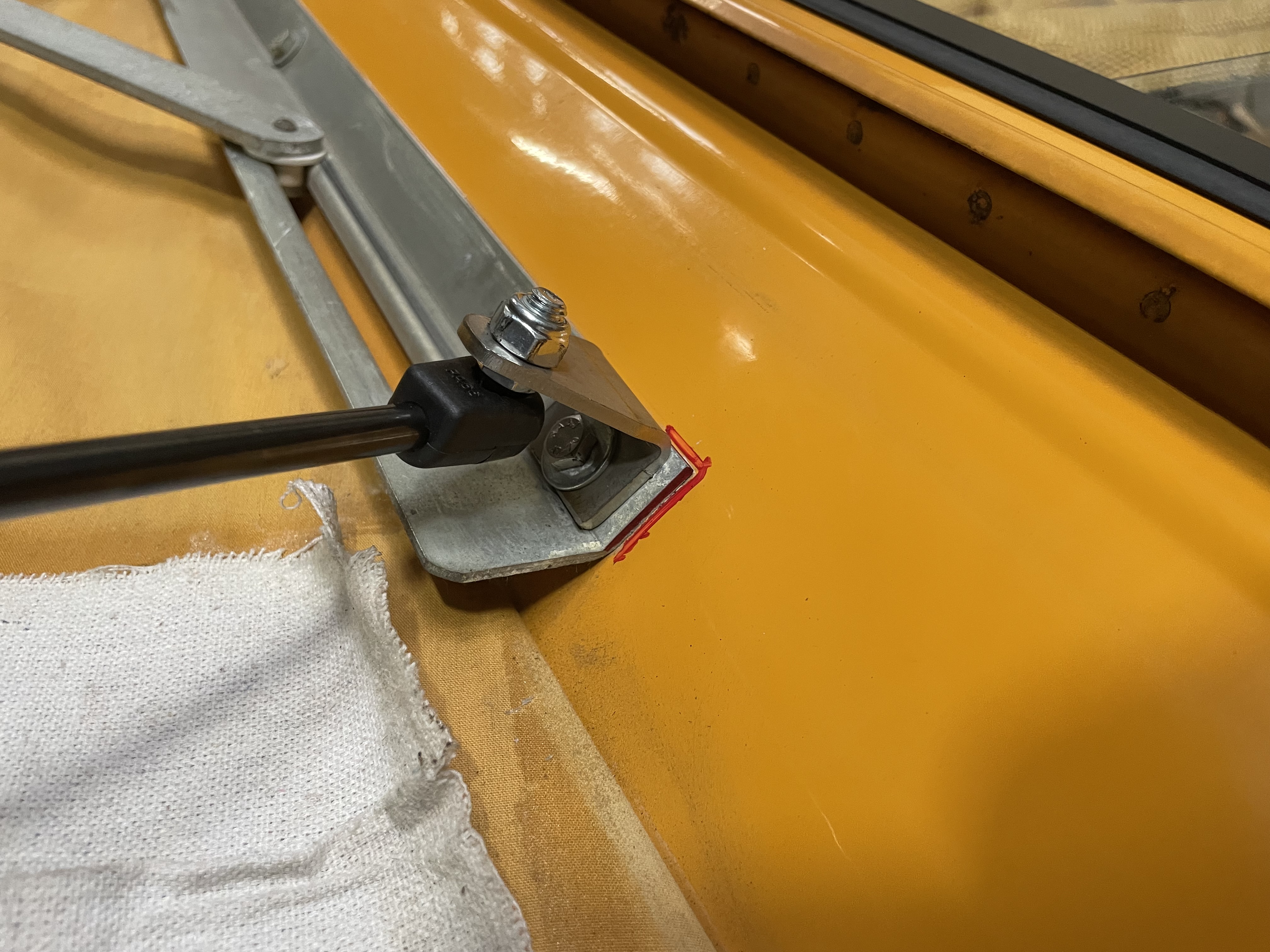

I started by installing the pop-top lift assist kit first. If any mistakes are made I could fix them later. Pretty easy install… The lift pistons use one of the bolts that hold the rear top hinge. Then the top of the pistons require drilling holes through the wood and fiberglass of the pop. I pulled out an angle finder to keep the drill at the same angle of poptop and make a nice straight hole.
I’m happy with the results, the top is much easier to lift. Pulling the top off in the coming days for sanding and painting.
Bottom bracket uses existing bolt and hole for rear hinge
Angle finder to keep drill straight
Top bracket placement. Best to get the holes centered on the wooden frame.
Final install
Final install

I like that drill/angle finder trick, thanks for sharing!

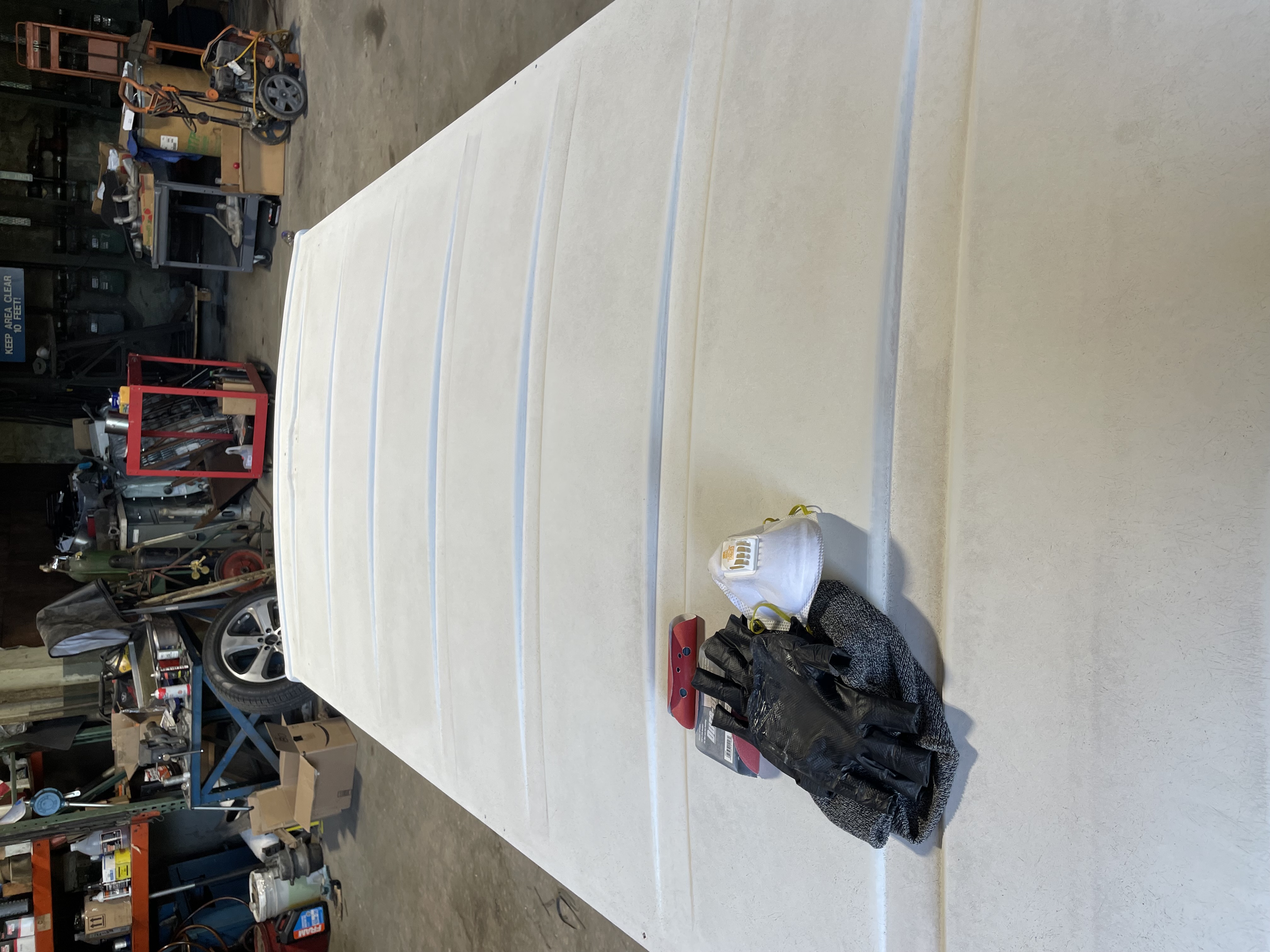

Sanding, sanding, sanding. Mixing up a bit of filler. Then more sanding.

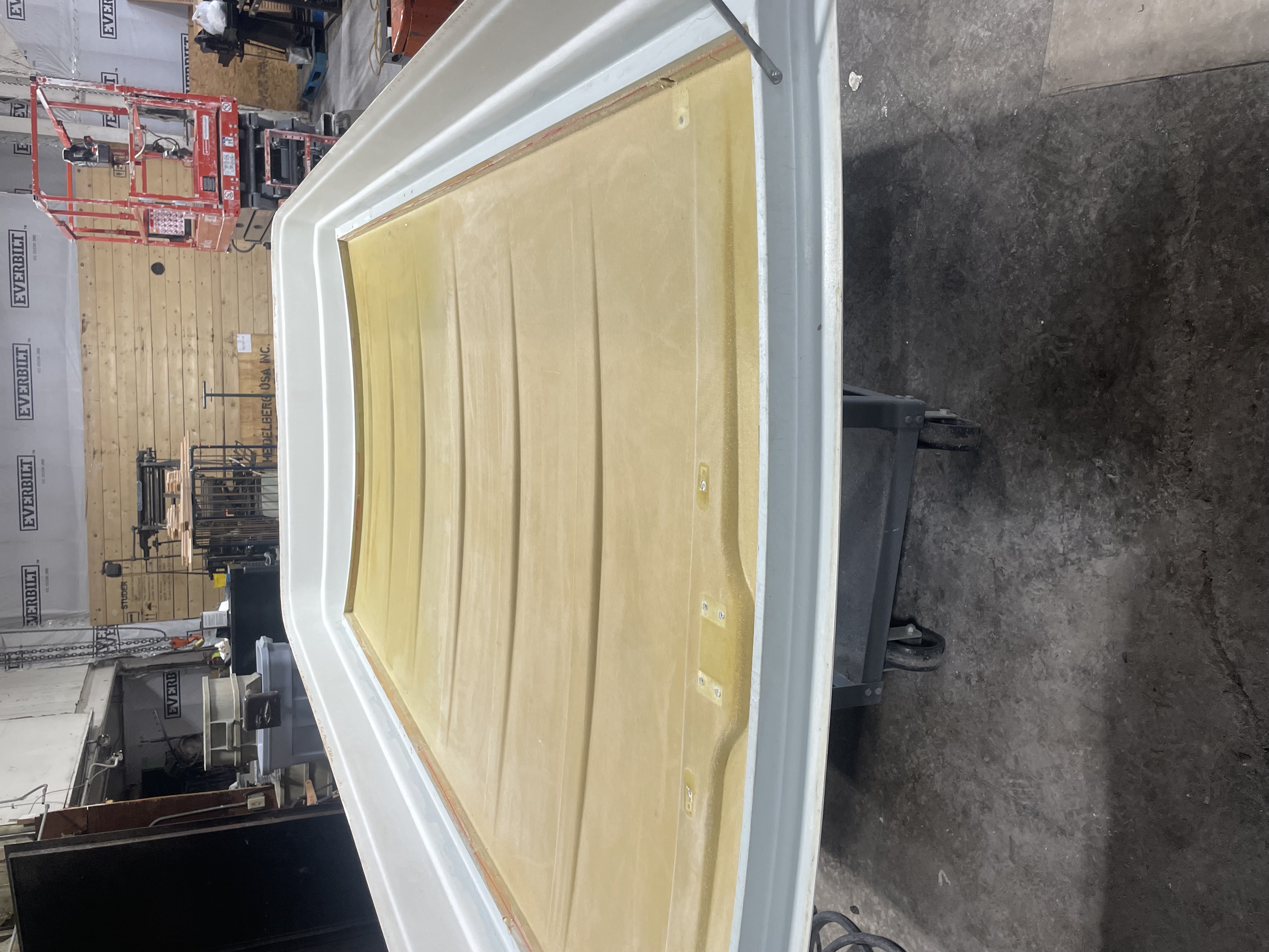

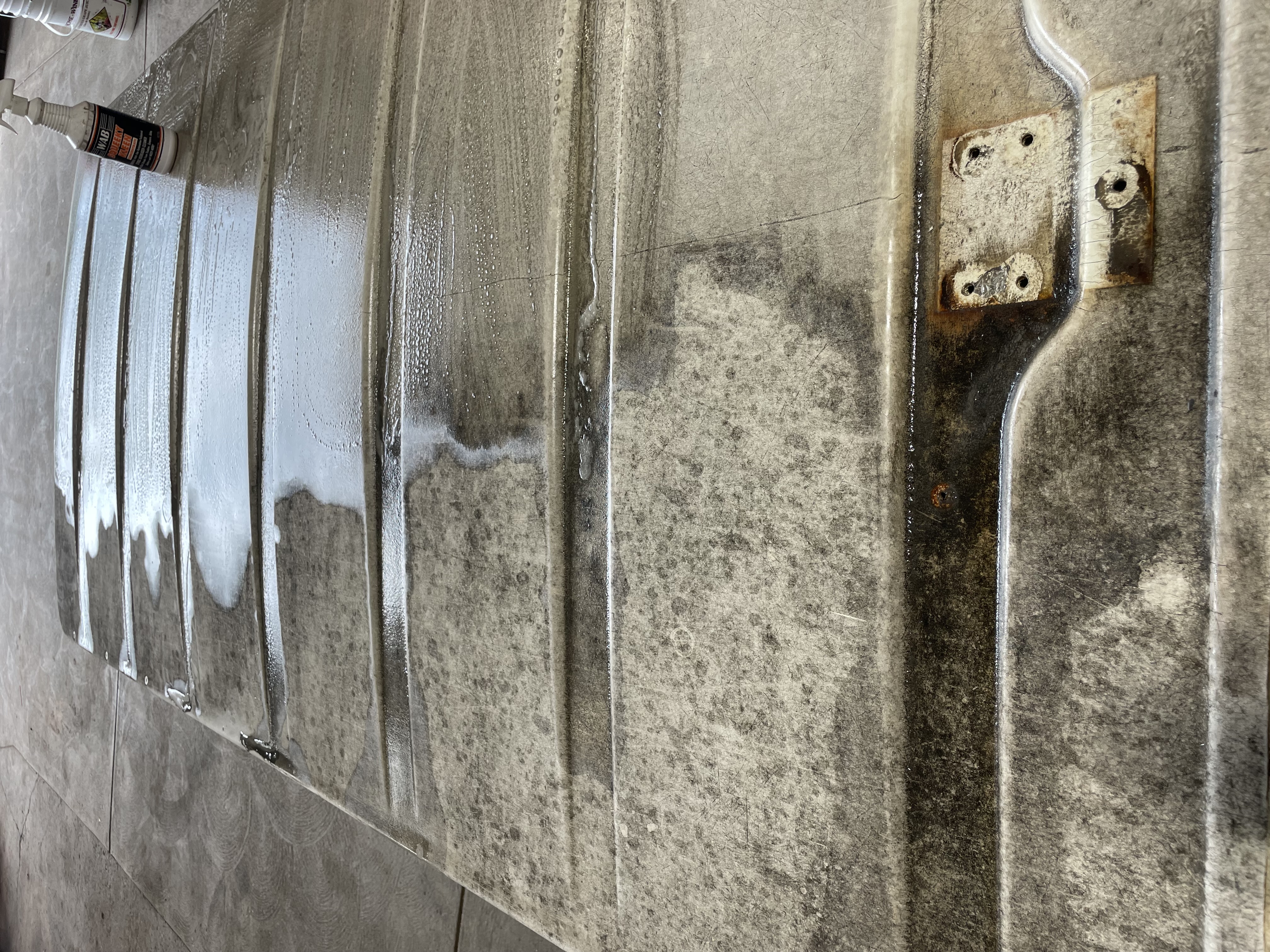

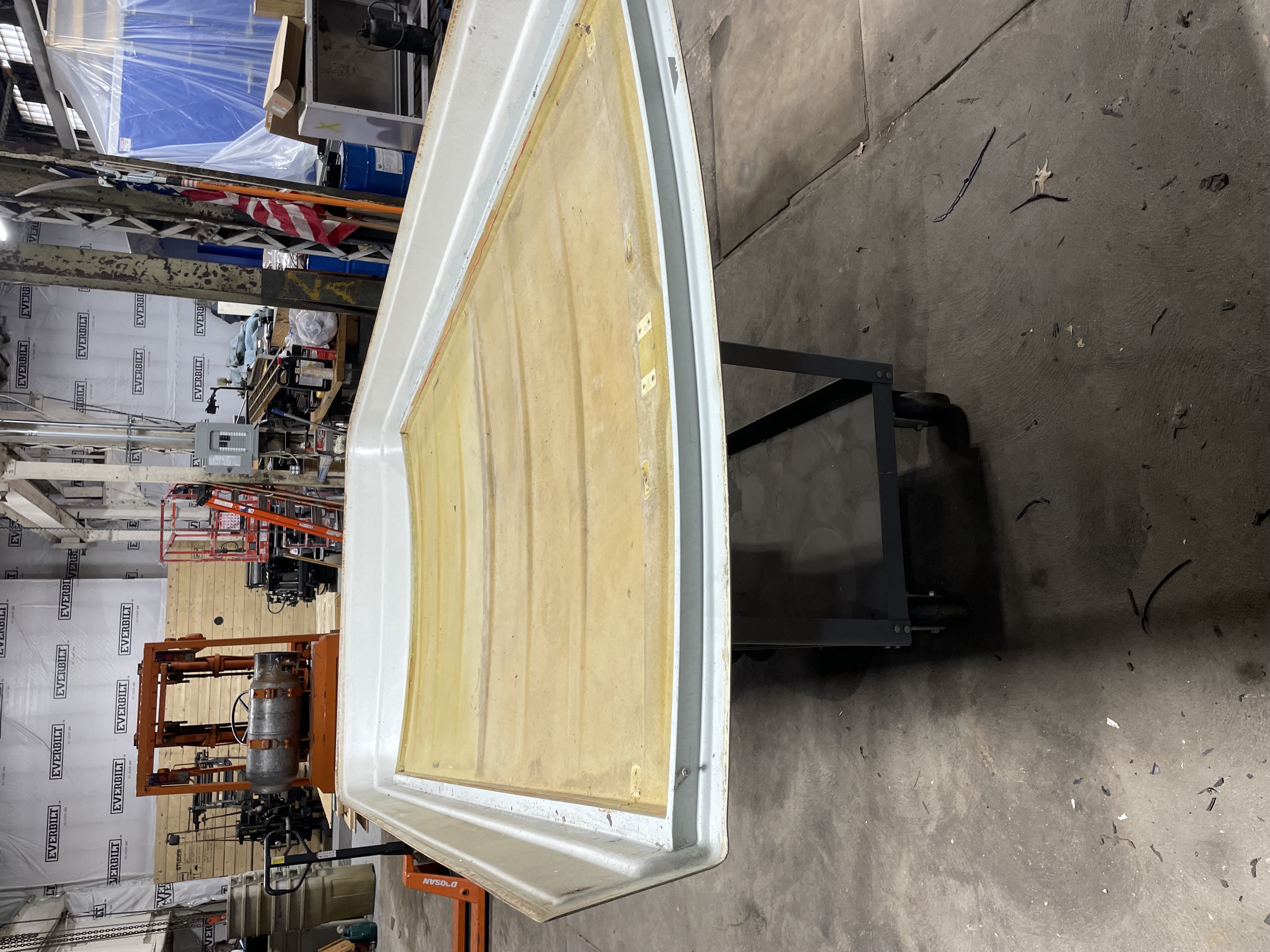

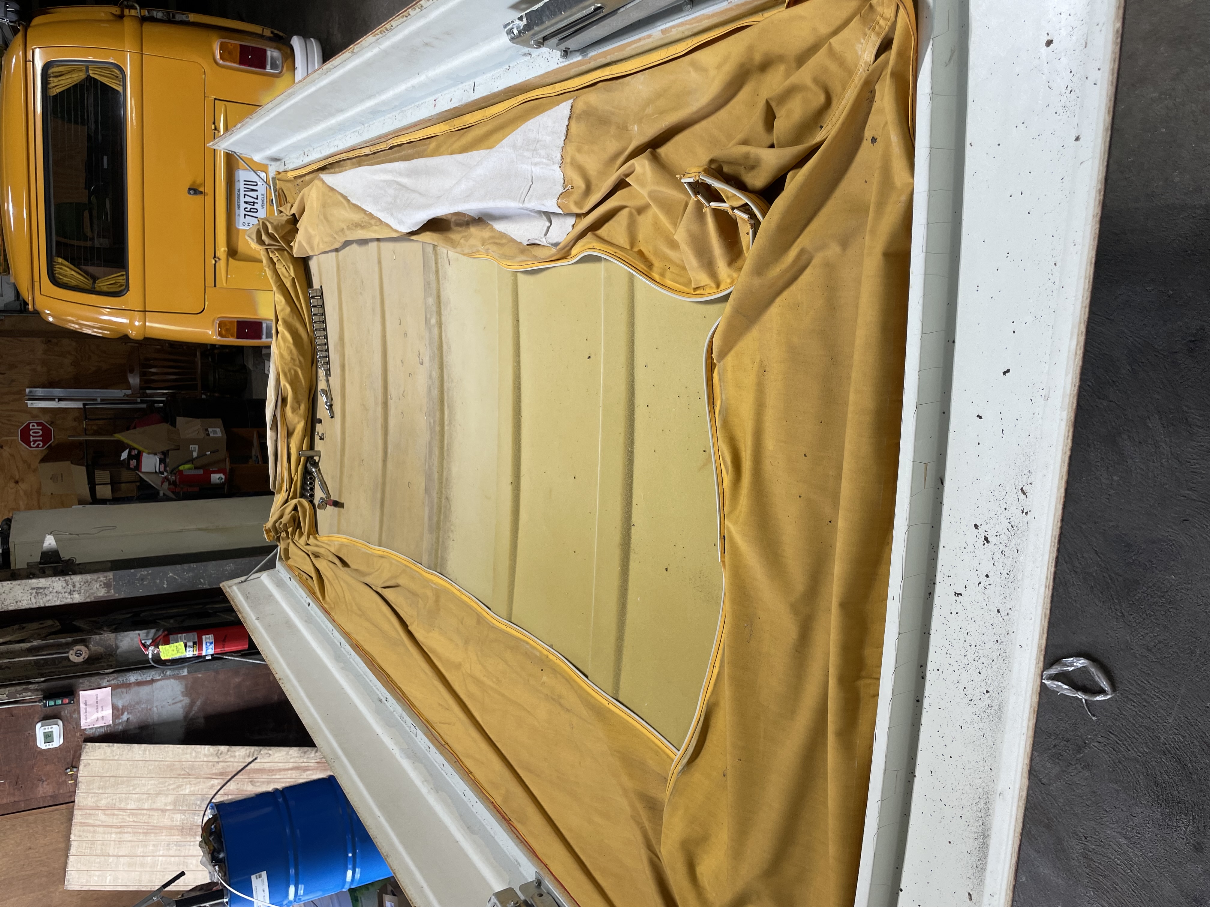

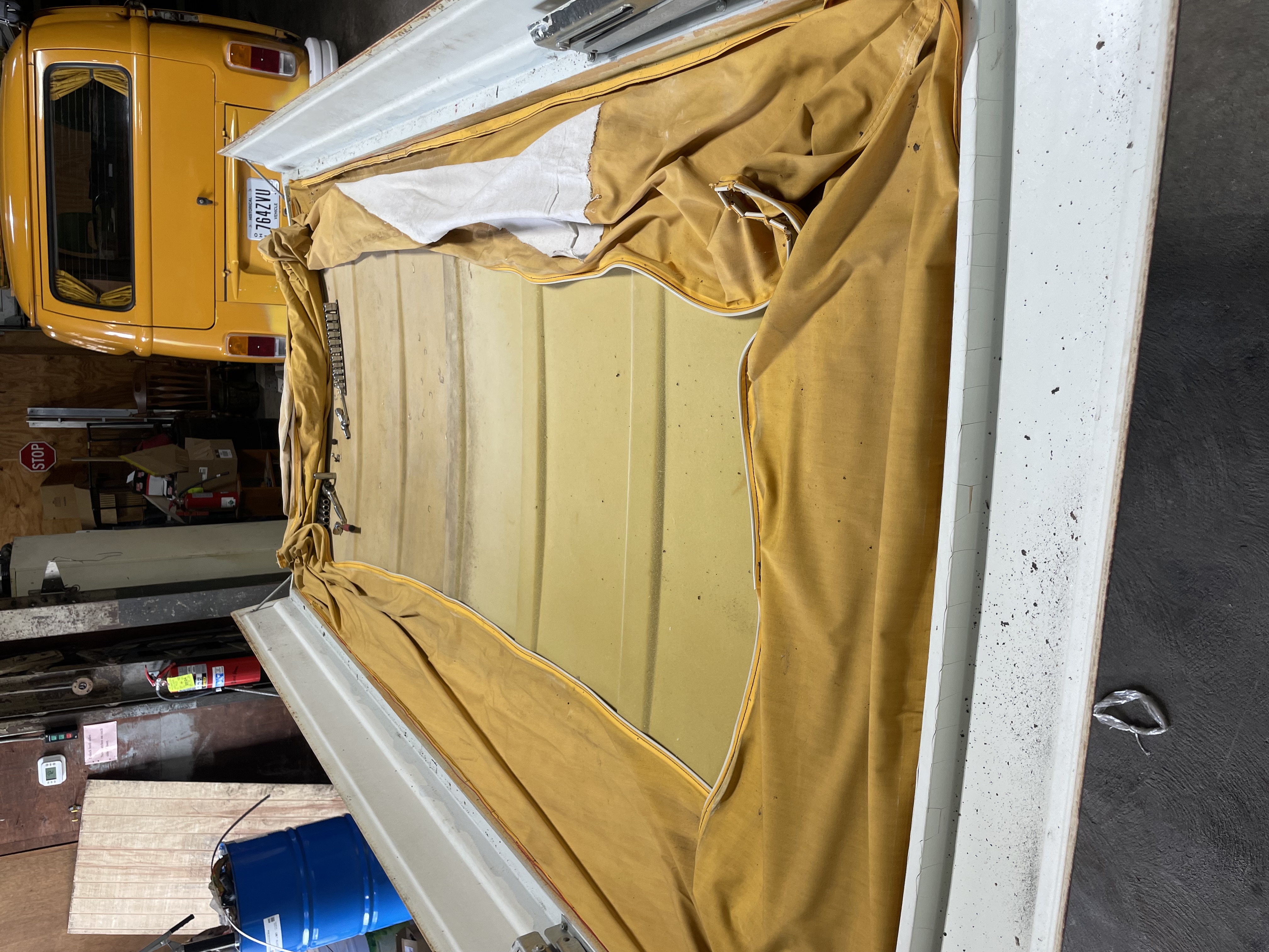

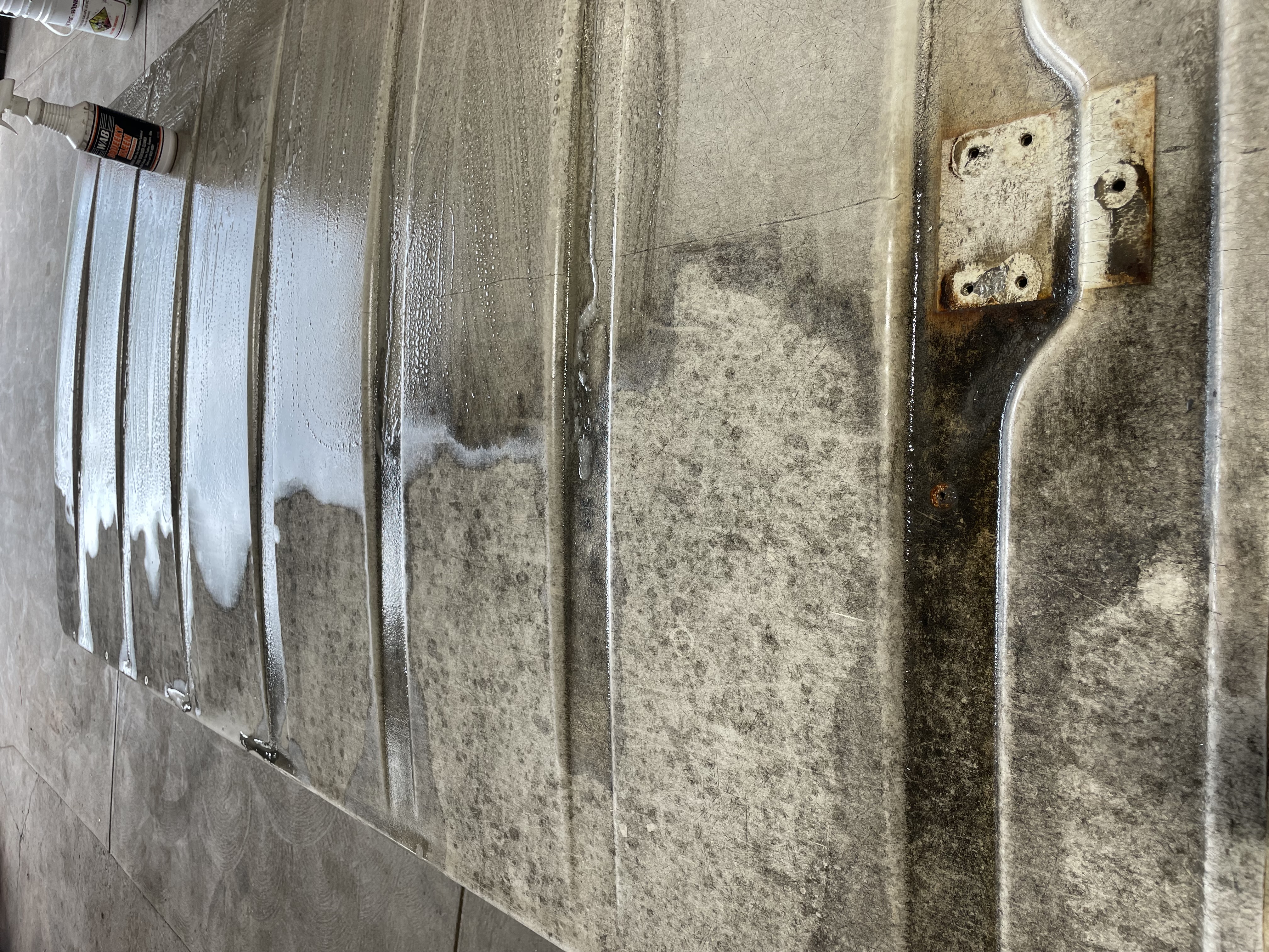

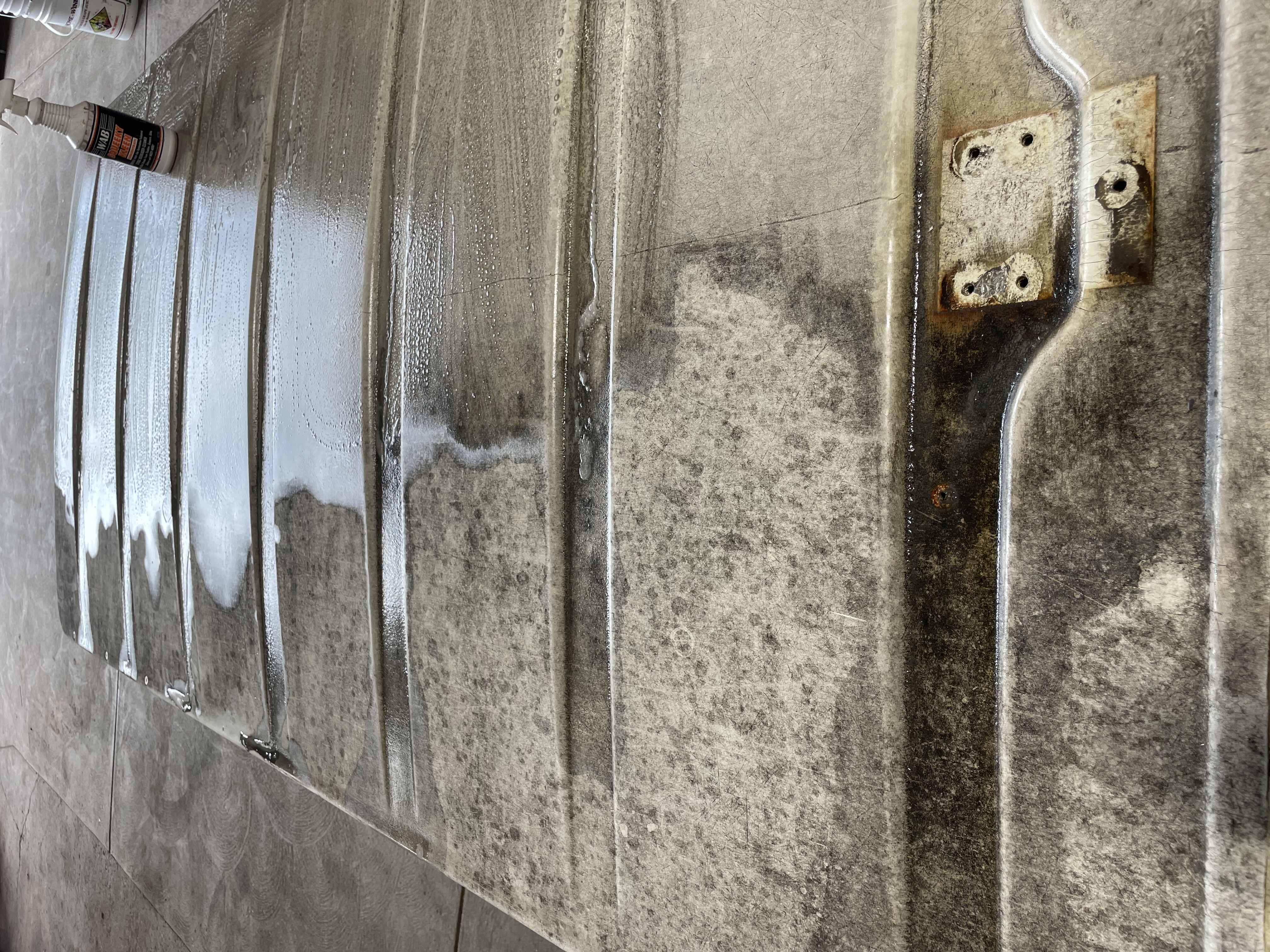

Not unlike a boat. The fiberglass pop top has a gel coat. The top layer of gel coat is dead and beat. A few round of sanding up to 220 grit to get down a nice clean layer of gel coat. There are a few cracks in the gel coat. I got out a small die grinder and opened the cracks up a bit to allow the fiberglass filler to stick. Finally ready to paint.

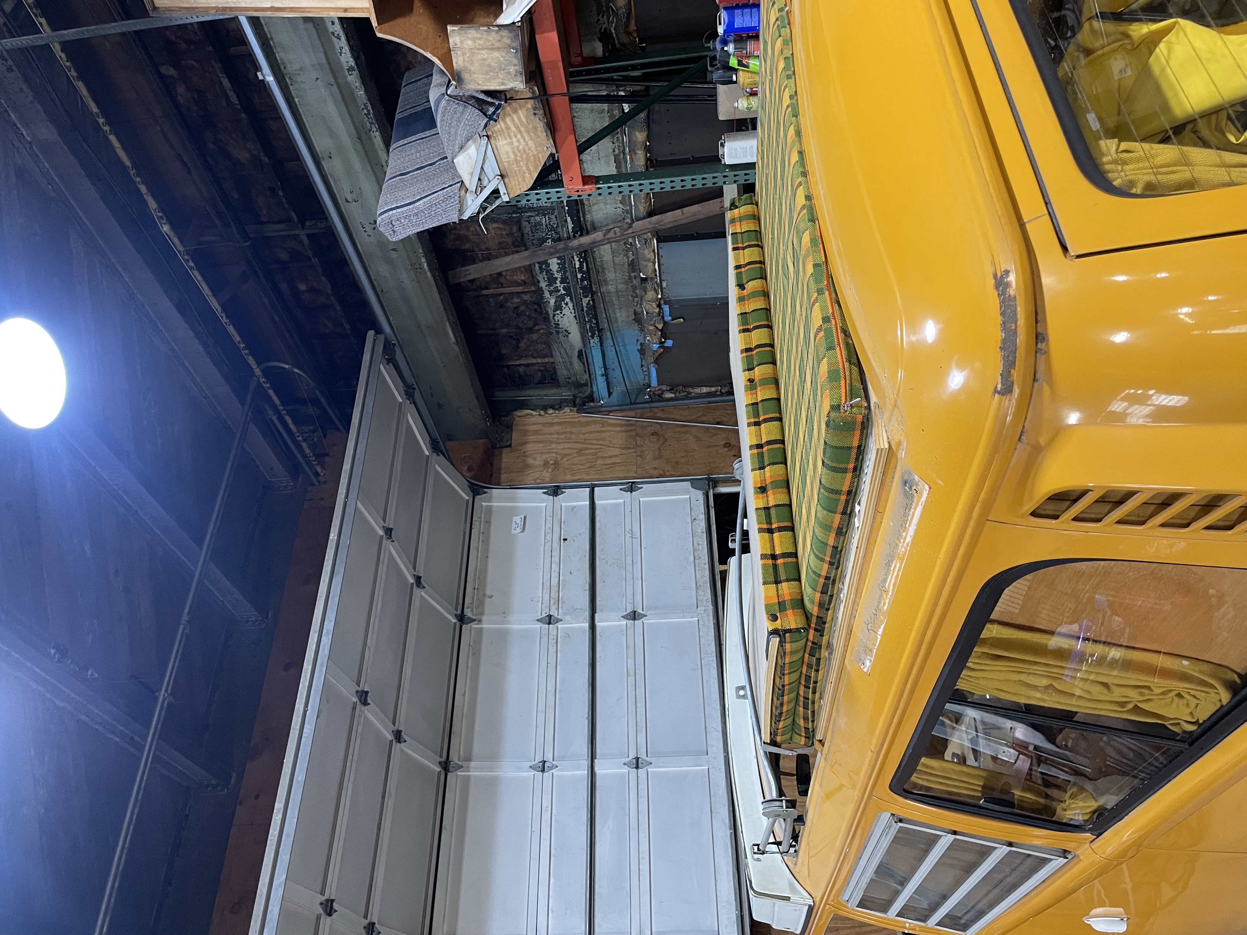

Convertible!
Convertible!
Canvas and parts striped off
Dirty dirty
Dirty dirty

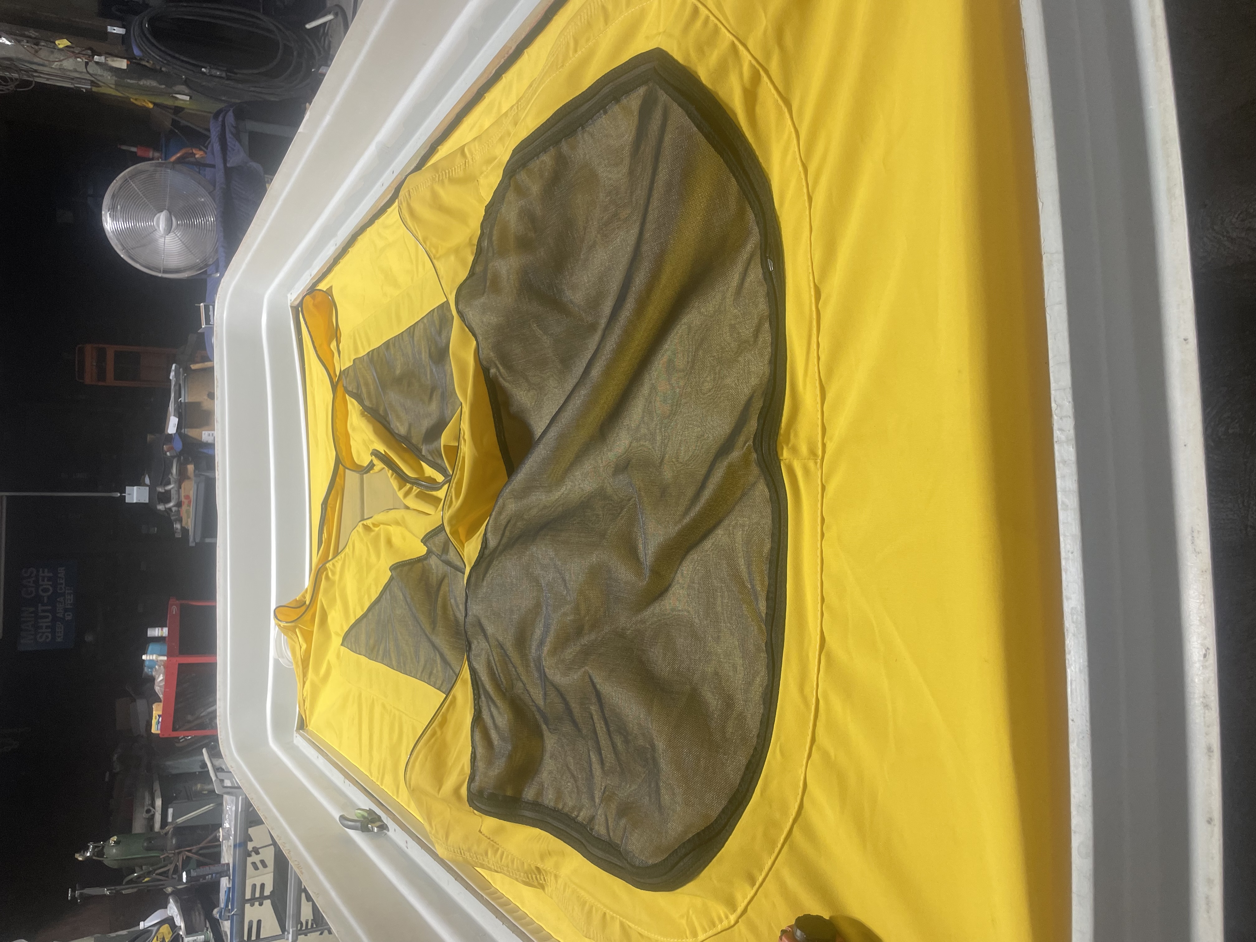

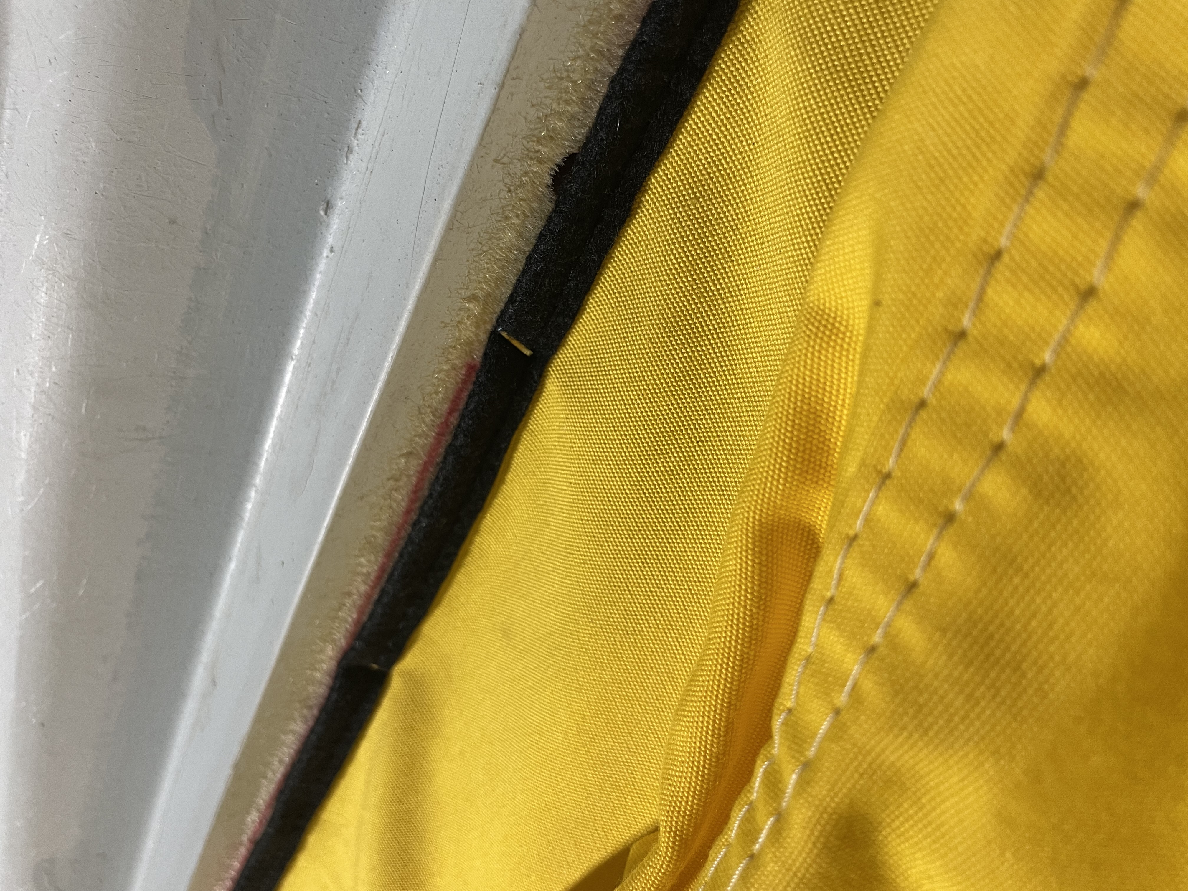

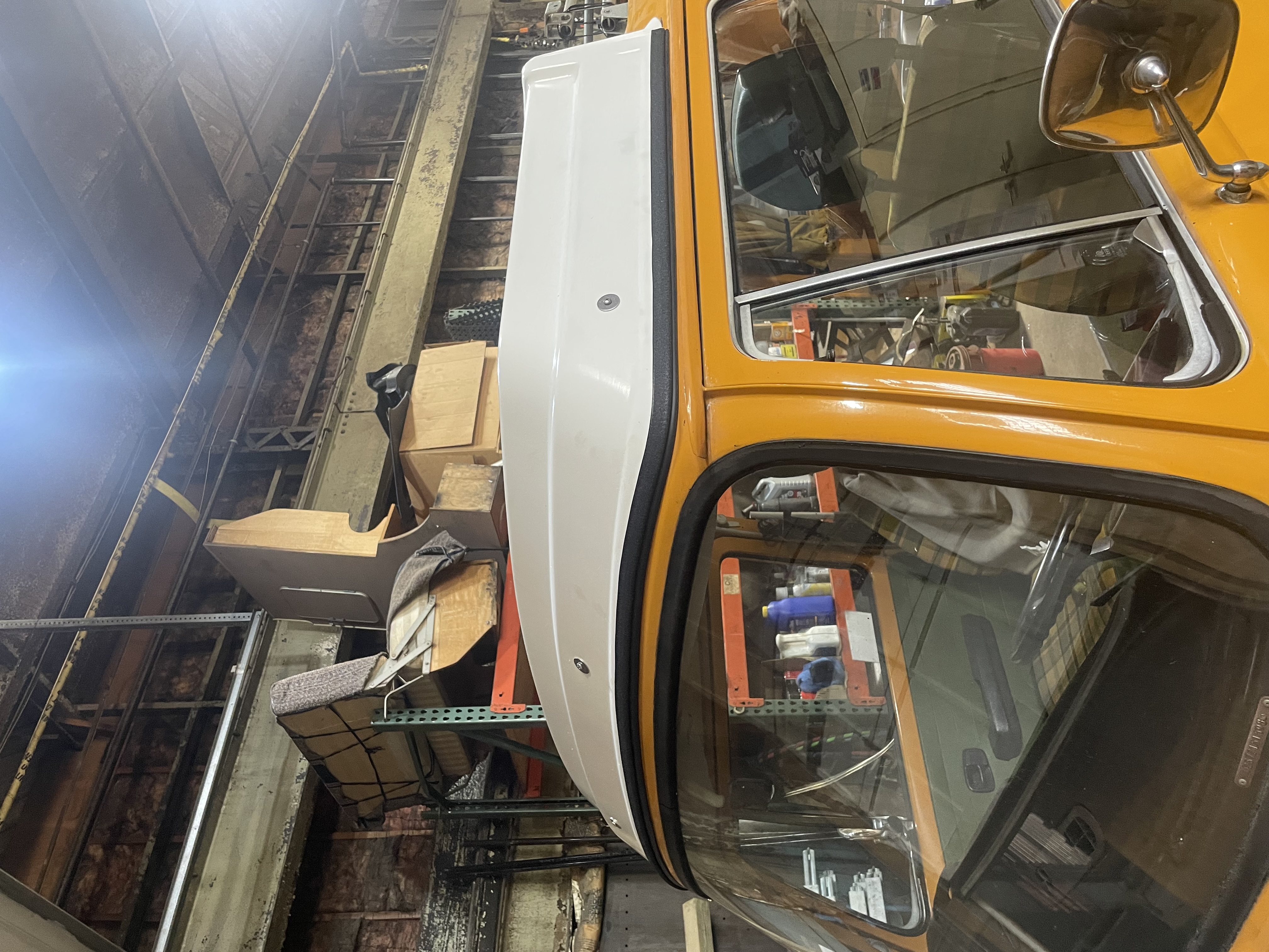

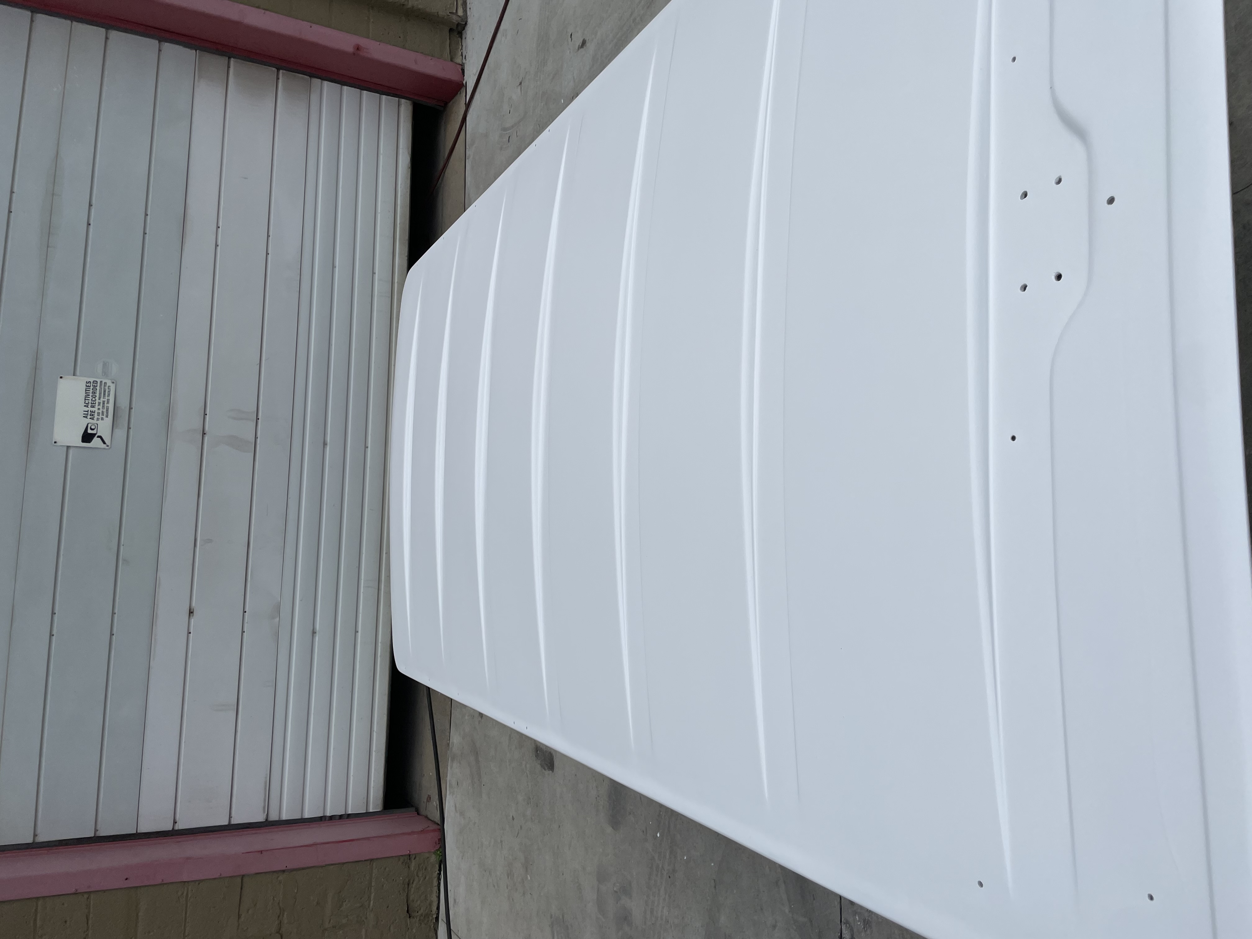

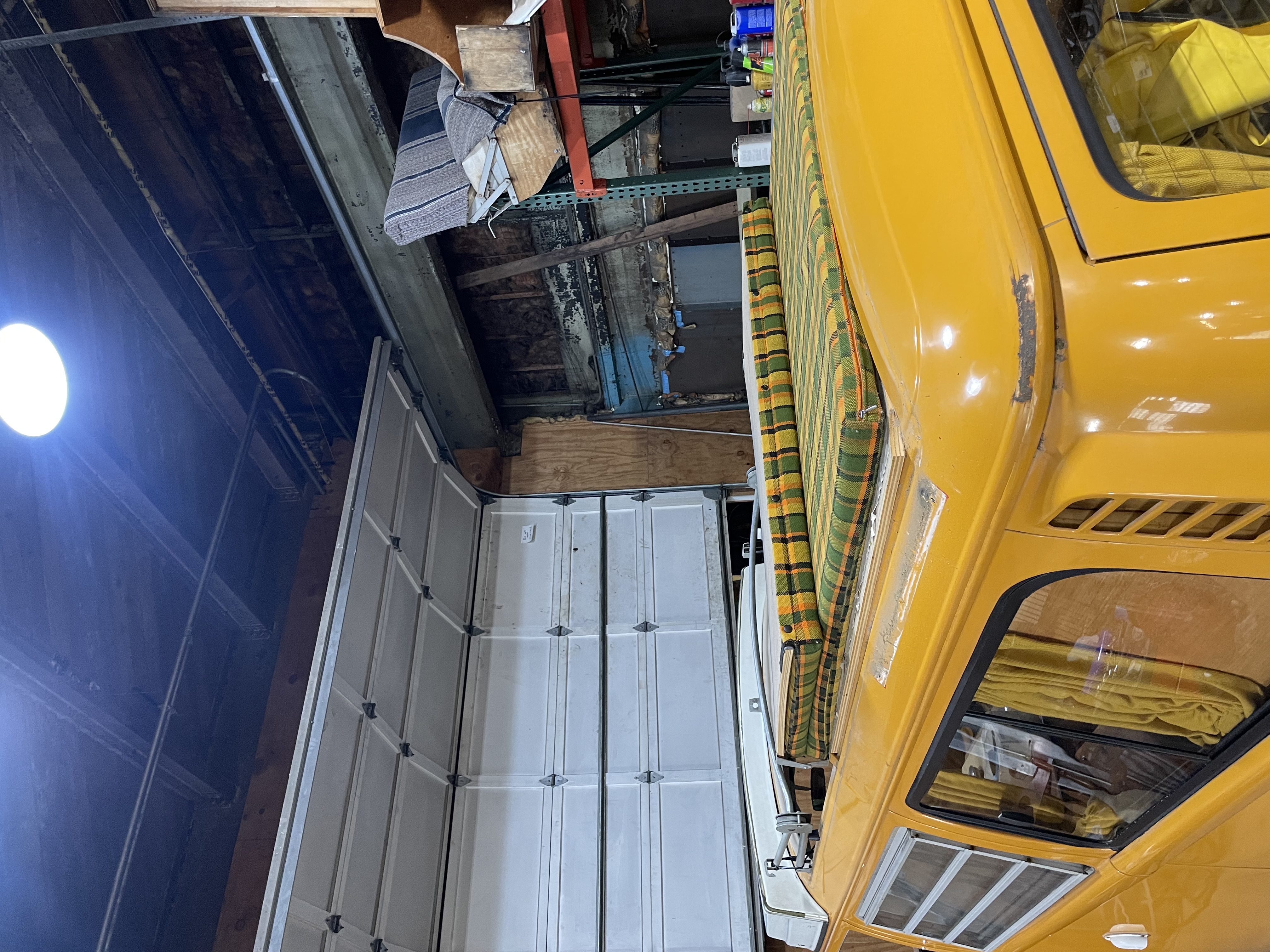

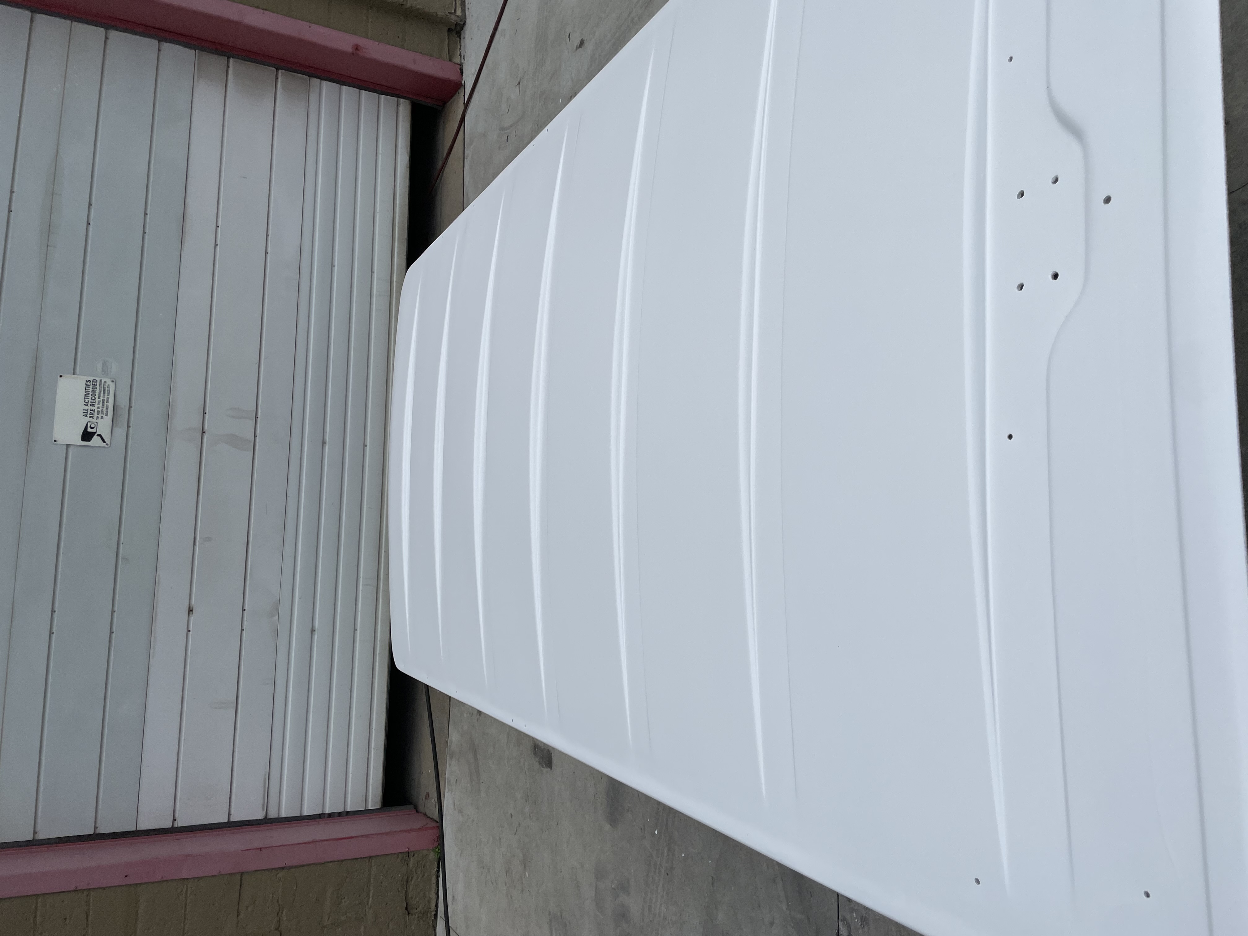

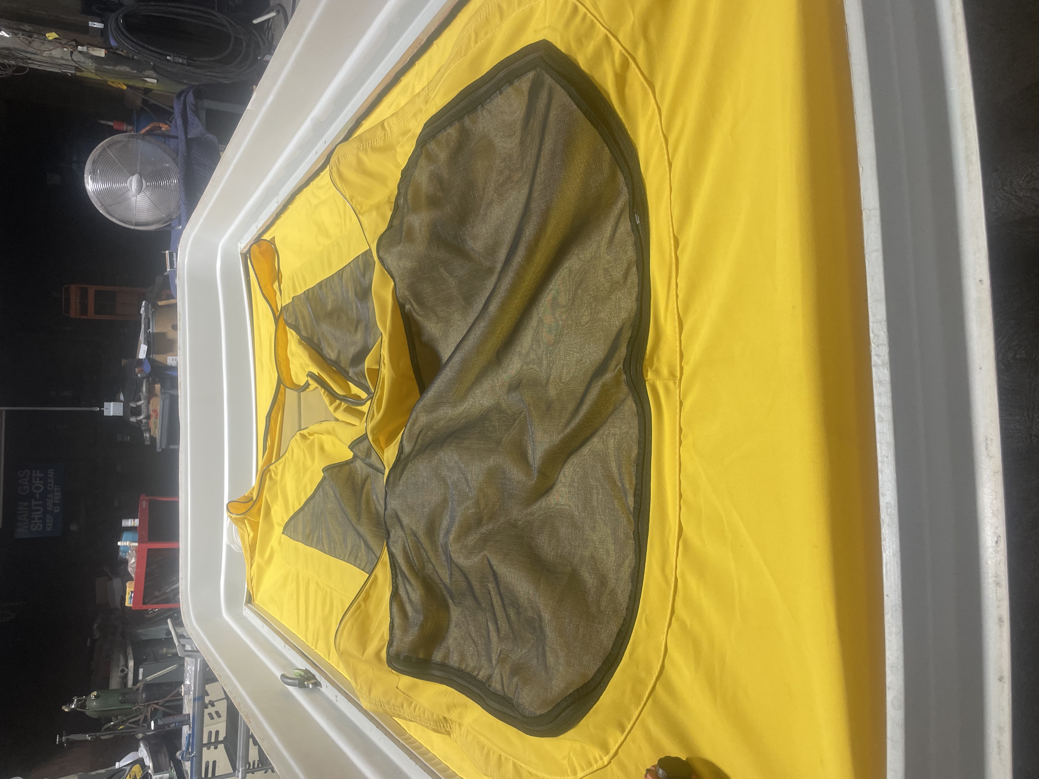

Finally wrapped this pop top project up! This was alot of work… a big Thank you to Chuck-hole for some painting support. And thanks to Bill Webner for some insider info too. I bought Pettit brand fiberglass primer and paint for this project from a boat store. Rolled on the sandable primer and sanded smooth. The primer really soaked in and 2 good coats were needed. Top coats were sprayed on with Chuck’s help.
Then the reassembly started. The canvas replacement went 1/2 right and 1/2 wrong. New canvas matched up nicely to old. I stapled in the new canvas in the same spots as the old one was. But, I didn't take into account that the old canvas was stretchy cotton and then new canvas was a stronger stiffer synthetic material. So I ended up having to pull staples towards the short sided rear and give myself every millimeter of fabric at the bottom.
I still need to put the westy decals on but overall I’m happy.

Final coat of paint
Final coat of paint

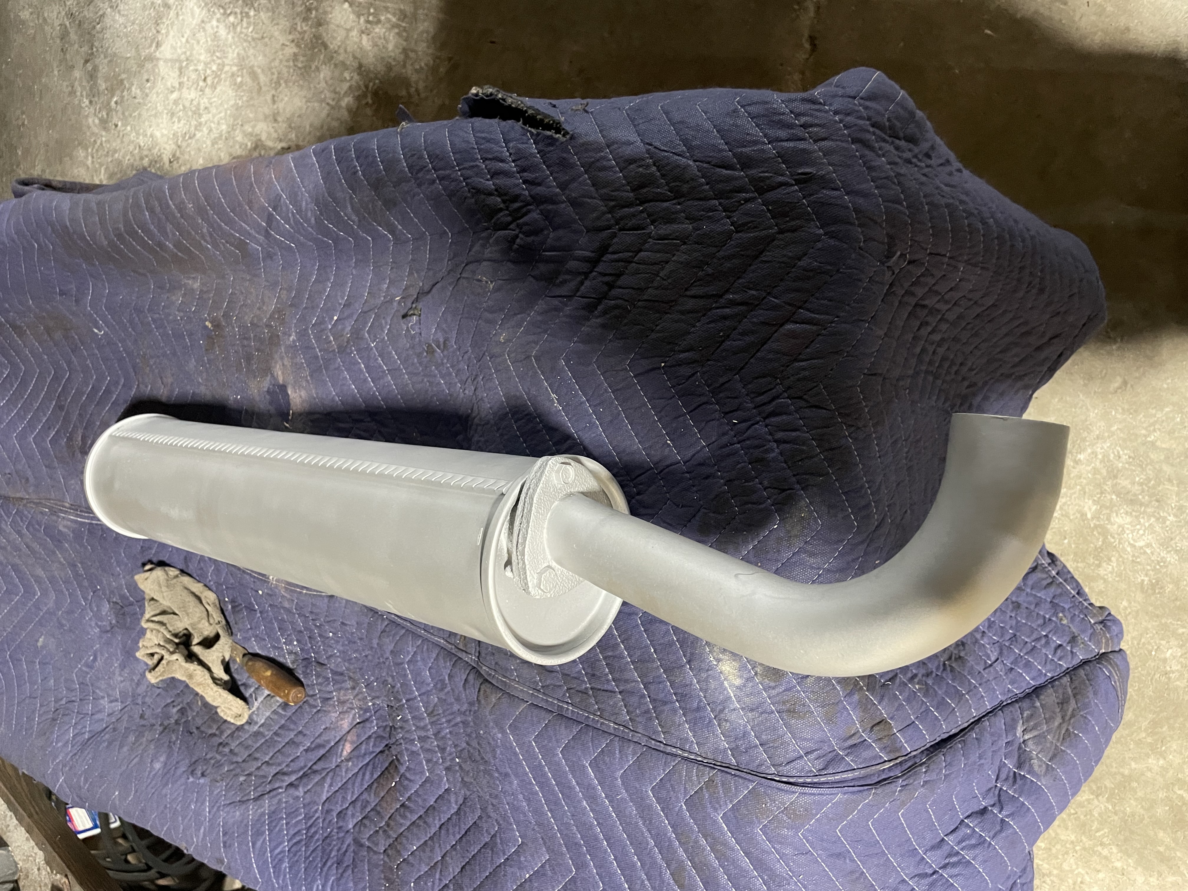

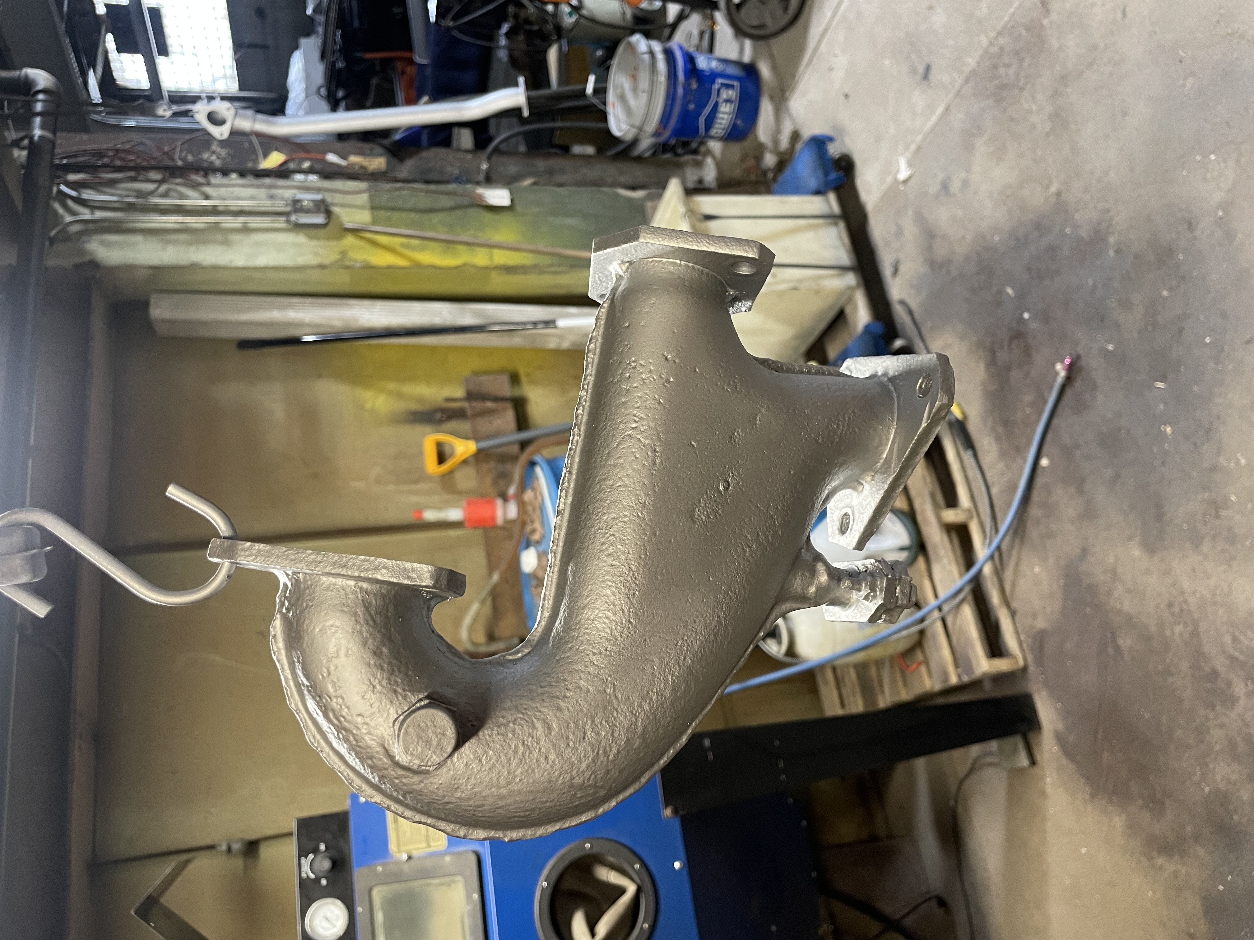

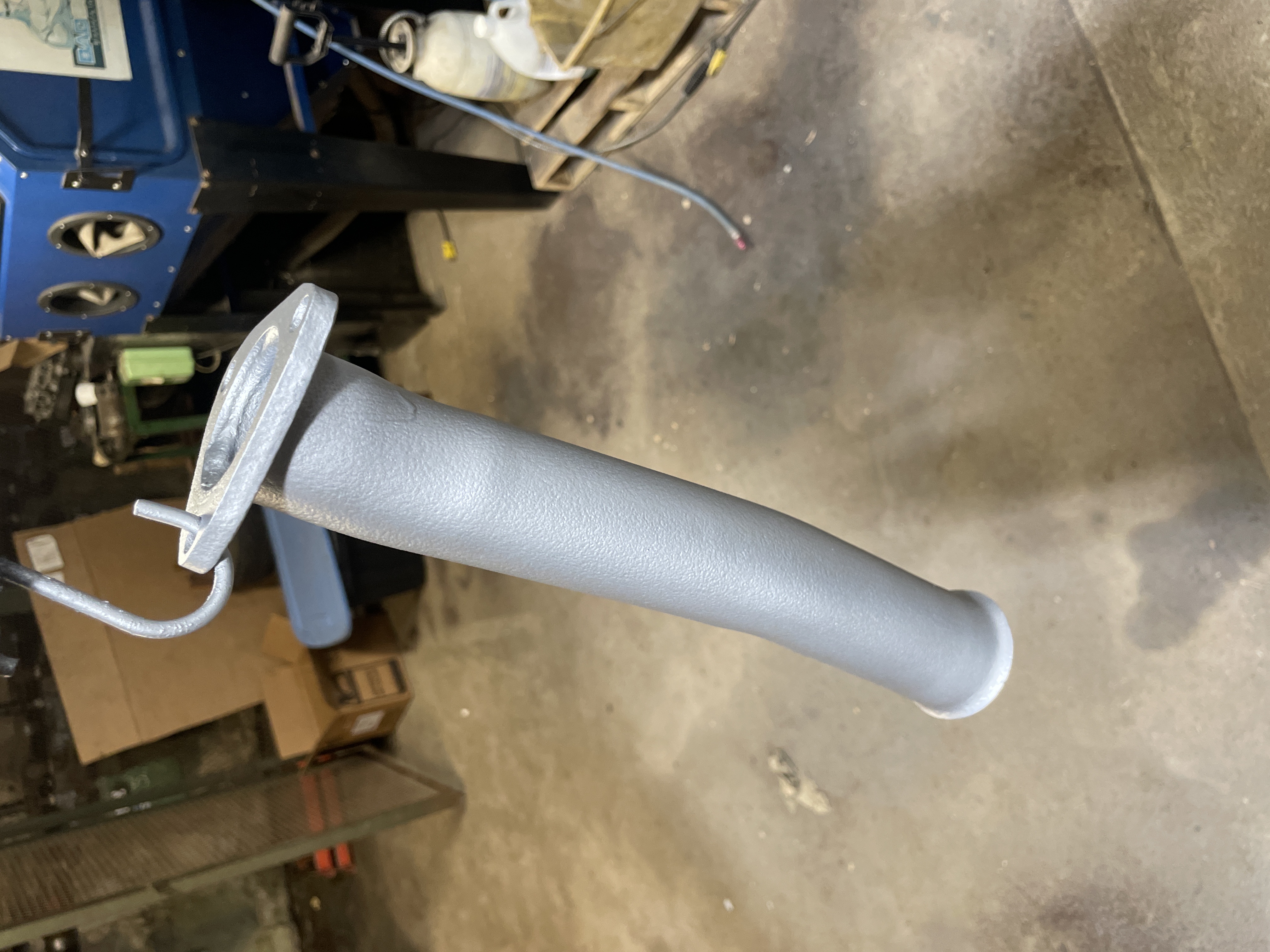

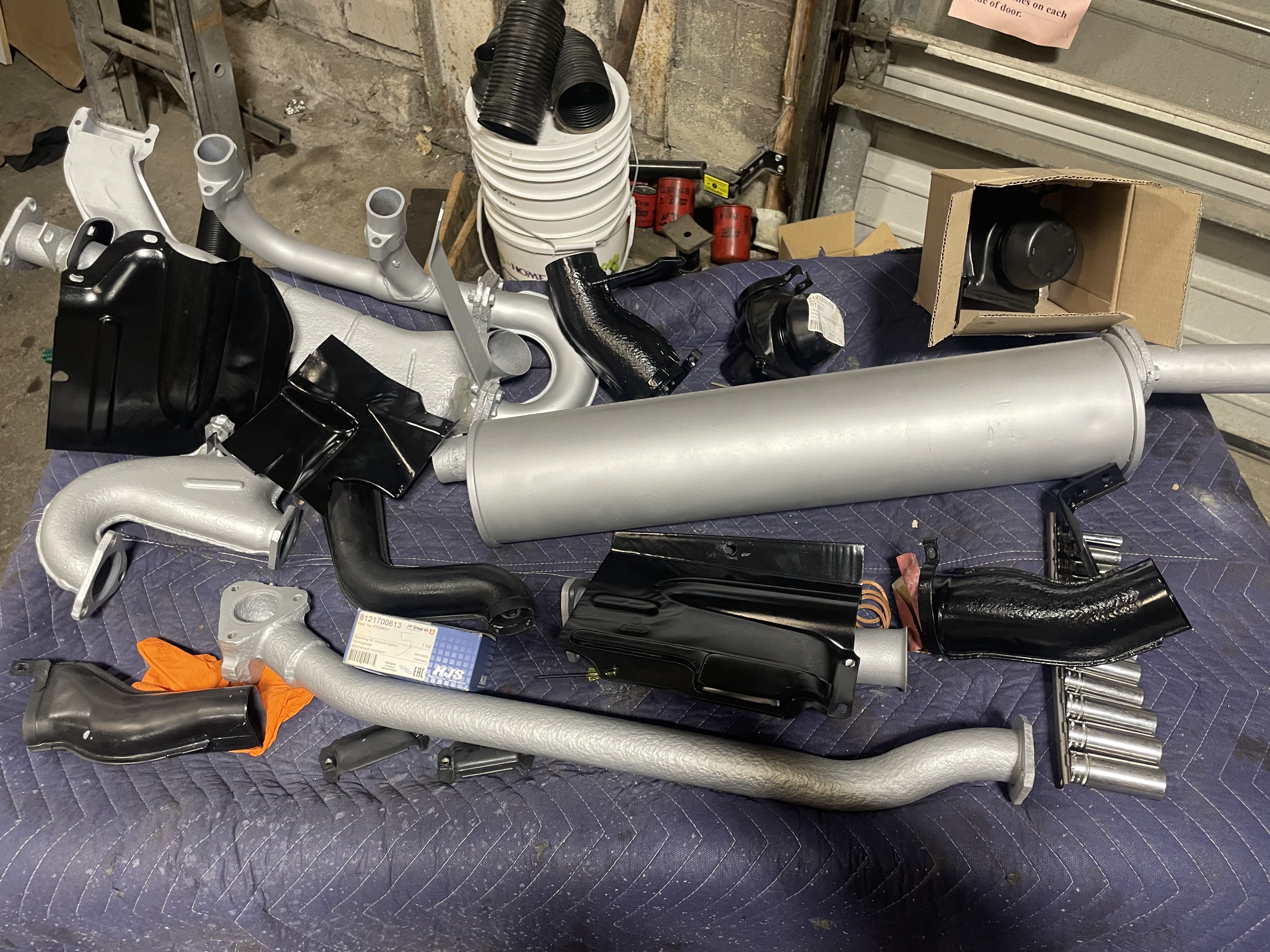

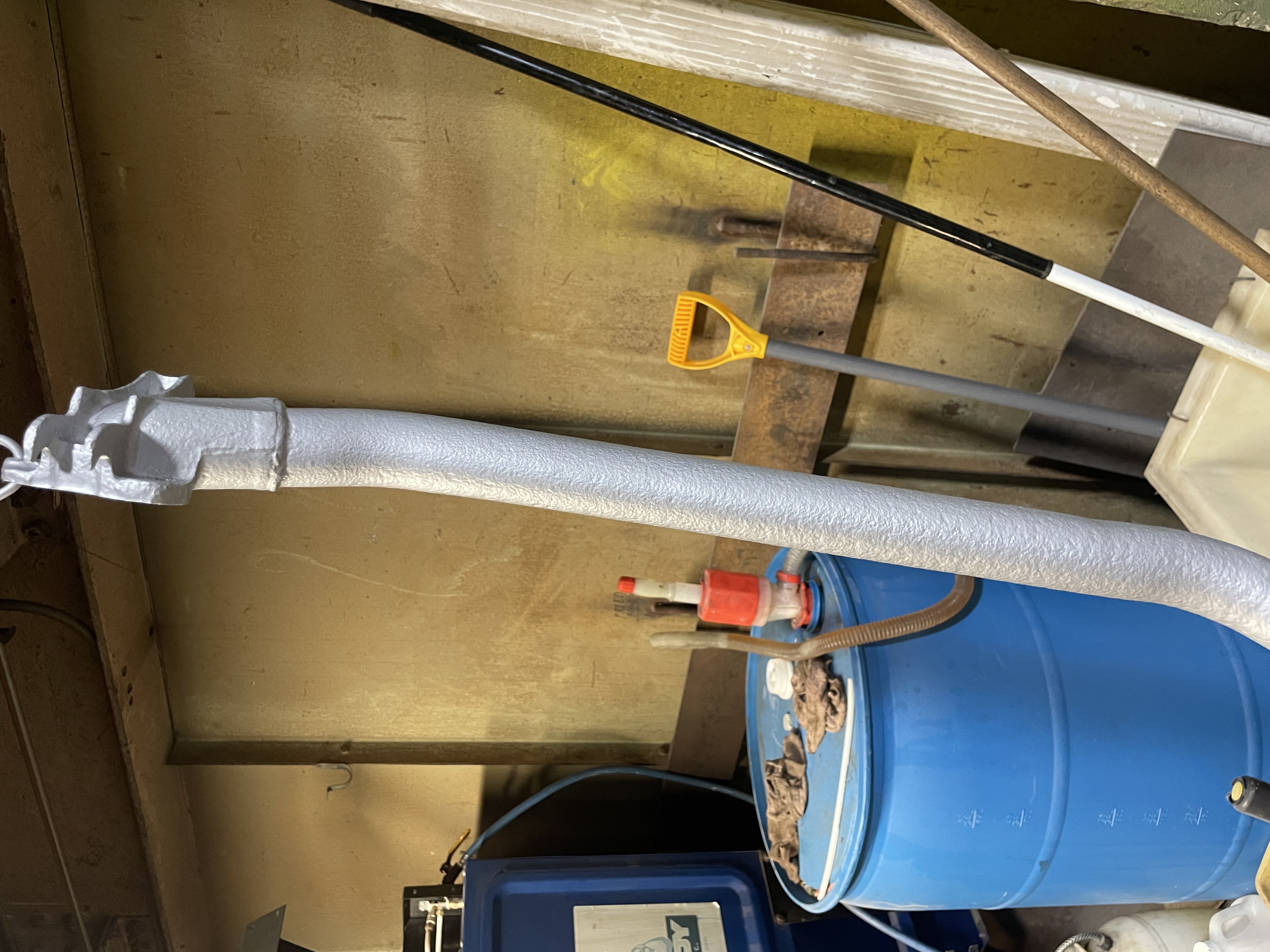

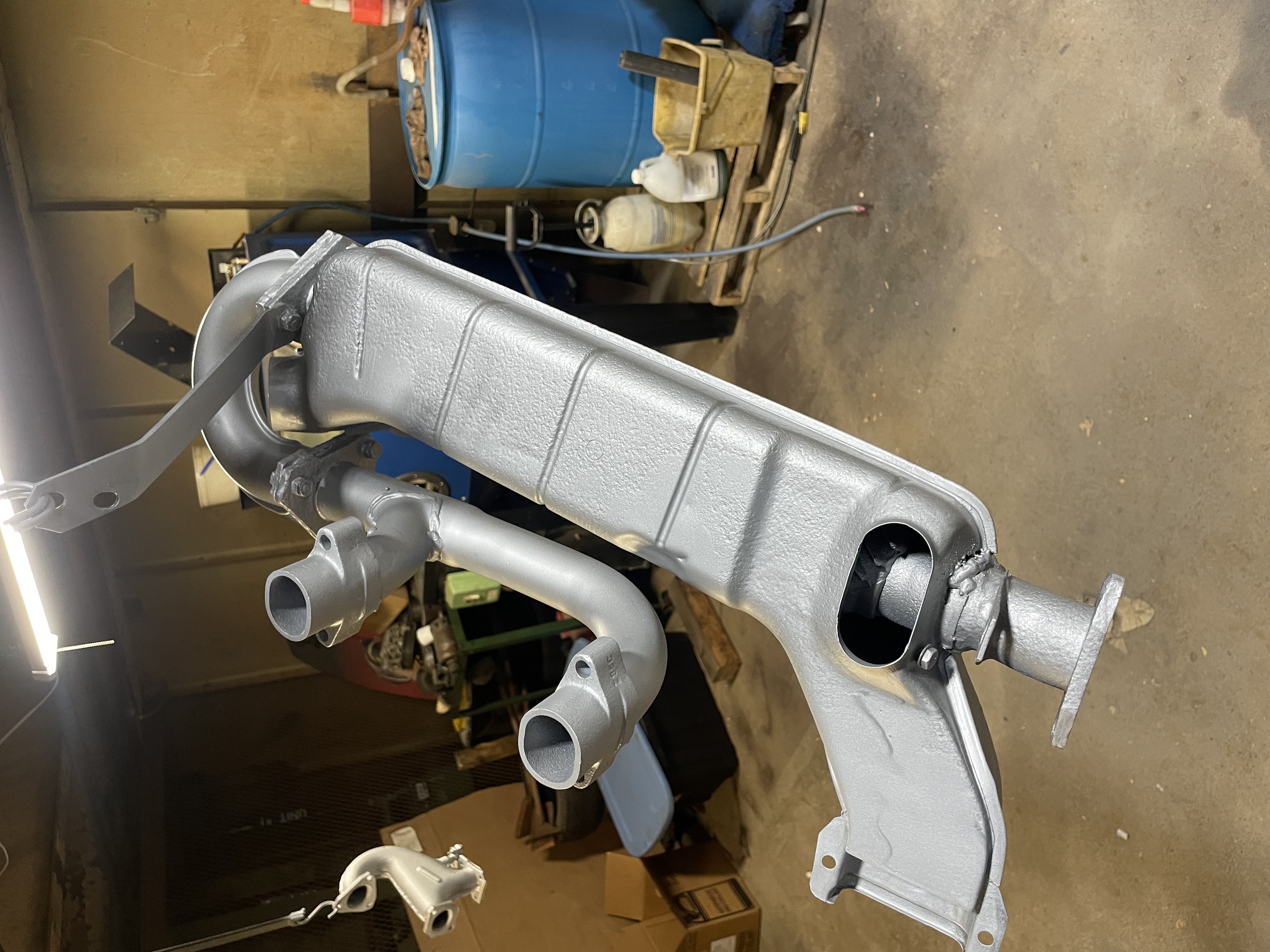

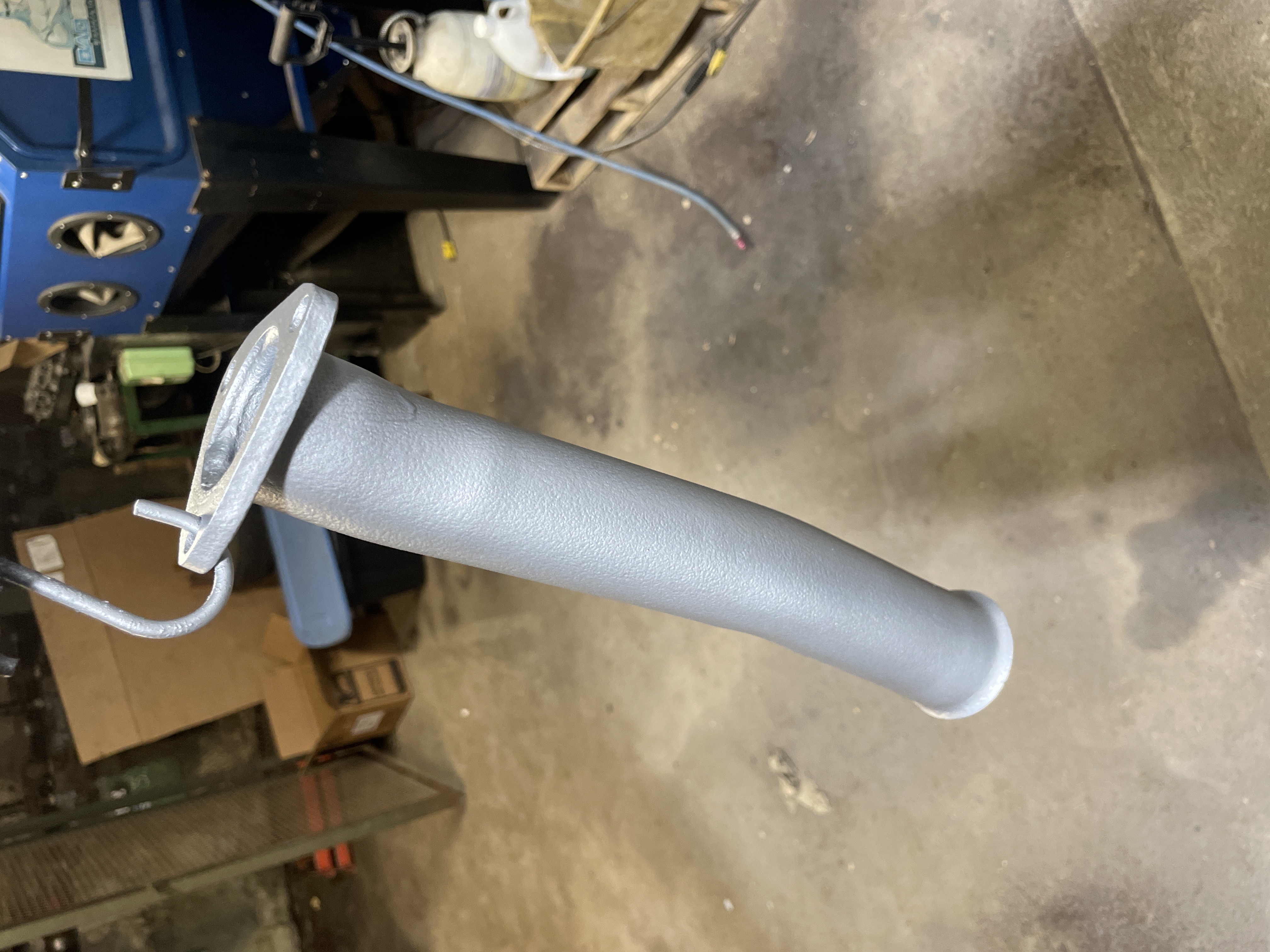

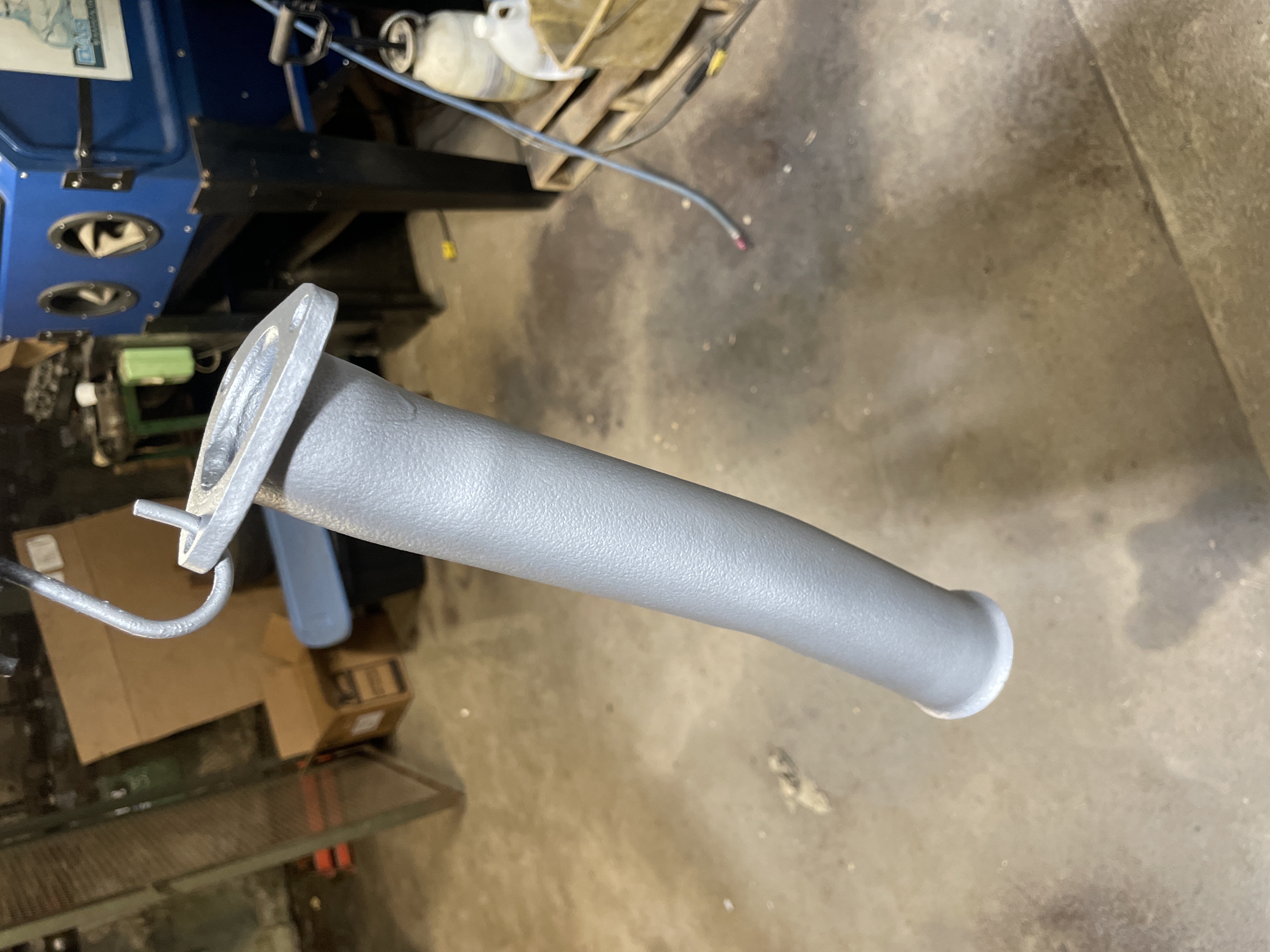

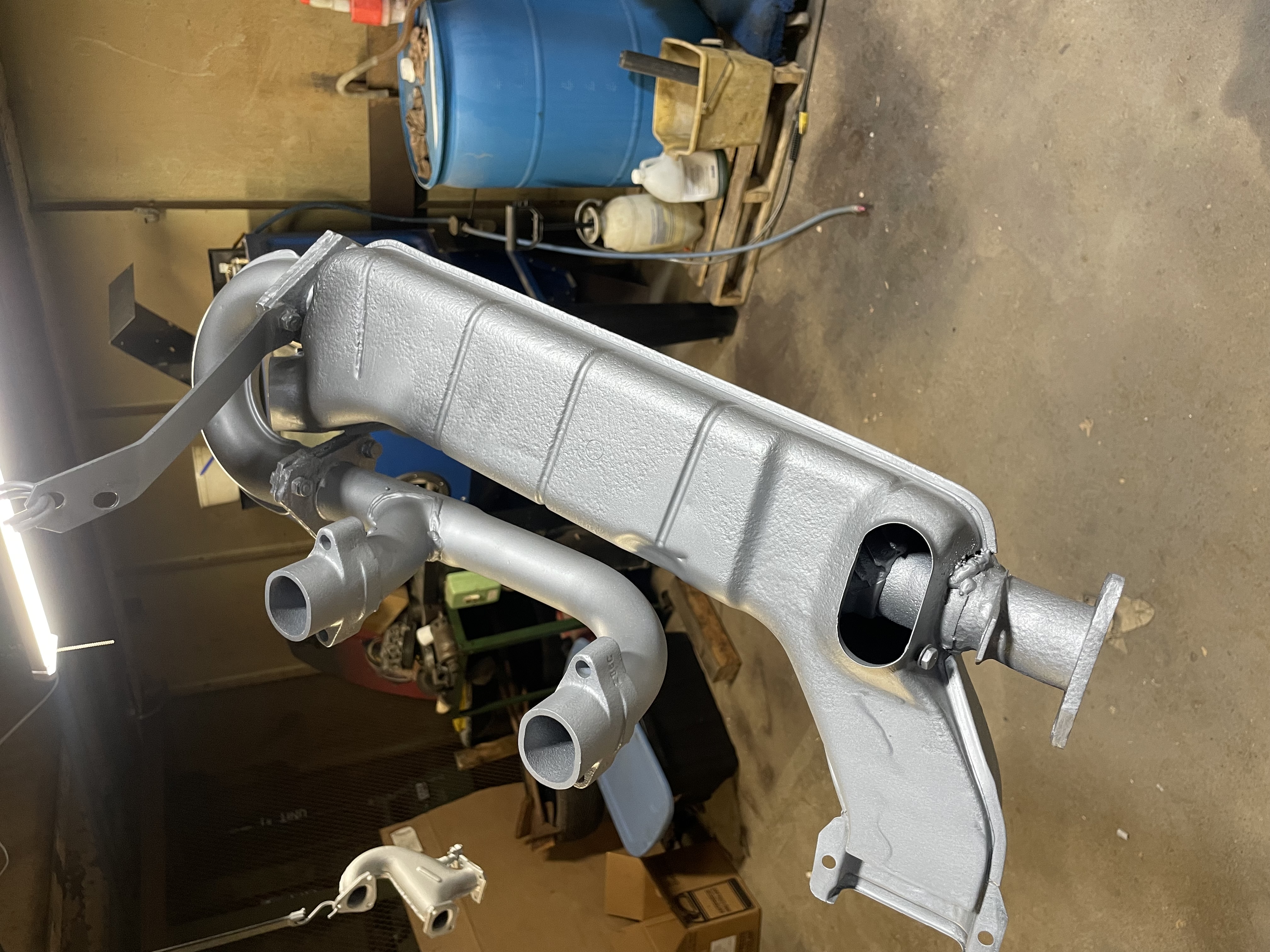

One of the next project in the pipeline is reinstalling a stock exhaust and hooking the heat back up. Currently there are some possibly custom made heater box delete pipes. A local $2 bill wielding friend had some correct N/A Late bay exhaust parts. I have been sandblasting and painting them up. I also ordered some gaskets and a few other things from Leakoil member Mick at Crooked River Auto Parts. Give Mick a call for parts. He has great prices and was able to track down a few odd ball parts for me.
Catalytic delete pipe goes between “Y” pipe and muffler
Late bay muffler
Late bay muffler
Orginal VW heater box with N/A “F” pipe header
“Y” pipe collector
“Y” pipe collector
N/A crossover pipe from 1-2 bank to 3-4 “Y” pip collector

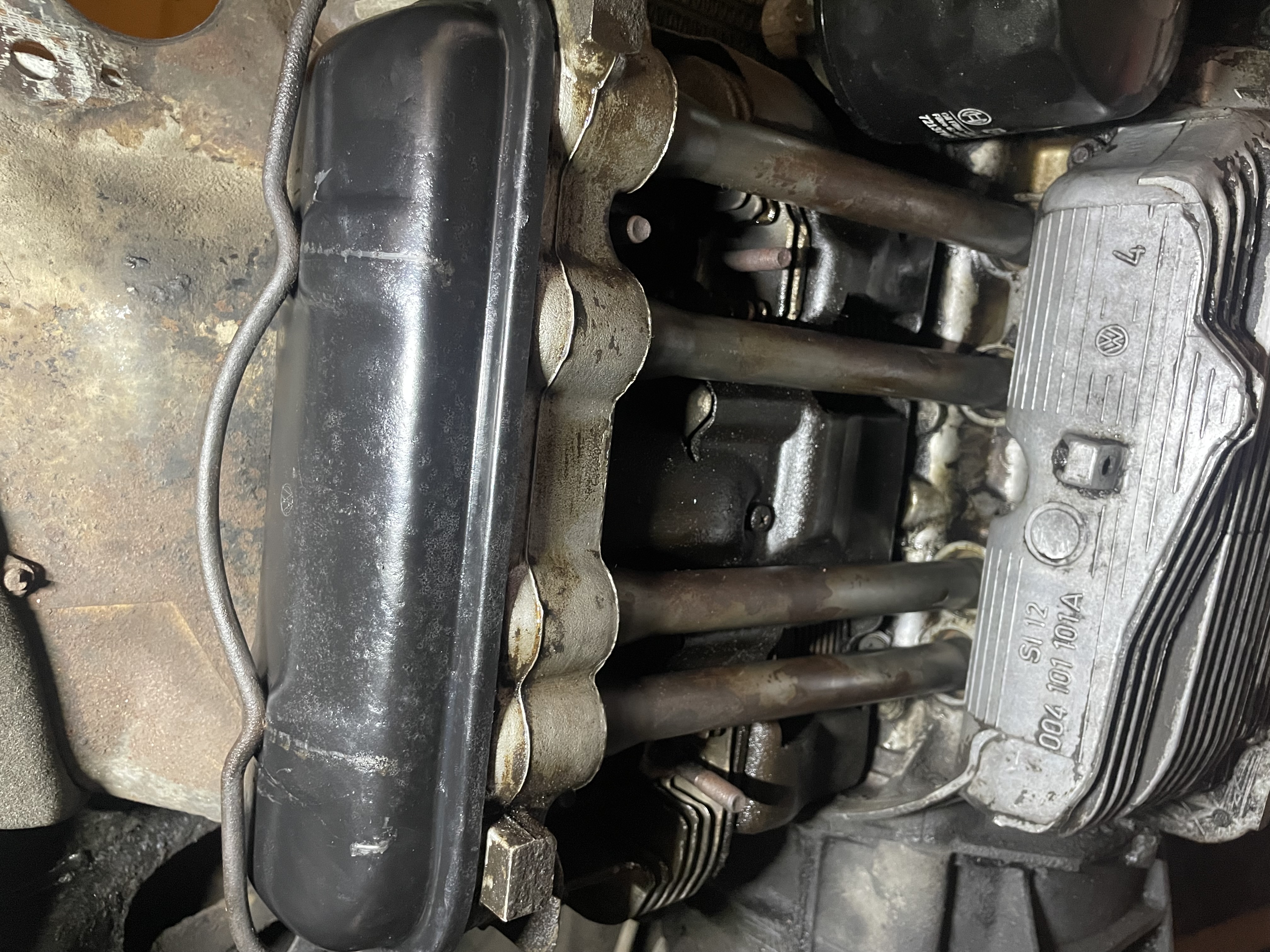

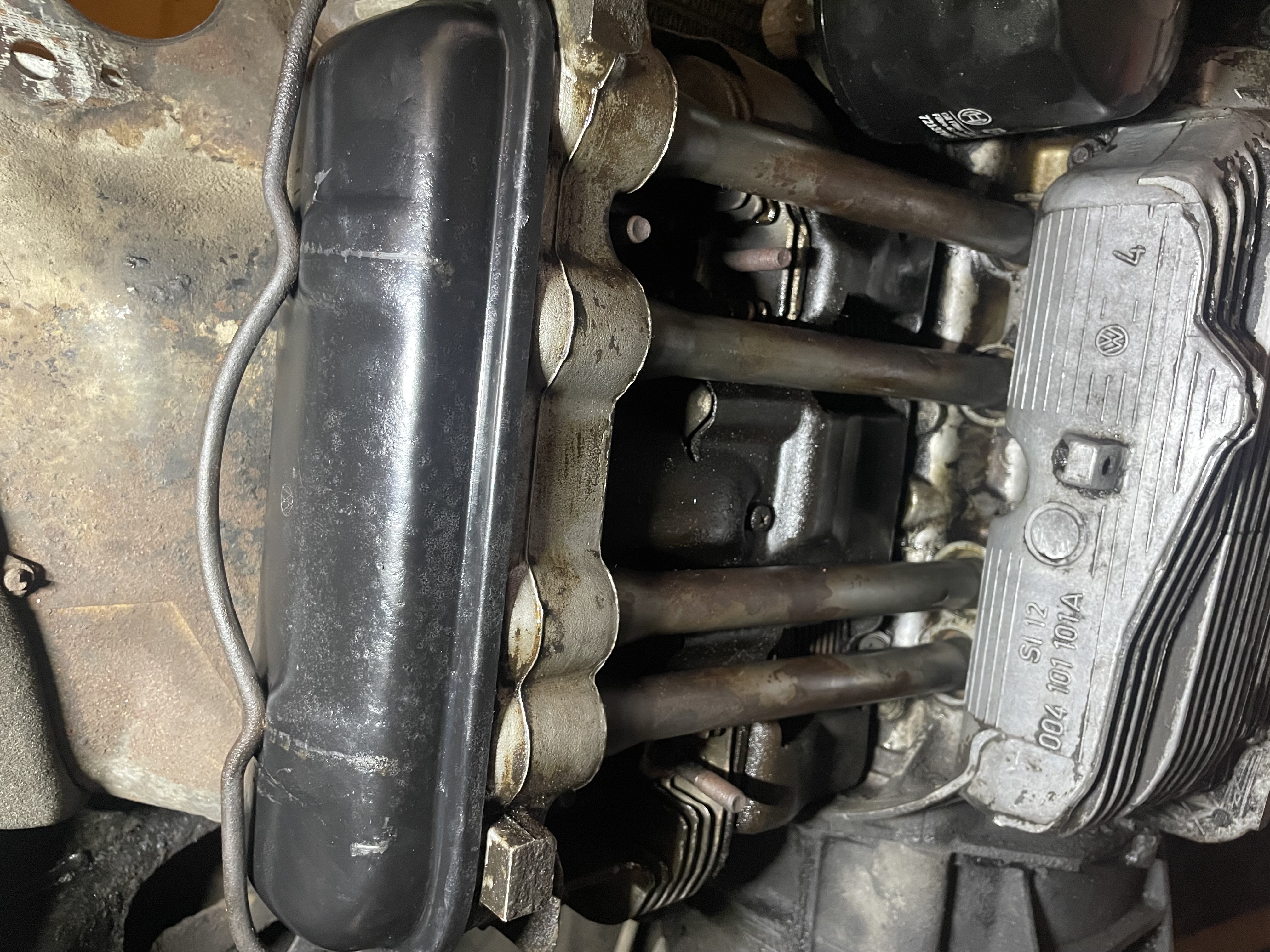

Hi, more projects are in the works. Pulled the exhaust off and prepping to install stock heater boxes and muffler. Quite a few small oil leaks needed to be addressed underneath. Ended up pulling pushrod tubes and replacing old crusty o-rings. Refreshed valve covers with sandblasting, paint, and new gaskets. Pulling “taco” sump plate and installing new o-ring. New crank fan pulley seal as well.
Sandblasted and painted lower sled engine tins along with heater pipes.

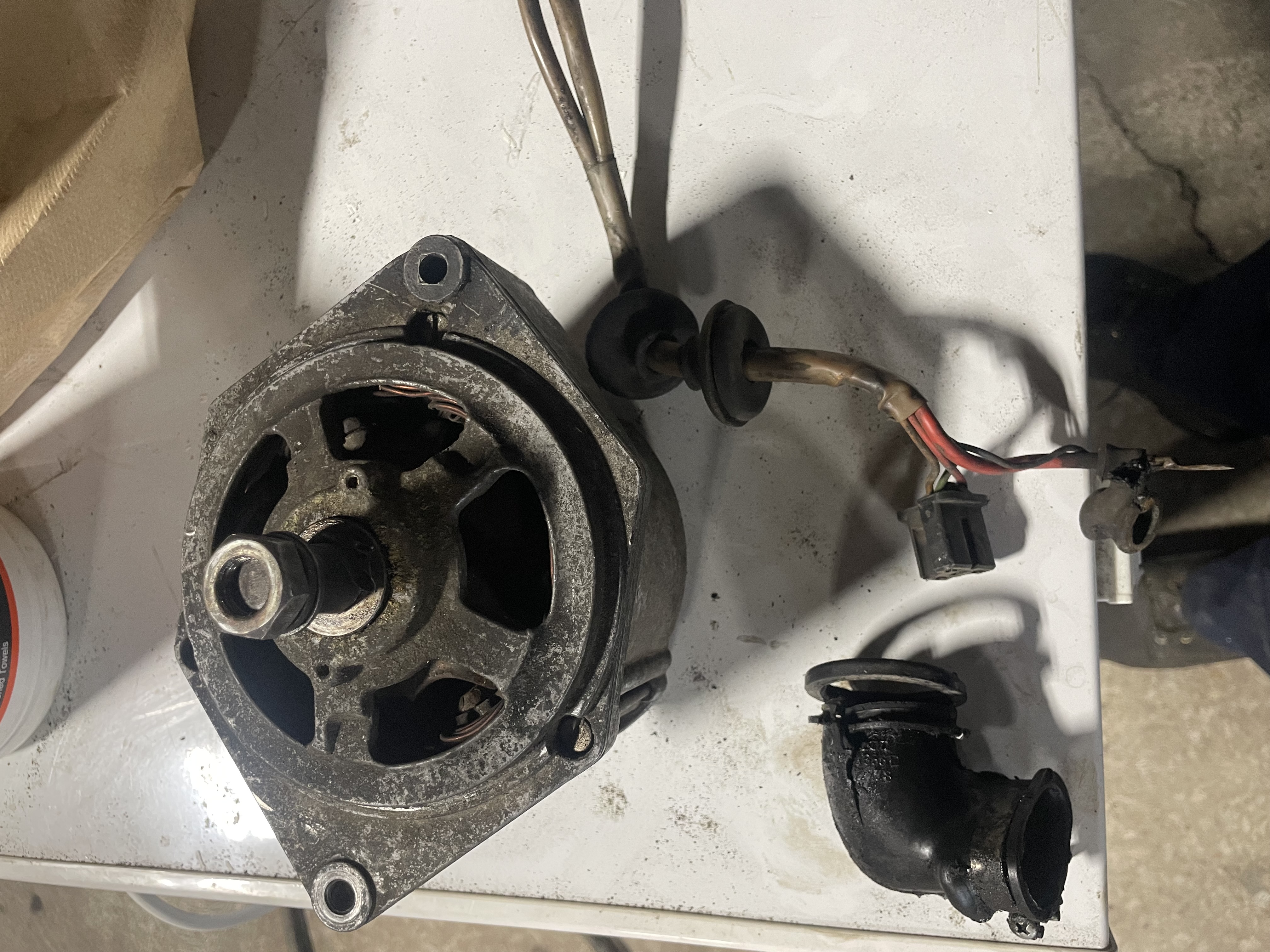

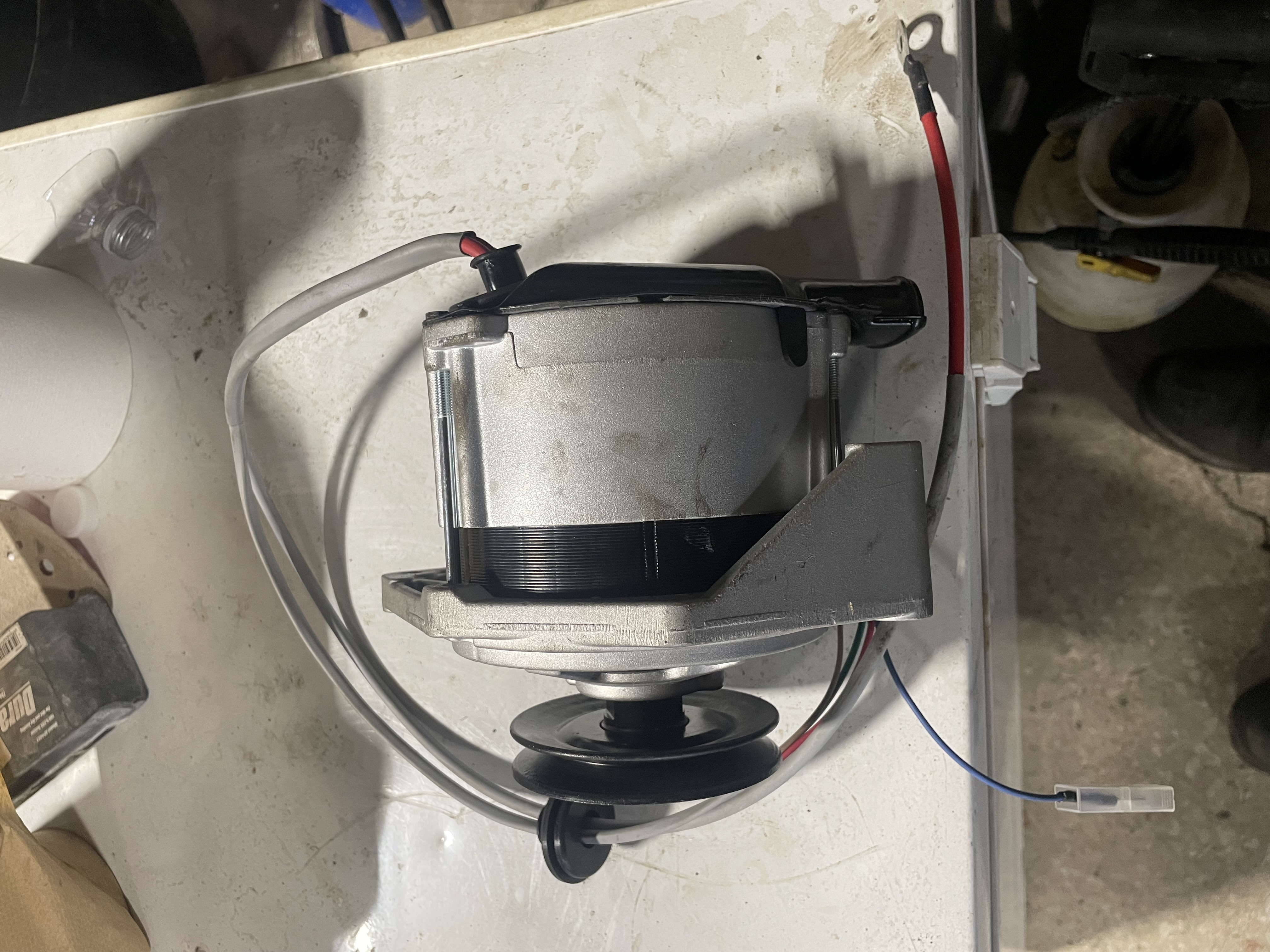

Removed old 55amp alternator and replaced with new 70 amp unit, new alternator harness, and regulator from Busdepot.com. Bigger output alternator will facilitate future installation of camping battery. More pictures and updates soon.
Cleaned and resealed pushrod tubes

New and shiny
New and shiny
Old 55 amp alternator, harness, and cooling boot
