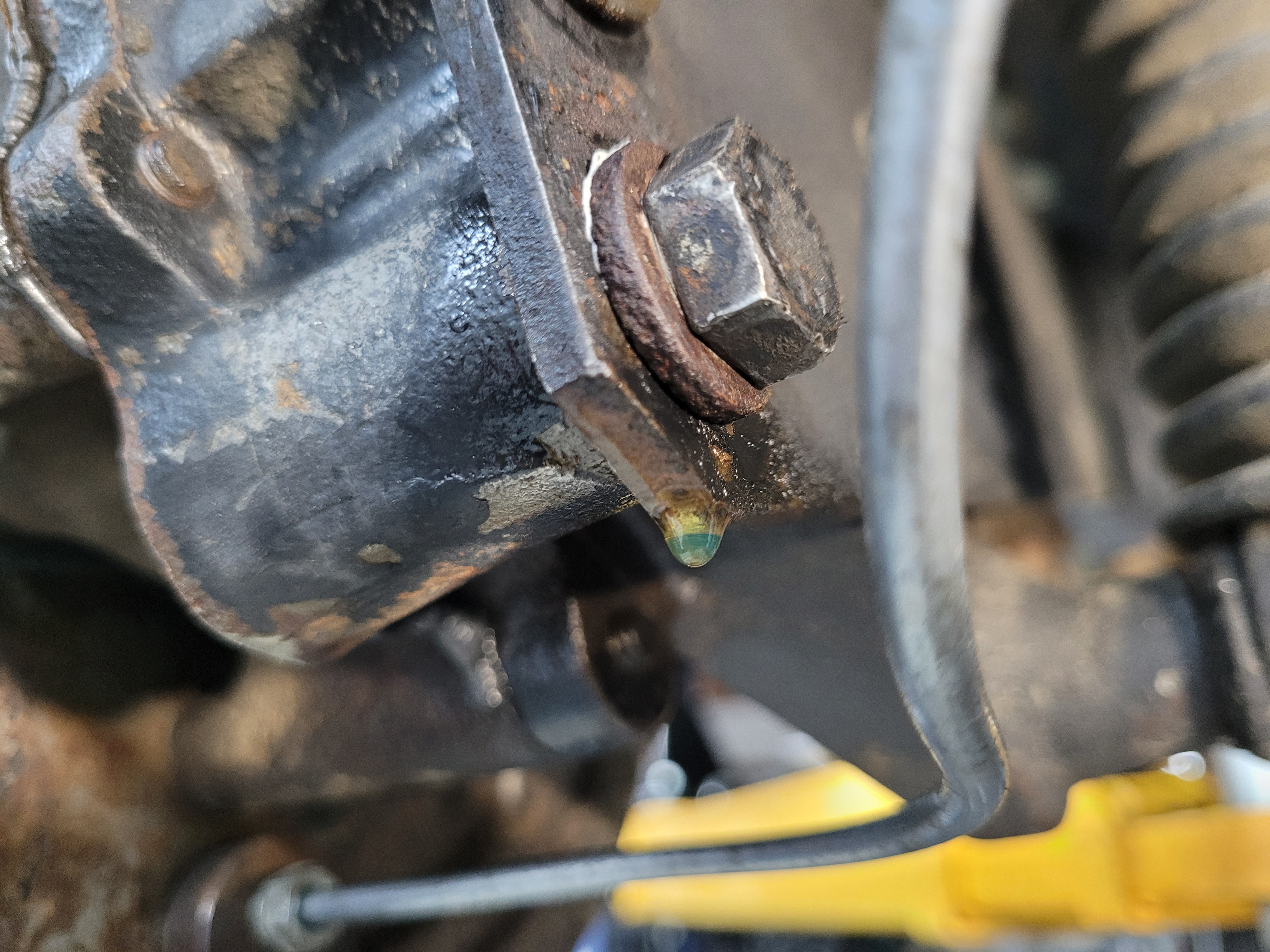

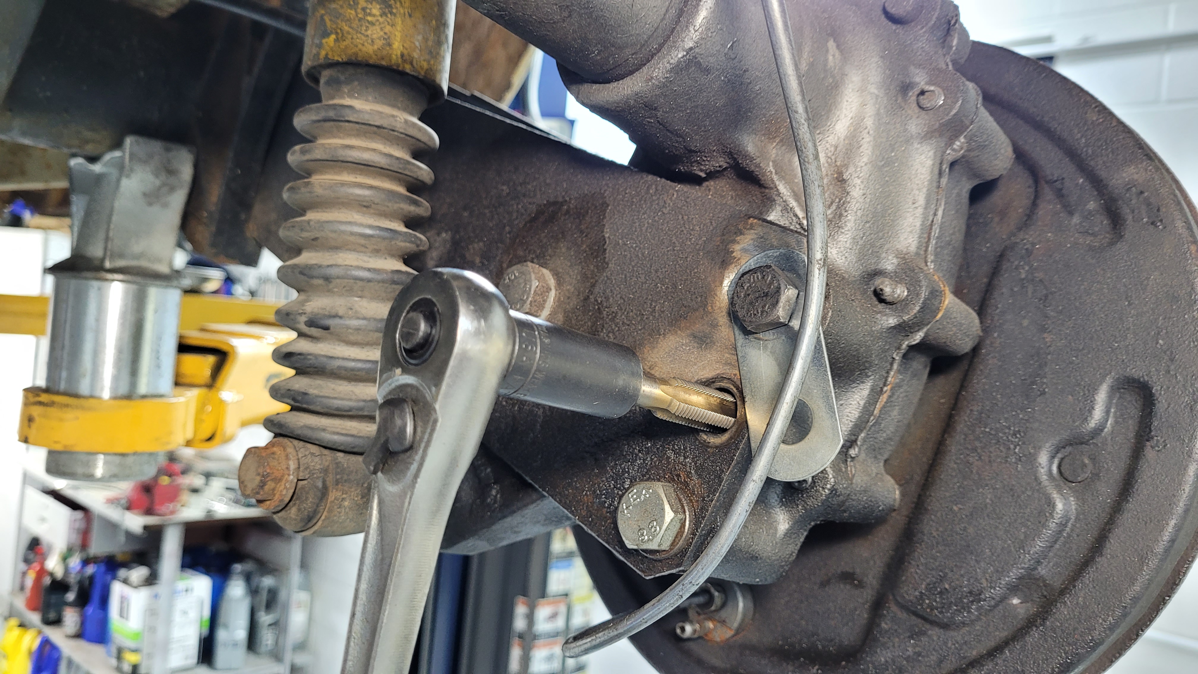

The left RGB was leaking pretty badly- leaving a 4-6" puddle when parked, it was the big freeze plug for accessing the inner wheel bearing that was leaking.

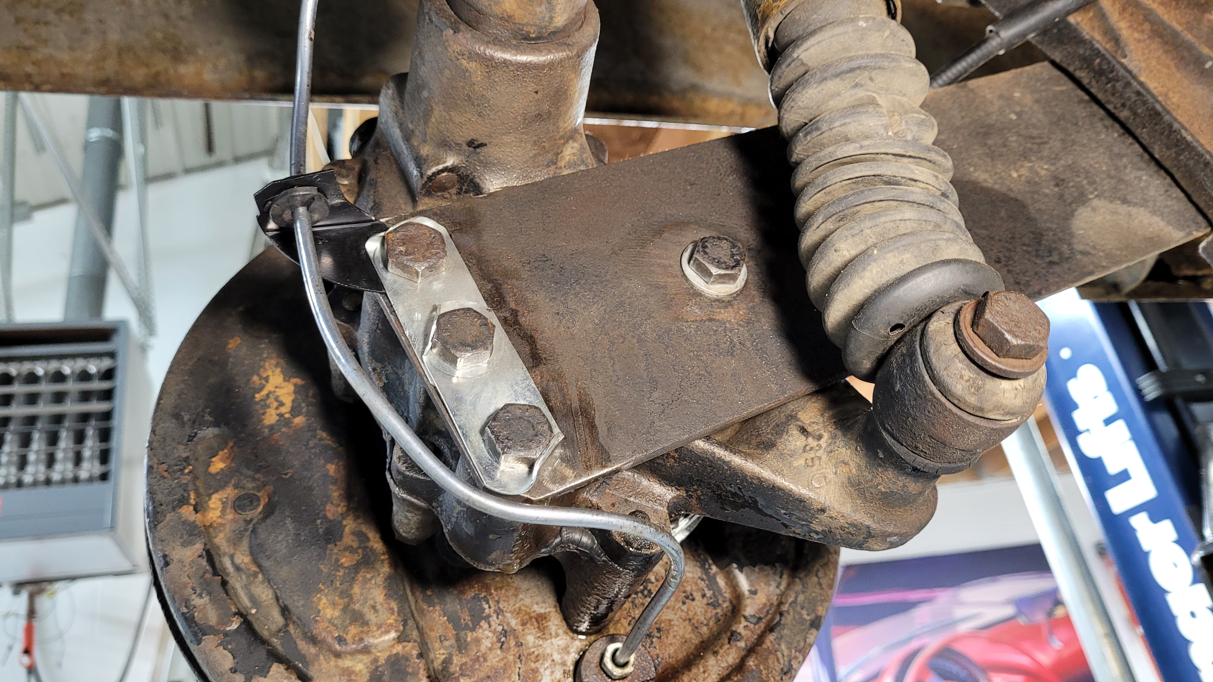

The brake line retainer brackets and grommets are missing, which will cause stress cracking of the brake lines over time.

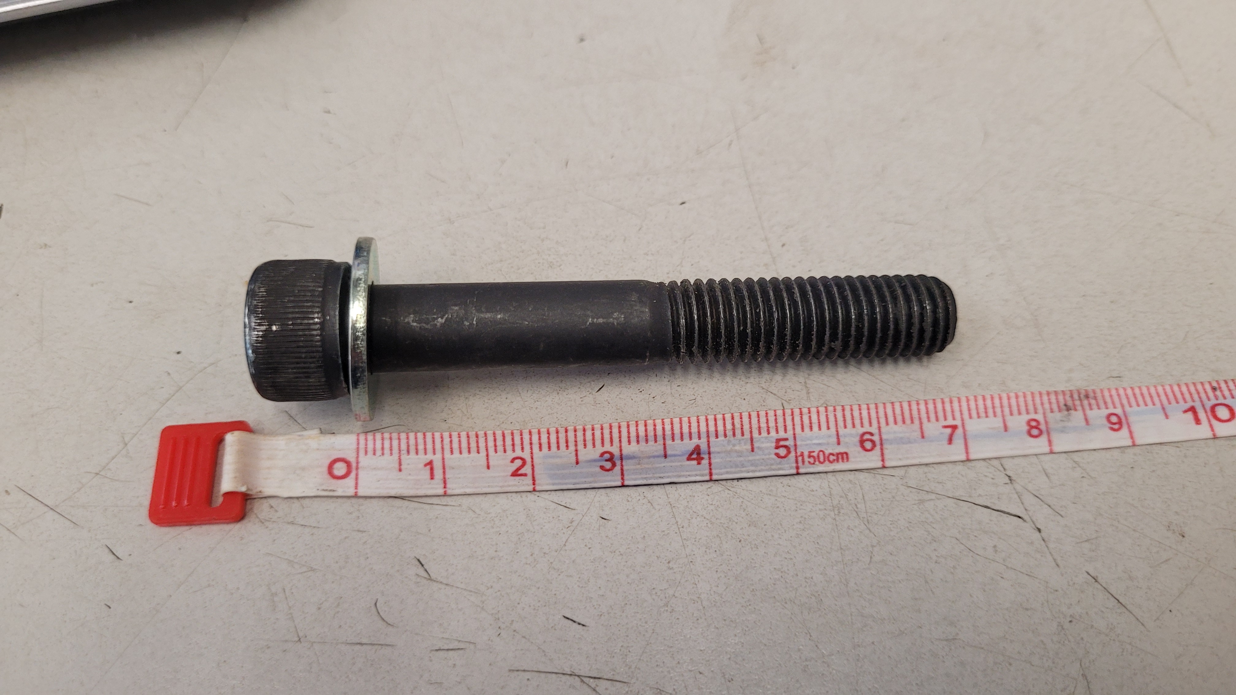

They used one bolt that was too long, probably bottoming in the RGB without clamping the spring plate.
They used one bolt that had trashed threads on it.

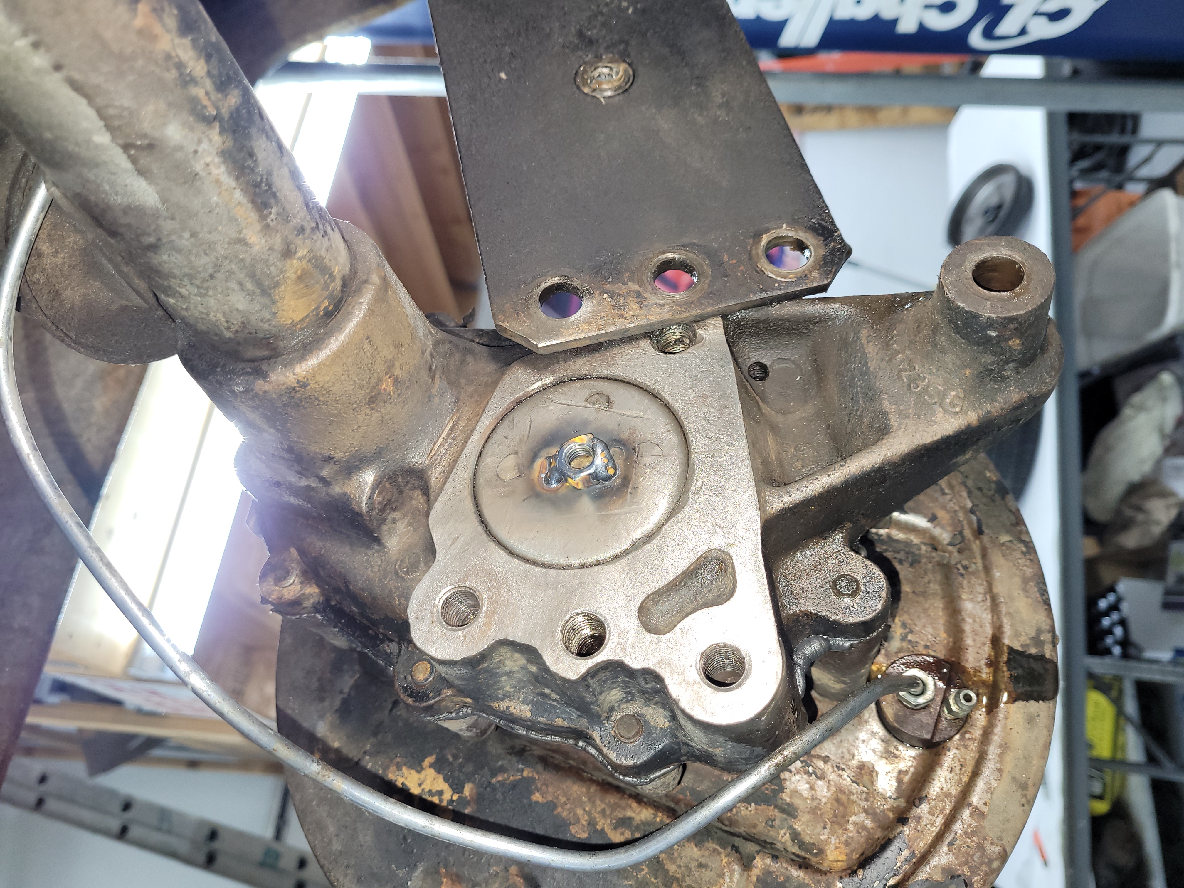

Remove drum, brake cable, and bolts.
Clean grunge from stuff so I can see what I'm working on.

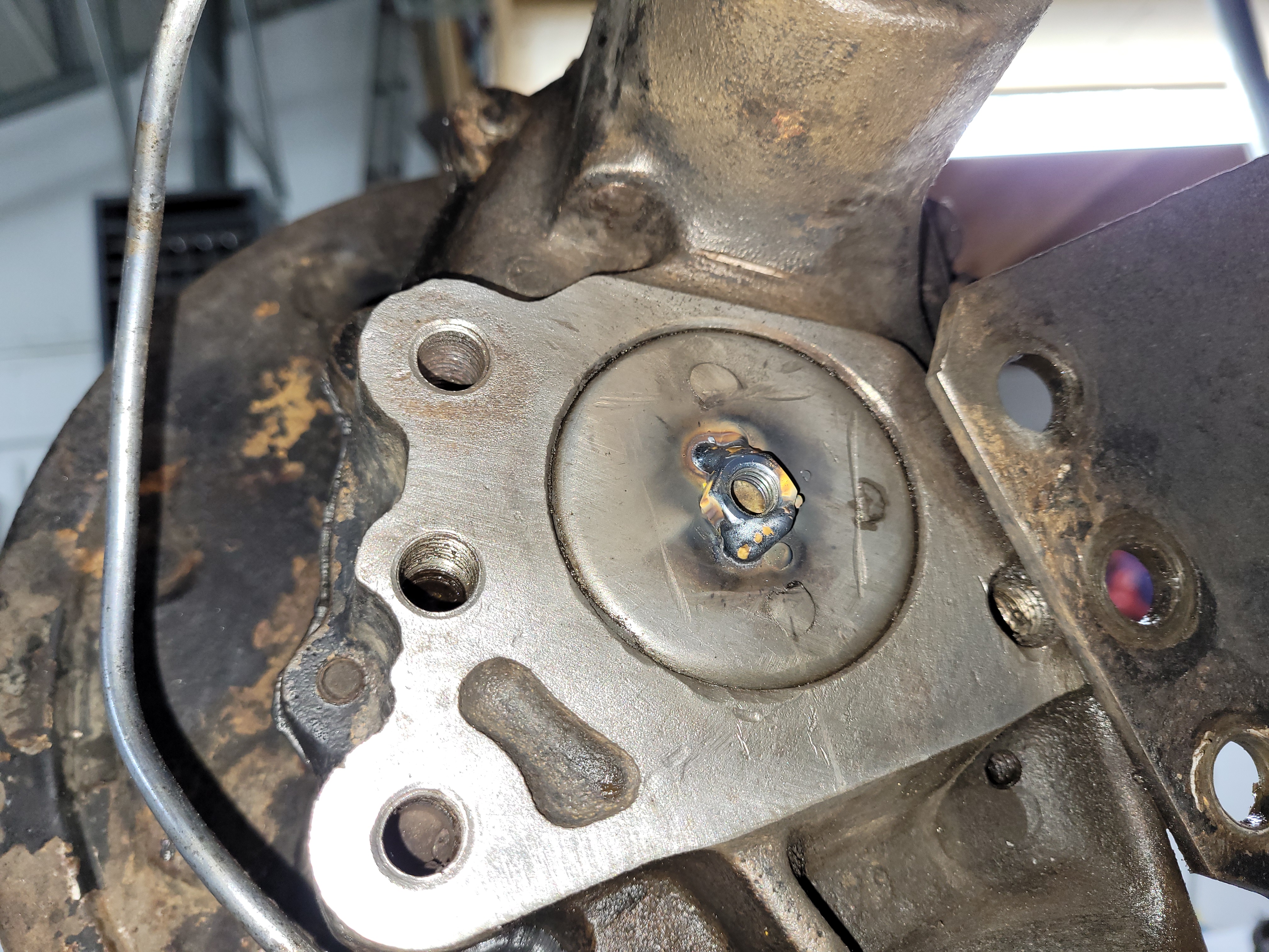

Weld nut to freeze plug.
Rig up some hillbilly tools to pull the plug from the RGB.
Cut the nut from the plug and grind clean.
Reseal with RTV and drive in flush.
Use a smear of RTV on the inside bore of the RGB, which the previous guy didn't do and that's why it leaked.
Clean all rust from mating surfaces.
Install brake line retainer and grommet.
I chased all of the threads, replaced the messed up bolts, and installed the lock tabs and correct wave washer on the front bolts. Install brake line retainers and grommets. All were torqued to spec, 80 ft-lb.

Brake lines had no grommets preventing rub-through where they passed through the bulkheads. I installed grommets and rubber hose for rub protection.

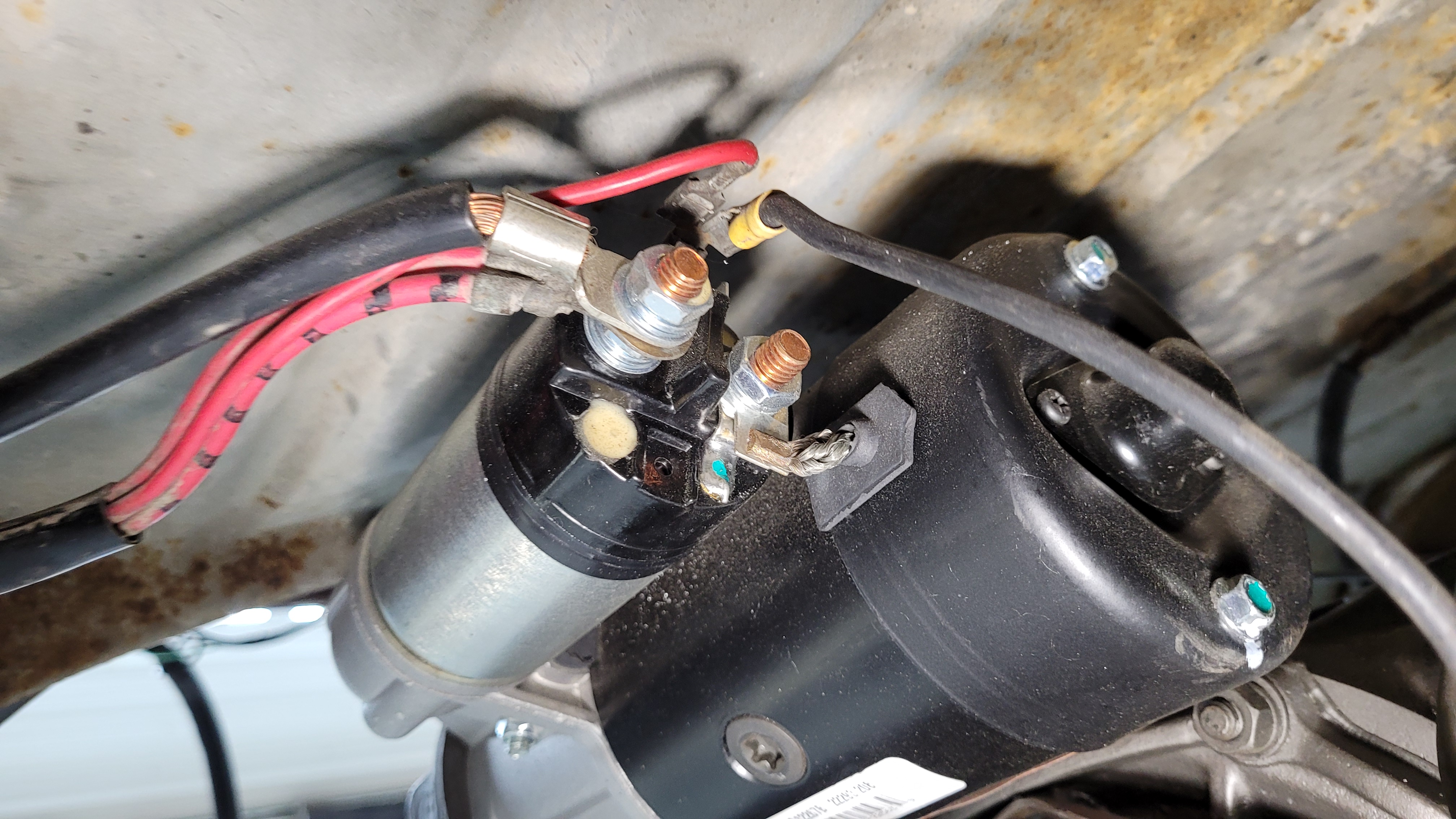

I don't know what's going on with this hillbilly wire on the starter trigger, but it's really crude and not protected. It's the starter trigger so it's only hot a few seconds a day, we'll take care of that another time.
