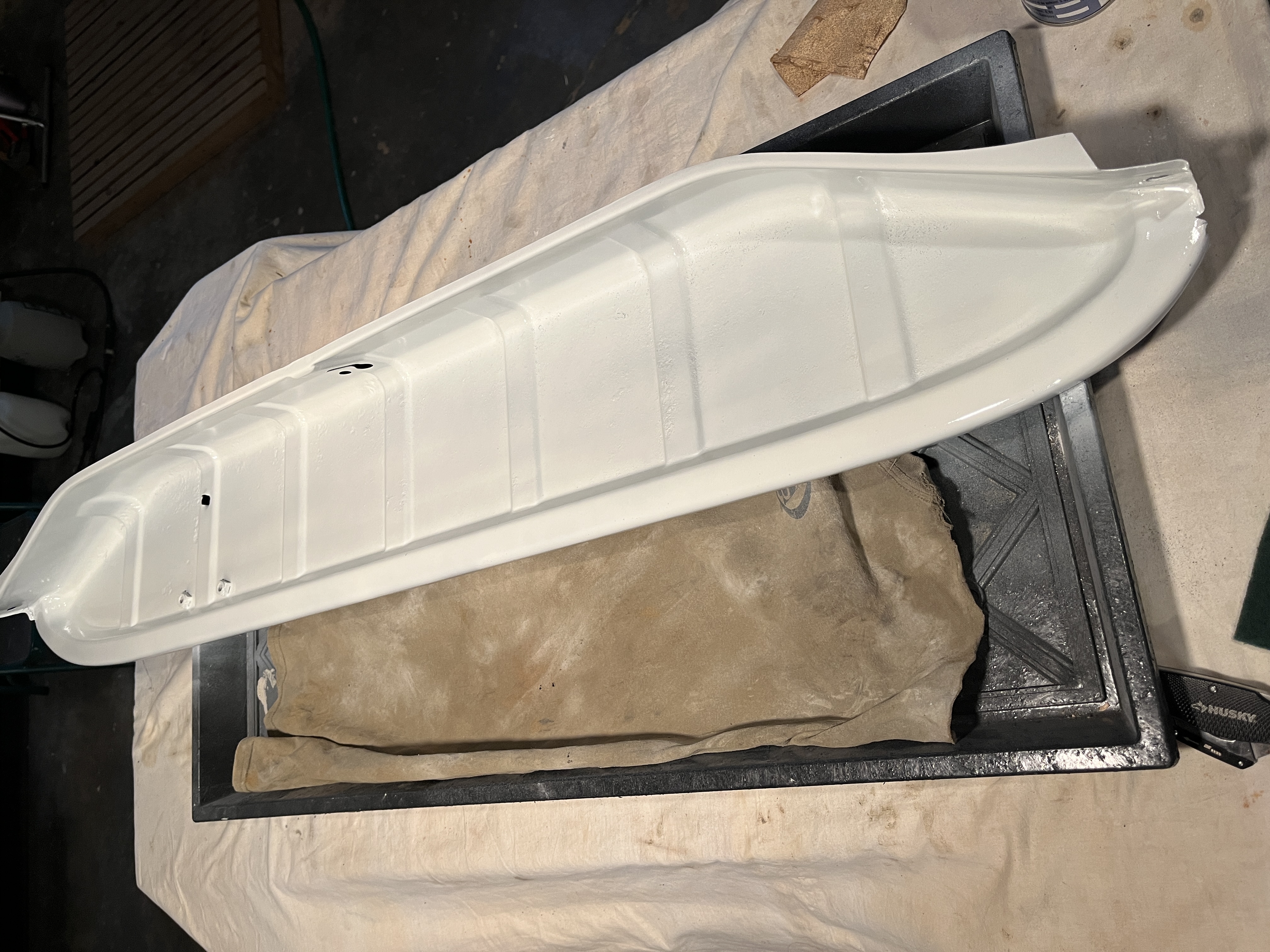

Got some work done on the truck.
Patched up the holes and rust in the window sills.
Cleaned, prepped and painted the parcel tray.

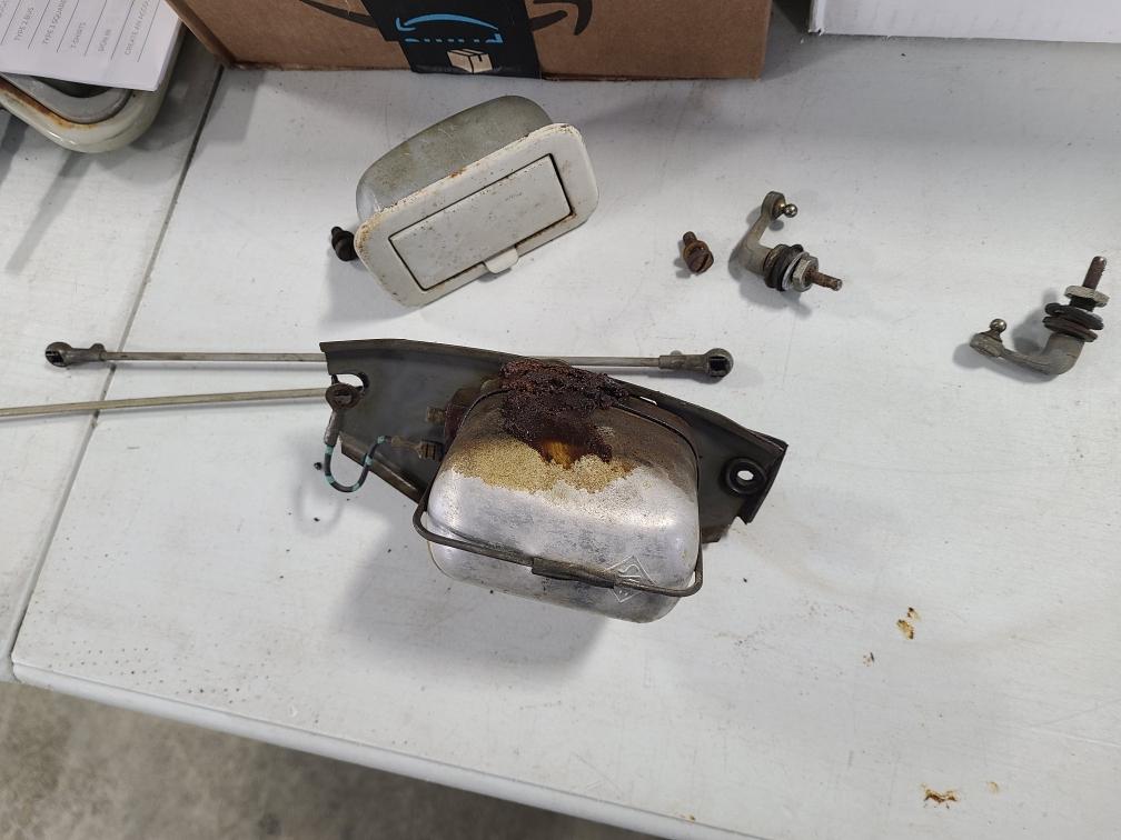

Upgraded the wiper motor to 12v and linked up the wiper stems.

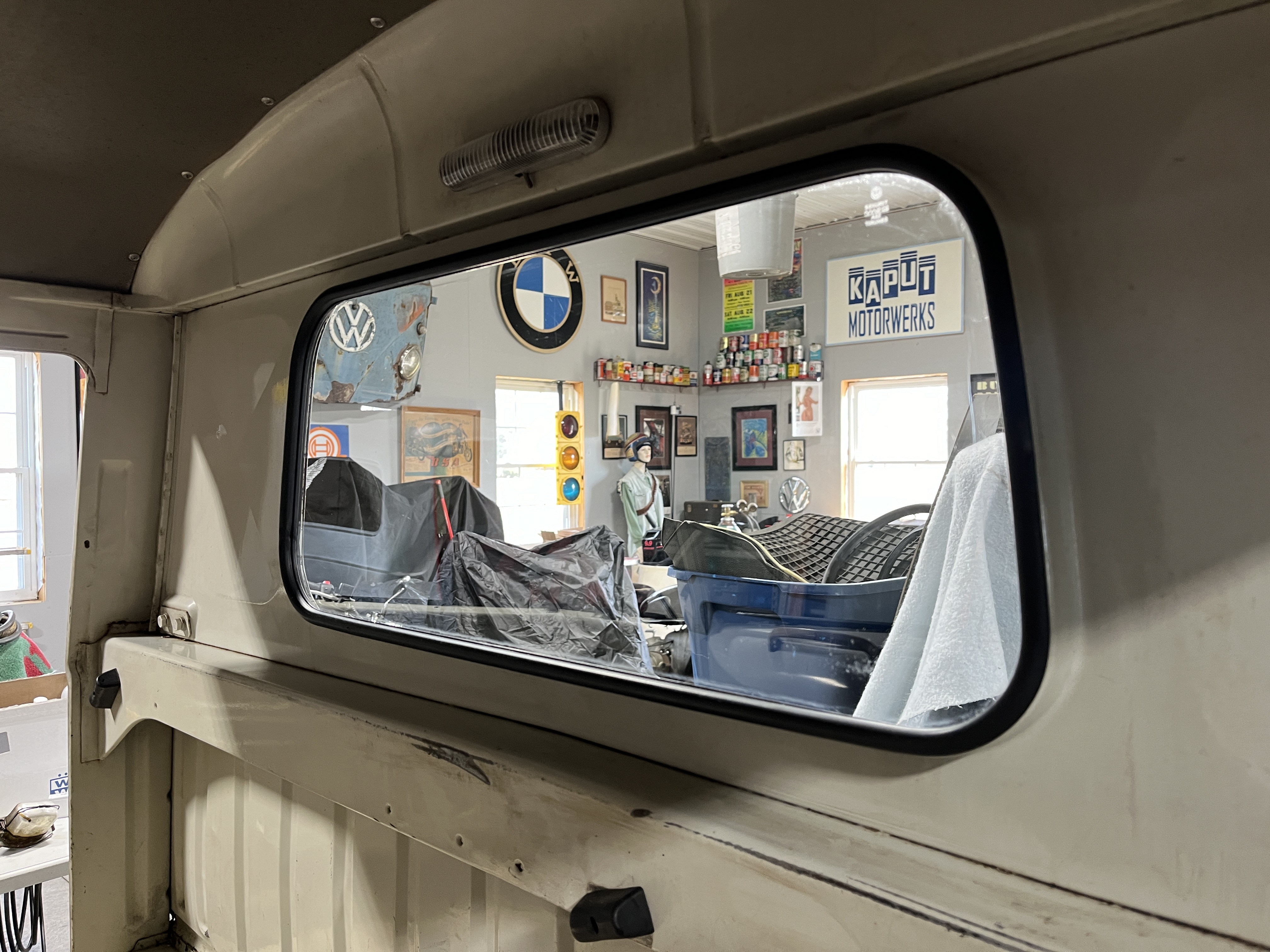

The glass is back in with new seals. Should be dry at least.
