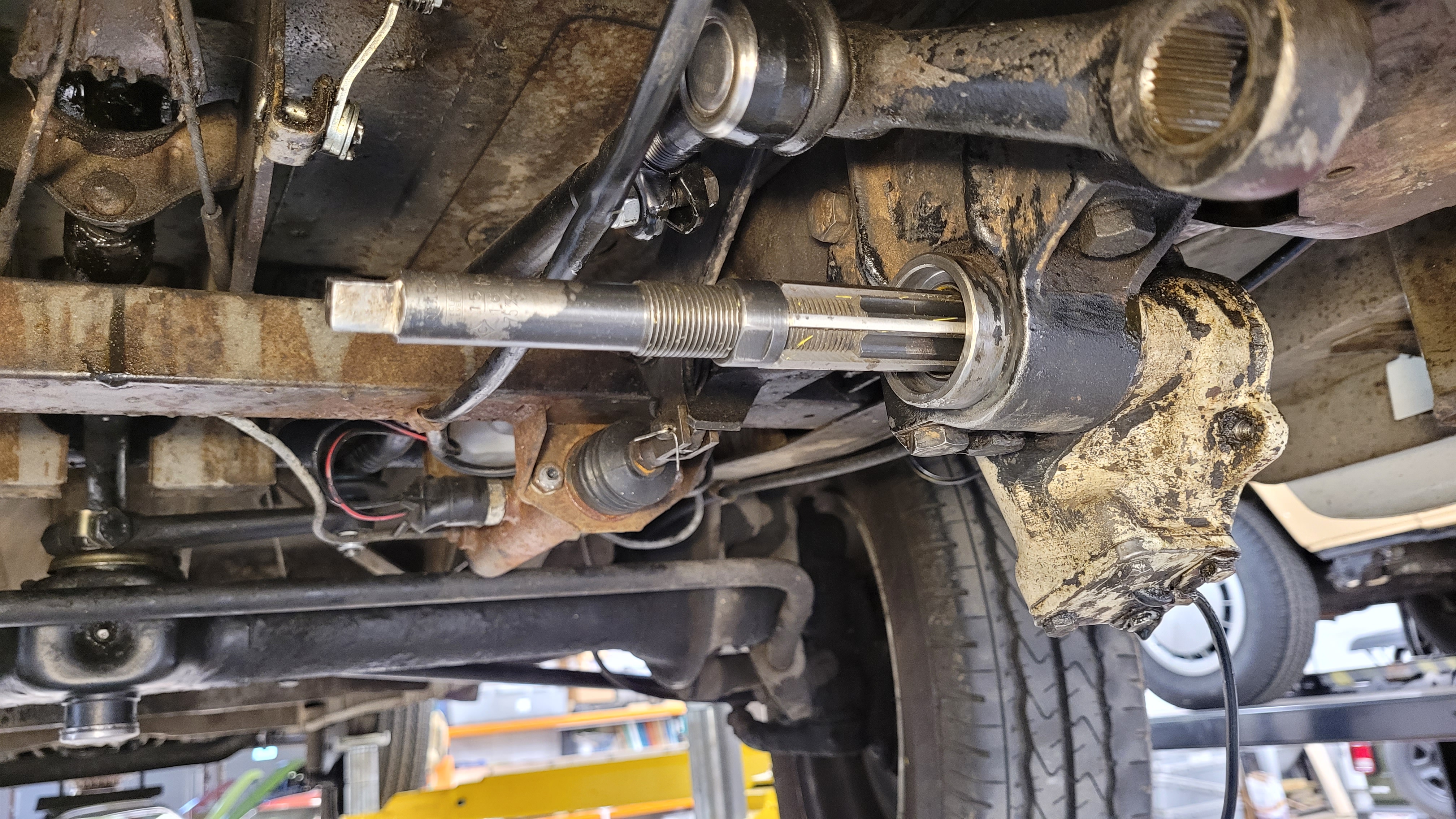

Been really busy working on Chevys lately so not much to post here. We did finally get back to Rob's bus and did the center pin bushings and steering box bushings.
The pitman shaft cleaned up perfectly with 1000 grit paper.
Same thing with the steering box, here he's driving in the bushings.
This is a shitty, messy, greasy job.  I mostly watched and made Rob do the real work.
You ream the bushings until the pin "just" goes through with minimal drag. Careful, it's easy to overdo it, and then you're screwed.
I have a set of adjustable reamers that work nicely.
Rob reaming the bushings.
New and old center pin with bushings. Pretty straight forward to install, drive the bushings out and in, ream to size, install, grease. Still a grimy job, though.
Reaming the steering box bushings.
