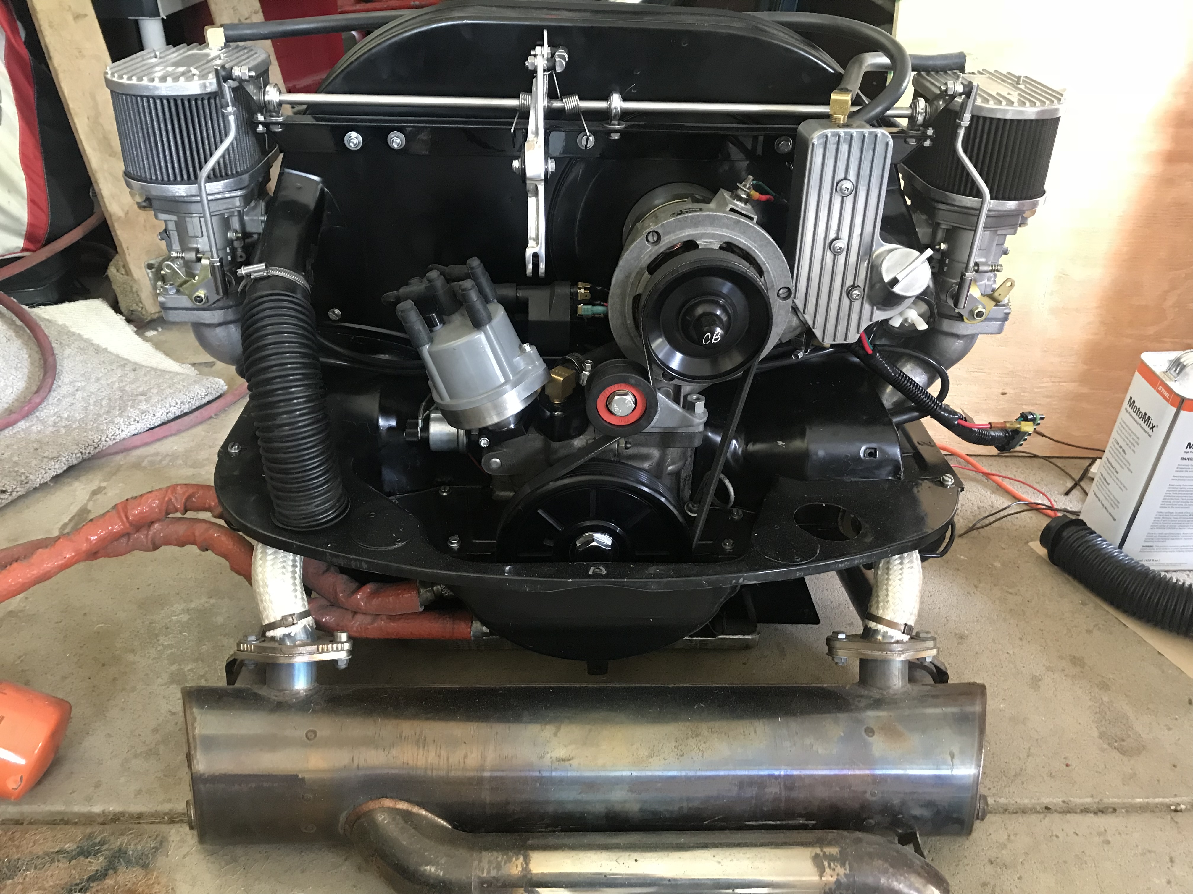

I purchased some tidbits for my engine over the winter. Mostly because Im a sucker with a credit card... A new Gene Berg carb linkage. It has nice return springs, roller bearings, and buttery smooth movement. It bolts onto the fan shroud and took a fair amount of time to get set up and adjusted but so far it really seems to be worth the time and money. Then installed a stock looking serpentine fan belt setup from CB. Not at all nesassary but looking forward to no more belt adjustments or squealing. Finally my favorite addition has been the new CB Magnaspark distributor and modern block coil. The distributor looks to be of excellent quality and its curve and total advance can be adjusted with ease. Ive been seeing this unit being used alot lately and after installing it I see why. Its a great unit. Im looking forward to attending some summer events :)

That one armed fan shroud is sure interesting. What is that vertical mounted unit to the right of the alternator? Some kind of oil distribution system? What's the black horizontal mounted unit right below it? You millennials really know how to cause head scratching. :lol: How's your heat? :lol: :lol:
Posts: 910
Six Volt wrote: Tue Jun 12, 2018 10:52 pm What is that vertical mounted unit to the right of the alternator? Some kind of oil distribution system?
CB oil breather/filler
Six Volt wrote: Tue Jun 12, 2018 10:52 pm What's the black horizontal mounted unit right below it? You millennials really know how to cause head scratching.
Coil
Posts: 679
Six Volt wrote: Tue Jun 12, 2018 10:52 pm That one armed fan shroud is sure interesting. What is that vertical mounted unit to the right of the alternator? Some kind of oil distribution system? What's the black horizontal mounted unit right below it? You millennials really know how to cause head scratching. :lol: How's your heat? :lol: :lol:
Haha 1 armed fan should :lol: I was making a engine wiring harness with a 6 pin weather proof connector and didnt put the other fake heater hose on for the picture. The CB breather/oil filler is awesome on a bus during an oil change. Easy oil pouring.
