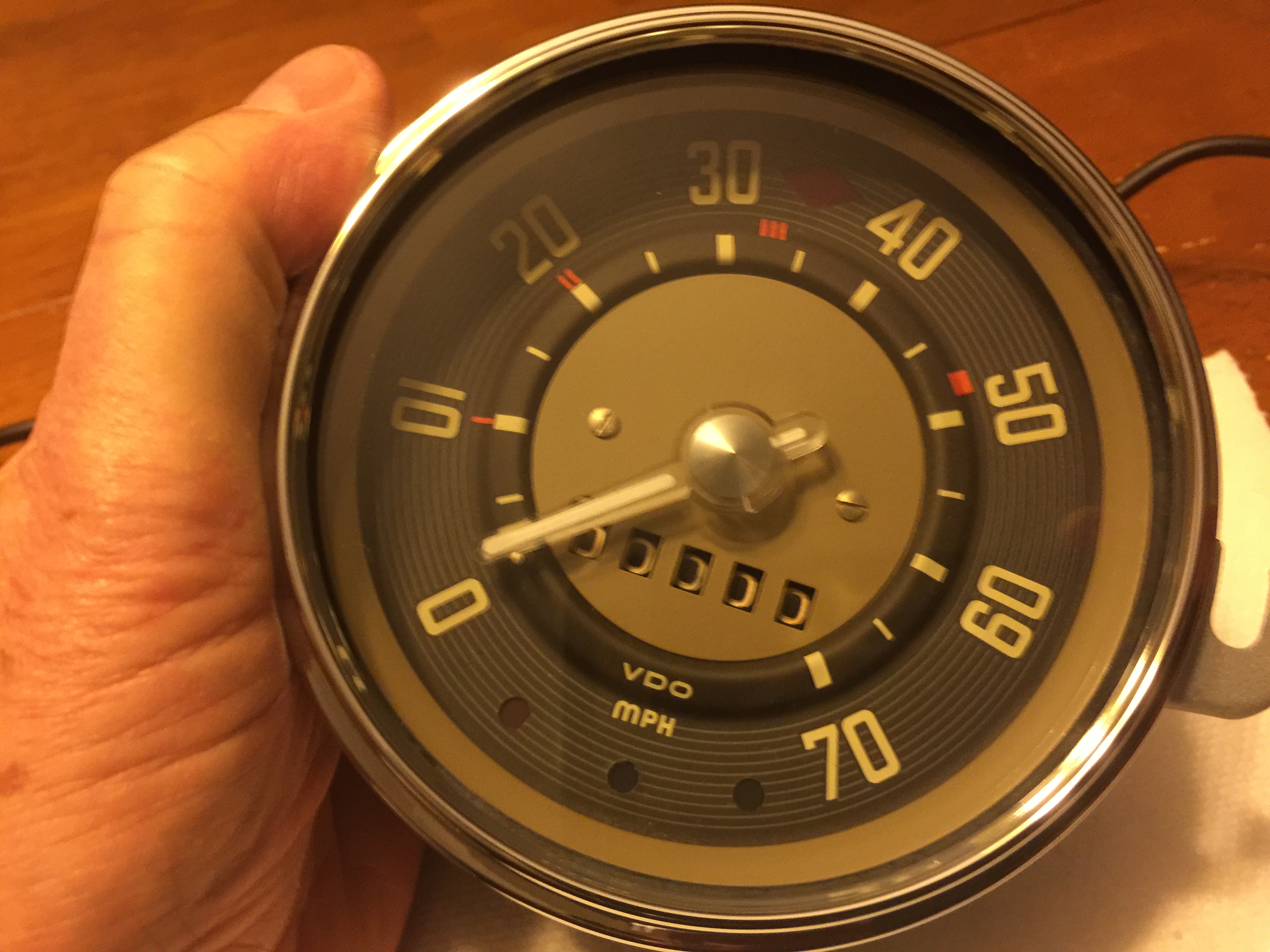

With winter coming and my plan to convert to 12 V, I thought its also time to finally address my speedometer woes. I've tried several used speedometers, but it always seems the odometers in them are bad. The hassle is you have to go through the headache of installing them to find out later that they're no good! :oops:
So speedometers on the samba for split buses that are re-done can be pricey. It's not uncommon to see fully reconditioned ones go for $400. I'm currently running an incorrect 80mph one (should be 70mph) with a bad odometer. The second (tenths) odometer wheel locks up on the number 3 digit. Bruce cleaned up my original 70mph unit, but we took a chance on the odometer being good and of course once installed it was bad! :lol:
So I started talking with a guy (Ryan) who has an outfit called Orange Empire Speedometer out of Corona California. Rather than buying one of his reconditioned units for $325, he suggested sending the 70mph unit out and see if he could fix it. I told him I had some other pieces parts from other split bus speedo's and he said send them along and he'll use them as possible cores and reduce my cost.
You probably know this, but if you're sitting on old speedo's from split buses, the 70mph ones are pretty valuable and bring really good money even as cores. The 70mph kilometer ones go for $600-$700 when reconditioned. Don' t throw those away!

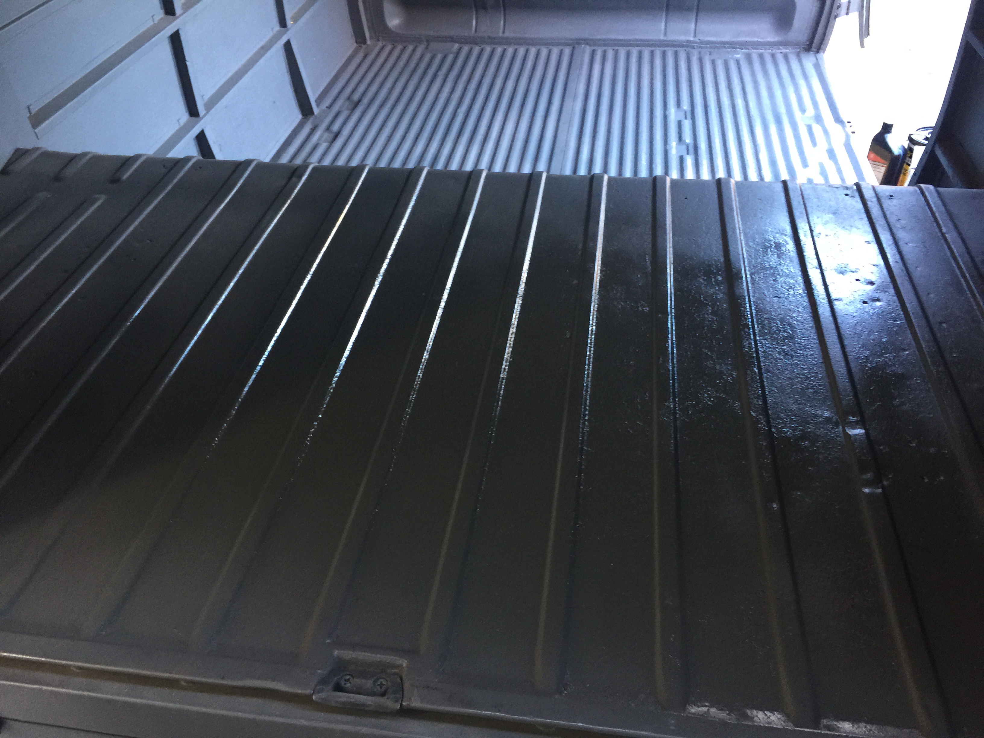

Used this great weather to clean up my floor and engine cover areas. Love these warm November days!

Got my speedo back from Ryan at Orange Empire Speedometer in Corona California. Great transaction. I recommend Ryan for your speedo work. Good communication, fair pricing and quality work. He’s right by Wolfsburg West so he often uses them for his out shipping.
