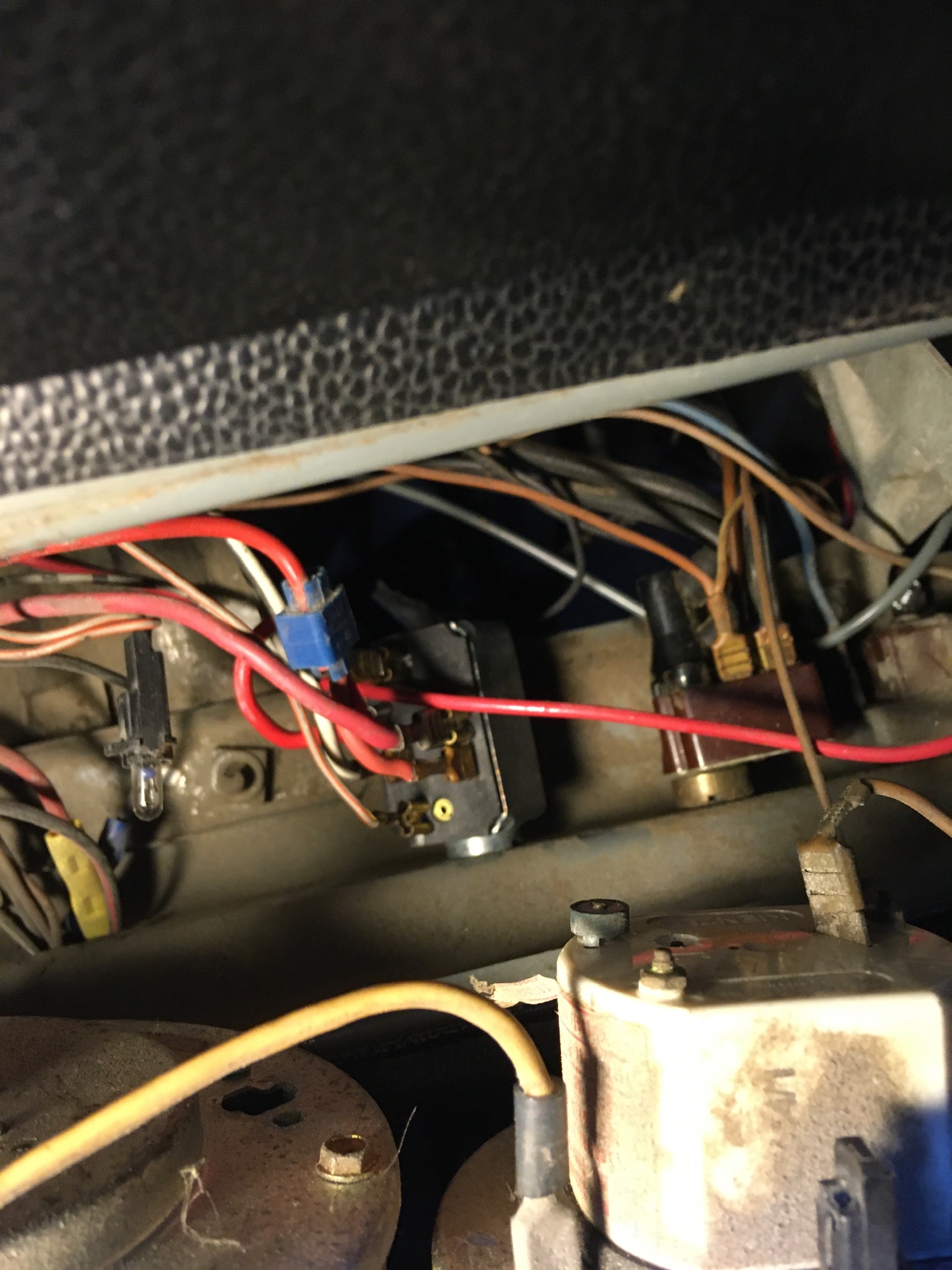

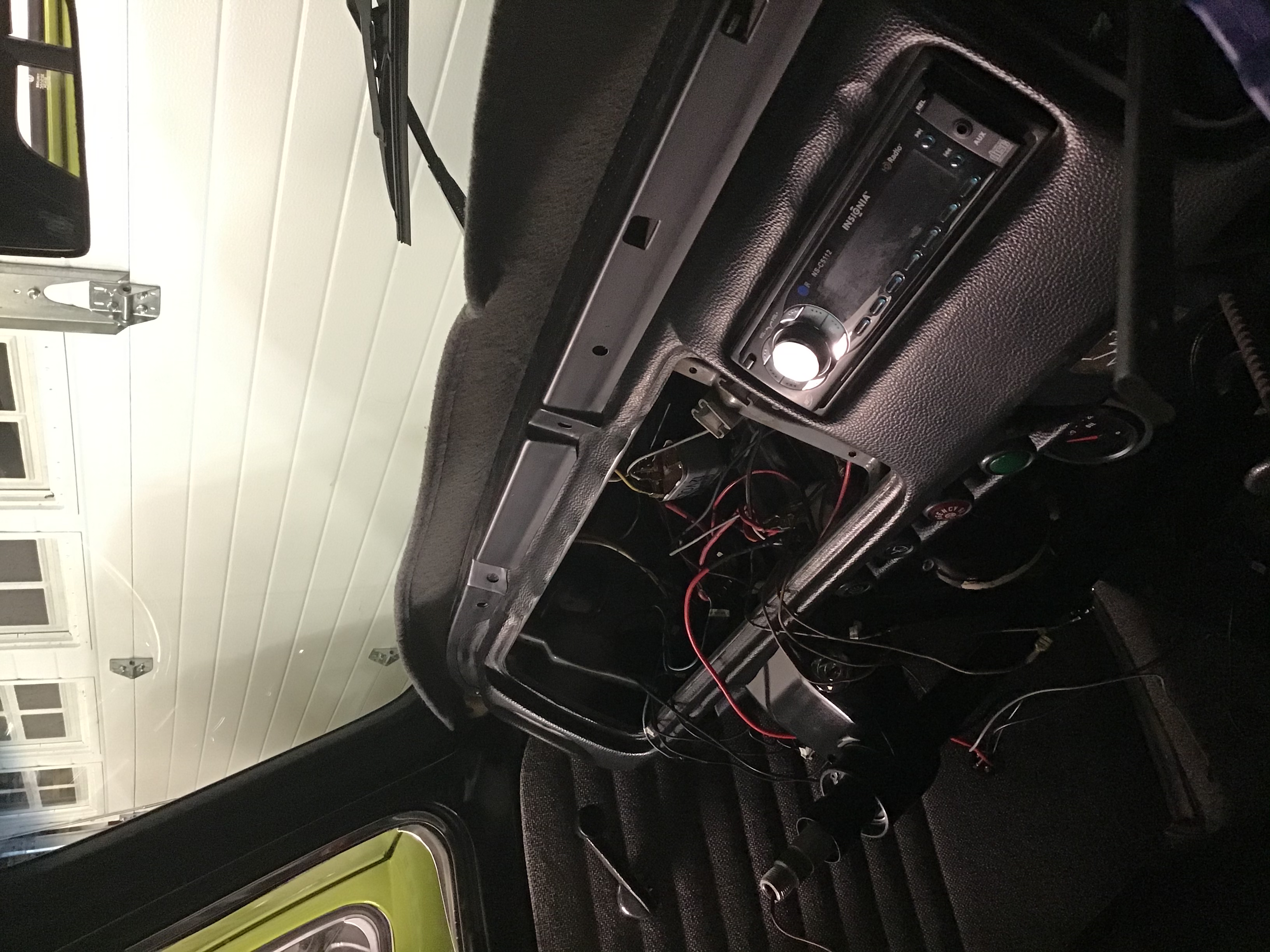

Since I had to pull the column apart I thought I would do some cleaning of the dash and sort some of the dangling wires. It was pretty funky.

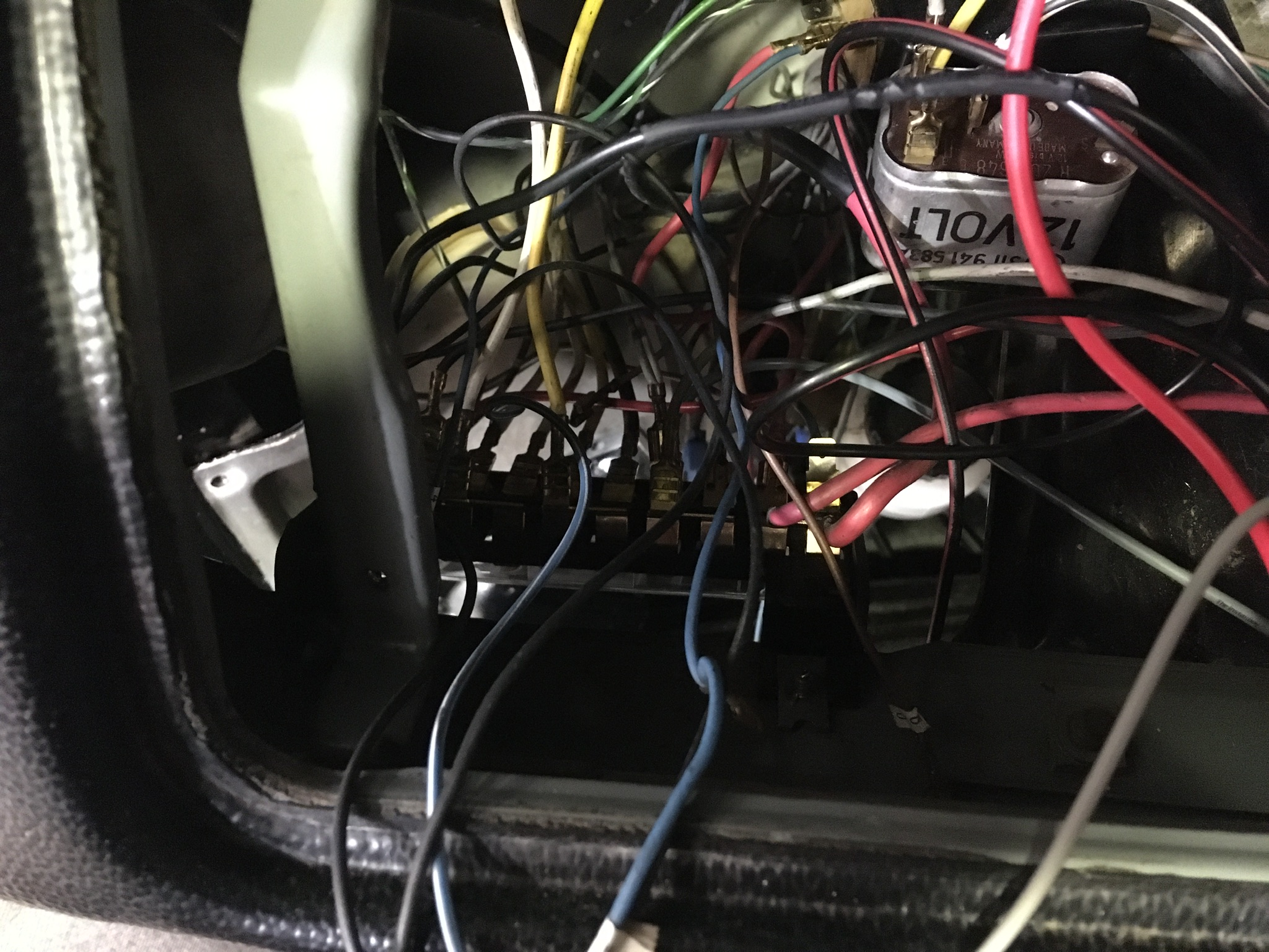

Fuse block broken and filthy.
Put in a new fuse block. Still need to organize the wires better.
