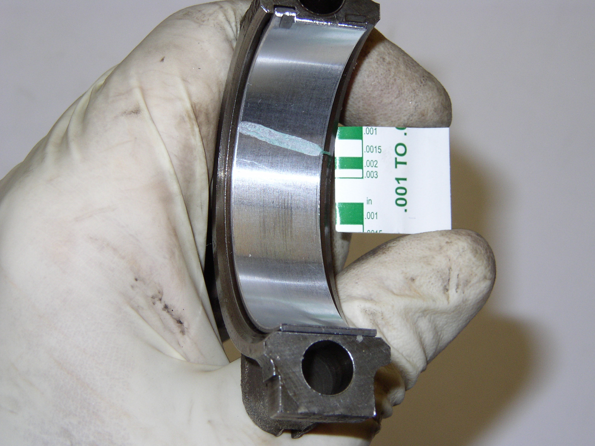

OK, the dry run went great, let's do the real deal. I miked everything and it was great but Plastigage tells the real tale. It's a thin plastic thread that's bolted in between the bearing and the crank and how much it "squishes" out tells what the clearance is. The rods were all right on target, between .0015 and .002"
Short block went together perfect and spun as free as a bird.
