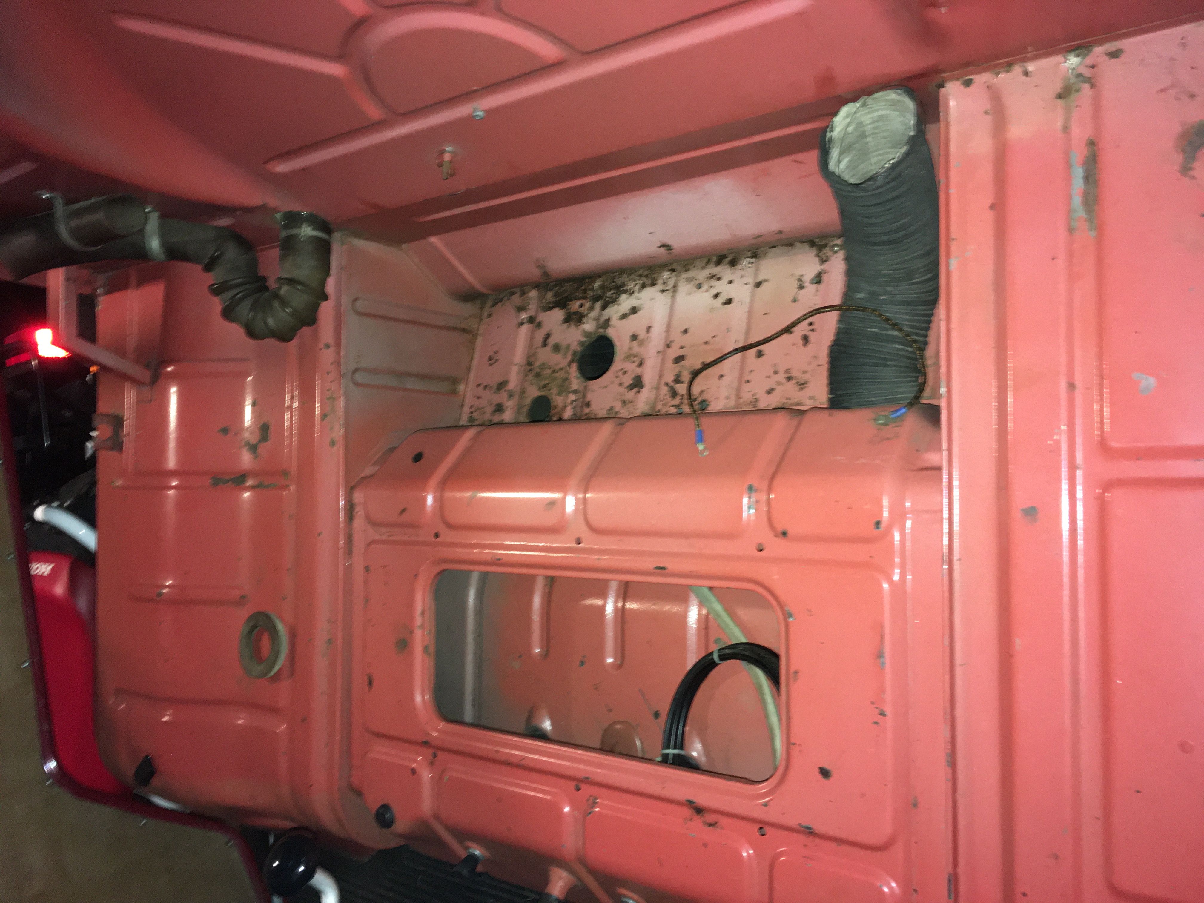

I managed to get a little bus and garage time in while home for the holidays this round. I decided to take the 60 year old, 6v gas Eberspacher out of the bus so that I can make room for an updated diesel heater. I am still torn between Eberspacher and the Webasto heaters but will probably fall on one or the other. Both get comparable reviews, are German made and have been around for a long time.
Taking the old unit out was a little bit of a challenge, but I managed to get it removed and the area cleaned. Next time I am home I will prep, paint and hopefully install a new unit with a small diesel tank in this same area, under the front seat. This was a Canadian delivery bus with the cold weather option listed on the birth certificate. They would use these heaters while driving to keep warm. My intention is just to use it on chilly nights while camping.
Here are some pics for reference.
The original unit in place.
Dirty Bus...
Cleaner Bus...

Make Craig update his thread about his heater install and we can compare the two when you're finished.
I like the idea under the front seat, especially since the duct is existing already, I hope you have enough room under there.
