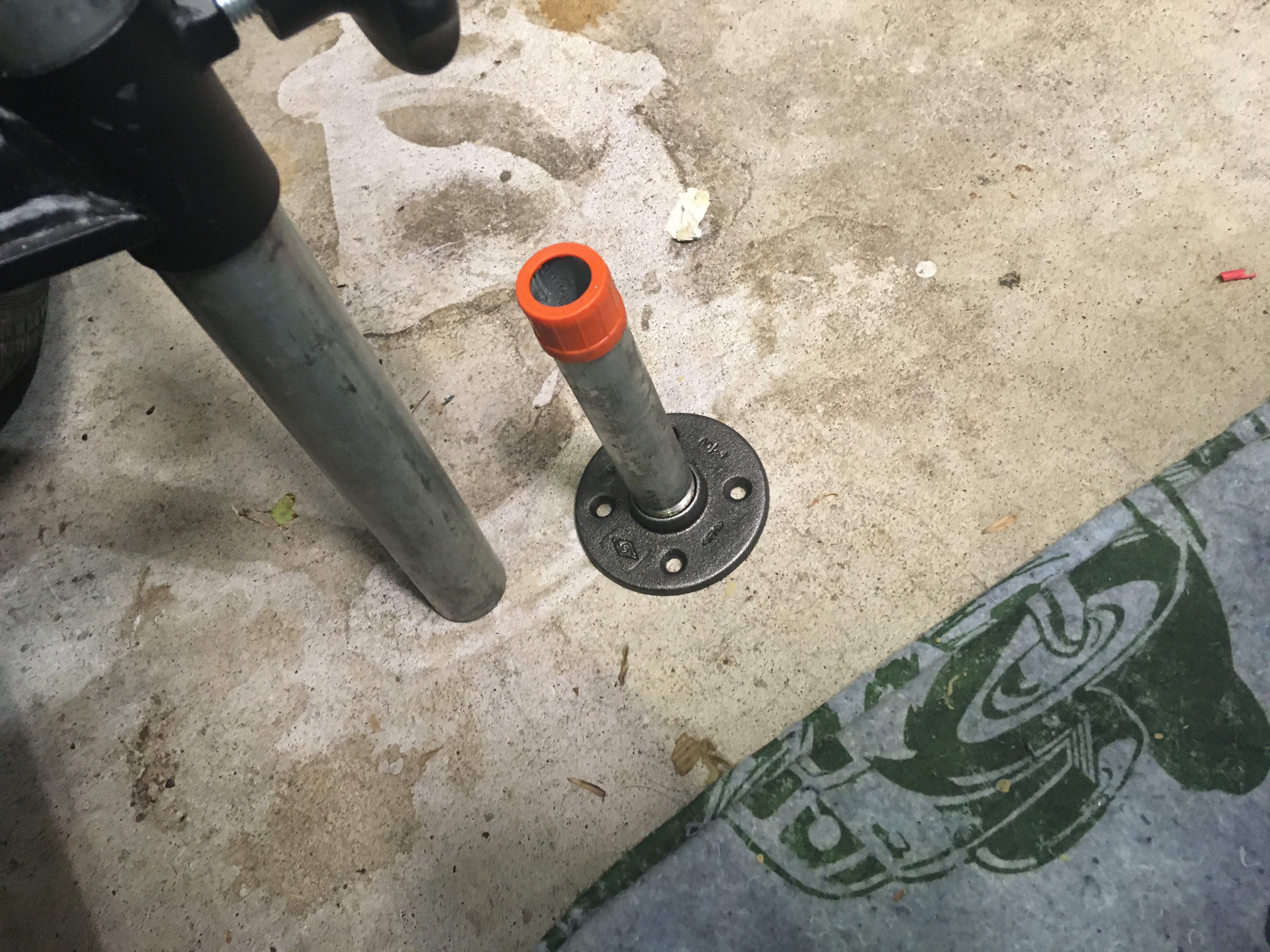

Not a repair necessarily buT a useful little item I also got front Bus-Ok as long as I was paying shipping from Denmark. A table leg stand that uses the jack mount. My contribution was a little leg I made from 3/4 in pipe. This way the bottom of the table leg won’t get chewed up.
