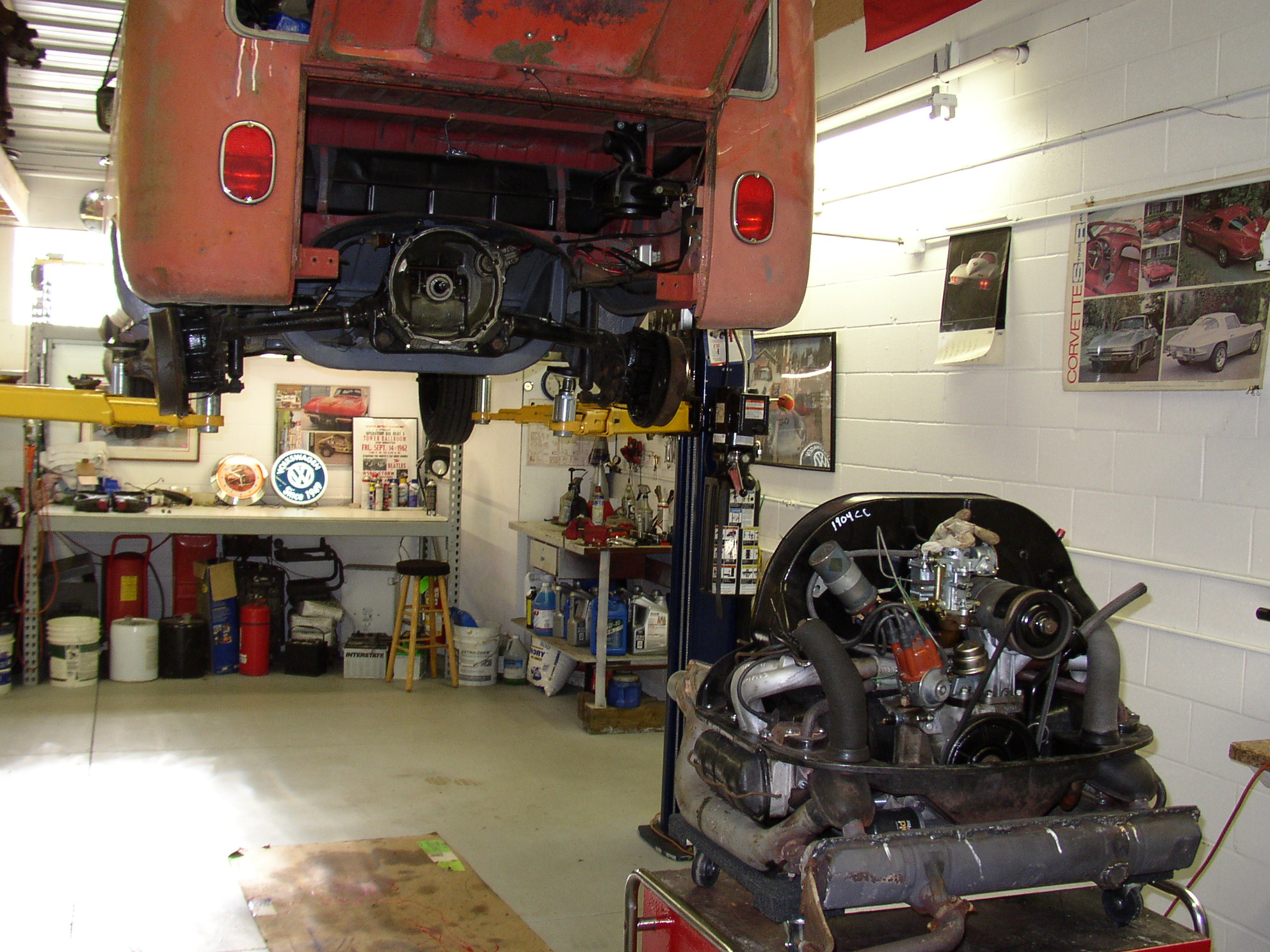

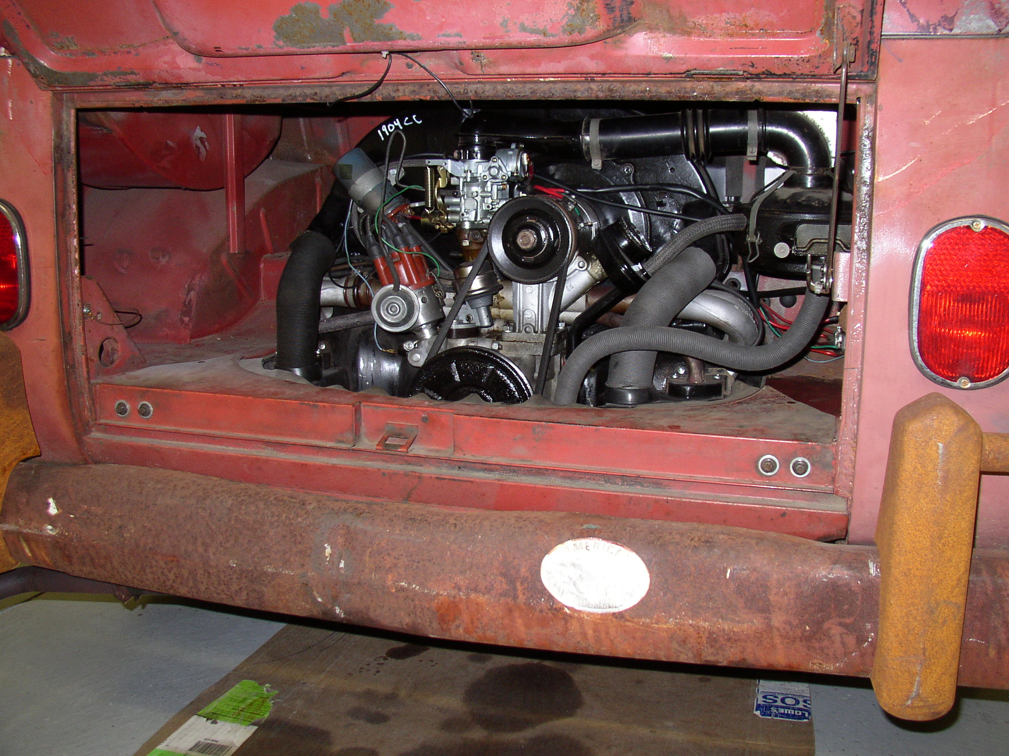

Remember "Musical Chairs" when you were a kid? I'm doing Musical Motors. The 2180 from the Ghia went into Bus 1, the 1904 from Bus 1 went into Bus 2. The 1600 CWC goes from B2 to the shelf. I didn't take a lot of pictures to document the process but it went smoothly. Out with the 1600: In with the 1904:
The last time I tried to beat the clock, on page 14 I hustled and did it in 1:15 with the bumper on. I thought I'd take my time and to make it easier I pulled the bumper. Even with switching the clutch, modifying the throttle tube and R&Ring the bumper it still only took 1:40, much quicker than I though it would be. That was Monday, I took it for a long ride then and yesterday too. I saw an old T3 fastback on Rt 82 in Grafton driving in it yesterday.
One of my buddies stopped by with refreshments to inspect my work. It pulls really nice with the 1904 like you'd expect. It has a '64 tranny in it which is a one-year-only gear ratio, 4:12 R&P and 1.26 RGB which is borderline too tall for a stock engine, that's why they went to a 4.37 in '65. There's a loooonnnnggg hill on the turnpike WB coming back from Jim's that it used to struggle on over the valley near Peninsula. I bet it won't struggle there anymore.

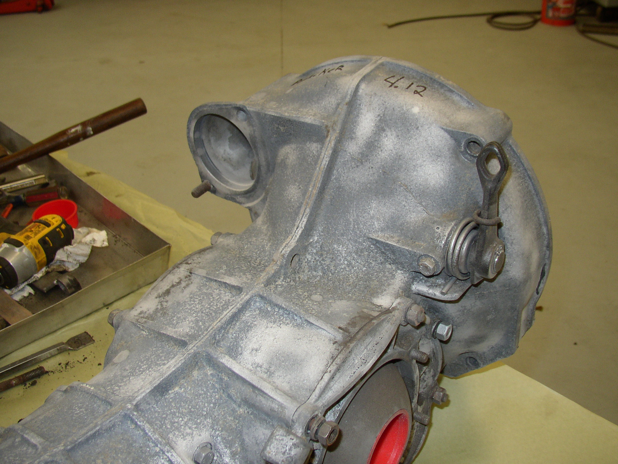

The tranny is a bit tired in Bus 2 and it probably deserves a new one. It actually works pretty well but leaks from the gearcase. I dug through my junk cores to find a suitable unit with the right R&P, I don't even remember where this one came from, probably a swap meet. I popped the side cover to verify ratio, it's 33/8 which is what I want, 4.125. Several others were 35/8 which is 4.37, a good city gear but really screams on the highway, and with the 1904 I should use the taller gear. I'm pretty sure it has a 4.12 in it right now and I definitely don't want to go lower. I cleaned it up, changed the clutch arm from the bent one to the straight one, put a new nosecone on it and dropped it off at Jim's. He says he's crazy busy! Everyone is off work and wrenching on their Dubs.
I don't know what VW was thinking when they put that bent arm on for 10-15 years but it's a major PITA to get at the top left bell bolt.

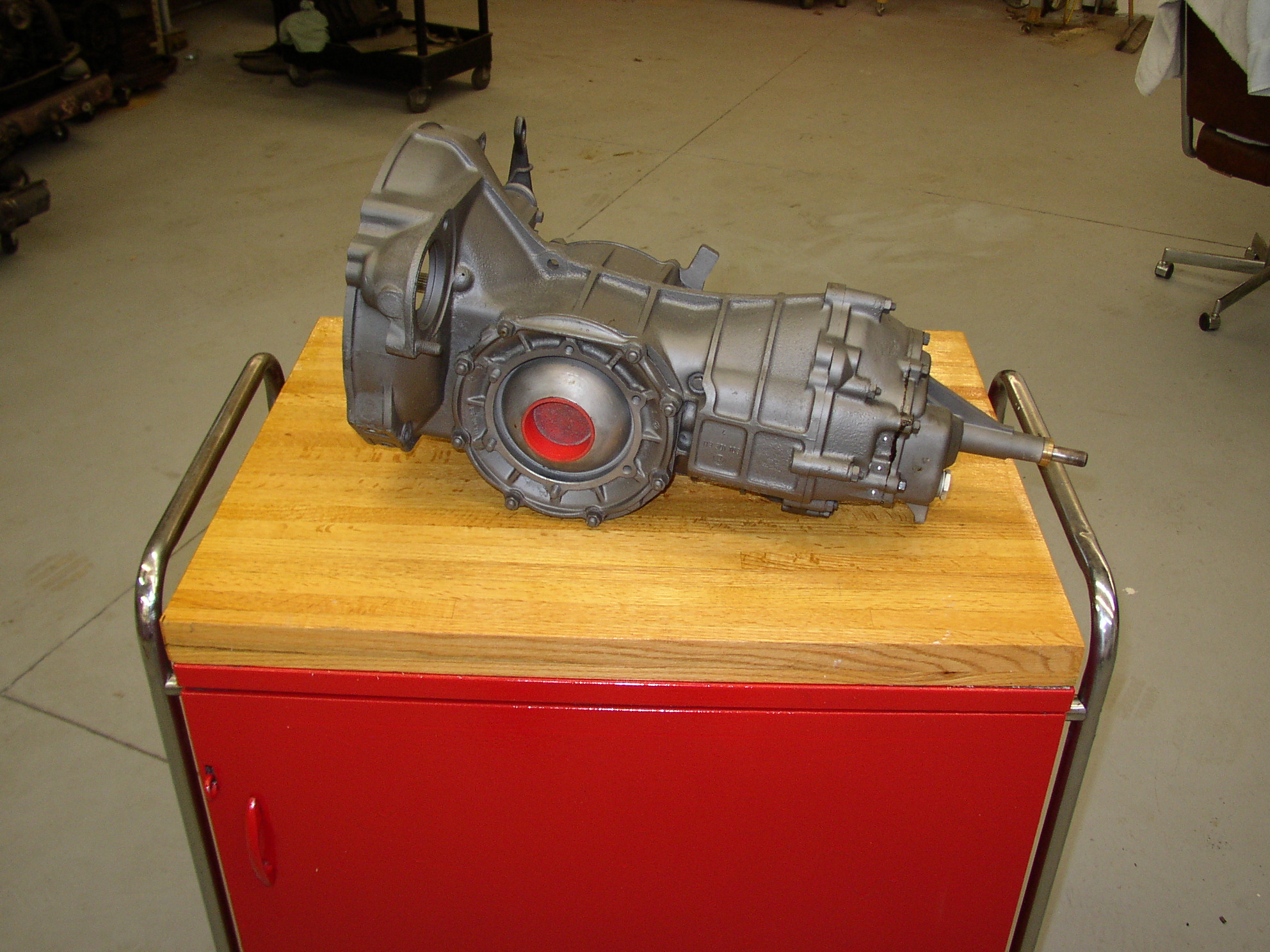

Jim's Custom finally got my tranny done so I picked it up at the show Saturday. It needed the normal stuff, a couple of synchros, 1st gear, bearings, etc. I'm splitting my time between Sean's motor and Bus 2 right now. I got Sean's long block done so I'm going to change my tranny now. Exit motor! Exit trans! I sure wish I could snap my fingers and get those axles to jump over from the old trans to the new trans. These things are a royal PITA to change axles on, the whole RGB and everything has to be torn down. At least it's all fresh so it shouldn't need anything.
