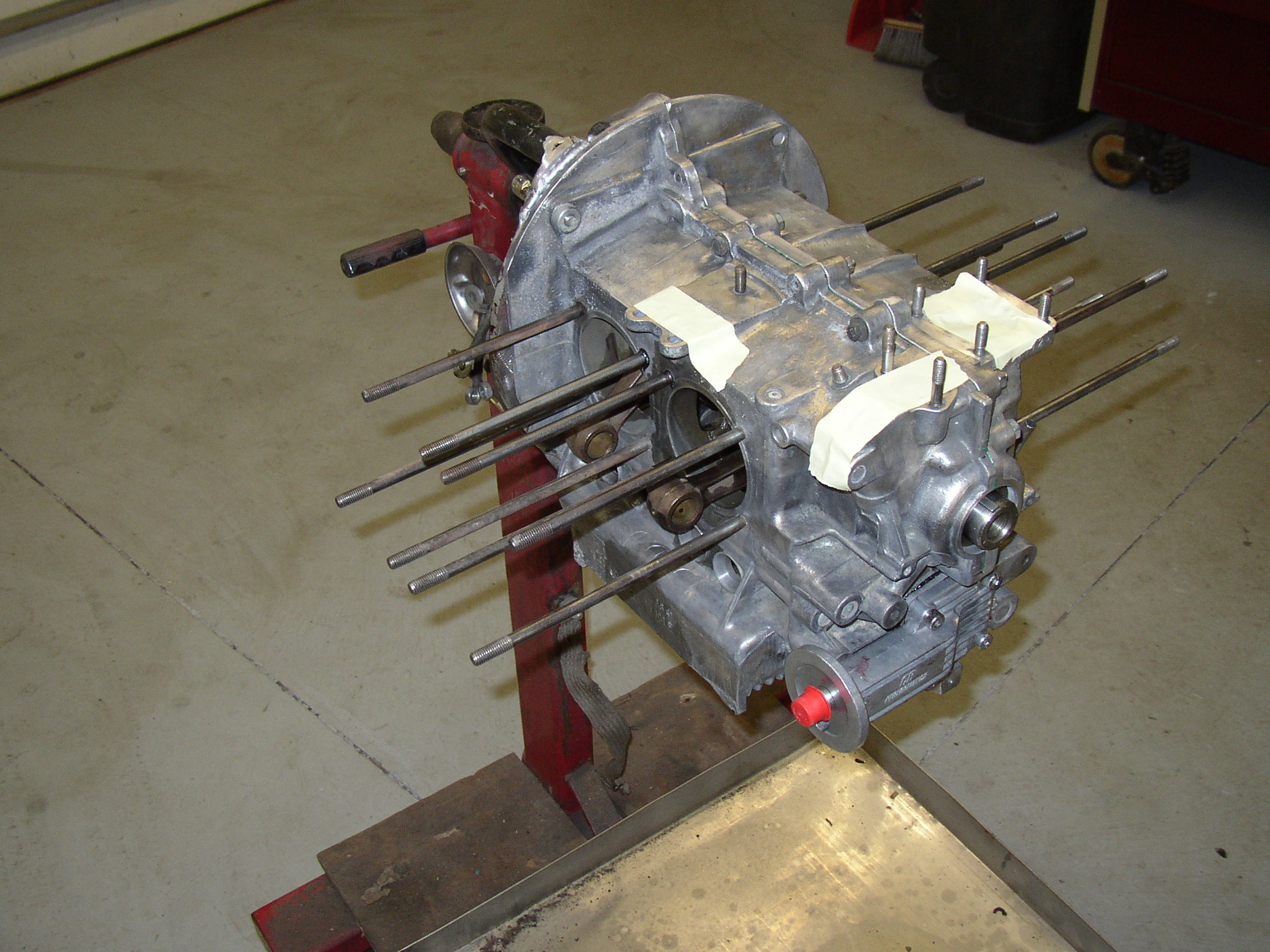

The 1600SP went smoothly, here's the case ready to mate together. The crank looked great to begin with but I polished it using a drill to spin it and 1000 grit, it looked like a mirror when done. The bearings are marked and "lined" to make sure they're seated correctly on the dowels, the case flanges are cleaned and gooped with sealer and it's already been dry-fit to make sure everything spins free.
Here's the short block done, it spins freely with zero effort.

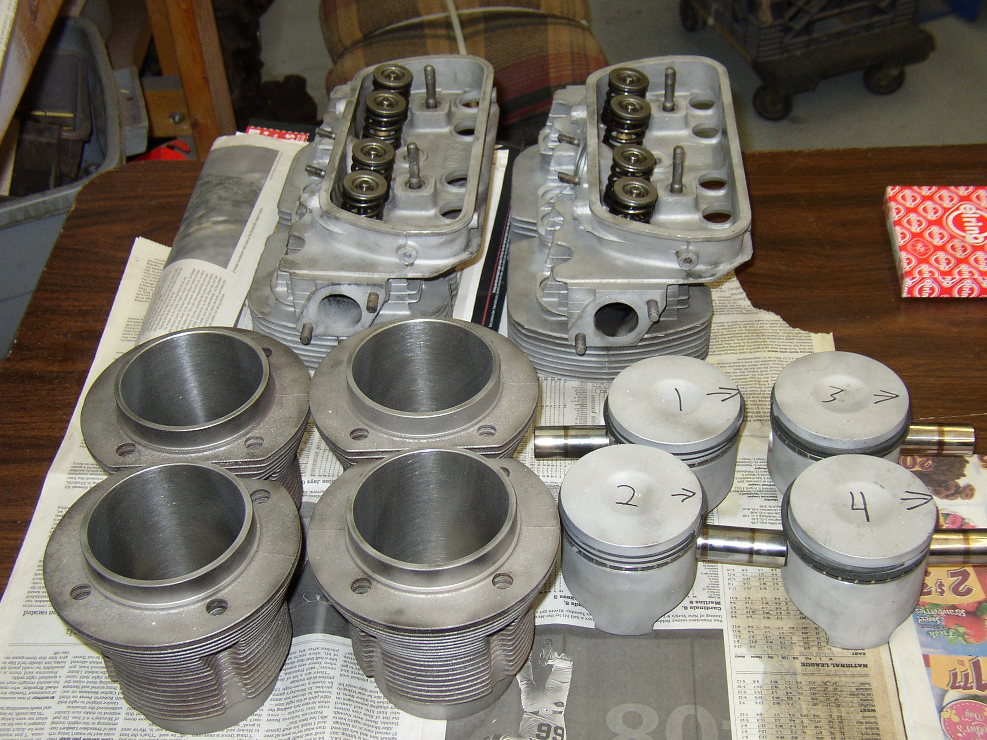

Parts done and ready to assemble, German jugs ball honed and checked, no wear or out-of-round measurable. Pistons soda blasted and re-ringed. Heads assembled and ready to go.

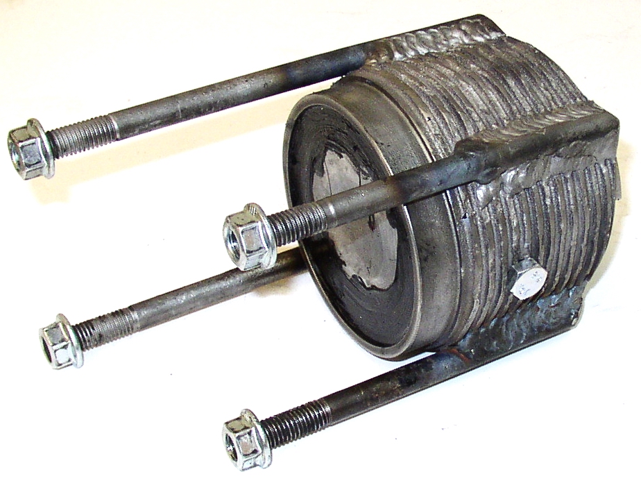

I thought I'd post this to give you guys something to look at. I've been pressure testing cylinders for a long time, as soon as I bolt the heads on I apply air and listen for leaks. A couple of times I've had valves that weren't seating and the head had to come off and go back to the machinist. I thought it wouldn't be hard to make up a jig to do this before the engine is assembled and I have plenty of junk parts, so have at it. In school we vacuum checked valves but I think shop air is much more effective.
Take an old jug, knock the fins off of it with an air hammer, weld some head studs to it, bolt a piston in with a ring, seal it with RTV, and voila! I have a hillbilly test jig to make sure the valves seat. The welds aren't as bad as they look, and if you can't weld good, weld a lot. :mrgreen: There's a lot of force on the piston (like 1700 lbs if I use full shop air) so the bolts go through the steel reinforcements in the skirts. I have a shutoff valve in the airline right next to my bench so I start with low pressure and work my way up if everything is tight, and I'm not hovering over it during testing. ;) That piston would probably leave a mark if it got loose.
I was going through some heads that had low mileage- TRW valves, tight guides, good looking seats. Clean everything, lap the valves, check contact with bluing and pressure test them, they're totally airtight.

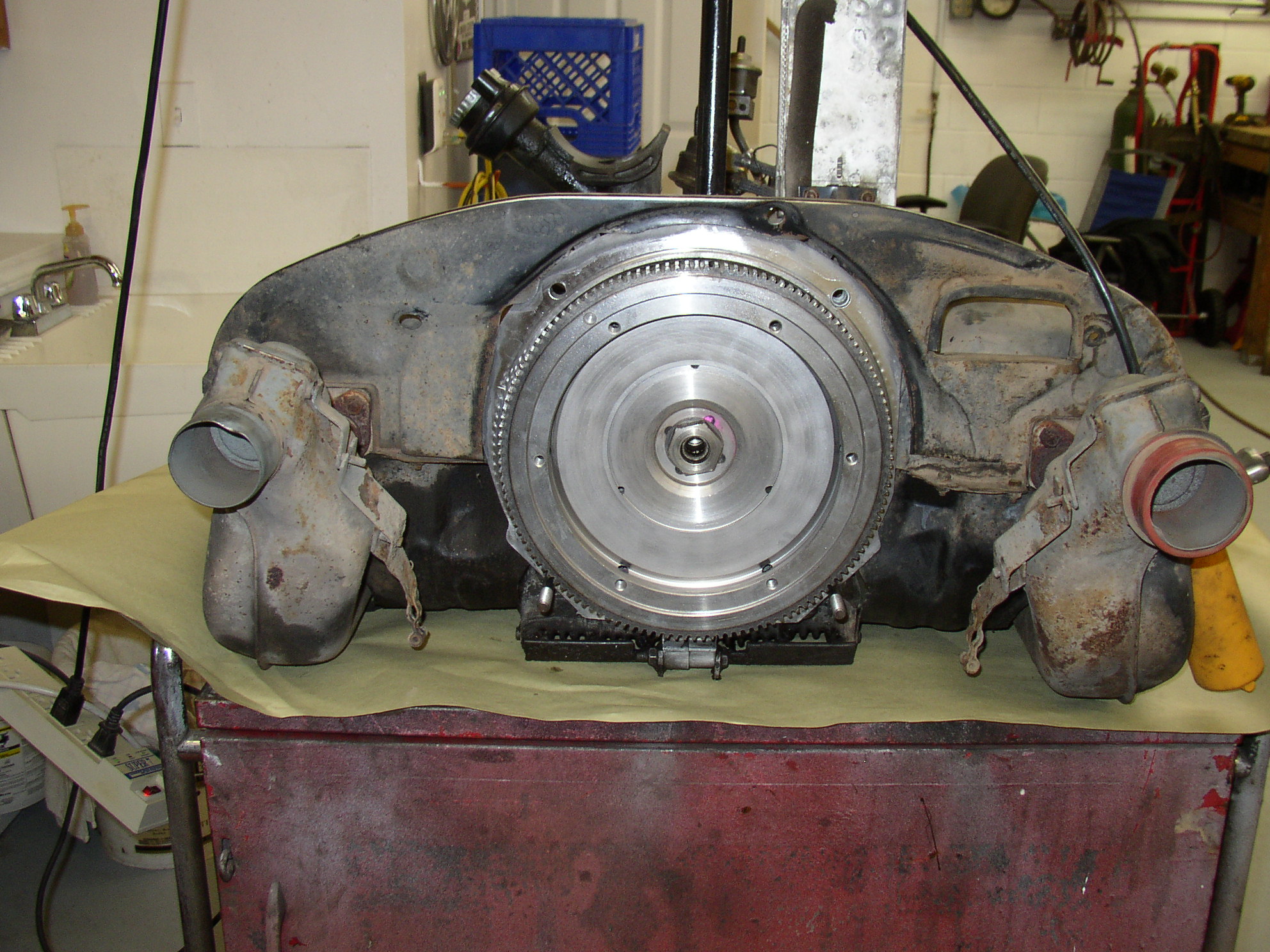

Step 1, yank the engine and strip the top of it to get to the intake boots.
The boots look like shit and are dry rotted to the point of being porous. OEG boots commonly look different and many times feel like brand new when removed.

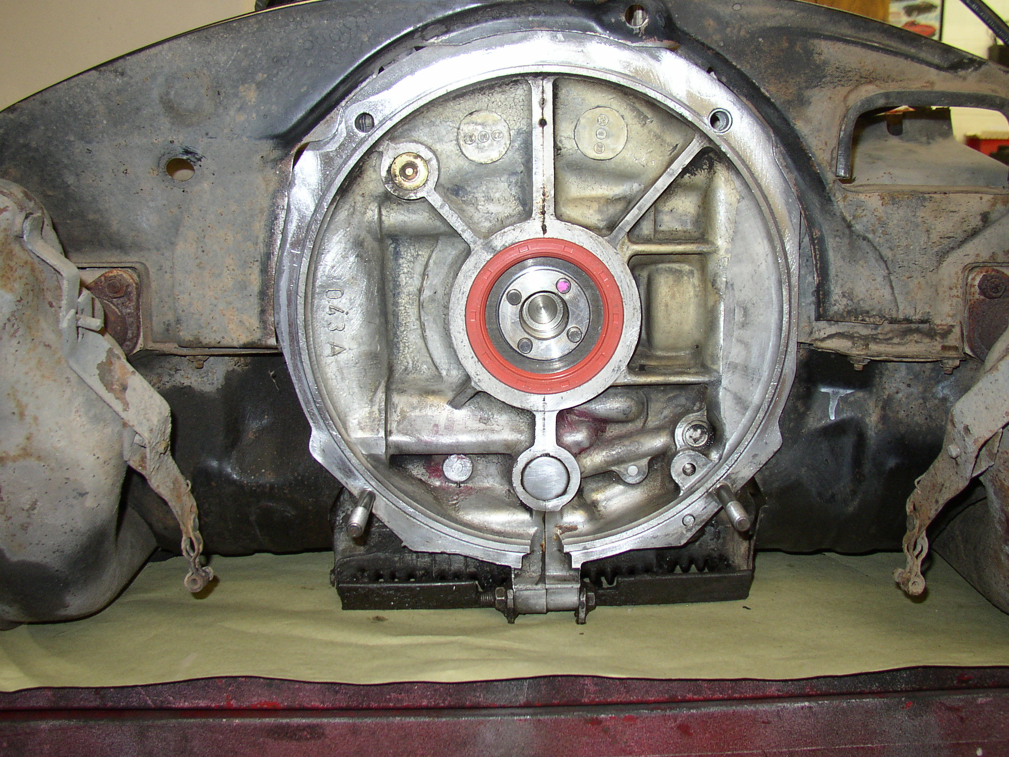

Might as well look at the clutch and stuff to find the disc wearing unevenly and the rear seal leaking. I cleaned up the back of the case and put in a new seal. I also bead blasted the flywheel to give the new clutch a nice surface to wear into.

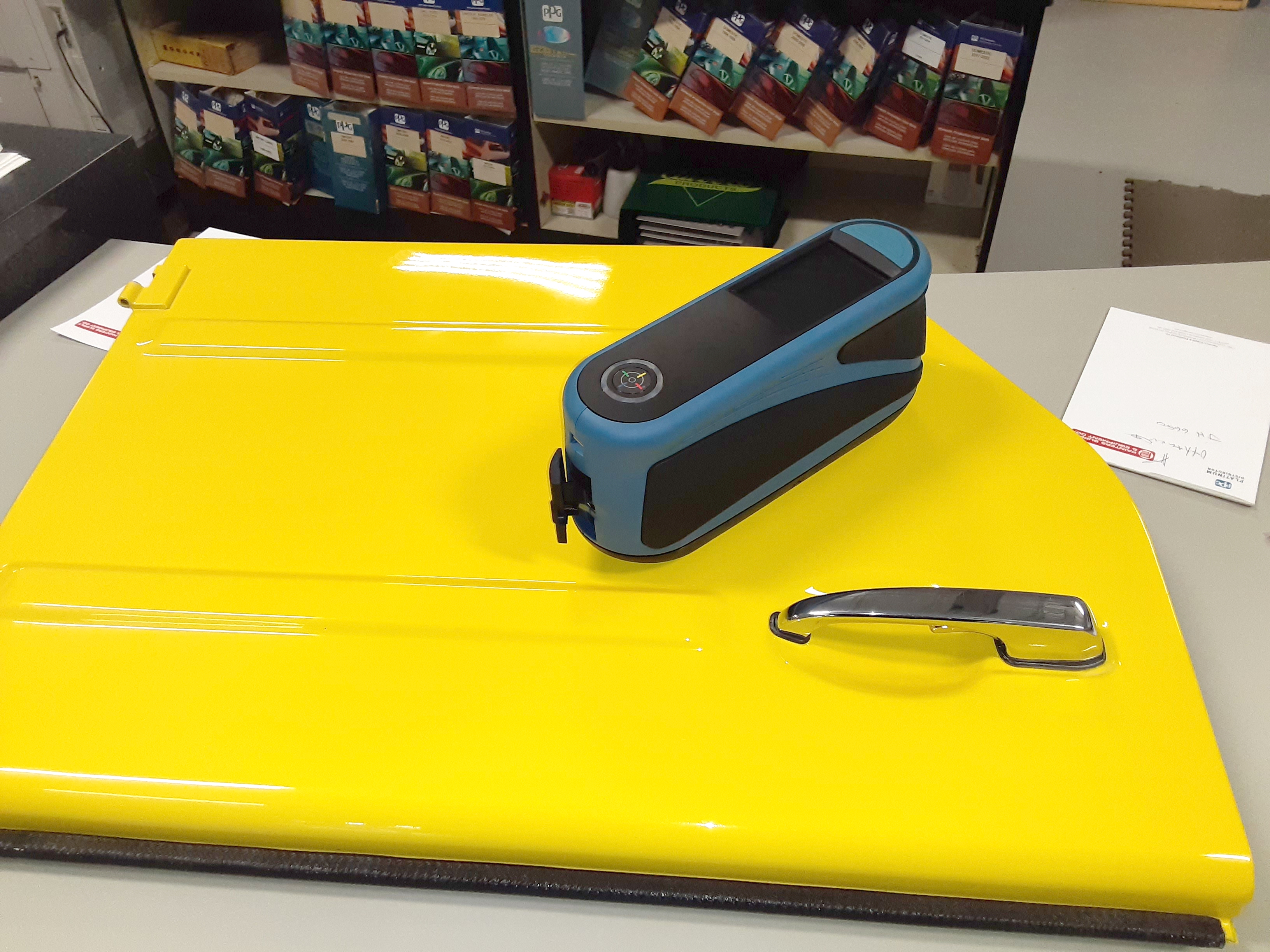

The owner got some pretty good sized stone chips in the paint and wanted them touched up, so I took one of the doors to the body supply shop where they used their camera to ID the color of the paint.
The match is pretty good, oddly it comes up as a Chrysler color. I was going to buy a quart in case I need to shoot something but they offered me a $15 touch up bottle so I got that.

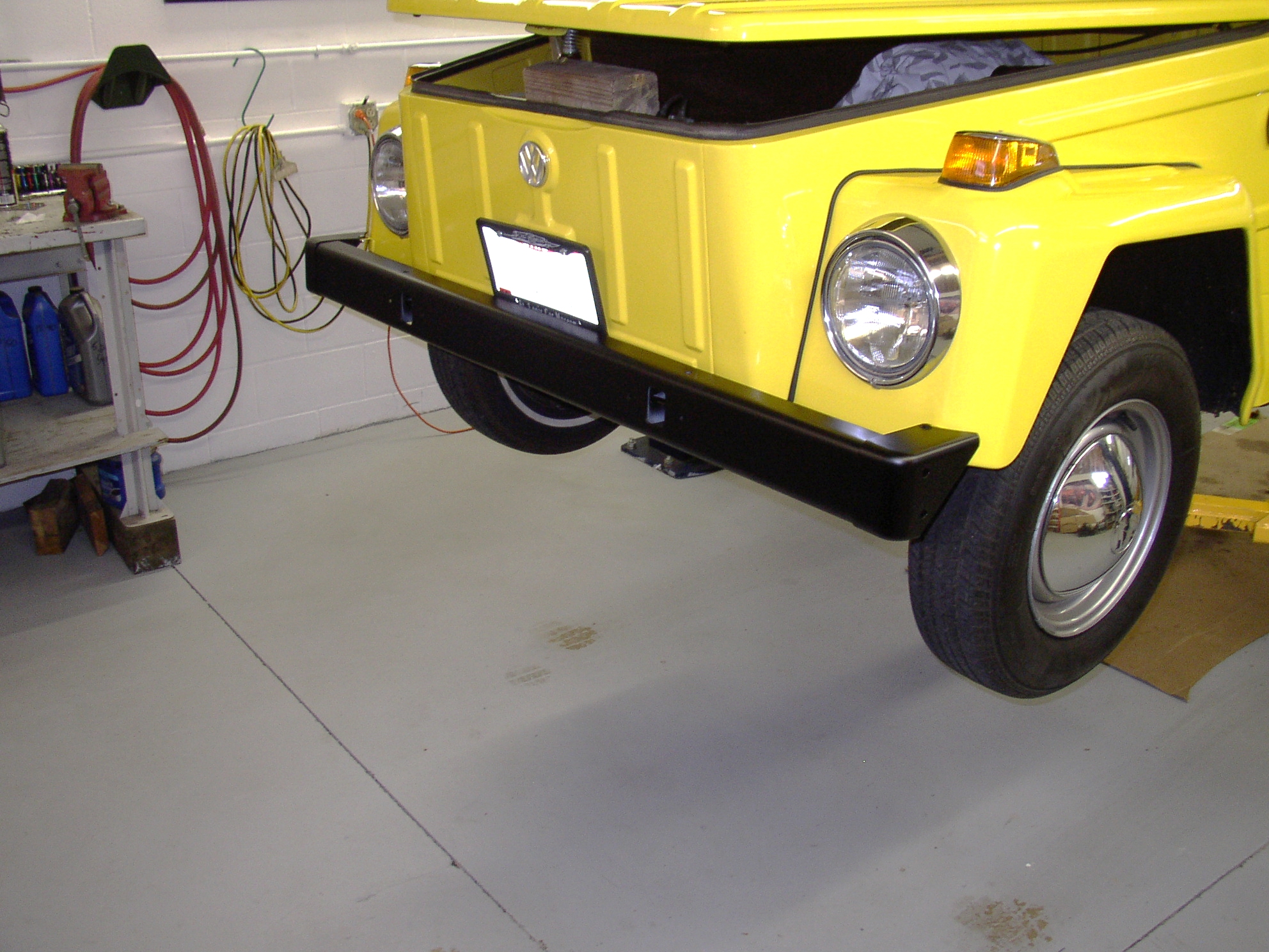

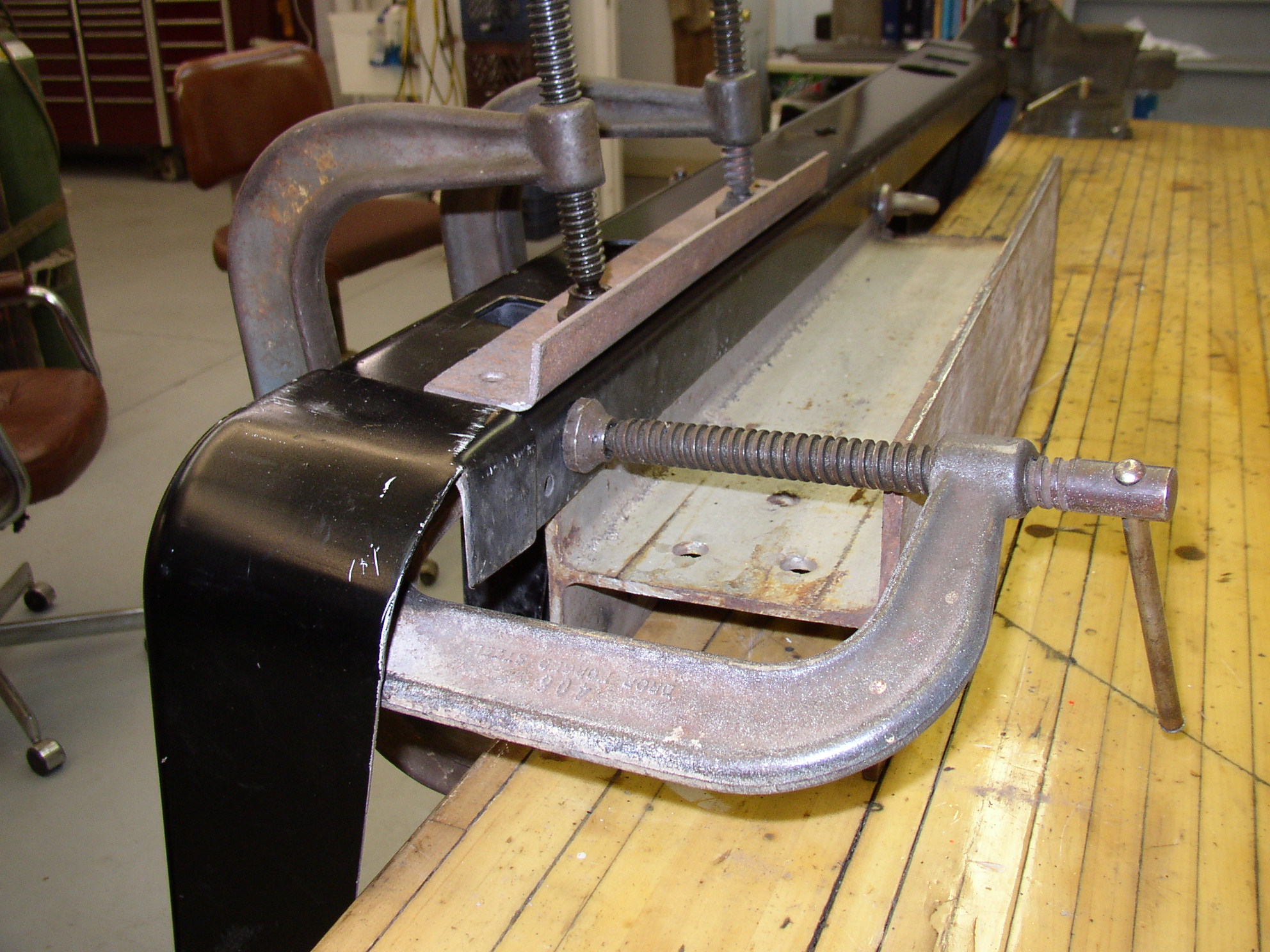

The PO painted the car but did a shitty job on the bumpers. Between that and damage from shipping they needed to be removed, straightened and painted. The damage was weird- not impact damage but "pulling" damage from either being dragged around the bodyshop/museum or loaded onto the car carrier with a strap. Anyway I straightened them as good as could be.
I still have giant C-clamps from my truck days, those aren't Chinese cheapies but forged-in-USA clamps. I bet they're $200 each these days or more. I used a piece of 6" I beam for a jig.
I filled in some low spots and electric weld divots to make them smooth. Note how many layers of paint there are!
They're in primer right now and will get black satin shortly. Yes, that's my primer gun, the HF cheapie. I can't believe how good those guns work, it seems like you can't kill them. For $10 they're barely worth cleaning, maybe just throw them away after each use. I shot a riding mower red last month with this one.

The bumpers came out really nice, they look like new. Satin black doesn't photograph well but trust me, they look nice.
