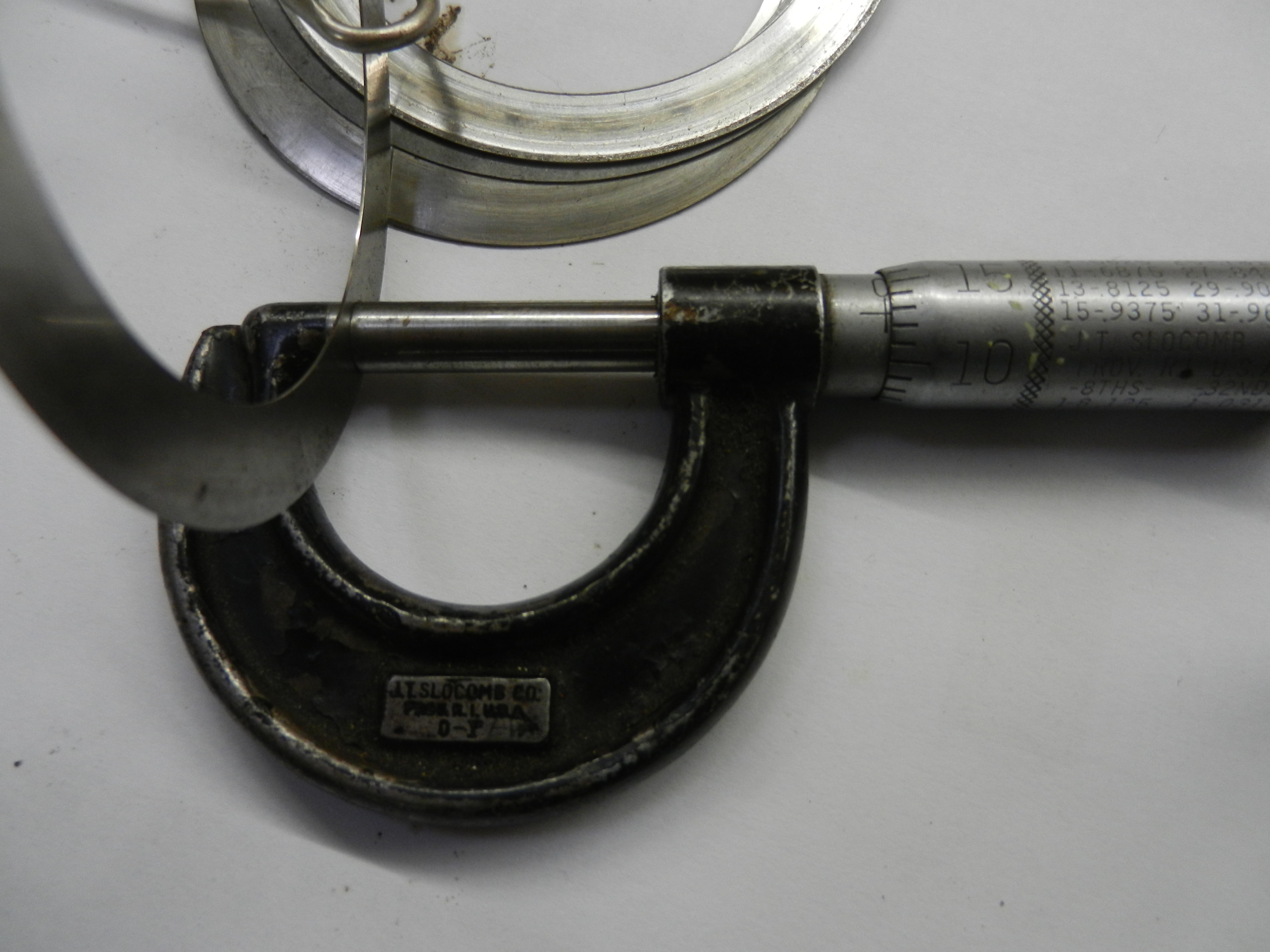

In my last post, I was a little vague on setting end play, and I had no pics of my build. So, I thought I would mock it up and provide a little more info. First, shims are sold in metric increments. So here's a little chart.
0.24mm= .0095in
0.30mm= .0118in
0.32mm= .0126in
0.34mm= .0134in
0.36mm= .0142in
0.38mm= .0150in

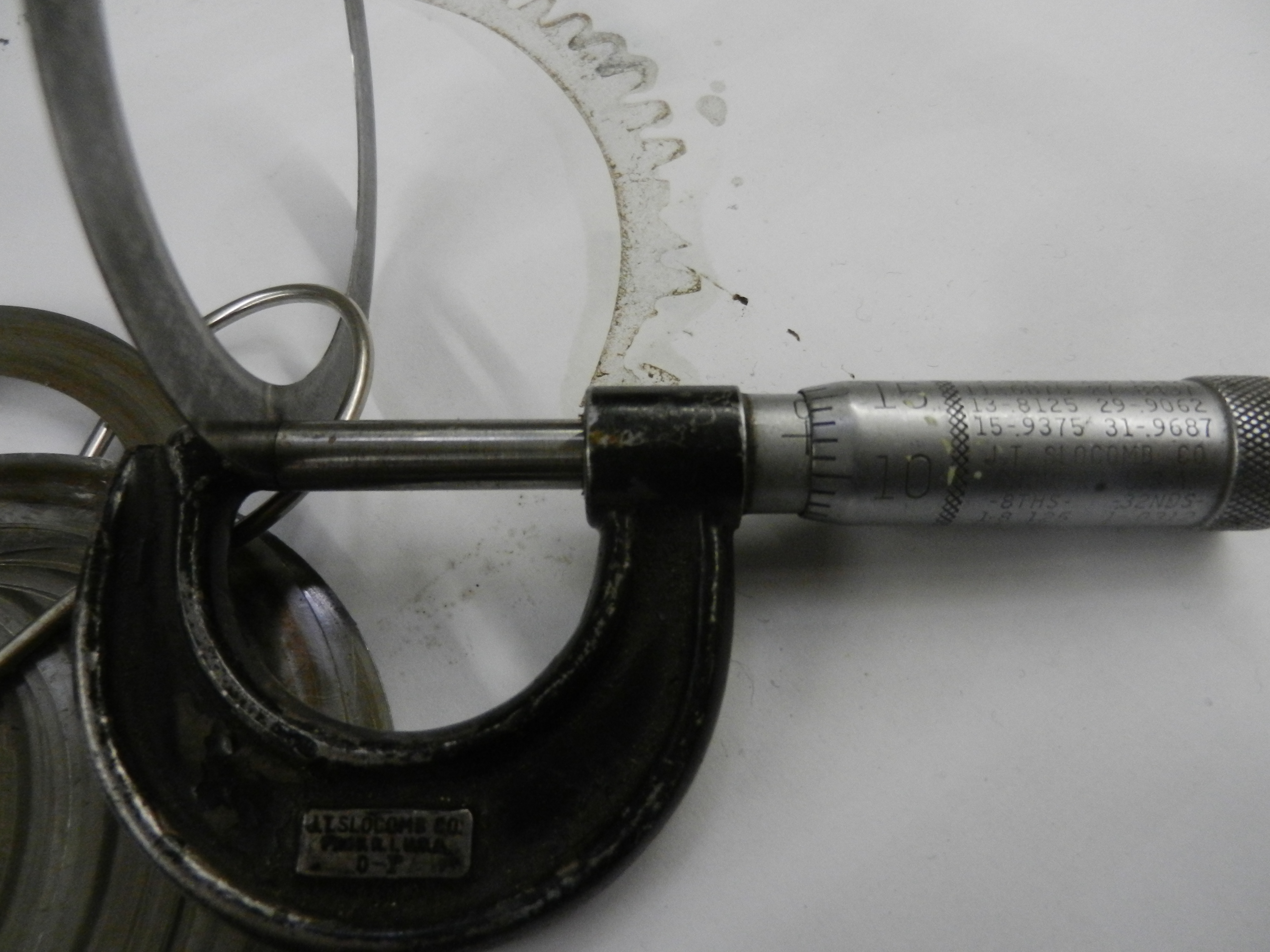

I doubt that any of us have a metric dial indicator or micrometer.
as mention prior, I pick 2 shims and measure them.
We'll call this one .013 (actually .0134)
This one .014 (actually .0142)
So, we have a 2 shim set of .027in
Install them on the crank.

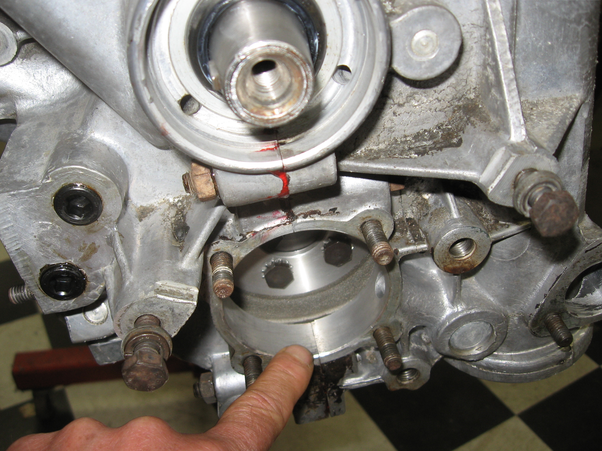

Before we install the flywheel, clean up the mating surfaces and remove the o ring if it is still there. ( don't forget to install the new o ring from the gasket set before final installation of the flywheel)
clean well, both mating surfaces.
A good time to clean up and polish the nose that sits in the oil seal. Some fine steel wool works.
I like to polish this area. check for any grooves. Just make sure it's nice and smooth to avoid oil leaks.
Install the flywheel and attempt to torque it. this can be difficult to get to 80 ft.lbs without a flywheel lock, A large flat blade screw driver in the flywheel teeth will work. Get the bolts as tight as you can. Even is more important than getting to actual torque spec. Getting a dial indicator mounted is also tricky when working with just the case half. So. we are going to use a feeler gauge here.
Here we have a nice tight .020in.
Now for some math.
we want to get to .004in (+- .001) to be at spec.
We have .027in in shims. .020in gap. deduct the .004 from the .020in. that we want for our desired end play = .016 shim needed for the 3rd shim. there is no .016 shim, so we use .015 and should end up with .005in for our end play.
You can work various combinations for this. But, in searching various suppliers, they cost between $8-$10 each.so use what you have and determine the shim you need before dropping $'s on a bunch of sizes.

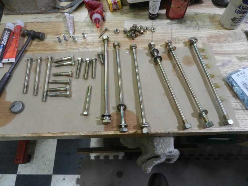

OK. Back to getting the case have ready to assemble. NOTE: we will check end play after assembly again.
First, get all the case hardware together. There are 20 bolts/nuts, including the 6 long thru bolts around the crankshaft.
(you did set them aside
) I had all mine plated, as a local plater will plate a hole bucket full of stuff for $50, and I had a bunch of other grungy stuff to plate. Nice part is, he has to bath them before plating, which saves the time ans mess of my doing it.
ALL the nuts and washers get a little Permatex to seal them up.
Type 4 main thru bolts get this to hold them in place,the bolts install from the case half that is now on it's side.
Don't forget the cam plug.Wipe the circumfrence with some Permatex 3H. One of the few places that RTV is acceptable,if you choose.
Smear some white grease on the gears. This helps cushion and lube things up until we get oil pressure when we first crank it over. Some cam lube on the cam lobes. In the "old days" we used STP for this. Wipe both case halves clean with a rag and brake cleaner.

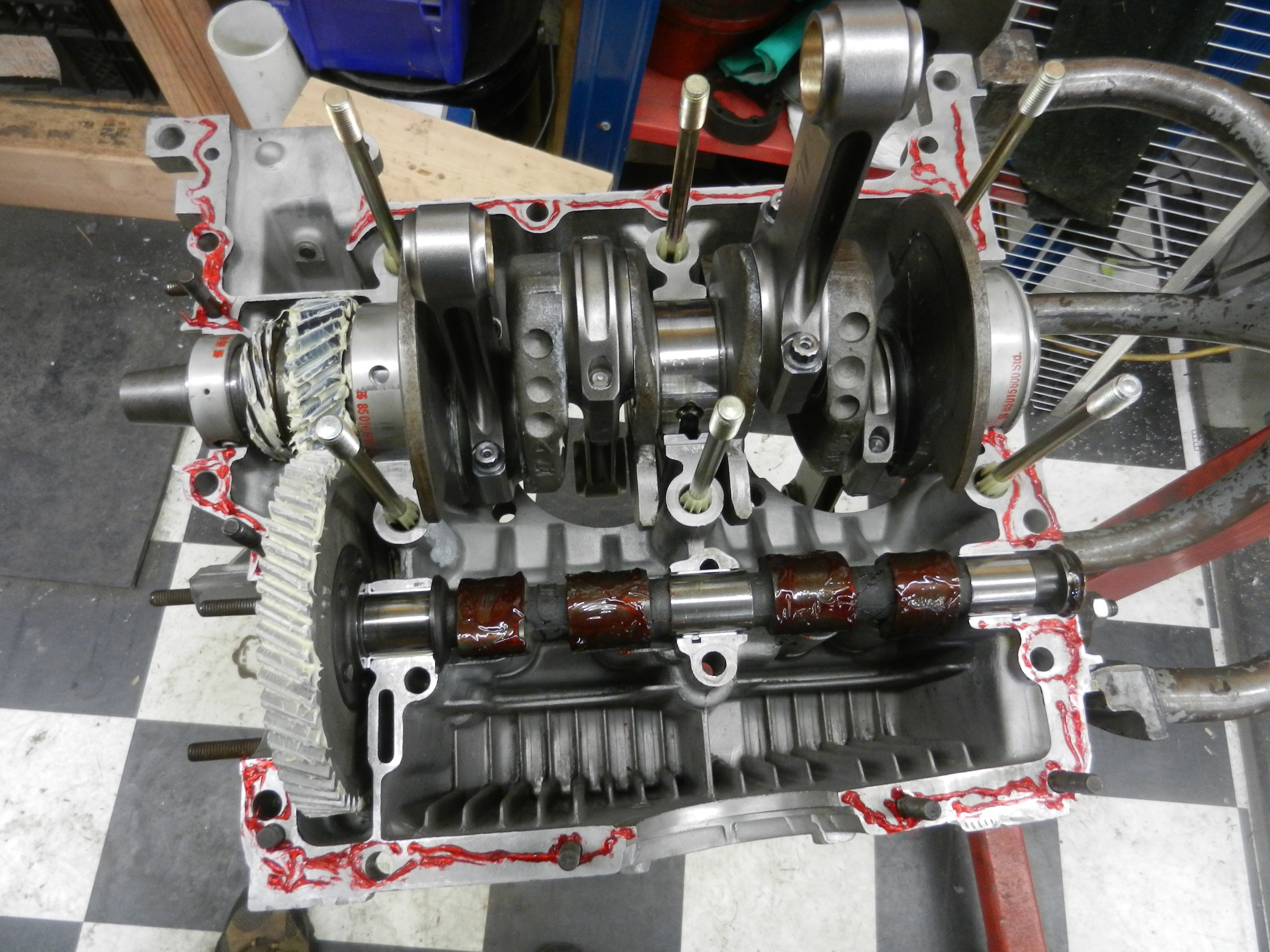

Now we can apply the case parting line sealer. As Bruce mentioned, there are many and they all work, except, NO RTV here. It builds too thick and does not allow for proper bearing crush. I have been using Locktite 518. One case half only. You can smear it around. Short break.

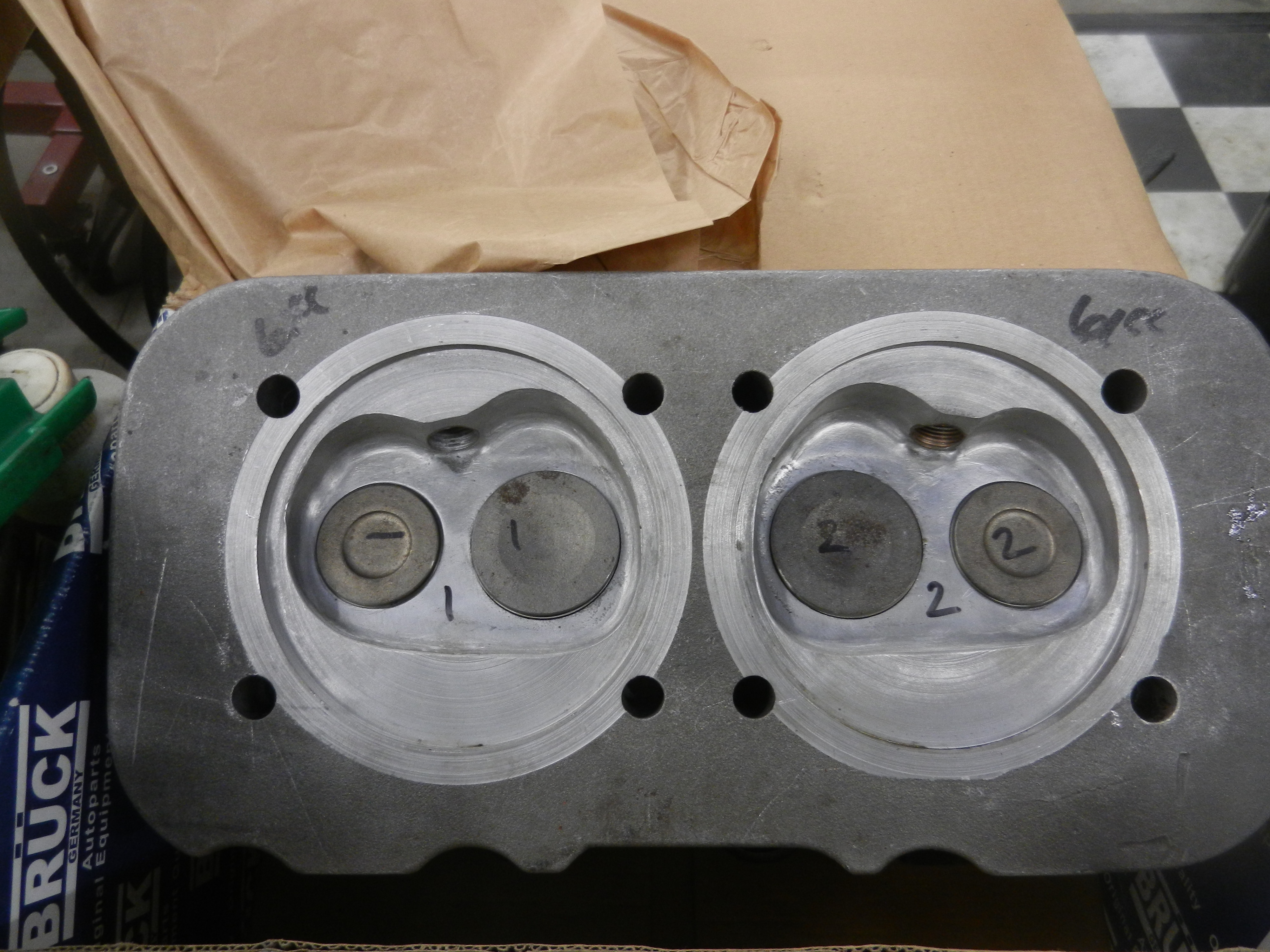

Stock 2 liter head. My head. My original intent was to use stock 94mm 2L pistons which have a 7cc dish. plugging the 61cc head chamber volume along with my desired deck ht. of .035 to .40, I realized that my comp ration would be too low, under 7:1
So, while the heads were sent off to Delzani's to install my new stainless steel valves and the valve springs supplied by the cam manufacture, I explored my options.
Option 1 was to use 914 Euro spec 94mm flat top pistons. This pic is not the 94mm flat top but shows the deck ht. .001 not clamped down. .000 was the measurement clamped. This was an unintended result of decking the case. But worked, as I could now choose the appropriate shim to get my desired deck ht. and comp ratio.Assuming a .030 deck shim. I came up with 8.4:1 comp ratio. acceptable, but I tend to be conservative when it comes to comp ratio for a bus. .040 deck shim got me 8.2:1. Again acceptable but I was shooting for under 8:1
Option 2 was to use 96mm NPR dished pistons. Using a .040 shim, for .040 deck ht( The max I would accept), I ended up at 7.72:1 comp ratio. Larger displacement 2.1 liter and a comp ratio I can live with.
Just a word on deck ht. In addition to being part of the comp ratio formula, There is a happy number. Too low deck ht and you run into the problem of the piston hitting the bottom of the combustion camber, BAD. Too much deck ht and you have an issue with "squish" The goal is to have the combustion energy directed to the center of the combustion camber and the center of the piston. Too much deck ht and too much of this energy extends to the outer area of the chamber and the pistons putting more stress on the rings and the sealing area between the cylinder and the head.
Mark Stephens determined that somewhere between .020 and .025 deck ht became 0 on fully warmed aircooled VW motor. Making .030 to .040 ideal. This means that on a fully warmed engine, the comp ratio is going to be higher than your cold calculations. Also, eventual carbon build up decreases the chamber volume which also increase you comp ratio. This is why I tend to be conservative on comp ratio and like to be a bit under 8:1.
We will get back to this when we get back to the heads. Next up will be piston prep.

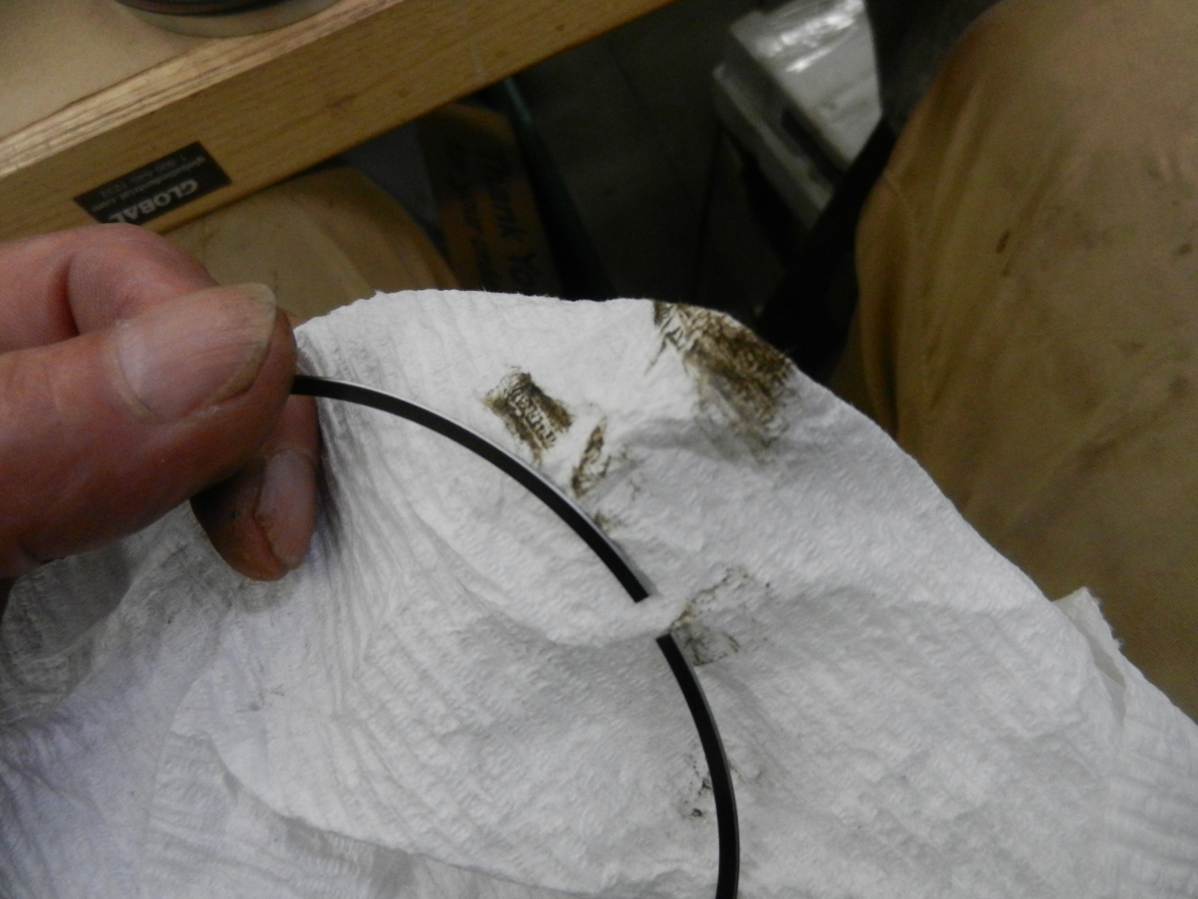

Next, we will remove the rings from the piston. I do the same cleaning with them as with the cylinders. It is best to do one piston at a time so you don't mix the top and middle ring. Then, wipe the rings with brake clean. Since this set came with rings, there should be no need to to check some measurements. But, we are going to do it anyway. This MUST be done if you are re ringing a set of pistons.
Install the ring ( top or bottom) in the cylinder and square it with the piston. Using a feeler gauge, measure the gap. Spec for the top ring is .014 -.022. We are .017 Do the same for the middle ring. spec is .012 - .022. I did not do this as I am using Total Seal gapless middle rings.
