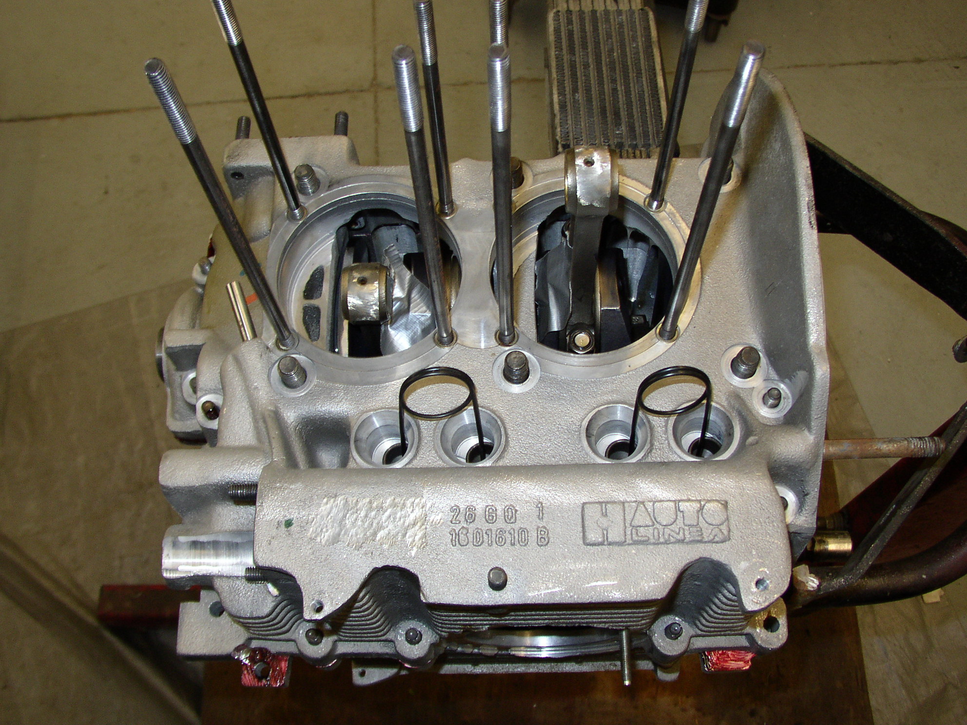

I miked the crank bearings, they measured exactly the same as a new set I have on the shelf. I did change out the cam bearings, chucked up the cam and polished the journals with 1000 grit to a fine mirror finish.
I had some machine work done on the cam for clearance for the stroker crank, new German lifters go on the cam with the gooey lube, clean the flanges with brakeclean and seal the case...
And it goes together, it spins as free as a bird.
Pics of the 92s next to a stock 85.5.
This engine only had a couple of thousand miles on it so it's like new inside. Not only did the mains show no wear but the rings are a tight .017" which is probably .015 or .016" actually. Spec is .012-.018" with a wear limit of .035" so they qualify as "new". There was zero carbon in the ring grooves, which is important for ring sealing. Jugs look perfect with hone marks still present so I'm not messing with them.
Lube and install the rings, clean the case deck and base of the jugs with brakeclean and put a smear of RTV on the base of the jugs.
Heads go on with a bit of Permatex under the lower washers to prevent oil seeping from the stud area.
Reseal the CB/JayCee adjustable pushrods.
As soon as I install heads and jugs I always pressure test or do a leakdown to verify the cylinders are tight. This is as tight as it gets, only a few % leakage on all 4.

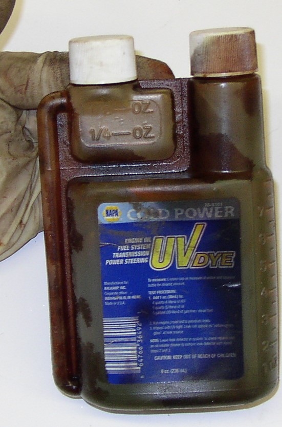

Well, not exactly zero leaks. :( I cheated and did not pull P&C #3and 4 off to change the cam and it bit me. After several hours on the run stand jugs #3 and 4 started leaking where they join the case. Because it's a big bore the sealing flange is very thin there near the studs so I think that's where it was seeping. Very little leakage, definitely acceptable to many people but it's winter and there's no rush to complete it.
I used a UV dye light and Napa UV oil to locate it.
It's difficult to shoot pictures of UV leaks with a camera but here's what a couple of drops of oil look like on the floor and the head looks like during teardown.

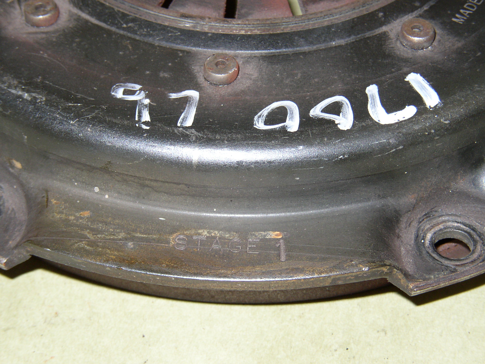

Wow, I've been challenged by a tough one here. The 2180 is bone dry, has 10+ hours on the run stand to prove it, and is ready to go in. I prep the flywheel and pressure plate with a DA like I always do. I put the 1700 lb Kennedy Stage 1 clutch PP I used on it in the Ghia with a new solid hub disc and stick it in. Everything is great except the clutch chatters like a bitch on engagement. :evil:

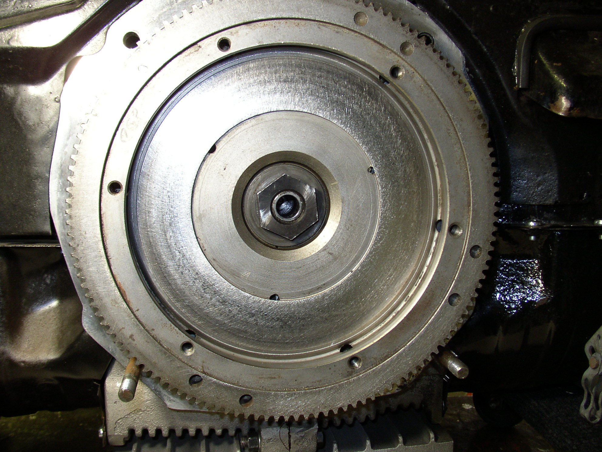

Back out it comes. From prior experience 90% of the time you have chatter the problem is the disc, I have a new spring hub disc in stock so I figured I'd try that. For S&G I checked runout of the FW, it's .000" with .005" end play in the crank.
NFG, still chatters like a bitch.
The Bowden tube "looks" OK, it's OEM and only 5 years old but let's take a closer look, Maybe the slack isn't enough so let's pull it out (not always easy :roll: I had to loosen the powertrain and move it back like I'm doing a tranny mount), I have a new one in stock so let's put that in and shim it correctly. The cable looks like brand new and is well lubed.
Back out with the engine, I'll put the stock clutch from the 1904 on it even though I know it probably won't hold the 2180.

Examining the PP shows nothing, it has only a few thousand miles on it when in the Ghia and worked great. The collar is level, the spring is not cracked, no visual cues.
I DA the FW and PP again, the gland nut bearing feels great, I always put a dab of high temp silicone grease in them before installation.
It doesn't chatter with the stock PP in it driving it around the parking lot. (YEA!) I can't really drive it on the road because of salt right now to see if it will hold the torque of the engine, but I doubt it will. I put about 200 miles on it last weekend when the roads were dry and it runs great!
I emailed Kennedy to see if they can test the PP and tell me why it's chattering. I see a new clutch in my future.
