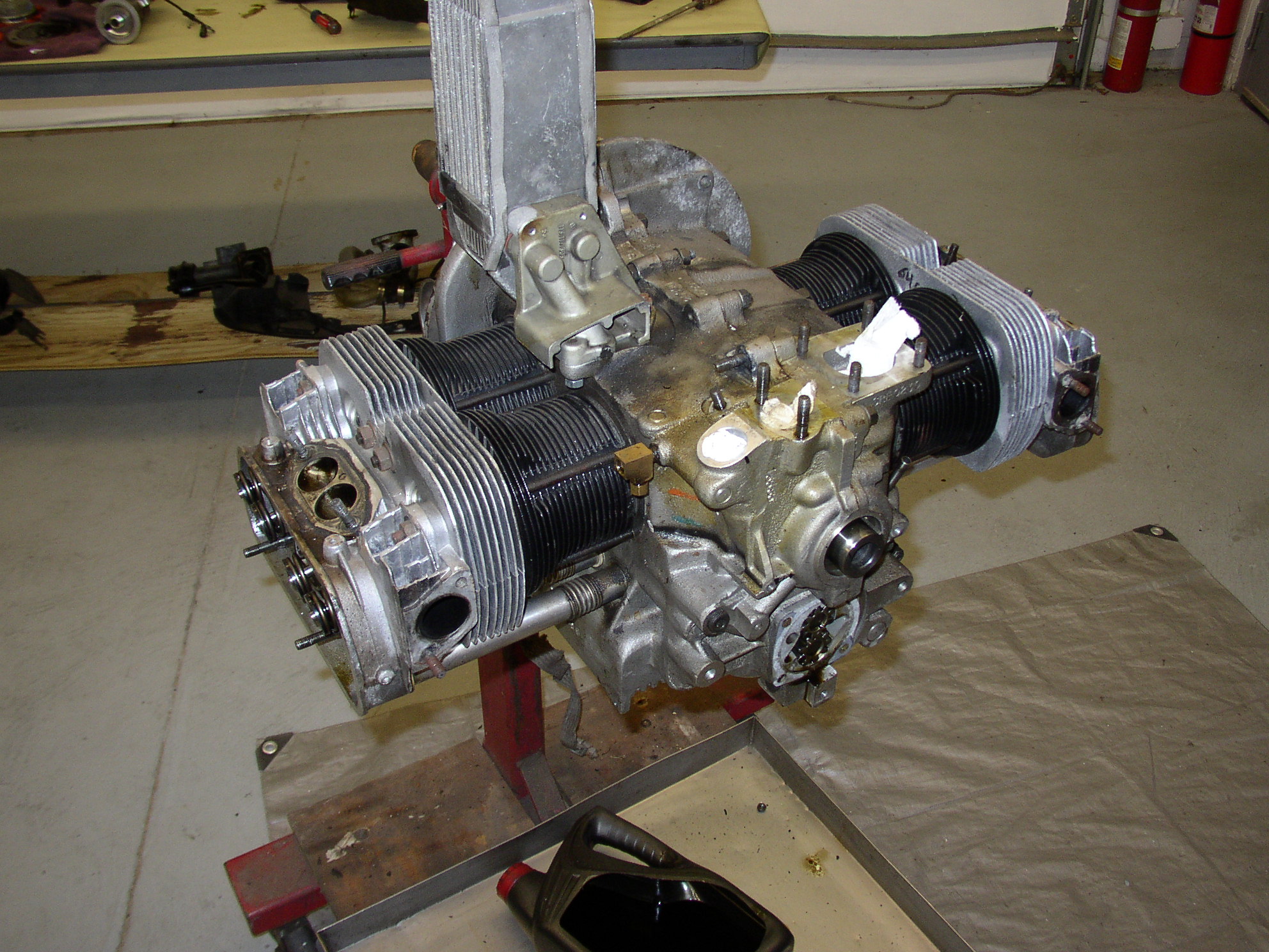

The site's been kind of slow lately so I'll post some pics of what I'm doing. I had Tom Simpson build a 2180 over 10 years ago for my Ghia with a new case and all new parts inside, pretty stout for what it got for carburation. It has a W110 cam and CB 044 big valve heads. It probably only makes 80-90hp with a single Zenith 32NDIX but could easily top 150HP with a hotter cam and twin carbs. I'm pretty conservative on engine stuff and IMO a W110 is a great cam for a light sedan like the Ghia but not really suited for a big heavy bus. Yea, I know guys who run that (or hotter) cam in a bus, but that's not me. I like low end torque right off the line so both of my busses have the Eagle 2280 in them which I really like. When I went to sell the Ghia nobody wanted to pay up for the 2180 so it wouldn't sell, I put a fresh stock engine in it and it sold immediately. I thoroughly oiled the 2180 and it's been on the shelf for a few years.
Time to dig it out and put it back into service, I did a leakdown test before teardown and it was very tight.

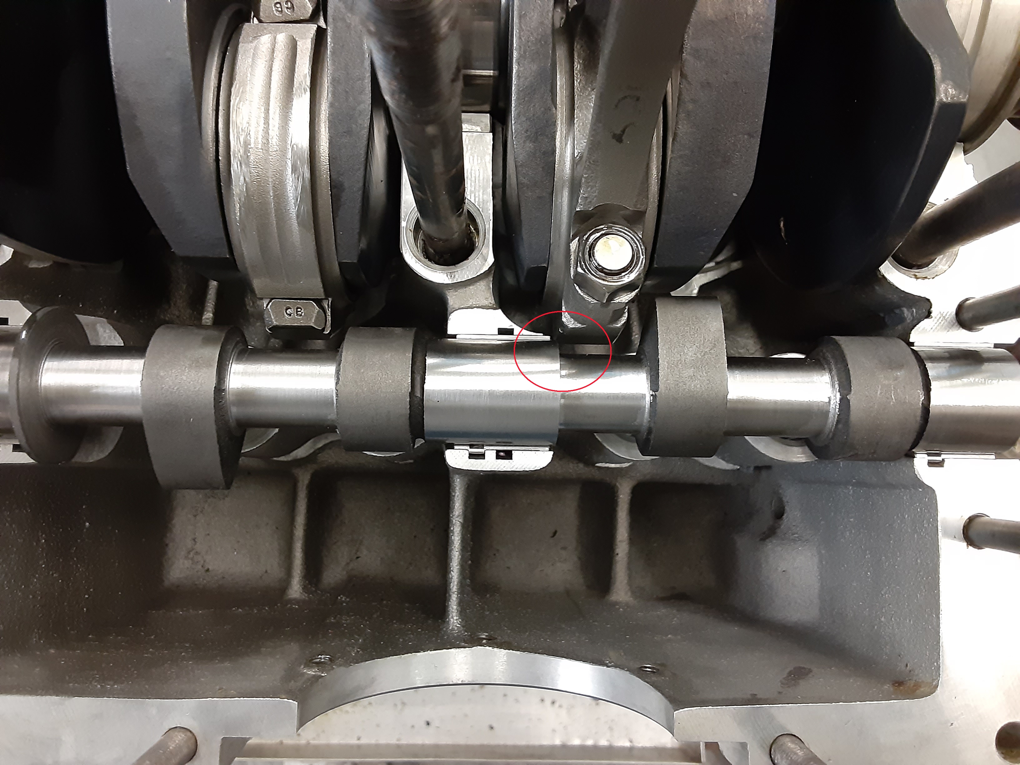

To change the cam you obviously have to split the case. Many would do a full teardown but I'll cheat and only pull the right side off since it has low miles on it. :mrgreen:
I checked the mains and rods and they look like new but they're Kolbenschmidt bearings. Unfortunately they're not easy to find so it got Silverline cam bearings which show some wear. I'm not sure if this is from low quality bearings or the journal surface on the cam was not perfect but it's not a big deal. I'll replace them and polish the new cam journals with 1000-2000 grit to a mirror surface.
The cam has to be machined for clearance on a stroker engine because the con rods pass right near the cam, I had a buddy cut it on a lathe for clearance between the lobes. I see it's still a little close near the center so I'll have him shorten up the center journal about .030".

Is that JB weld on the cyl studs that are tapped through the case?
