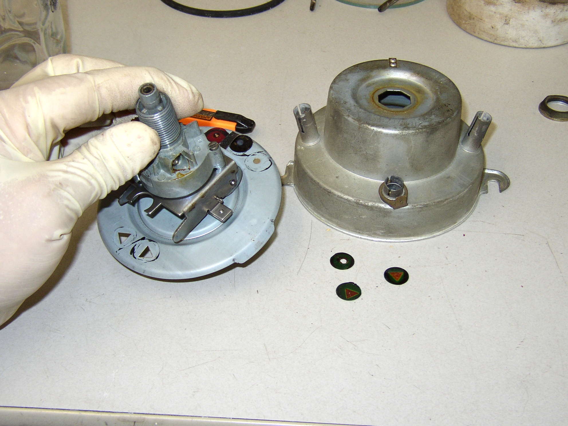

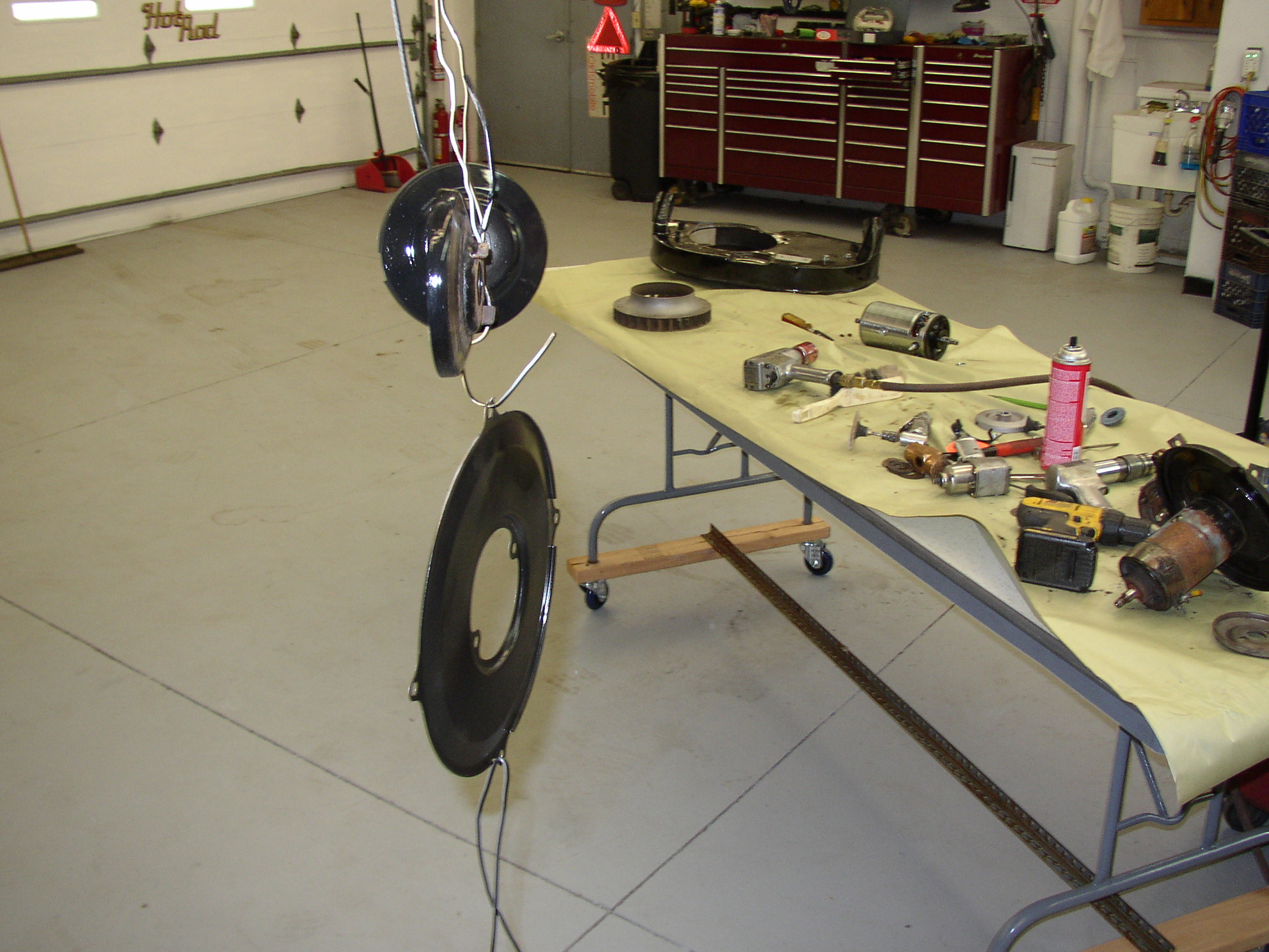

FNG wire wheeling, bead blasting, and painting parts. It's hard to find good help these days, the last FNG only lasted a couple of weeks. FNG assembling the headlight buckets. Pretty much all parts are dedicated left or right so make sure you keep them straight and mark them top and bottom to make it easier to assemble. Heat any grommets to make them more pliable to install. Meanwhile I was doing the speedo head, when I took it apart the colored gels fell out, which is pretty much normal. I bead blasted the can, buffed the chrome trim ring, cleaned things up and glued in new gels with weatherstrip adhesive. I had the FNG bead blast all of the sockets and put in new 12v bulbs. I always test them for about 30 seconds each to make sure the bulbs are good and everything is super. Here's a before and after picture. After installation with the power on.

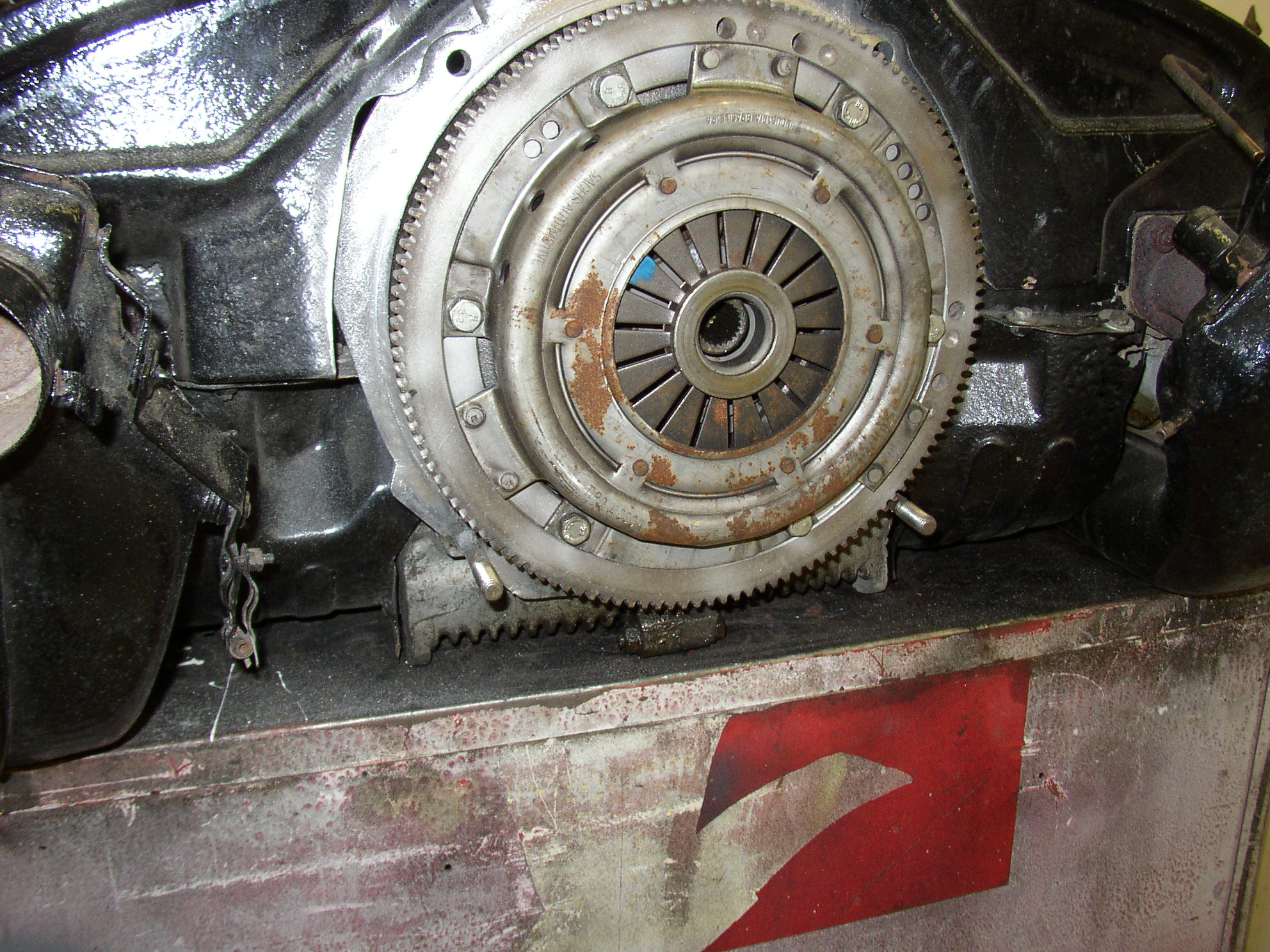

Here we're putting the bigger gen stand on, brand new 12v gen from Mick, replacing the flywheel, torqueing it. The flywheel was a used 12v so I blasted it and DA'd the friction surface with 120 grit. I checked end play before and after, it was the same.

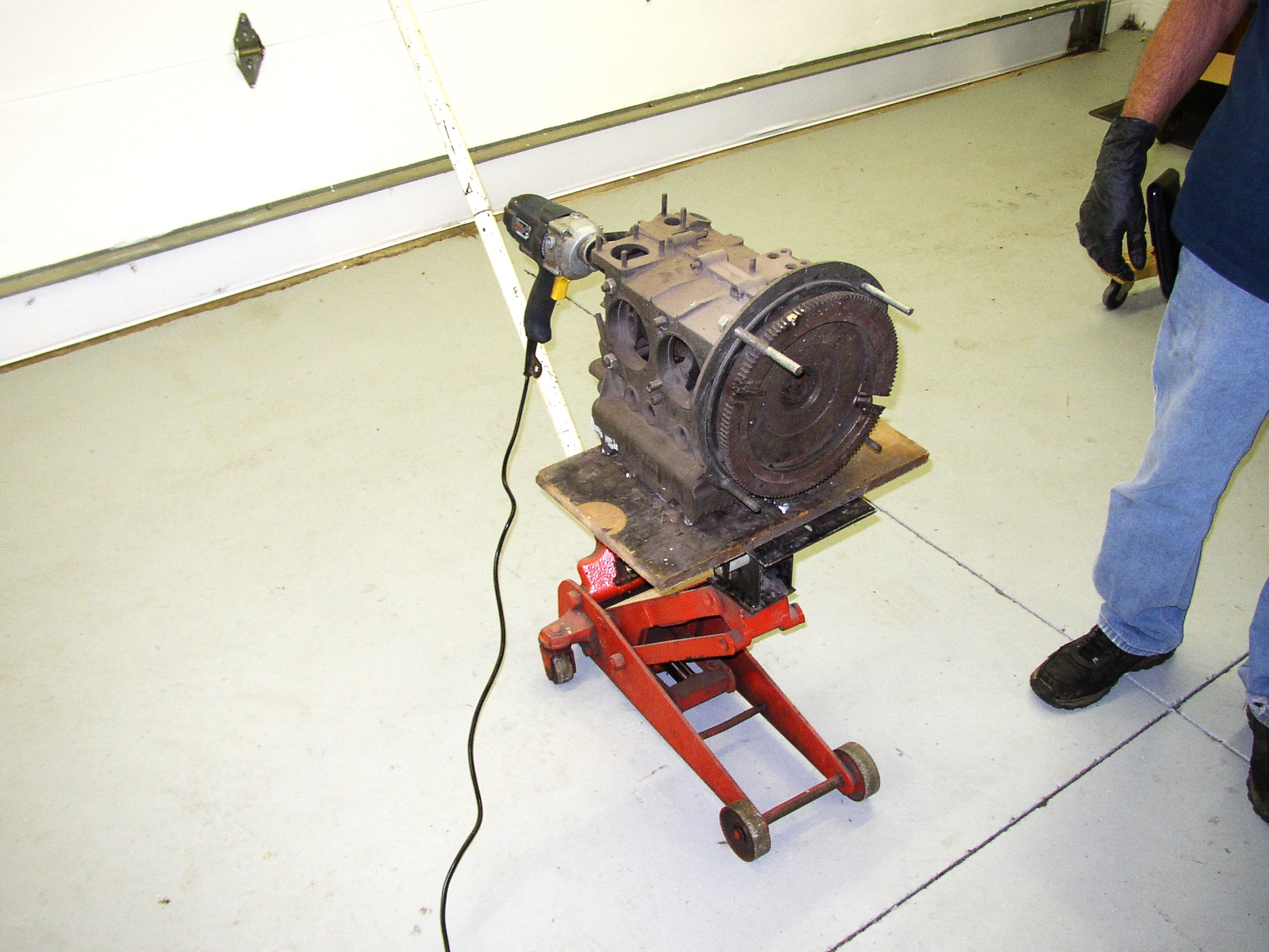

I wire wheeled the lower engine studs so you can spin the nuts with your fingers when the motor goes in.
Test running the engine to make sure the gen charges, light works, fan doesn't rub, etc. Exhaust pipe goes to my exhaust fan in the wall.

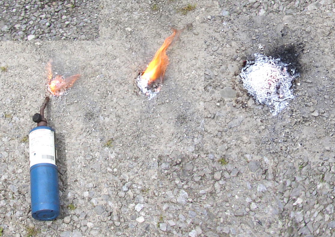

Hmmm, I can't remember if the trans is aluminum or magnesium, let's find out. Take a handful of shavings outside, and yes, it's magnesium. The propane tank is there for size comparison.

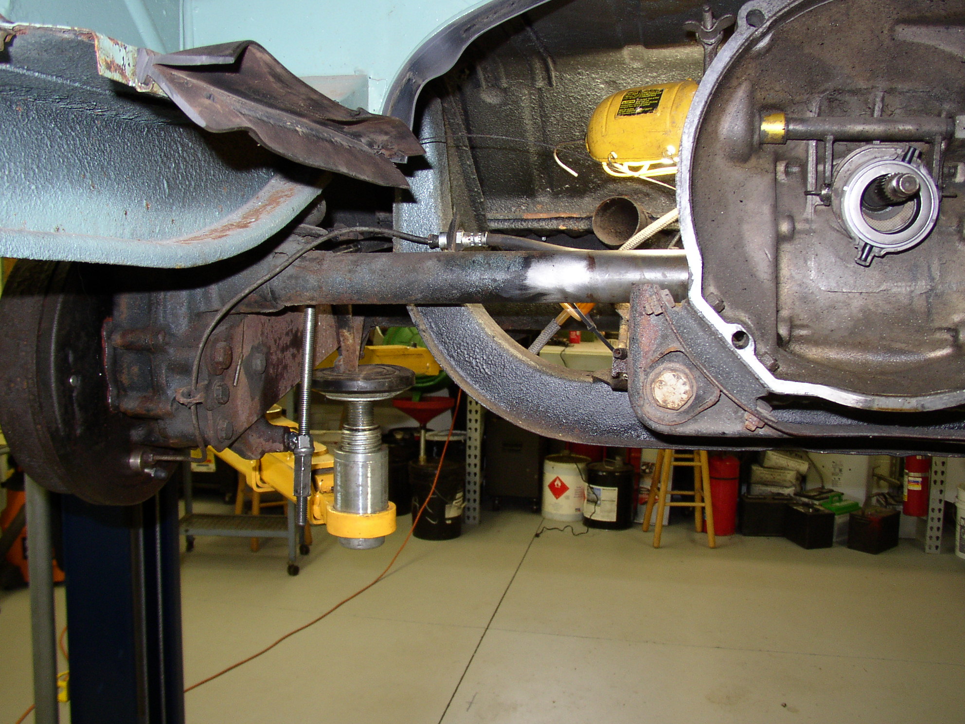

Replacing the torn axle boots requires leveling the axle with my homemade torsion bar compressor tool. Once again, keep hands and feet away from moving parts. If those welds break loose bad things happen and I'm not the best welder.

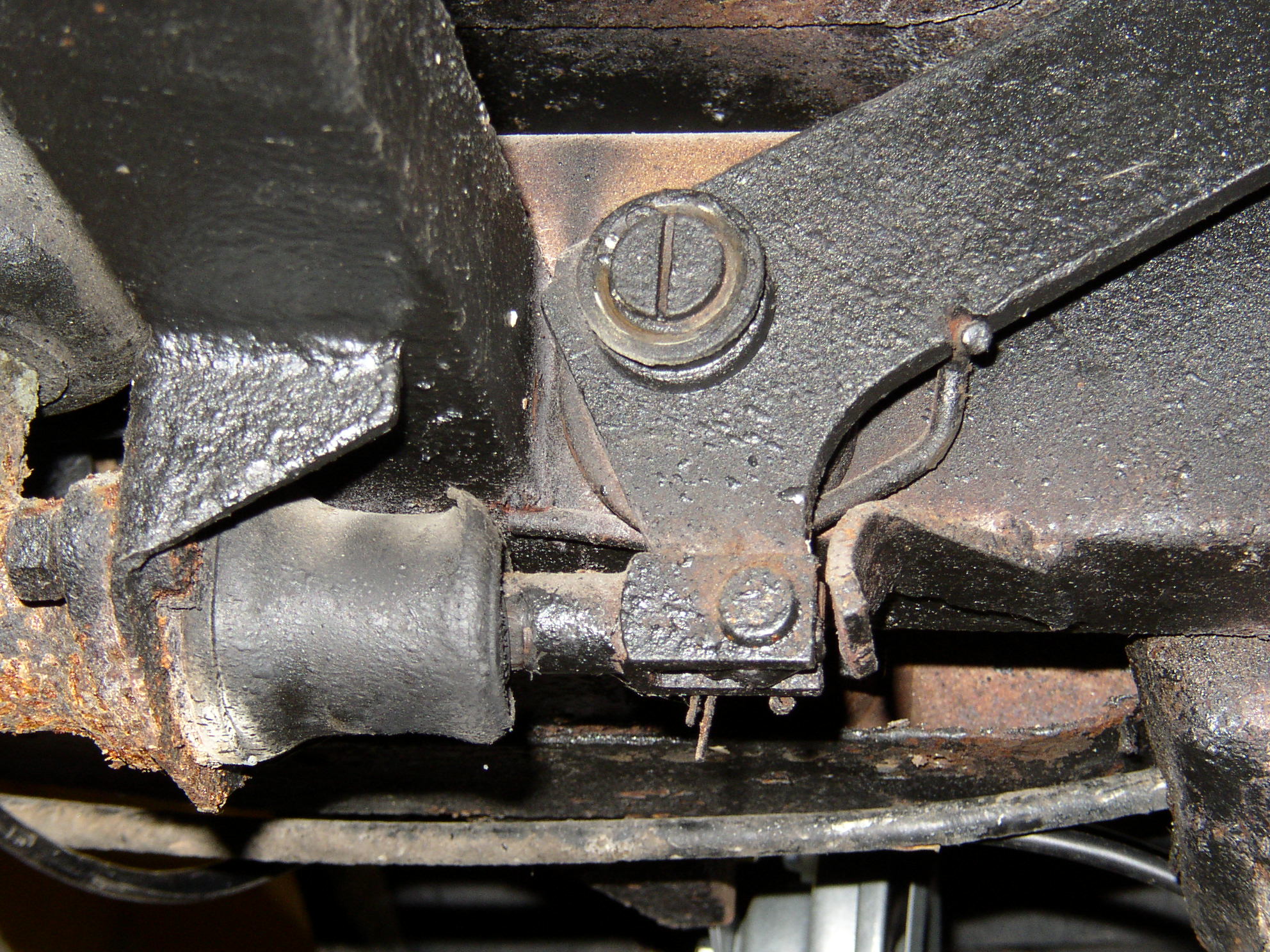

Those stupid upper bell bolts gave me a fight coming out because they turned, so I welded nails to them to prevent that.

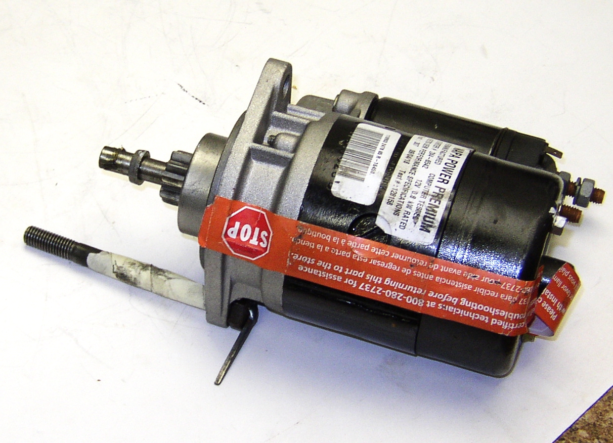

They still need some masking tape to stop them from pushing back as you try to start the nut. The last Napa starter came through as a brand new PM unit, this was a reman German unit.

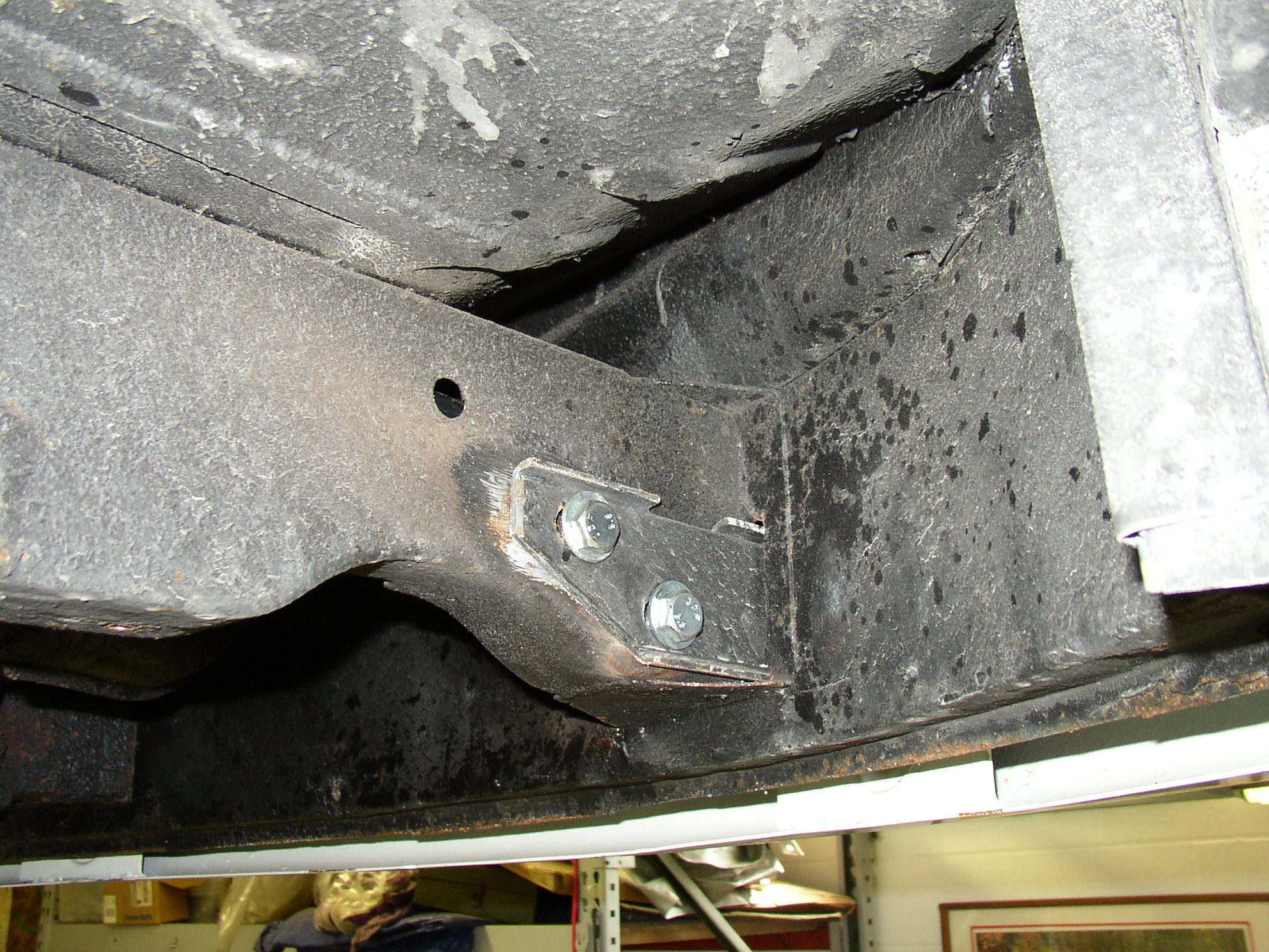

The front bumper was loose and probably rattling, let's take a look. Someone put 8mm bolts through the 10mm weld nuts on both sides and ignored the broken 10mm bolt on the right front. Brother, maybe there's enough stub to grab if I glow it.
I did get it out and chased the threads, cleaned all of the f'ing undercoating from the rail and installed the correct 10mm bolts. I hate undercoating, it does nothing on a classic car but hide bad bodywork, rust and other issues. It's a huge turnoff for me to see undercoating on the bottom of a car.

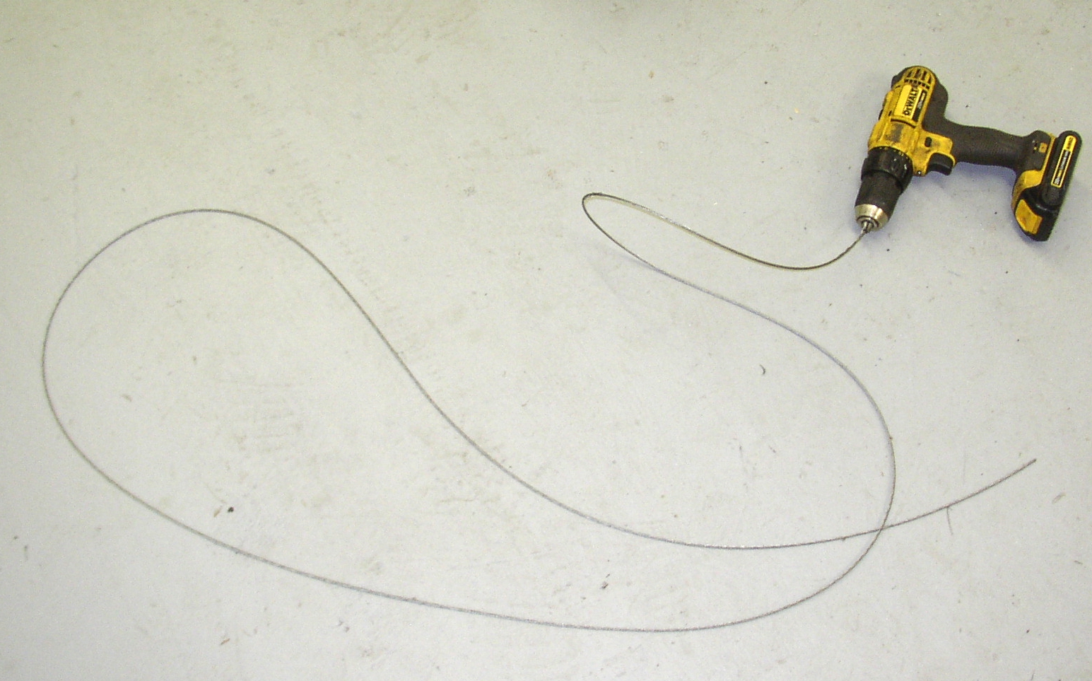

I noticed some other issues while I was working, like the throttle cable binds badly inside the tube, the throttle linkage lever in front was really worn out and one of the spring clips was missing. This shit was also rusted to where it had to be cut off with a whizzer wheel.
I used a long piece of thin wire rope on a drill and brakecleaner to clean out the throttle tube.

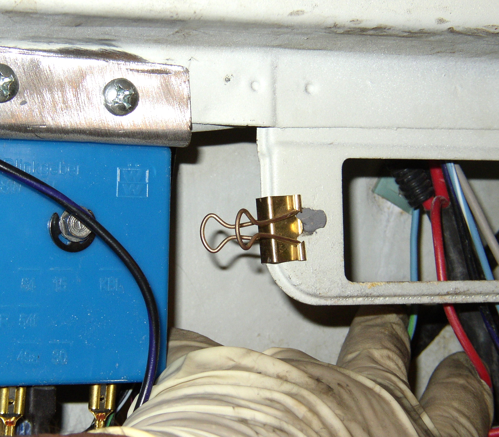

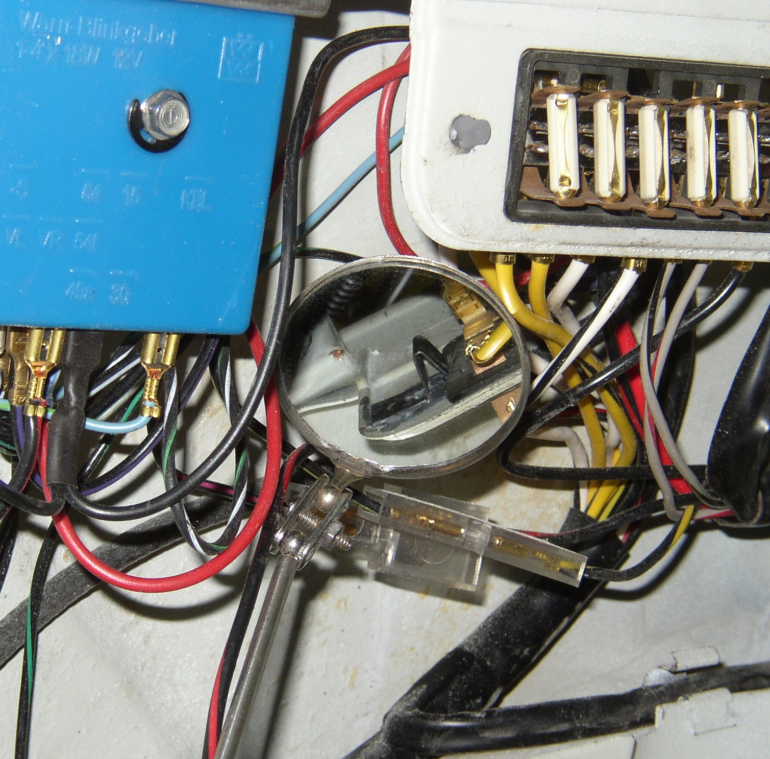

The fusebox clip is a SOB to get right, lately I've been epoxying the clip in place to make sure it doesn't come loose. There's many threads on Samba about this "Jesus" clip.
Here you can see the correct installation in the mirror.

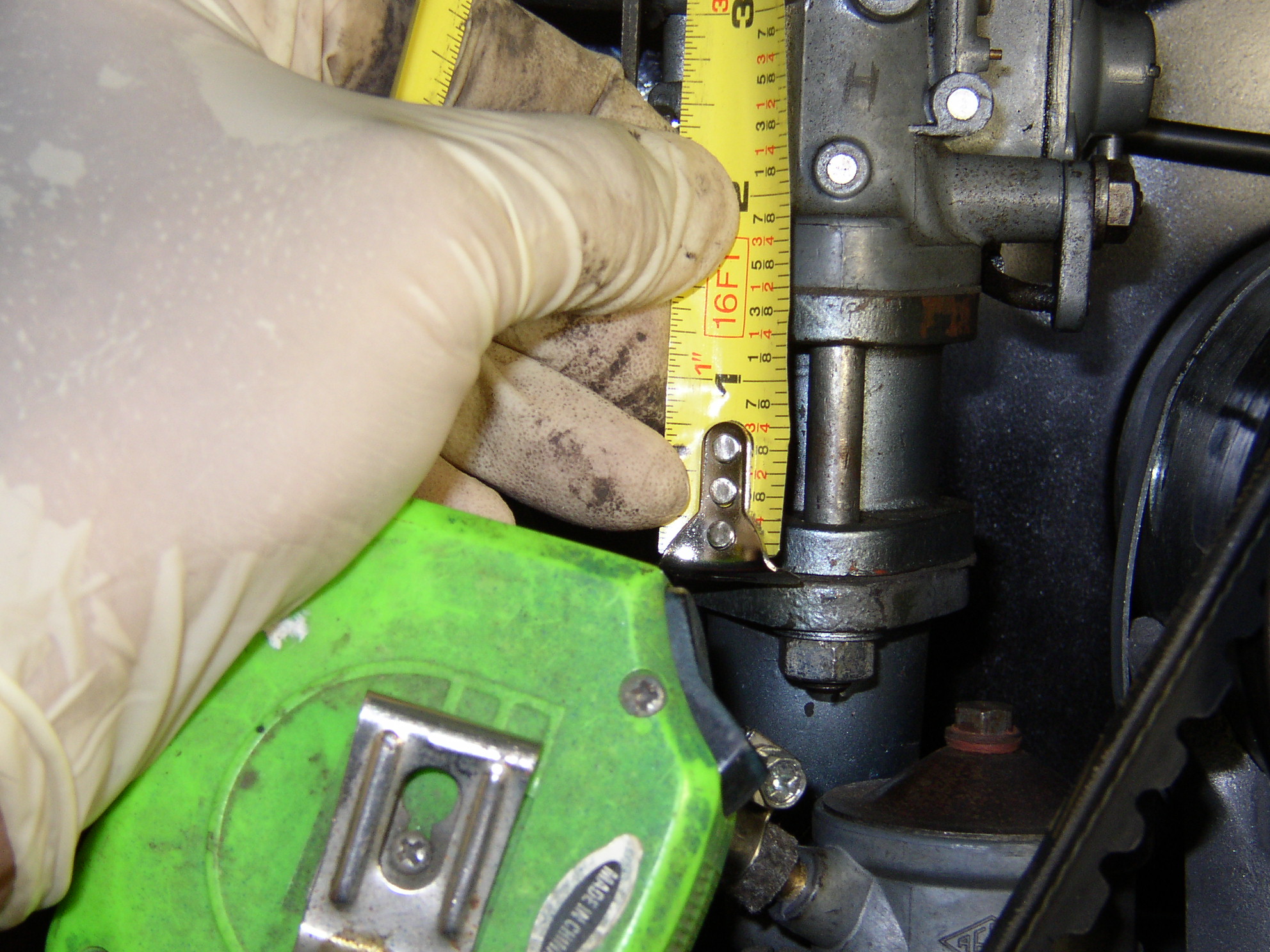

Currently sorting out a problem with the throttle cable to carb alignment, the shroud/manifold/gov spacer don't all agree and the alignment is off by quite a bit requiring an extra return spring to get the carb to idle. I straightened the tube and ordered a 1" spacer to replace the 1.5" spacer which will help a lot. With the 1.5" spacer it's too high, without it it's too low. Ken has a Pic 30 with a built in spring we'll use, that should help even more.
