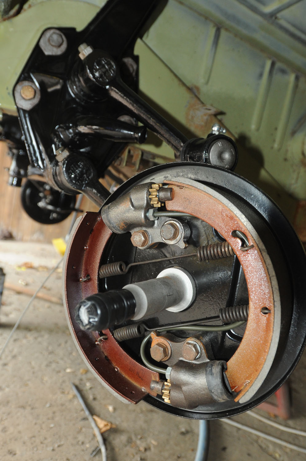

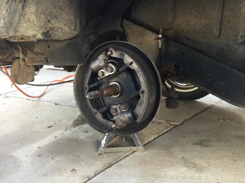

You "probably" have the late brake but here's how to tell.
I don't know how to ID the front spindle/brake without pulling a drum, but here's what to look for with the drum off:
This is an early brake, note the straight spindle and goofy angle of the adjuster vs. the cylinder:
This is a late brake, note the tapered spindle and adjuster parallel to the cylinder:
These are not my busses! If you go back in this thread you'll find pics of my spindles too.
