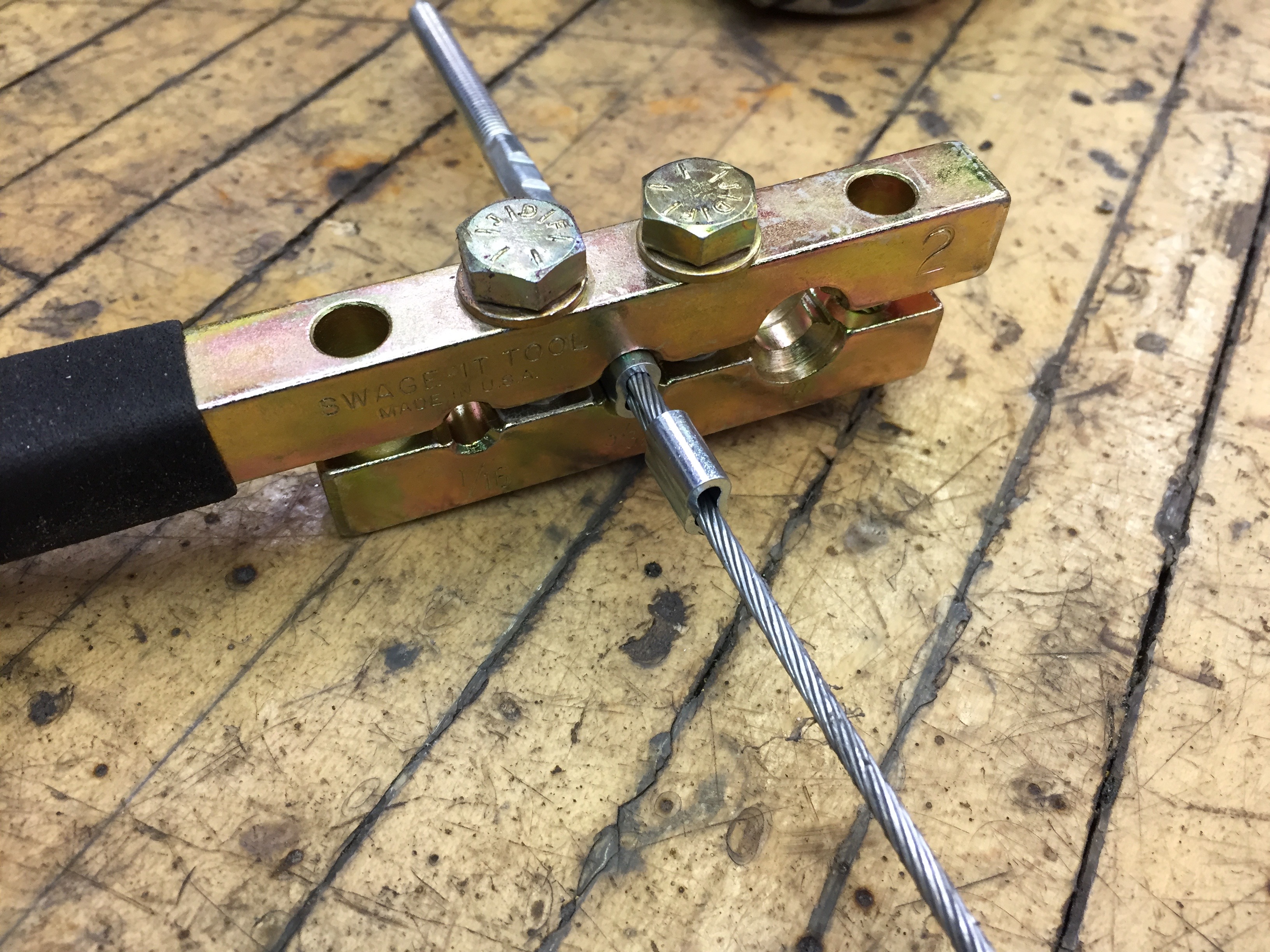

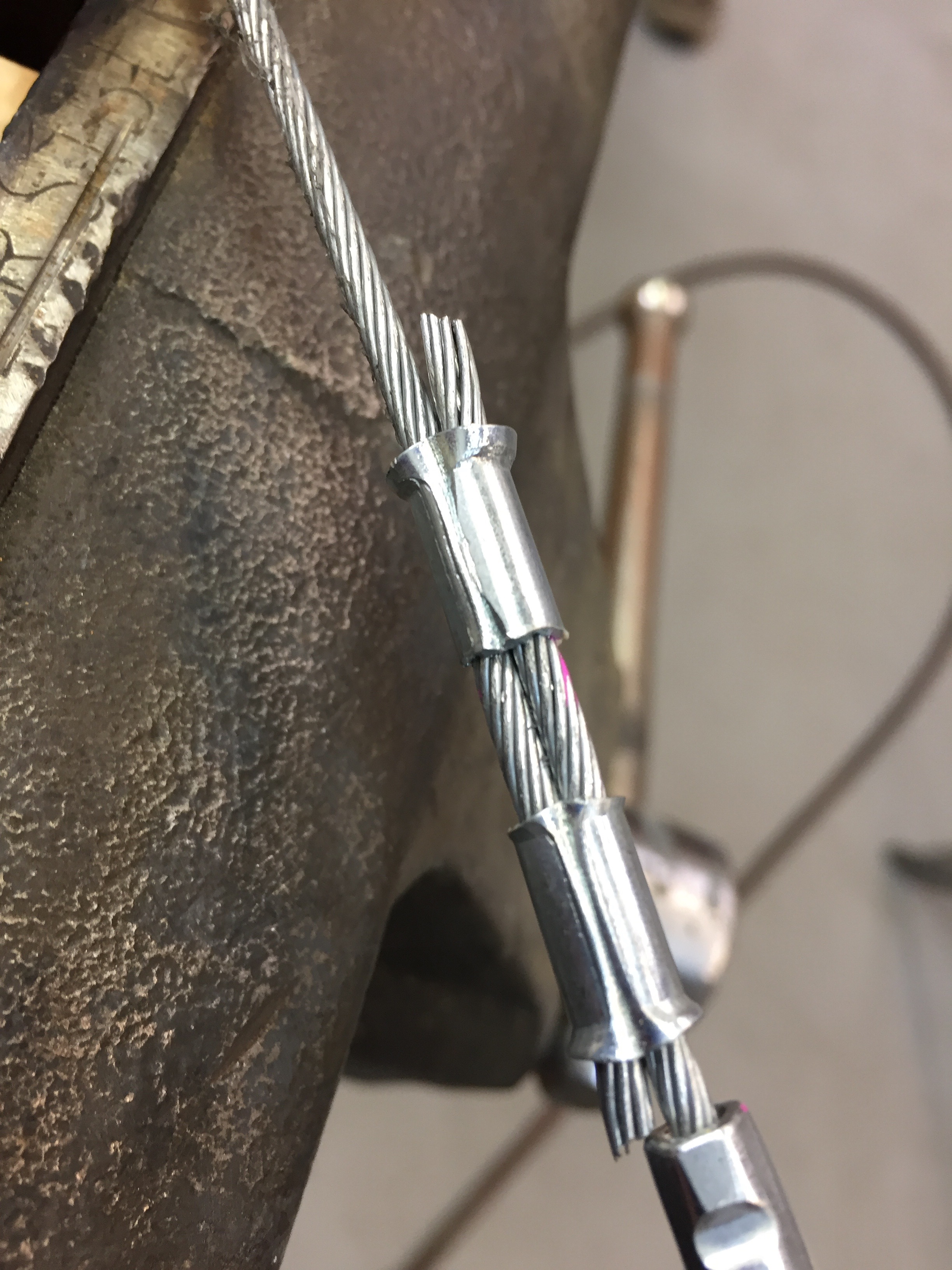

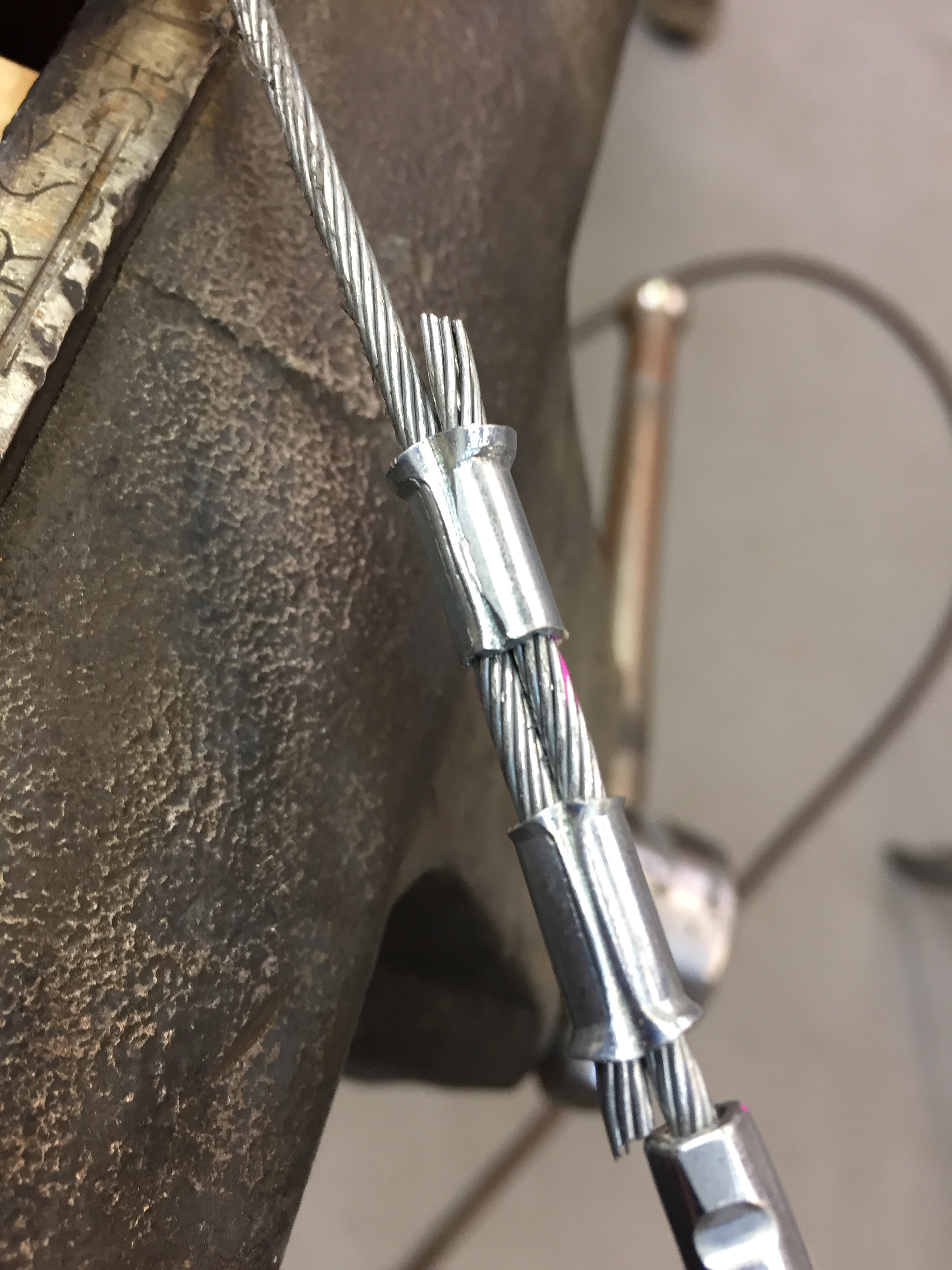

During the course of this upgrade I picked up a "swedge kit" to shorten the cables so they (hopefully) work in an emergency. I got the tip from Aaron (Widefive) and a guy that goes by the name "Glideking" on the samba. He recommended an aircraft supply house who sold a nice little kit with 3/32 swedges that work well with our sized brake cables.
The good news is the kit came with plety of swedges, so if you need to try this in the future I've likely got you covered.
To give you an appreciation of "fit," here's one of Bruce's 185/14 Hankook's next to one of my Thialand 195/15 radials. You wouldn't believe how much bigger these tires are without seeing them next to each other.
The swedge kit is pretty straighforwarded. We doubled it like Glideking did and it fit nicely. Here are a few pics.

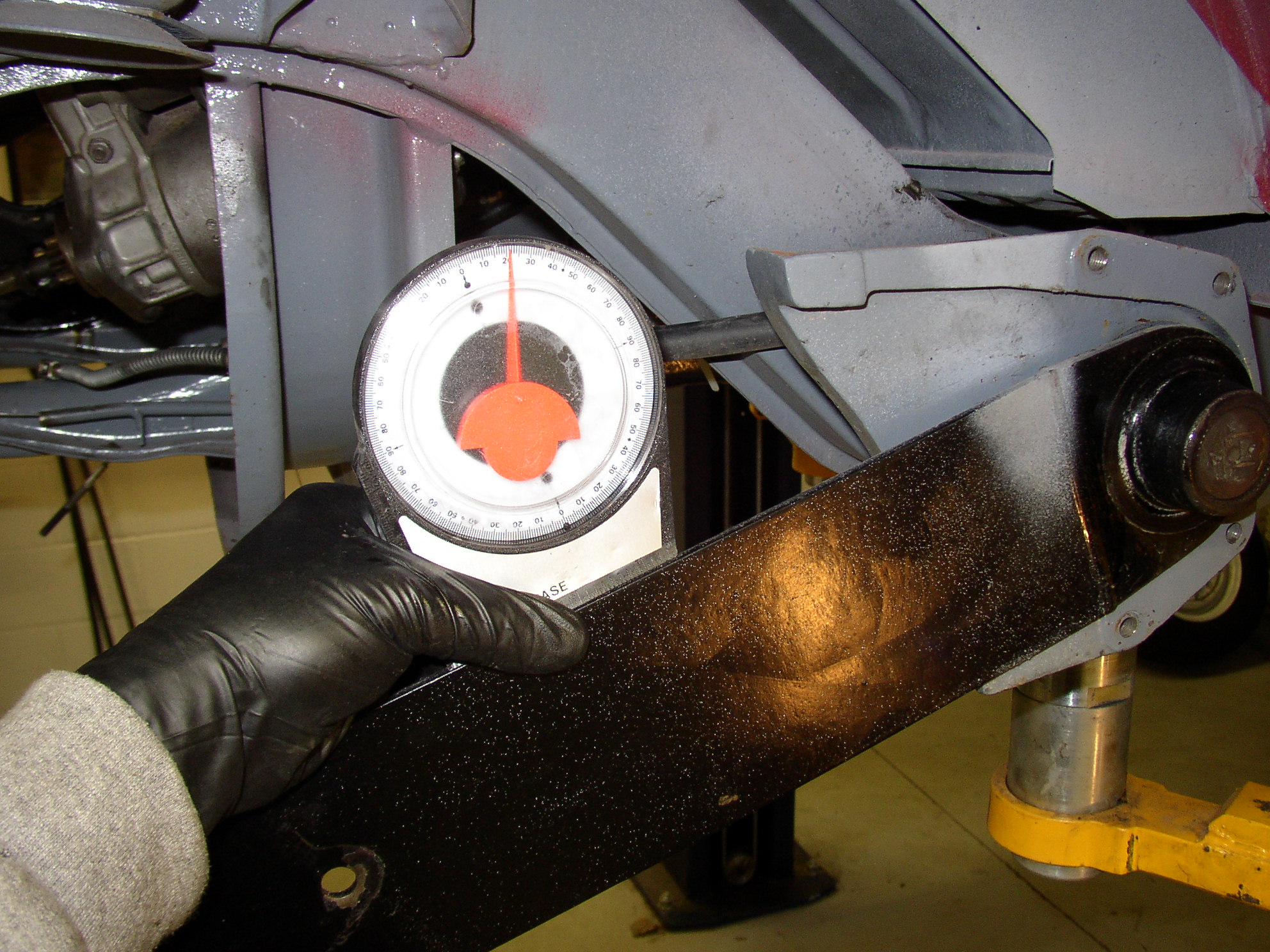

Resetting the camber went smoothly because everything was just apart. Sean helped, we were rushing and I didn't take any pictures so I'll recycle some old ones from my busses to explain:
Measure camber of the tire on a level surface, I measure each wheel/tire 6 ways and take an average of the 6. The inner hub of the wheel seems to be the most accurate. The picture shows the outer wheel rim measuring .8° positive.
Sean's measured about .5° positive on each wheel which is where I like it on '64-7 busses but it makes tire install tough on early busses because the fenderwell is 1.5" lower.
Rack it, burp the bolts, pull the shocks and brake cables, pretty straightforward.
Loosen the spring plates and make your initial baseline measurement. Many guys use dial angle finders but I hate them, too sloppy for my needs.
I find a digital one much more accurate.
Here's the note sheet I was using on Sean's- his wheel camber measured .5° on each wheel and he wanted to go to 2.5° positive on each wheel to get more ride height and tire access. A few years ago I figured out that wheel camber is relative to spring plate angle by a figure of about 1.24. That means to change wheel camber 1° you need to change spring plate angle 1.24°. I came up with this ratio by dividing the effective length of the spring plate by the effective length of the axle.
After the right spring plate was loosened, pulled off the stop and wiggled to get it to settle down, I got a baseline measurement of 18.5°. Sean wanted to increase his camber from .5° to 2.5° which is an increase of 2°. Simple math- multiply the 2° desired change x 1.24 gives you 2.48° increase in angle. His baseline was 18.50° so it's simple- add 2.48 to get the desired spring plate angle. You'll see in my scribble the target is 20.98 or 21° on the spring plate. To give myself some leeway I allow .2° each way from target which means I'll accept 20.8° to 21.2° . I pop the spring plate off and twist the torsion bar randomly until I get in my target window. This is actually pretty quick, within 5 minutes I'll be in the window which is 10-20 tries of the splines. Sean's wheels measure 2.5° on each side when done, perfect.
Every time I've used this equation it's been spot on. And to think I was kicked out of Geometry class in high school!
