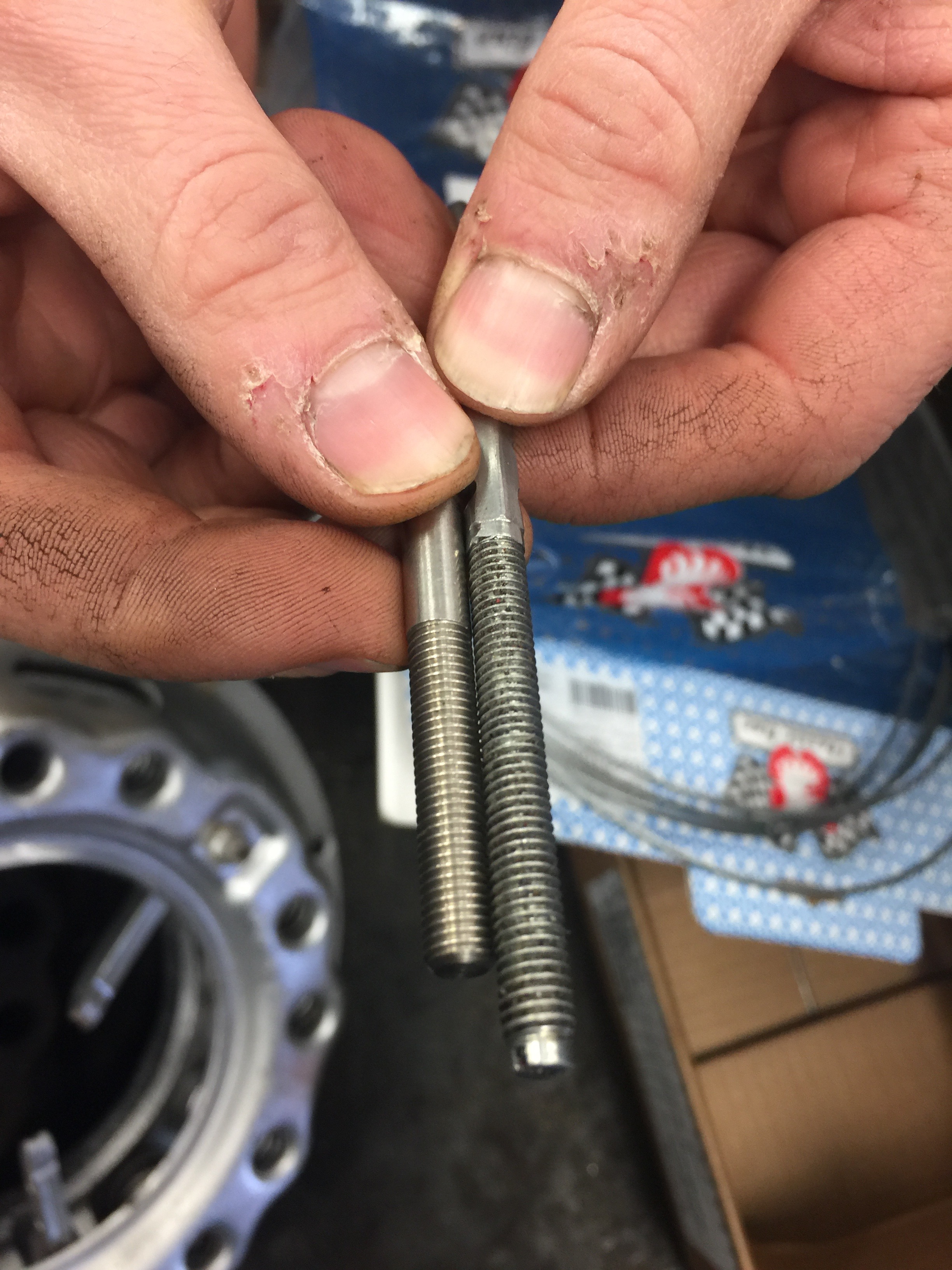

Anyway, I thought I'd try a local reputable clutch company that shall remain nameless and after measuring and cutting have them "swedge" new ends on the cables so they would be like stock. $33 later I've got my shortened cables and the installation goes flawlessly until I pull the brake cable and both "swedges" break free. Thankfully it happened inside the shop and not when I was hurting down a hill at 50mph with no brakes. :shock:

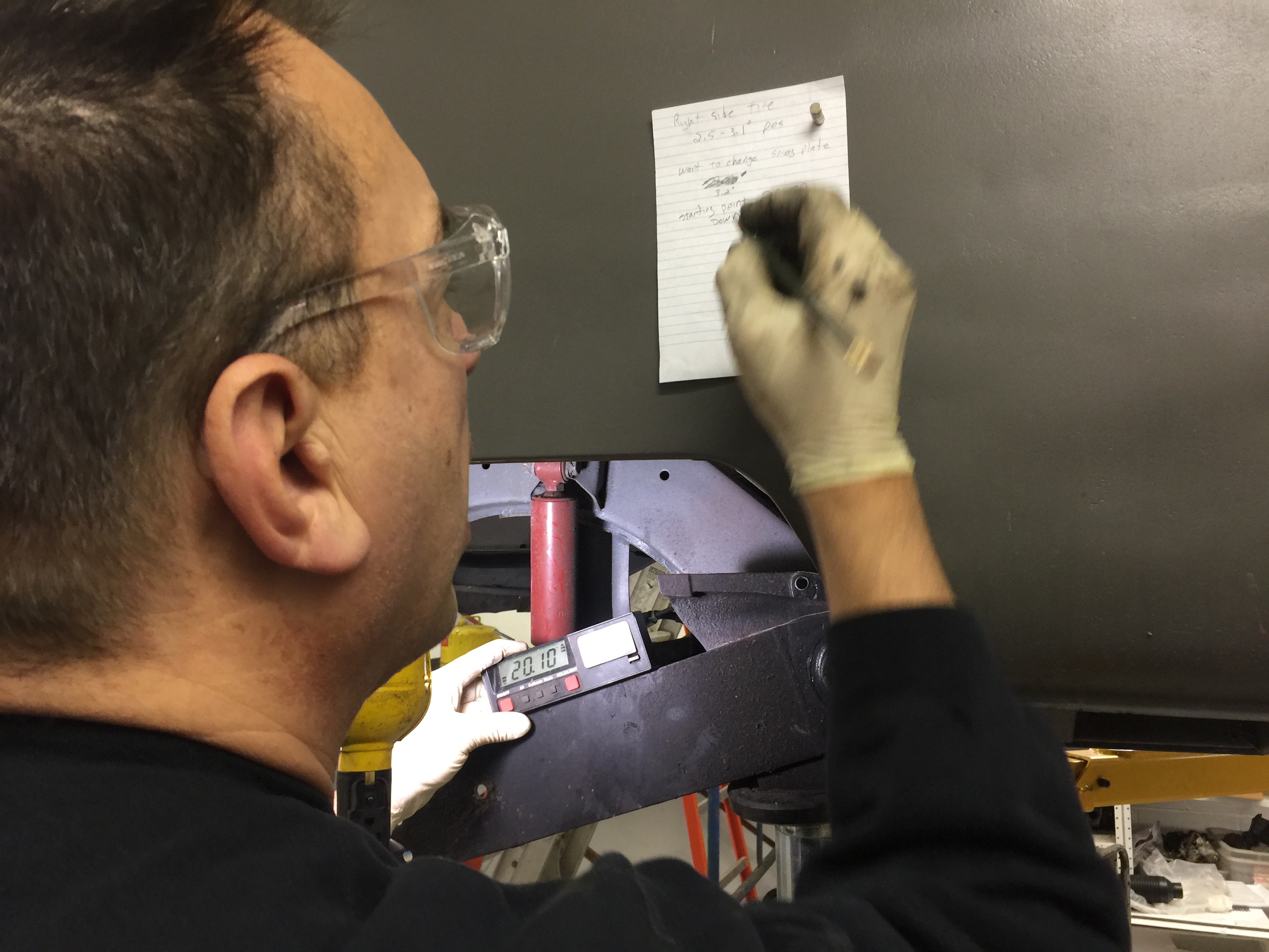

Bruce got the axle seals all buttoned up with a nice technique of leveling the axles with a gizmo he put together. I would not try this at home! :o

This was Bruce's method of leveling the axles.
This was the replacement threaded end that failed (one on left) (I'm going to buy that mechanic some Jergens.)
