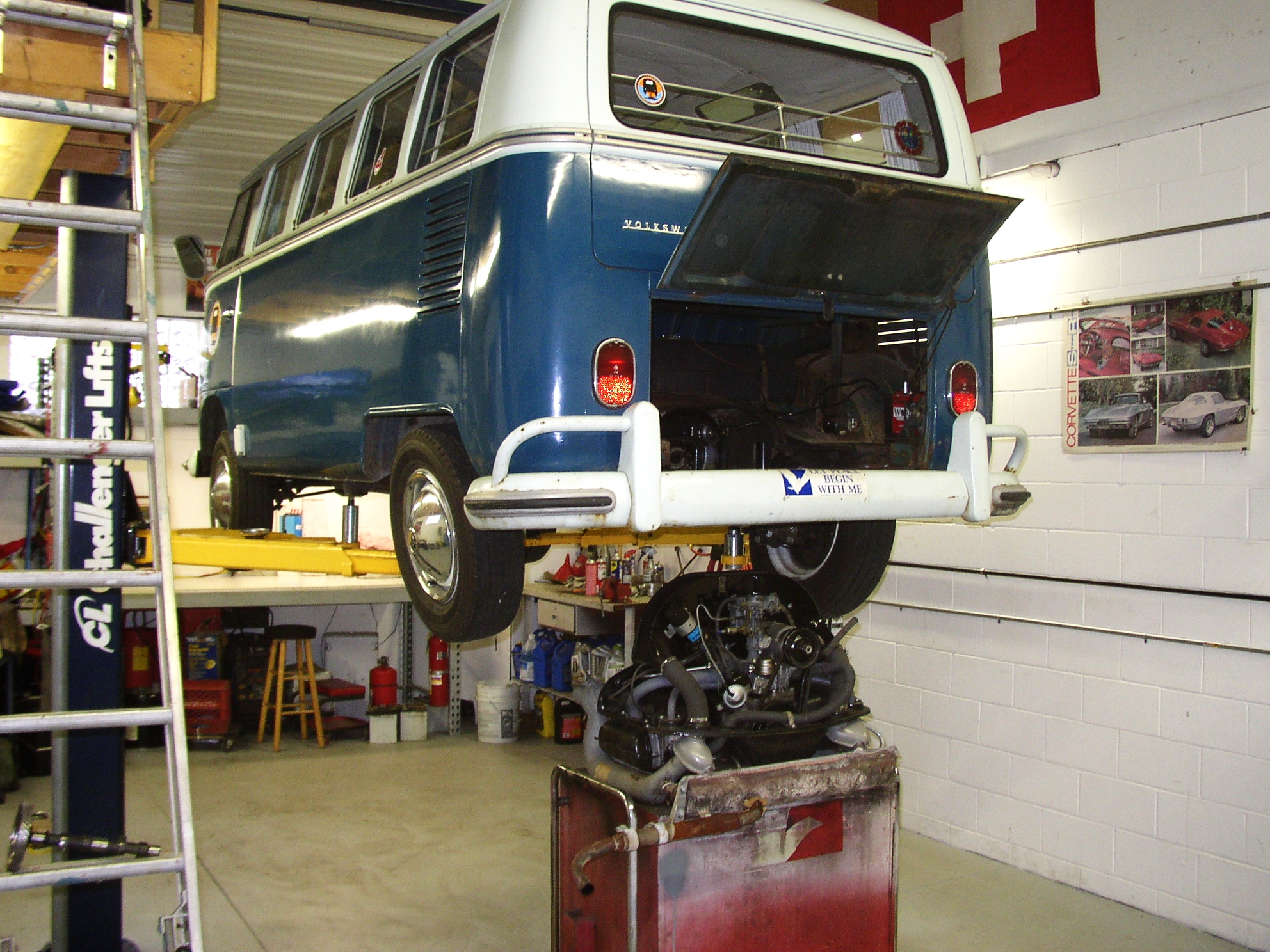

I had Joe and Jackie's bus in for oil leaks, finding a leaky oil cooler and trans input seal. All fixed, bone dry now.
Building a 1600SP for a spare.
Ken's 66 is in for a 12v conversion.
