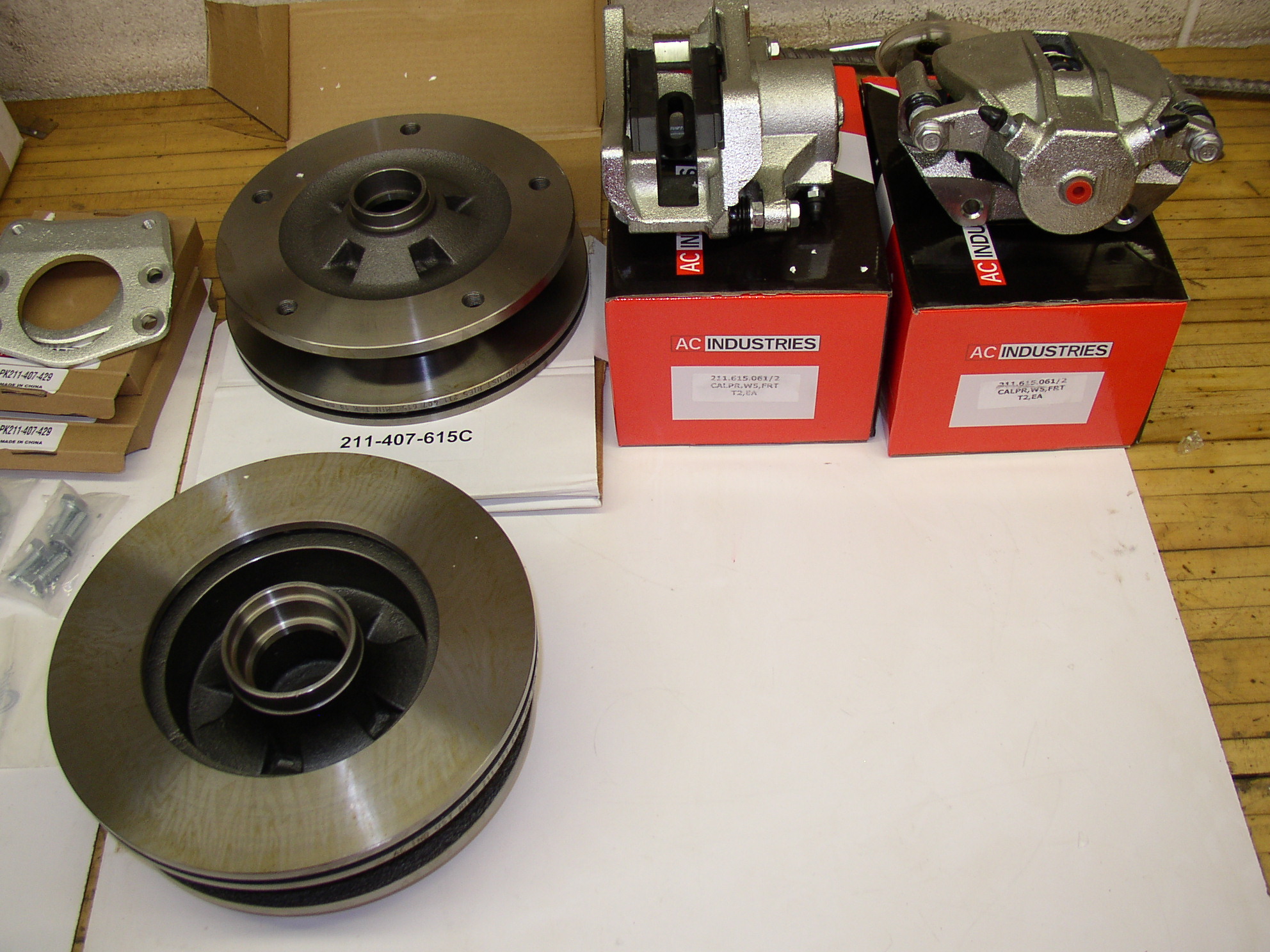

They come complete with new wheel bearings, seals, hardware, MC, reservoir, and hoses. It's all Chinese, here's what they looked like coming out of the boxes:
They claim replacement parts are available locally, but have not responded to my e-mail asking what they fit or industry part numbers.

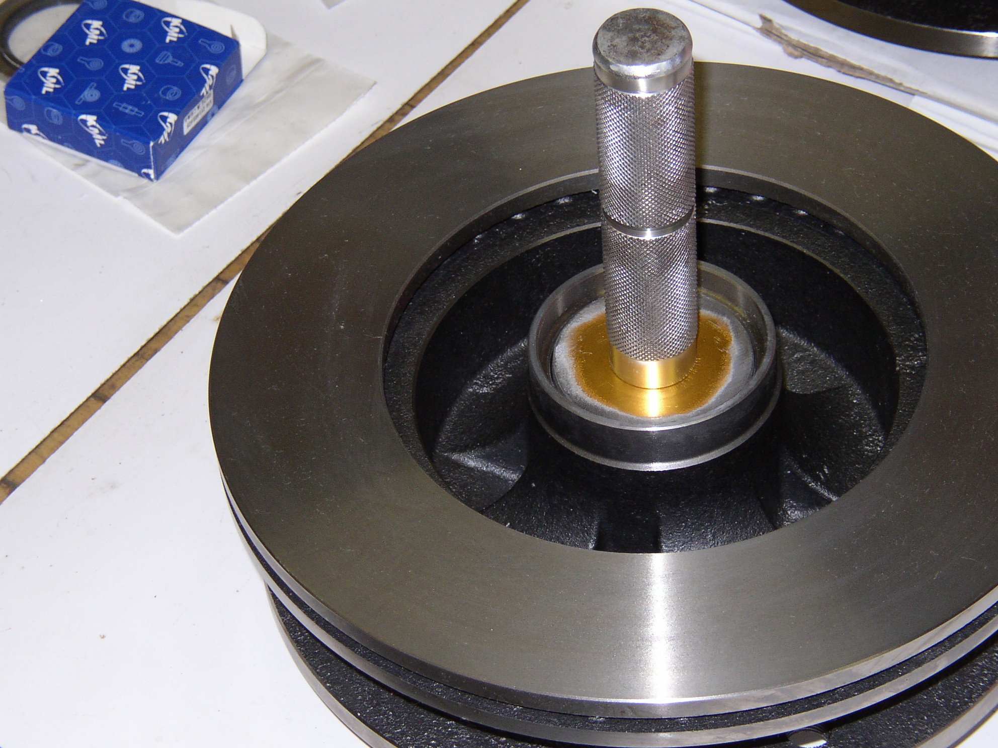

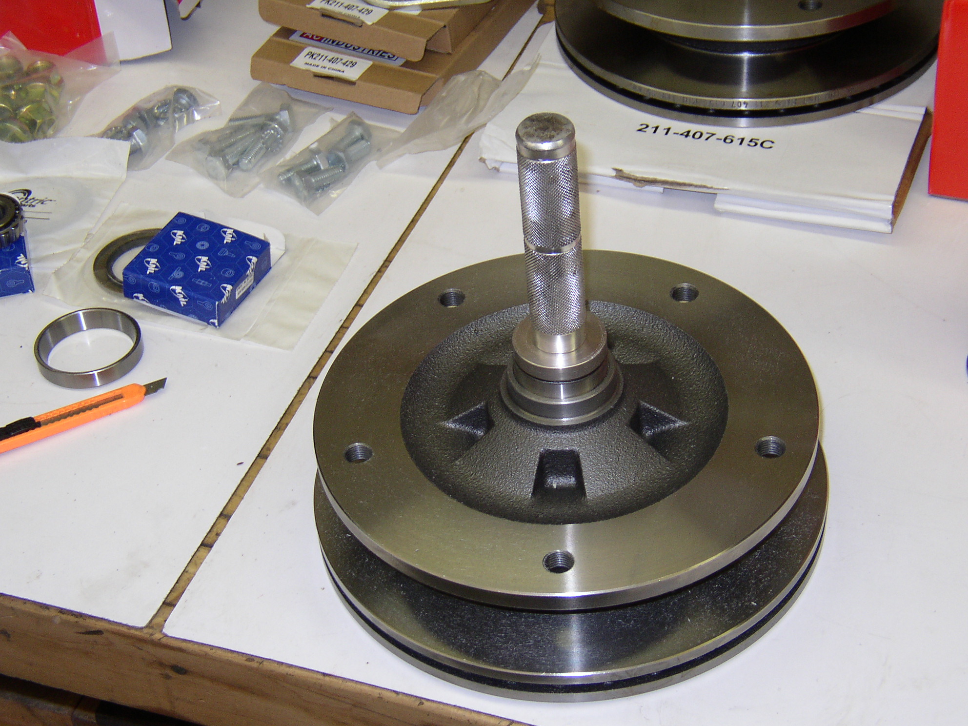

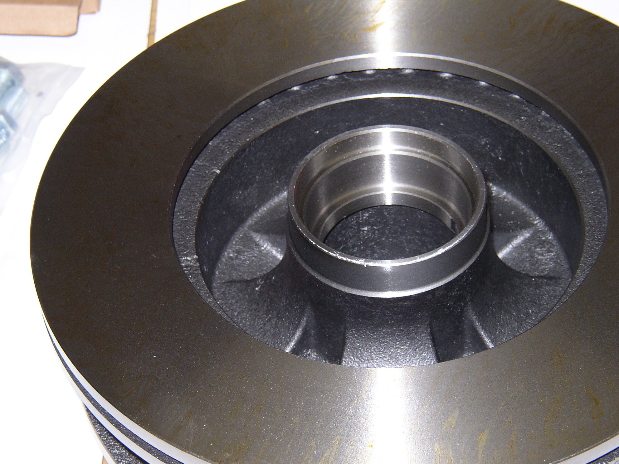

The rotors are very heavy (good), fully ventilated. They are one piece, not separate rotor/hub.
I knock the races in.

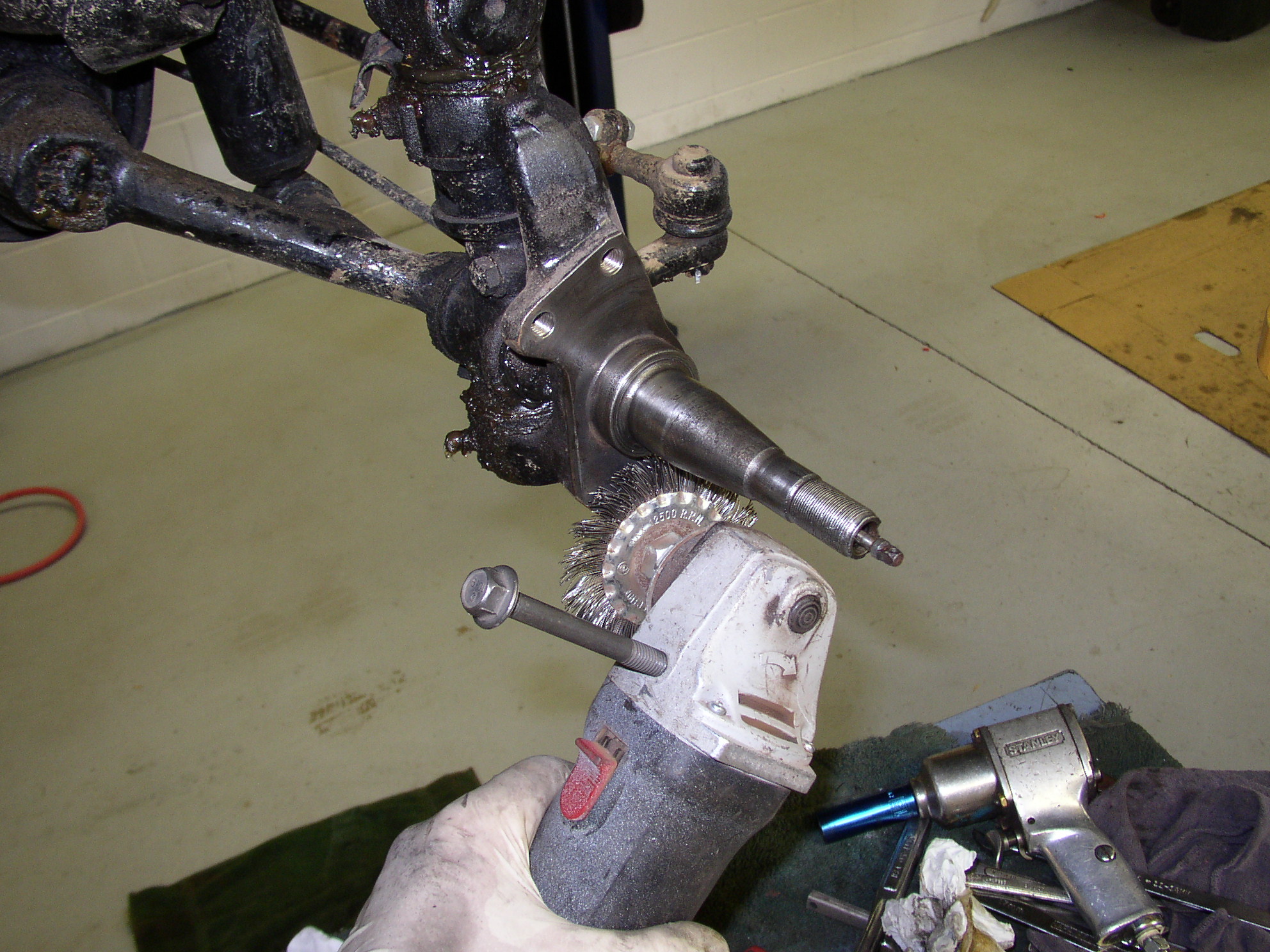

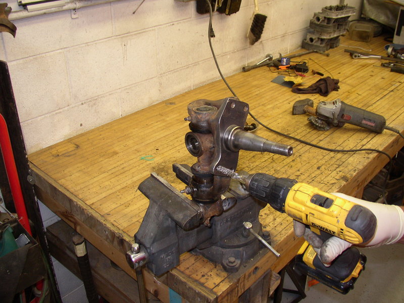

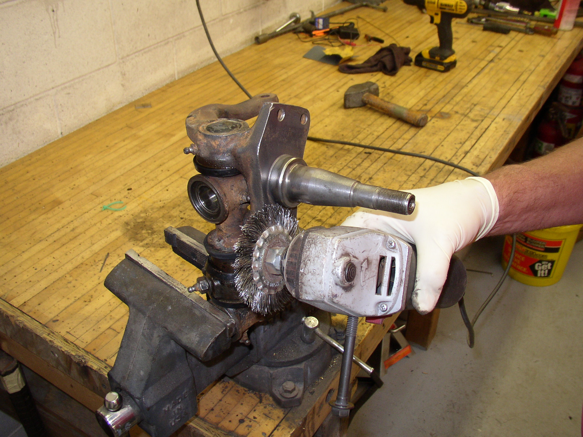

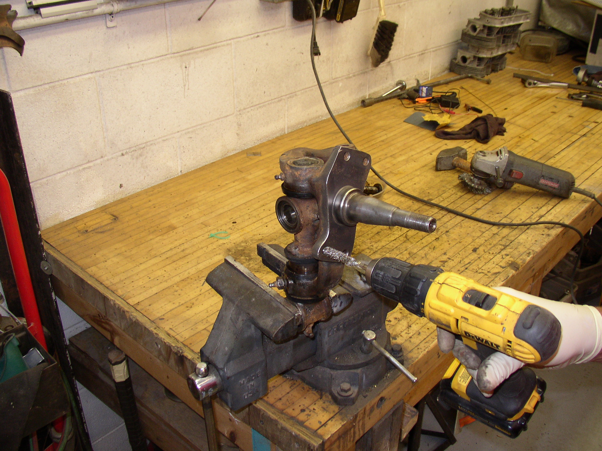

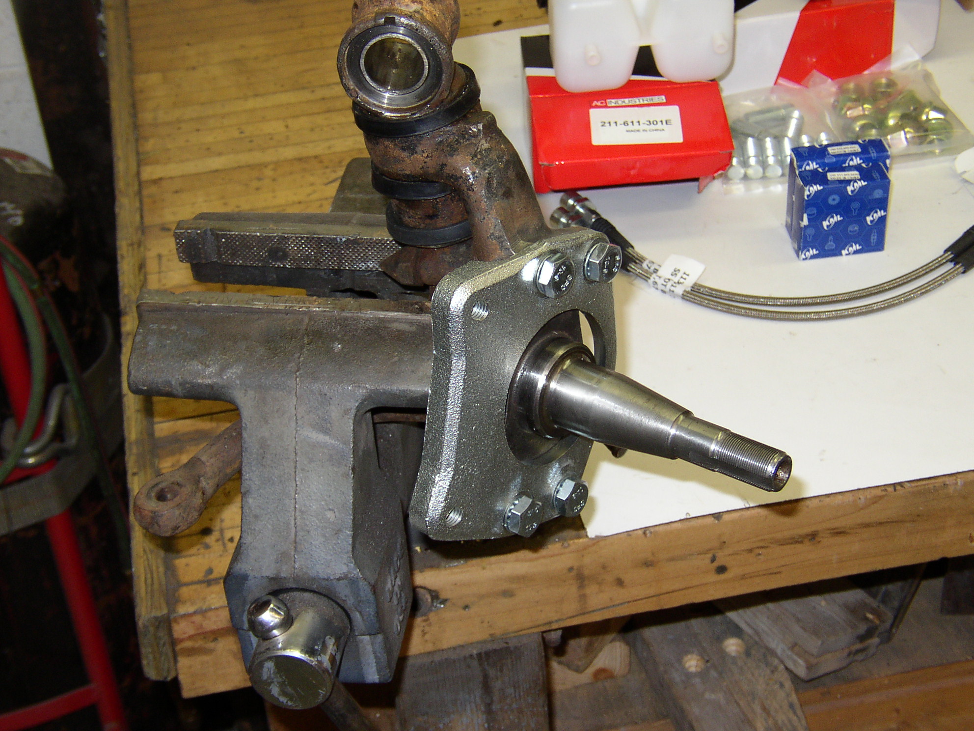

I had some spare spindles and wanted to mock them up on the bench before tearing my bus apart, so start by cleaning the flanges and threads:

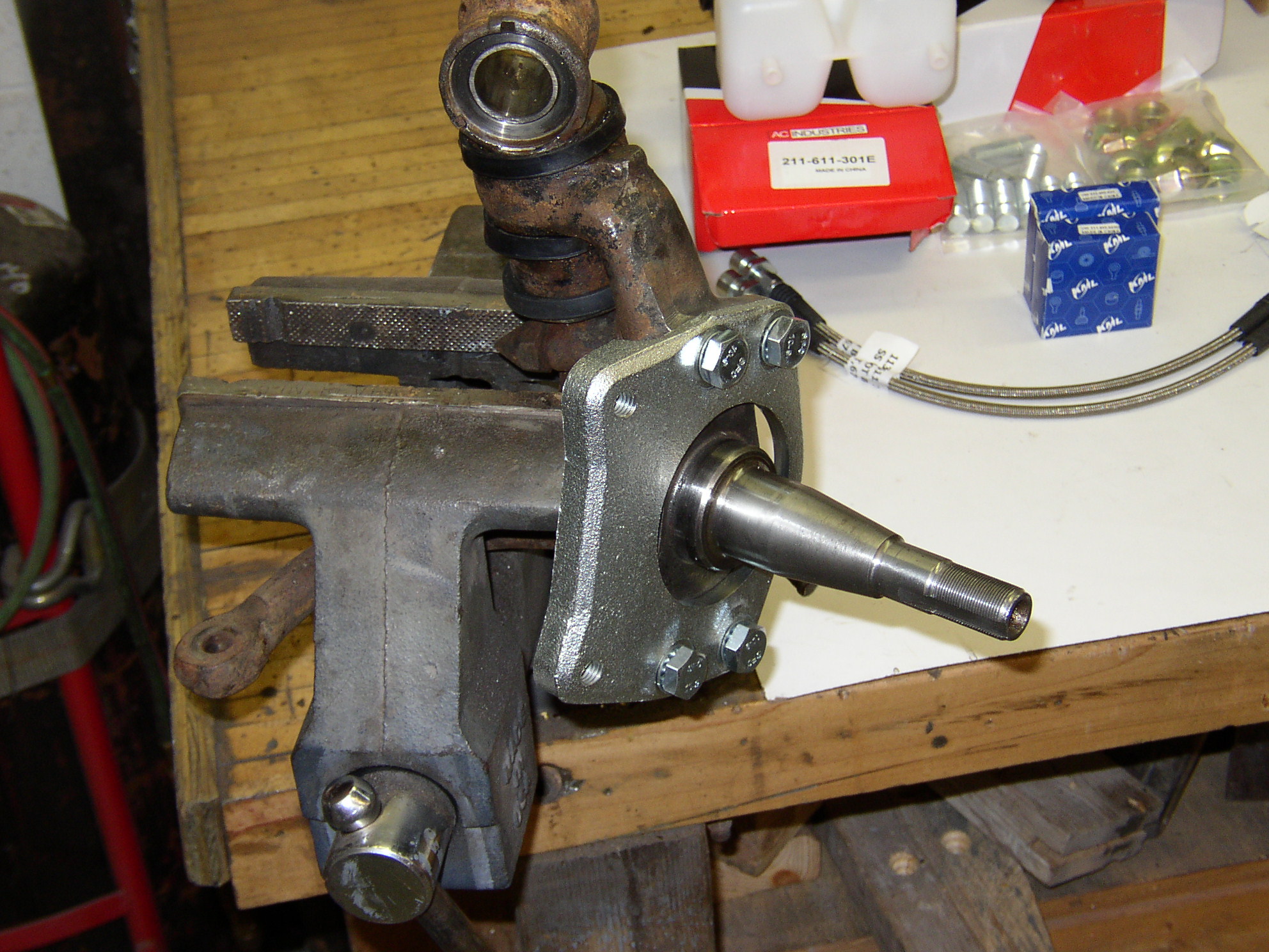

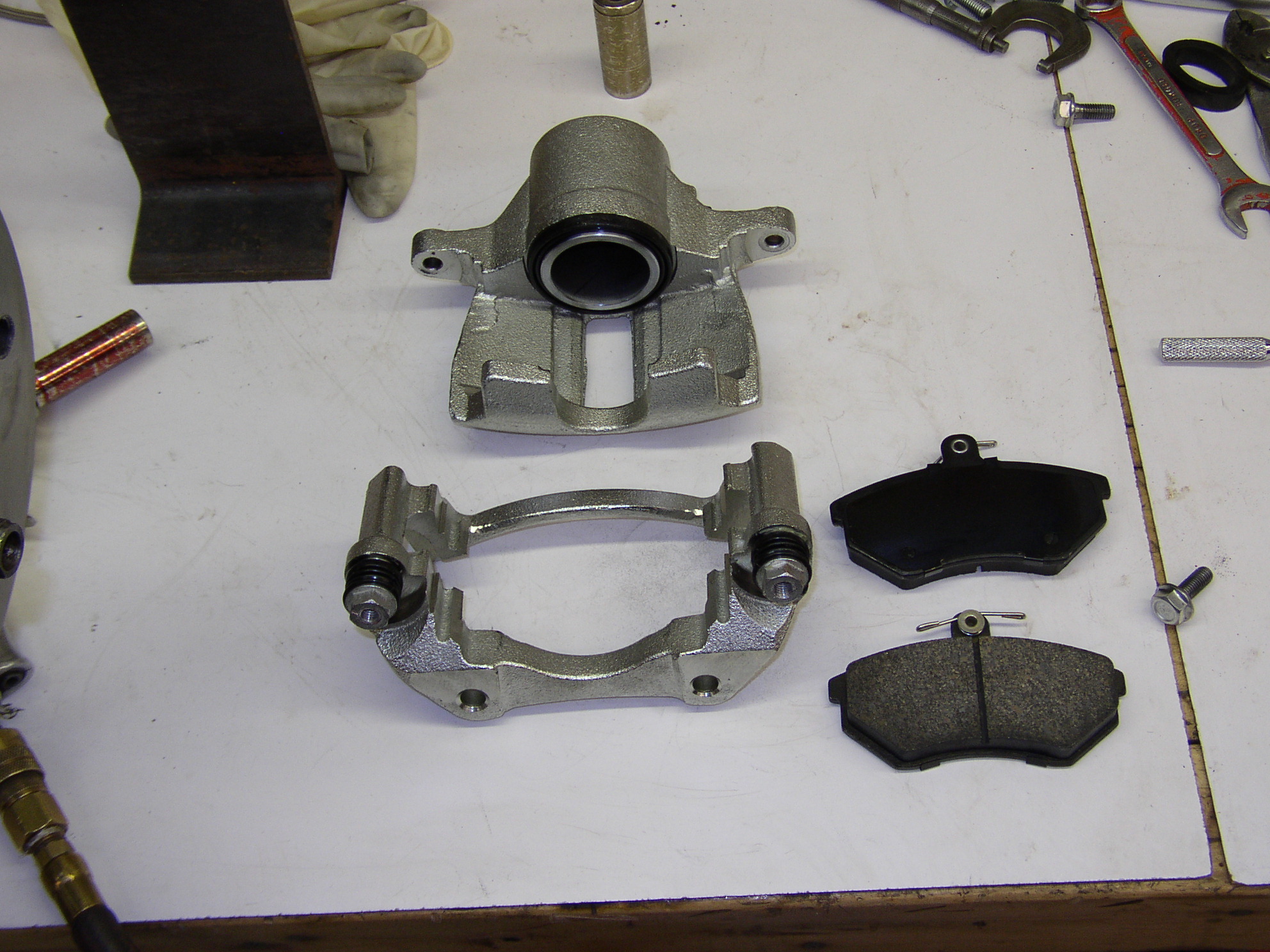

Bolt the caliper mounting bracket on (both adapters and calipers are L/R)
Using the supplied gr 10.9 bolts and lockwashers.

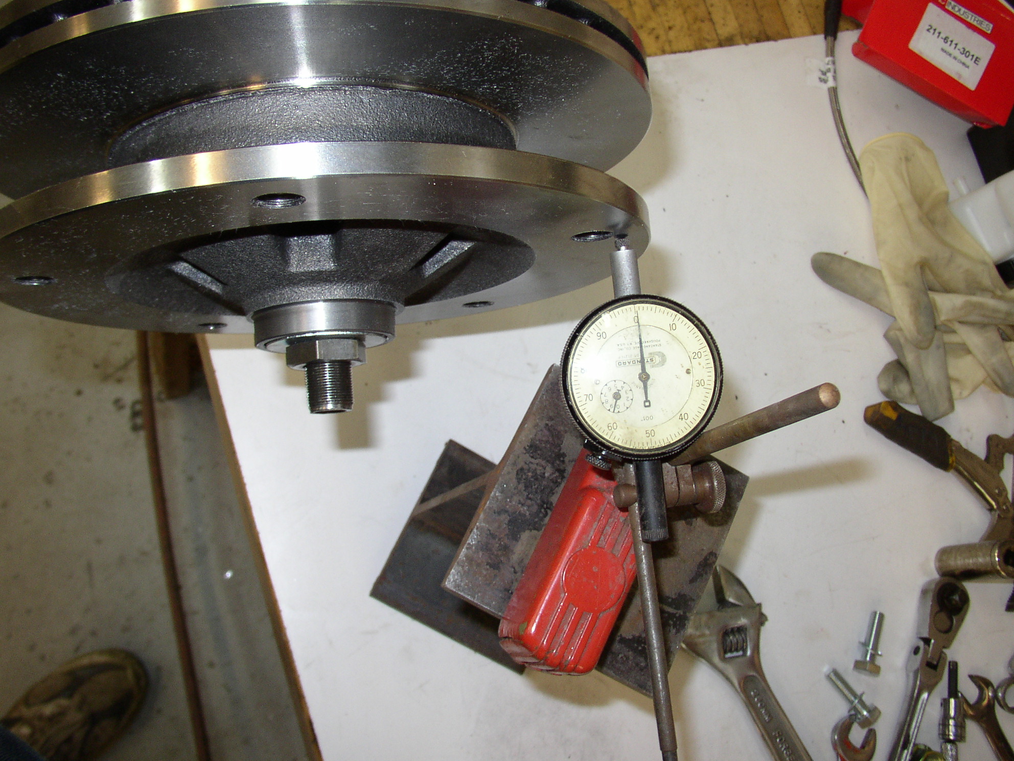

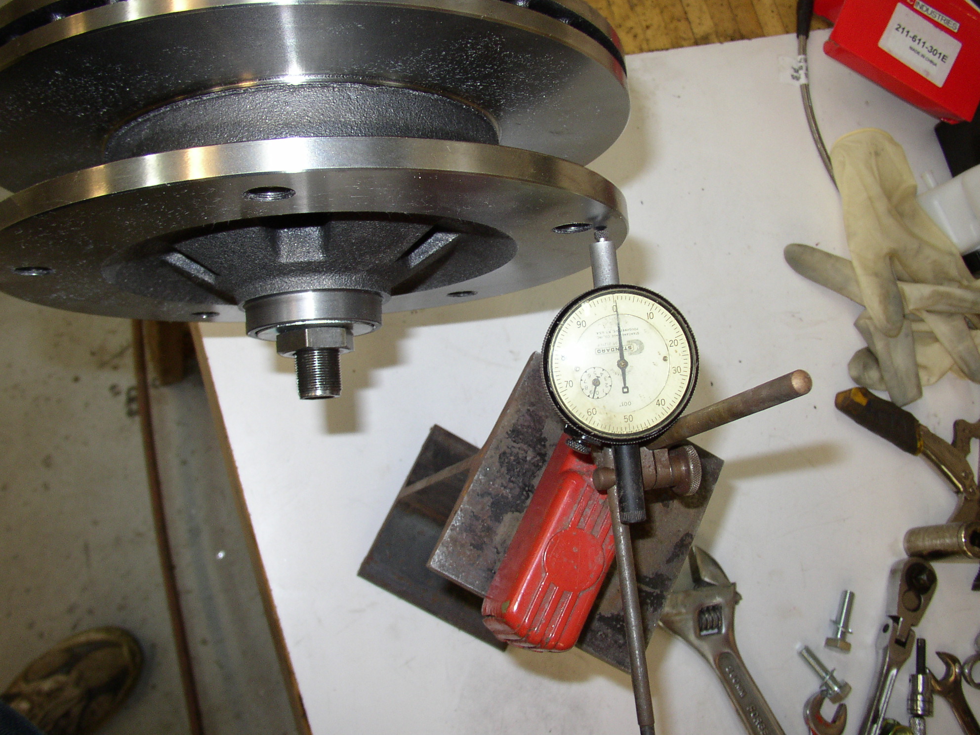

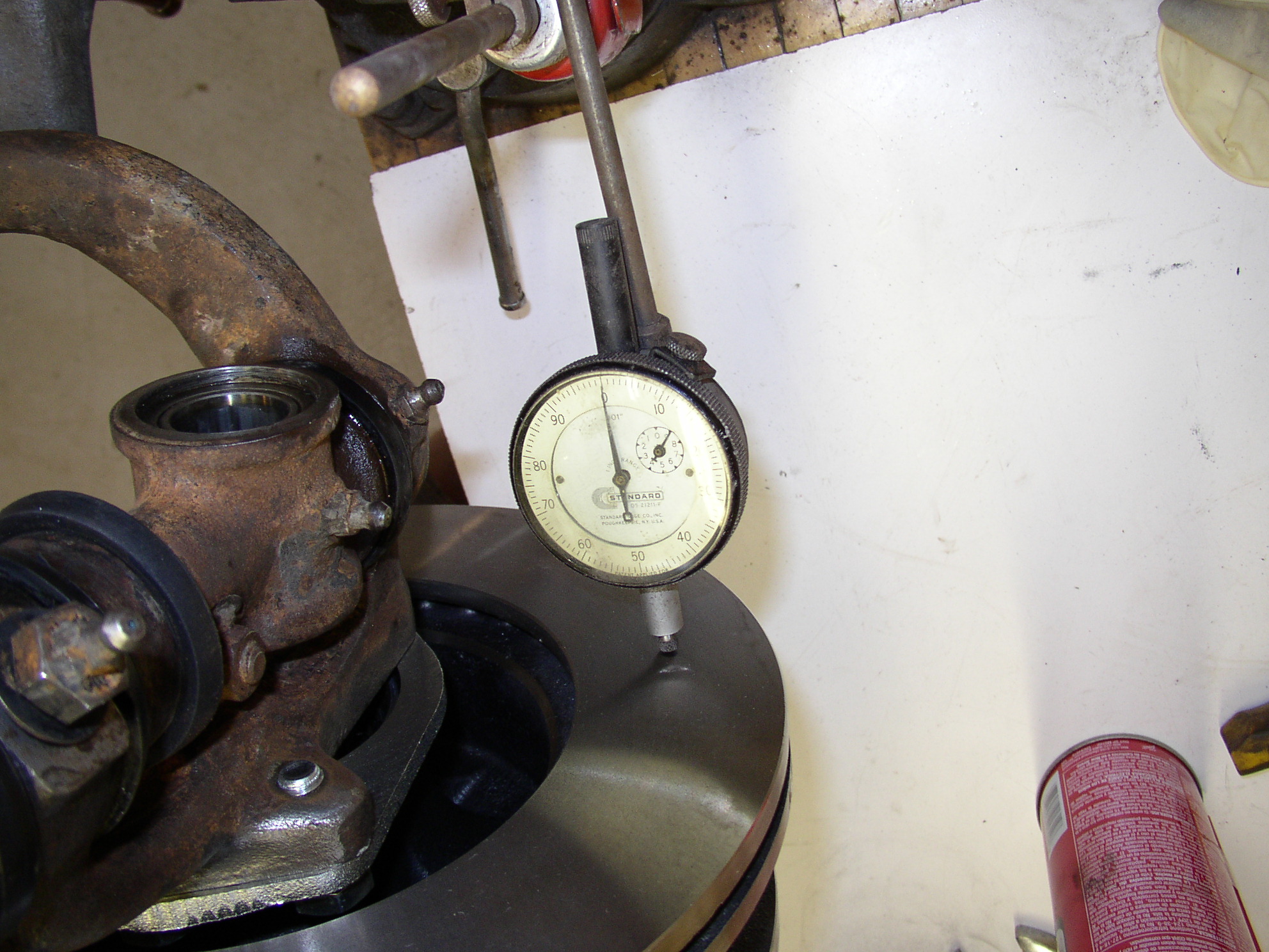

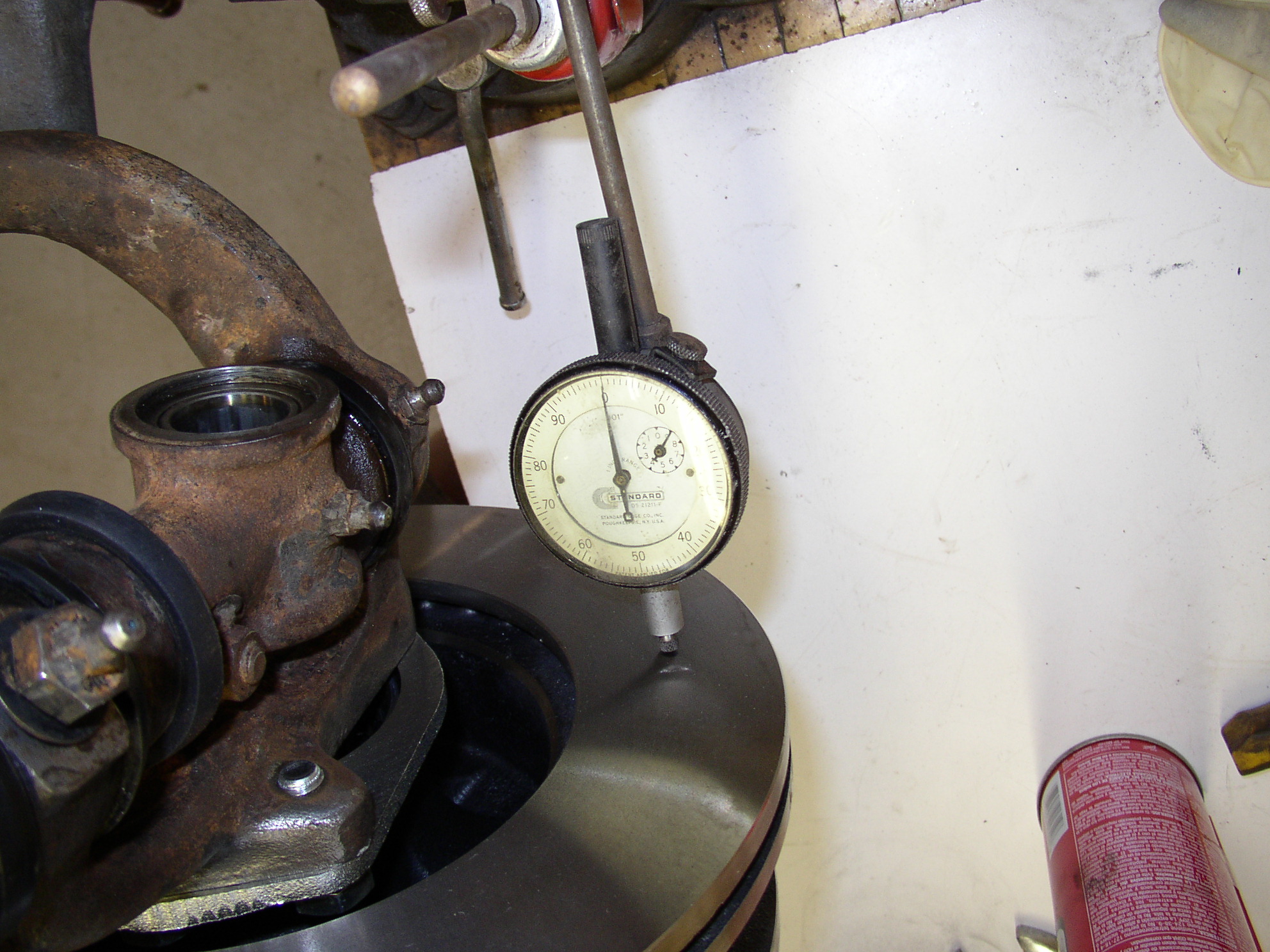

Fearing the worst about Chinese quality I wanted to measure runout before tearing my bus down. I was really surprised to found no runout at all, less than .001" on the rotor or wheel face on both rotors.

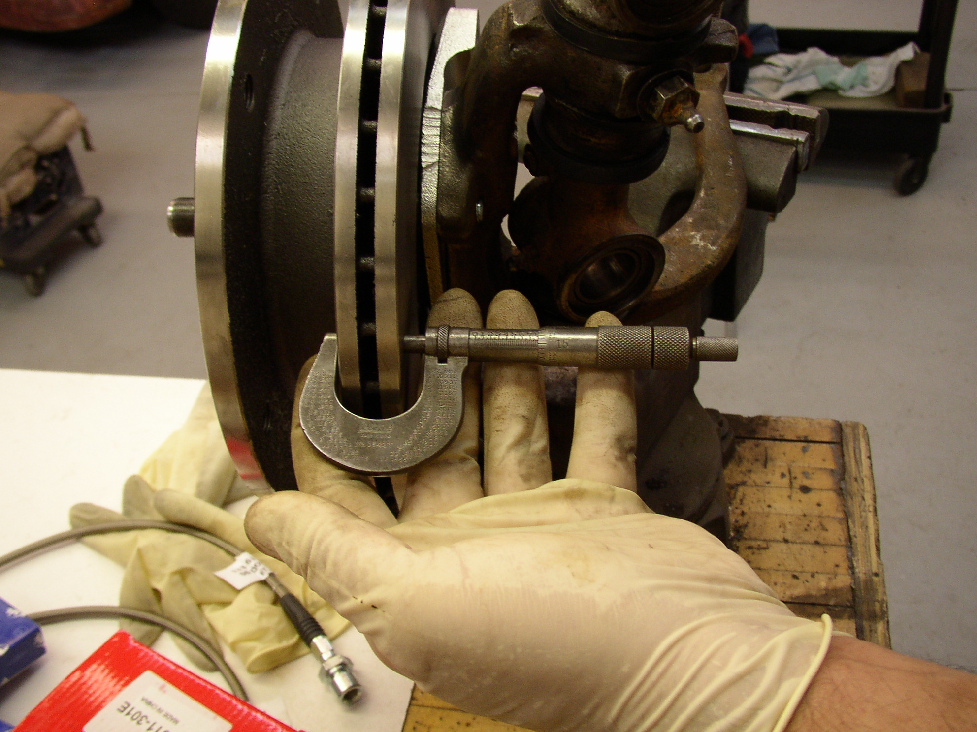

And parallelism on the rotor was also under .001".

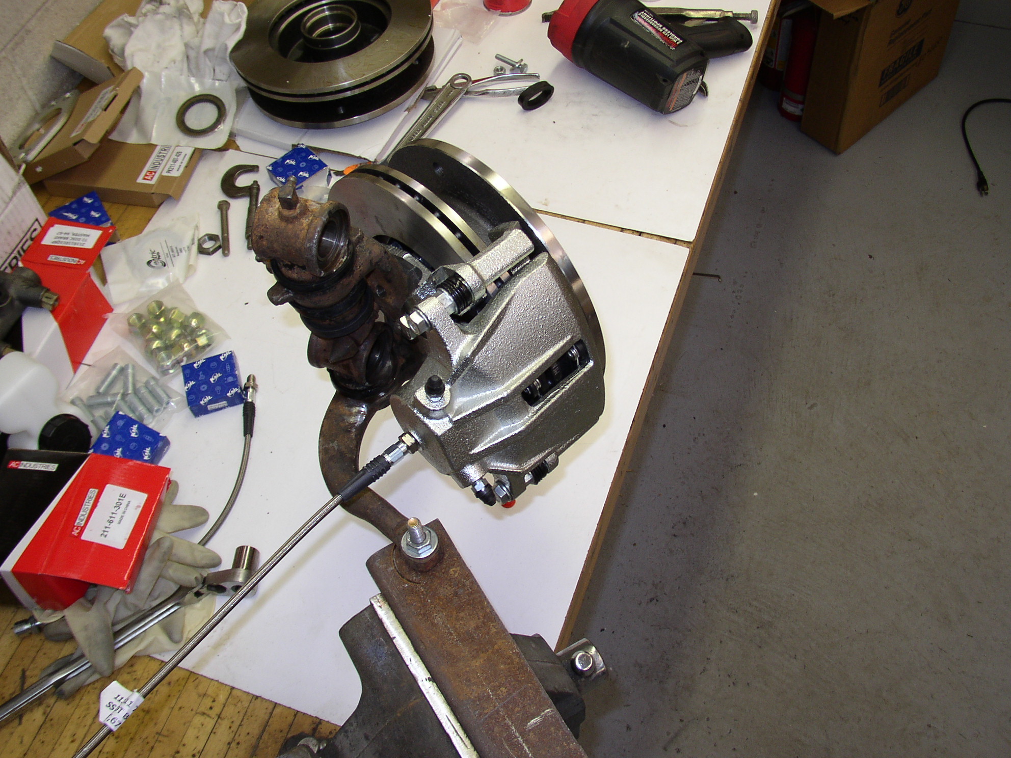

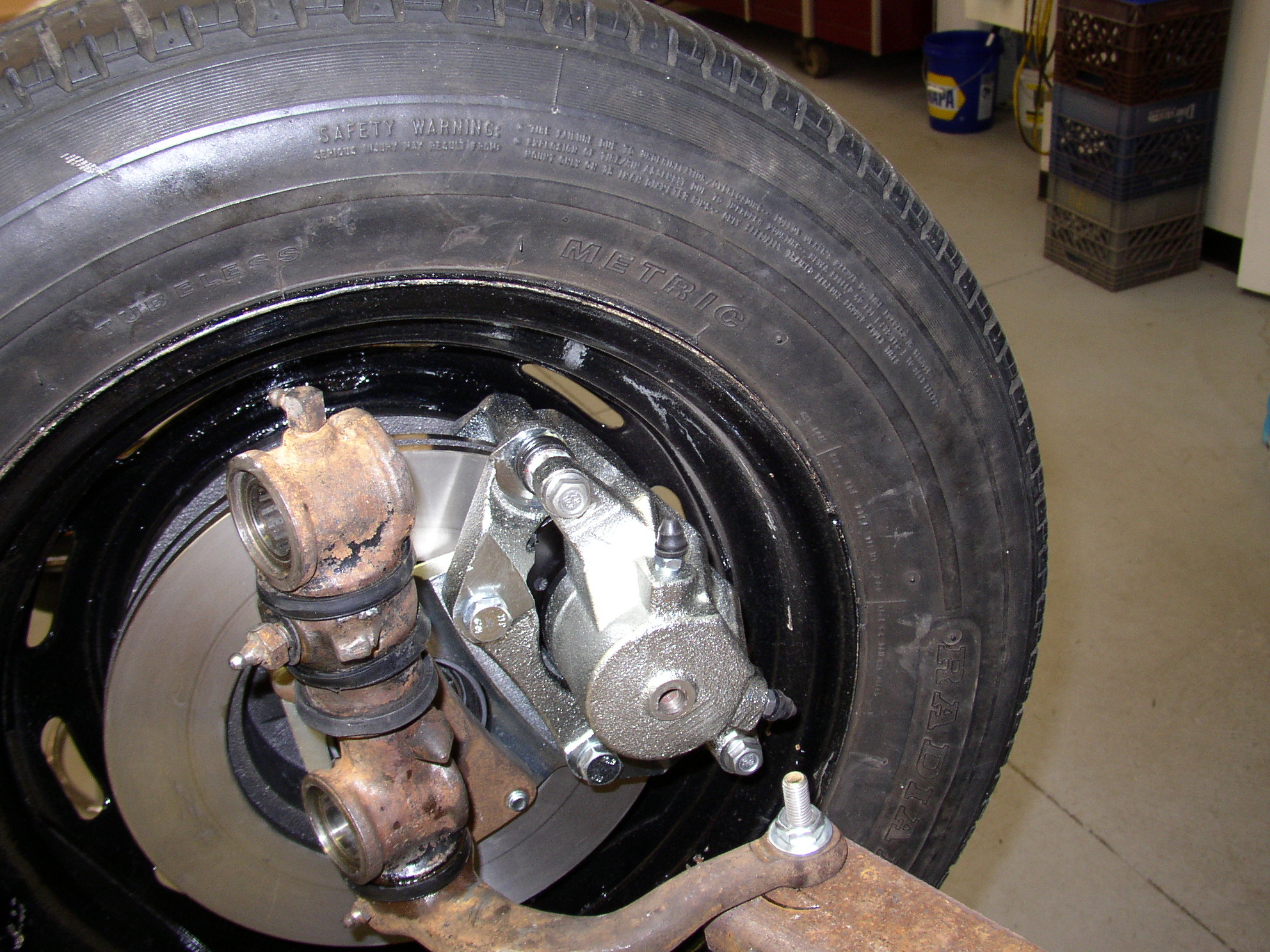

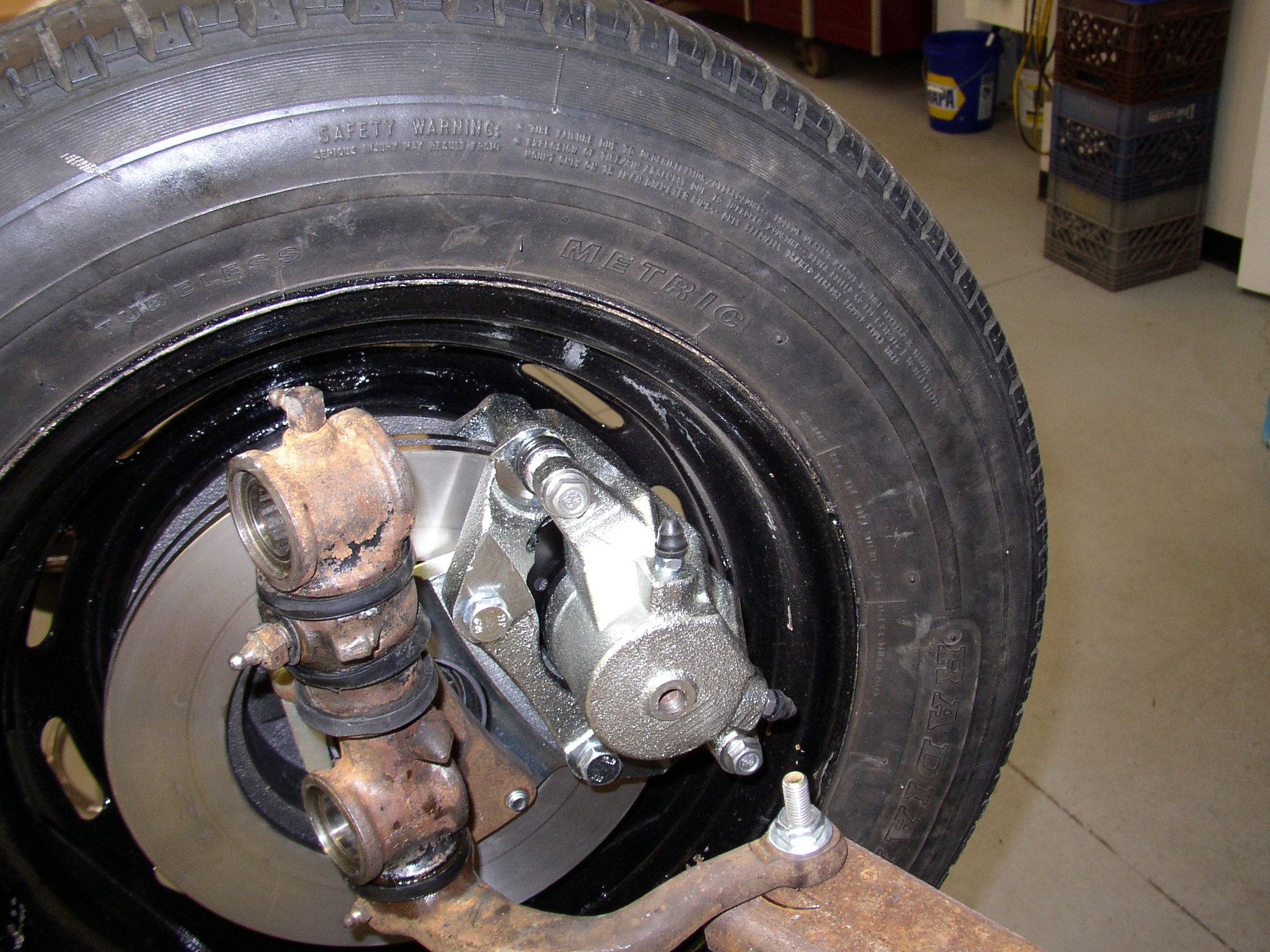

Here it is mocked up,

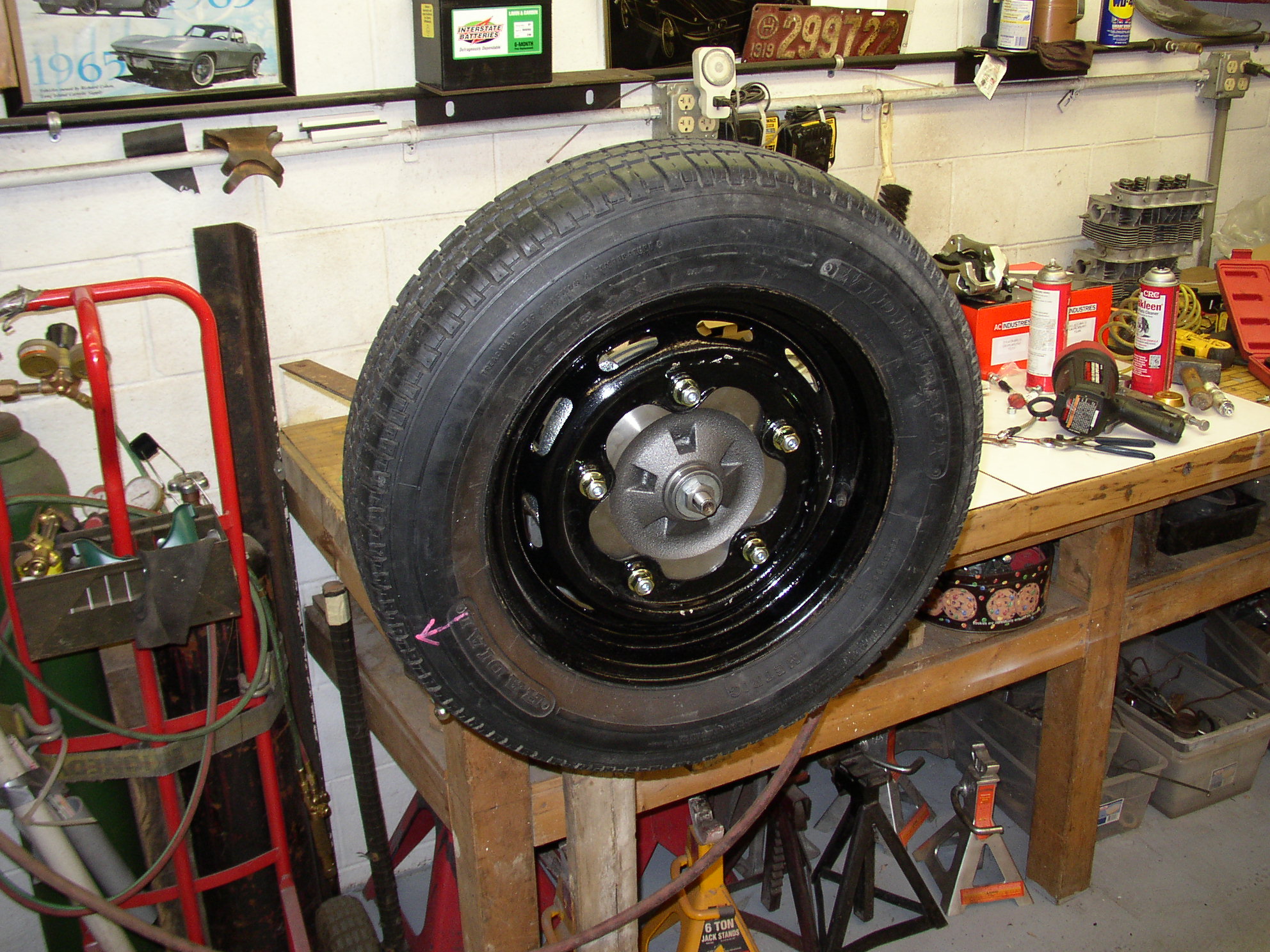

I use a 15" Beetle wheel on both of my busses for a spare so I wanted to see if that fits, and it does with plenty of clearance.

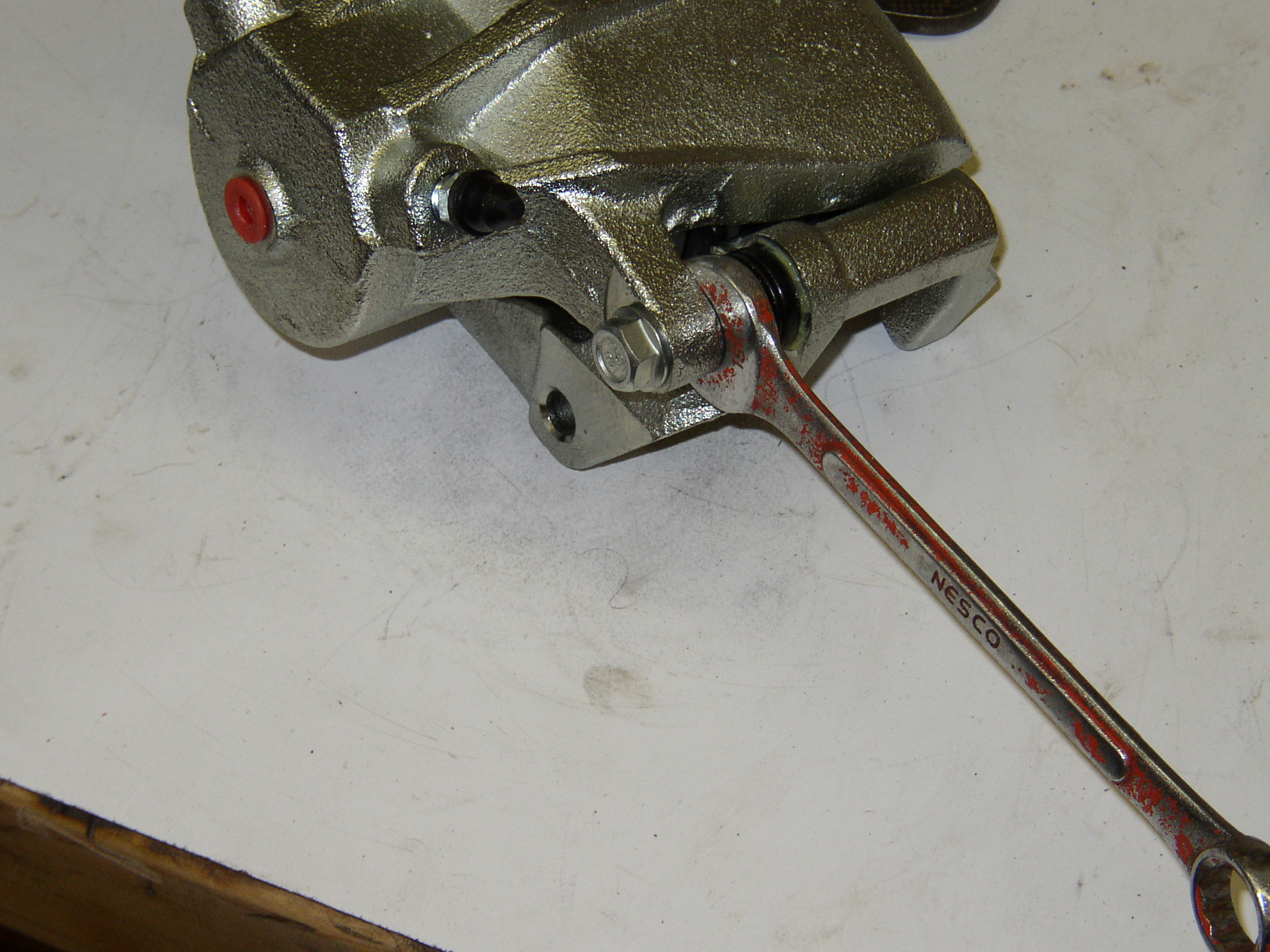

If you need to take the caliper off you need a skinny 15mm to fit on the slide. Most of my 15s would not fit.
The wheel studs are "flanged" (?) so they won't thread all the way through and Allen keyed for ease of installation. I Loctited them into the rotors. They also use an appropriate lug nut and not a separate ball washer like some silly setups I've seen.

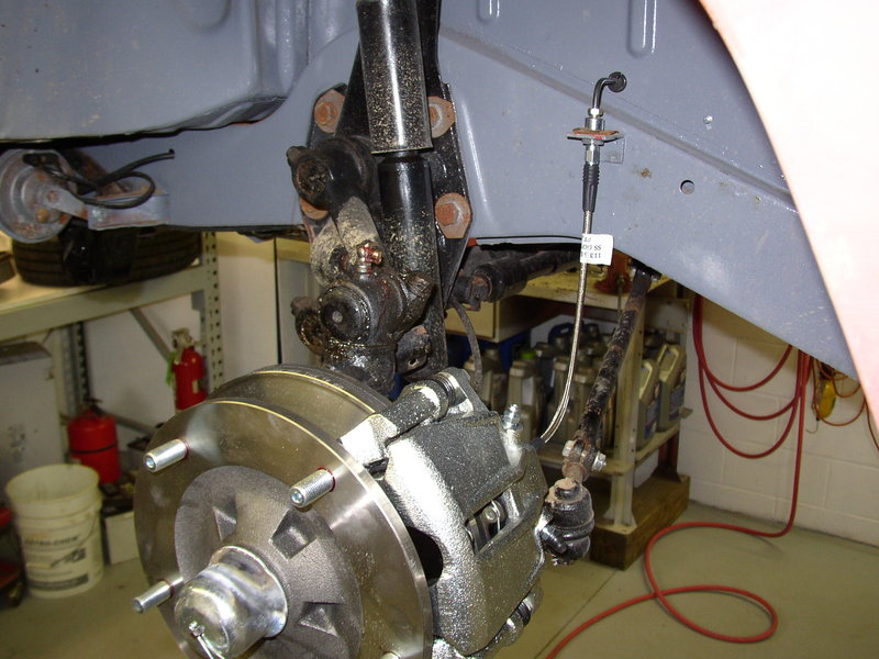

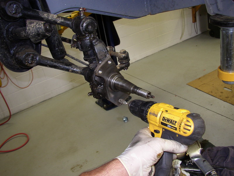

On to the bus and it's the same procedure, clean the flange and holes. This was done last year so they looked like new when I unbolted the drum brakes.
Bolt on the adapter with Loctite and torque to spec. They give clear instructions along with torque specs.

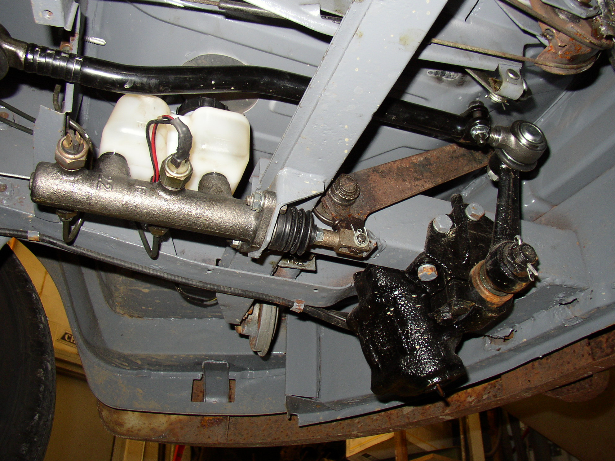

Here it is done:

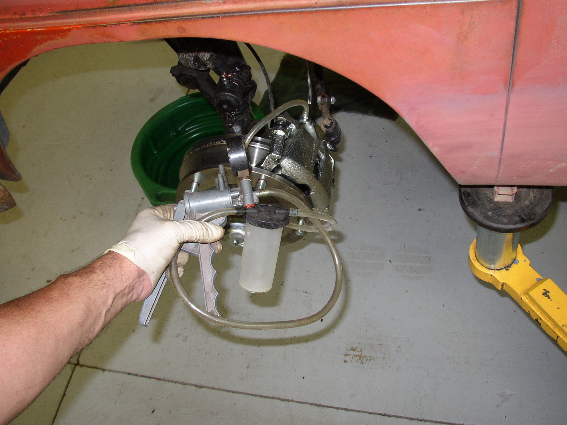

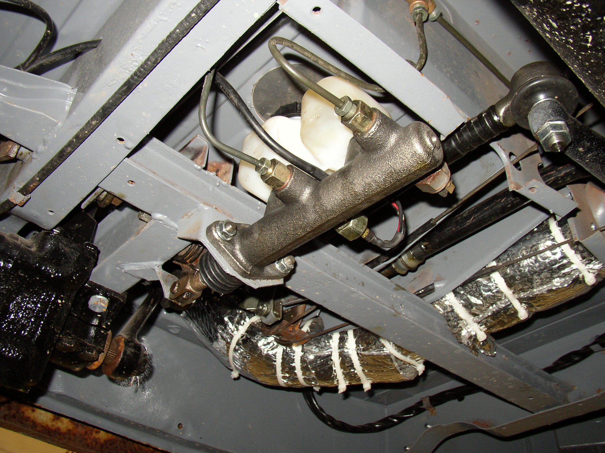

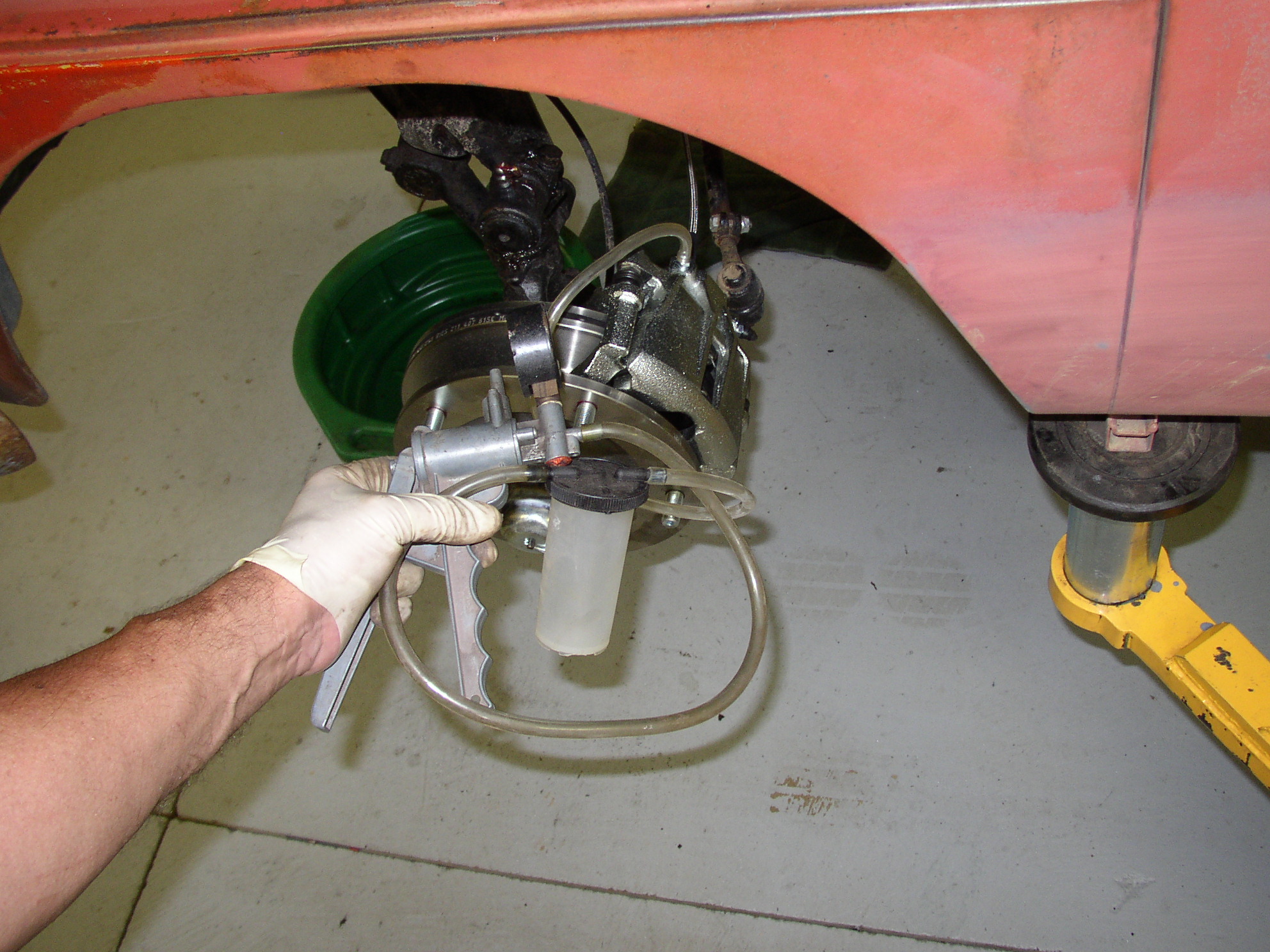

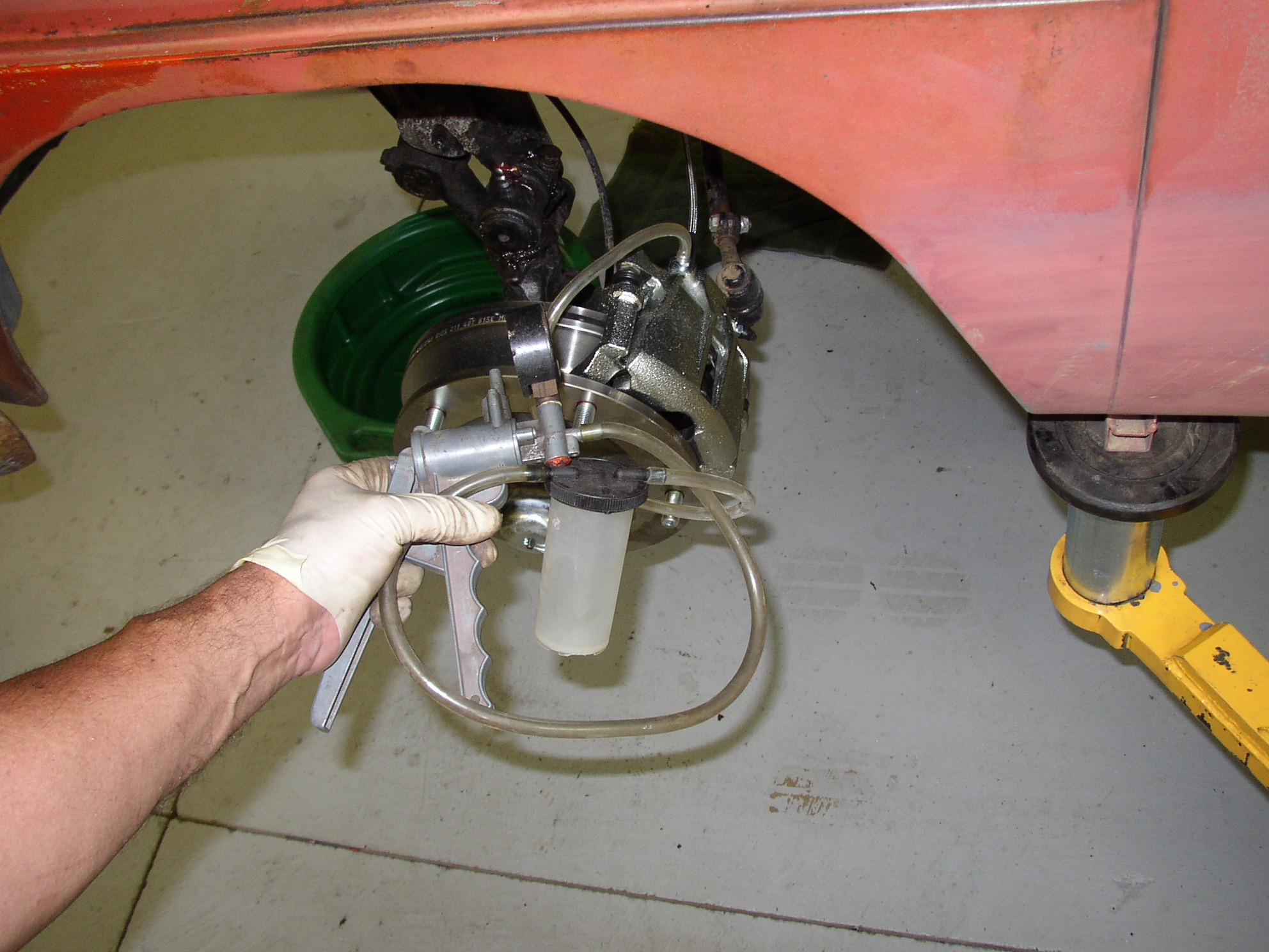

Bleed using a vacuum setup:
The MC reservoir fit really well, I didn't even have to adjust the pushrod as clearance was about 1mm. I bled and adjusted the rears as well.
The hoses clear everything from lock-to-lock, no rubbing on tierods or anything.
I have about 60 miles on it since complete and am really happy. It was easier to install than I would have guessed, and I'd give the kit an "A" rating. Excellent!
It stops MUCH faster than it used to with similar pedal pressure. I would recommend this to anyone with a split bus. :D

Edit: SoCal wrote back today and said the pads and cal kits fit an 89-98 Jetta. That's cal kits, not calipers, so I assume they're using a custom caliper housing that uses Jetta guts. With a little luck I'll never need them. ;)
Thanks for the pics. The setup looks real nice -- the castings don't even look too "Chinese". ;) You answered a question I had regarding the pads -- if they're readily available (from what "newer" car).

I see your AC kit from SoCal is single piston caliper. Is the CSP kit also single piston?
