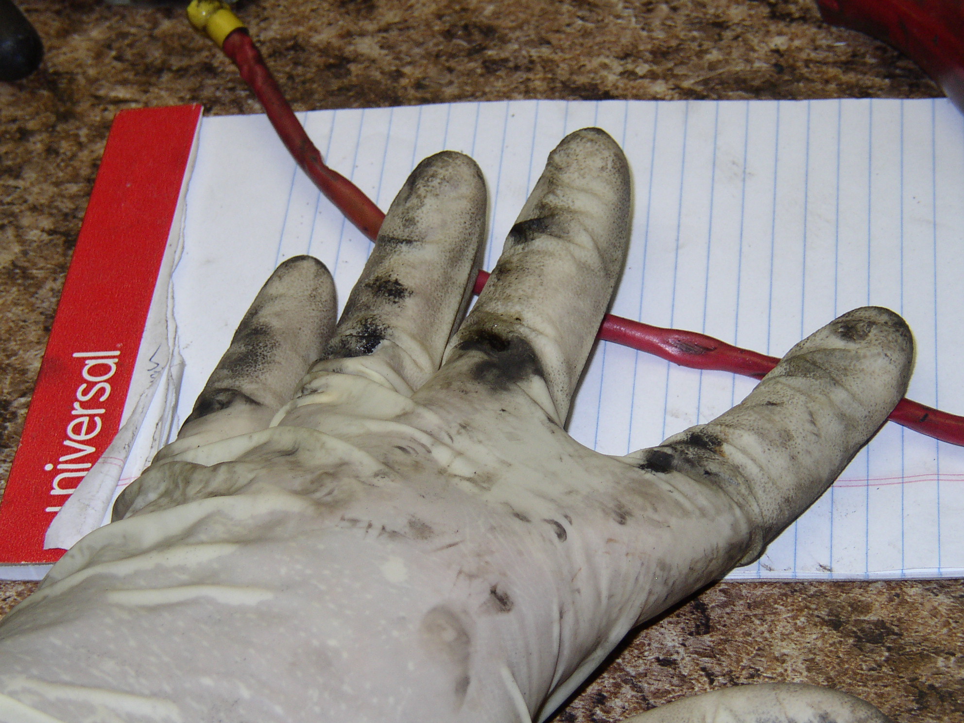

The Alt hot feed was rubbing on the throttle cross bar and just making its way through the insulation.
It had a funny little shadow where it was trying to ground and by the melted/swelled up spot on the backside it was caught just in time.
The eyelet was loose on the end of the wire, too- I could pull the wire in and out a bit. Yech. By the deformed insulation it looks like it was getting hot, too.
