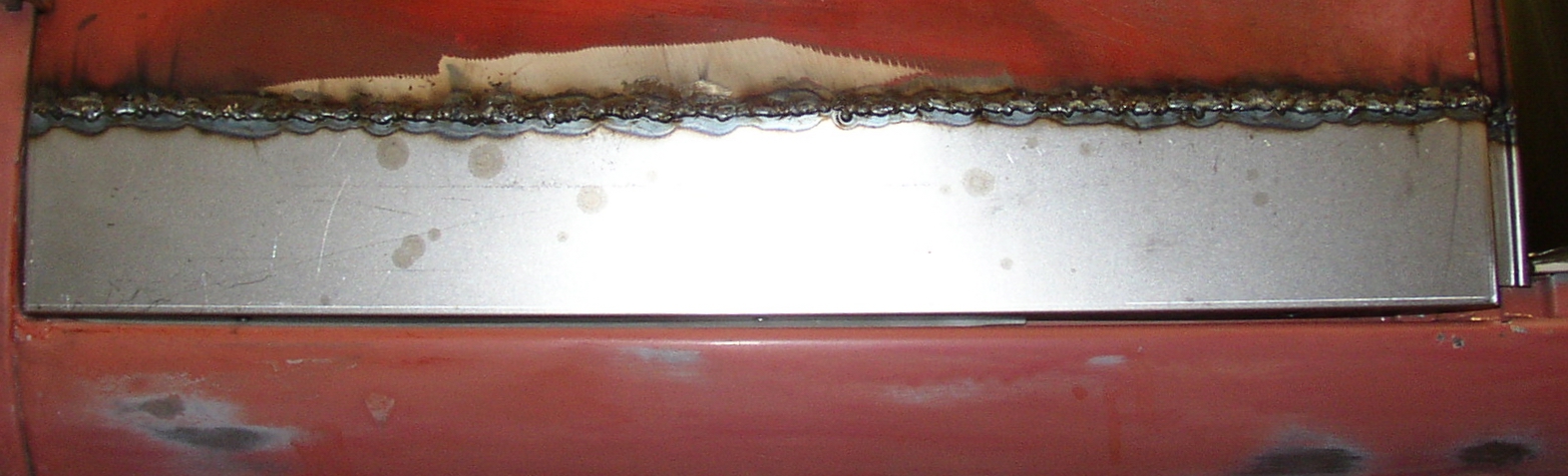

Here the weld tacks are growing together into one continuous weld.

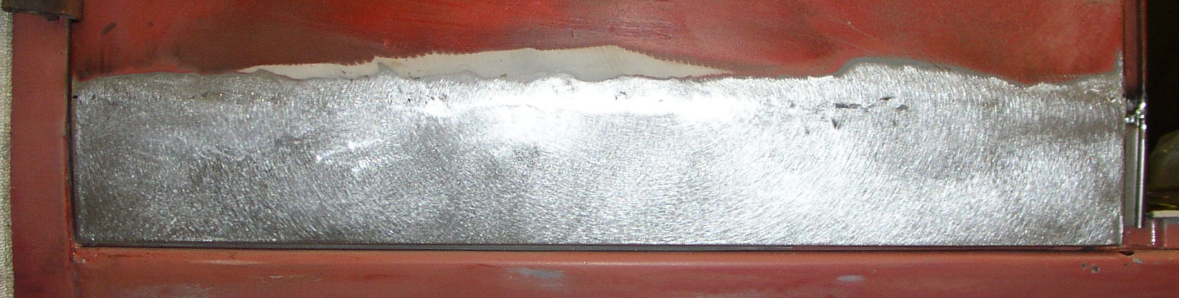

Now grind out the weld buggers so it's ready for mud. All the time I'm fitting/welding, I'm constantly opening and closing the door to check the gaps and for interference to make sure the door operates properly. Note the gaps are nice and even.

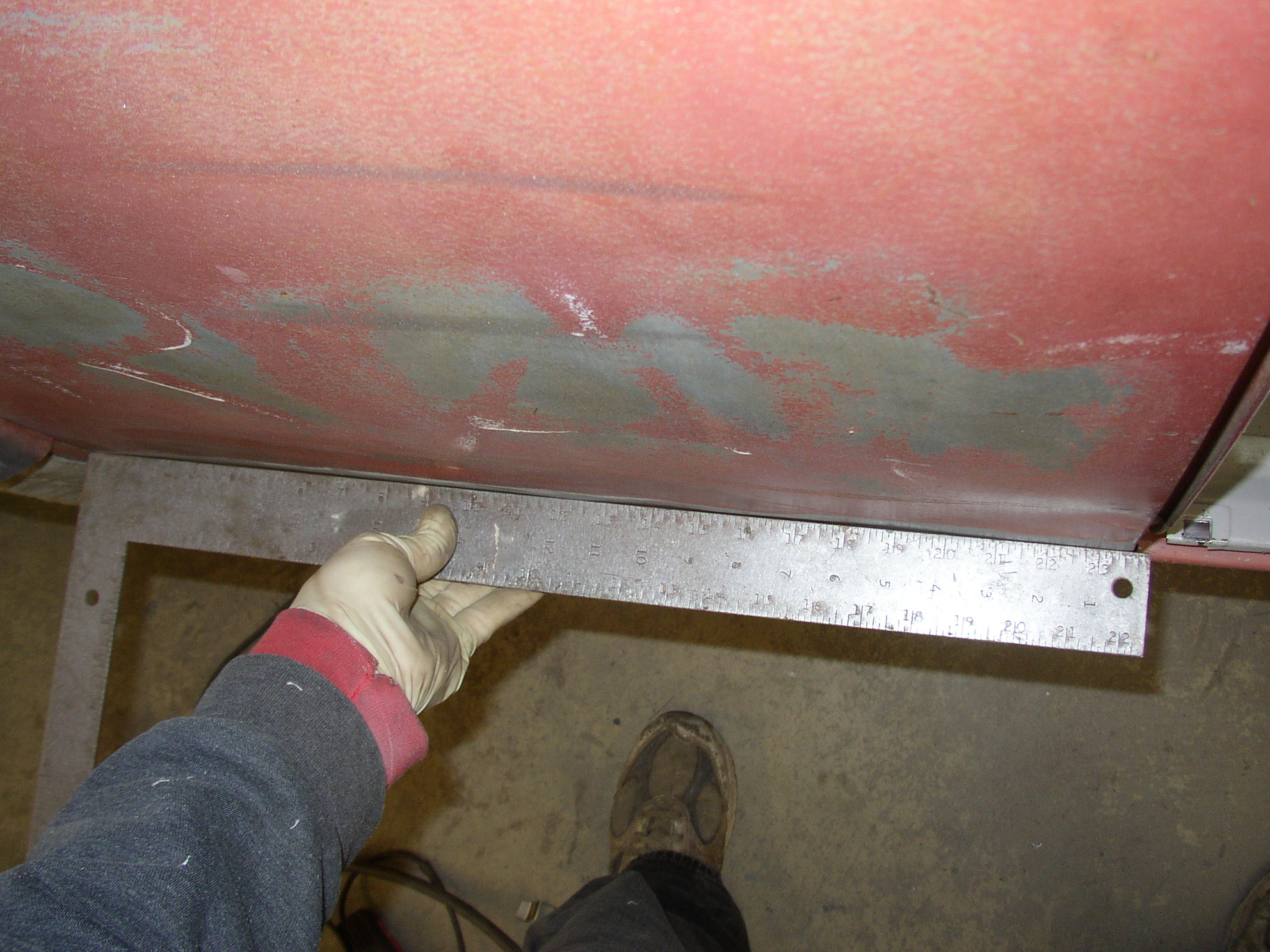

Let's check the warpage with a straightedge. If you're really good, like Kirk, all you need from here is high-build primer and color. :D Not me, I need mud, but not bad, less than 1/8" will smooth this out. :roll:

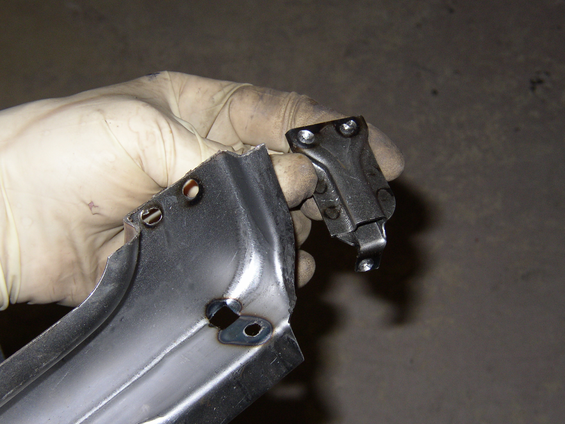

If you look straight down through the lock rod guide you can see how much it's misaligned. Compare it to the right side lock hole.
So drill the spot welds partially through to weaken them, then pop them apart with a screwdriver.
Here's the bottom, compare it with the rotted OEG- not that much different.
Open up the hole with a square file to bring the lock rod about 3/8" outboard.

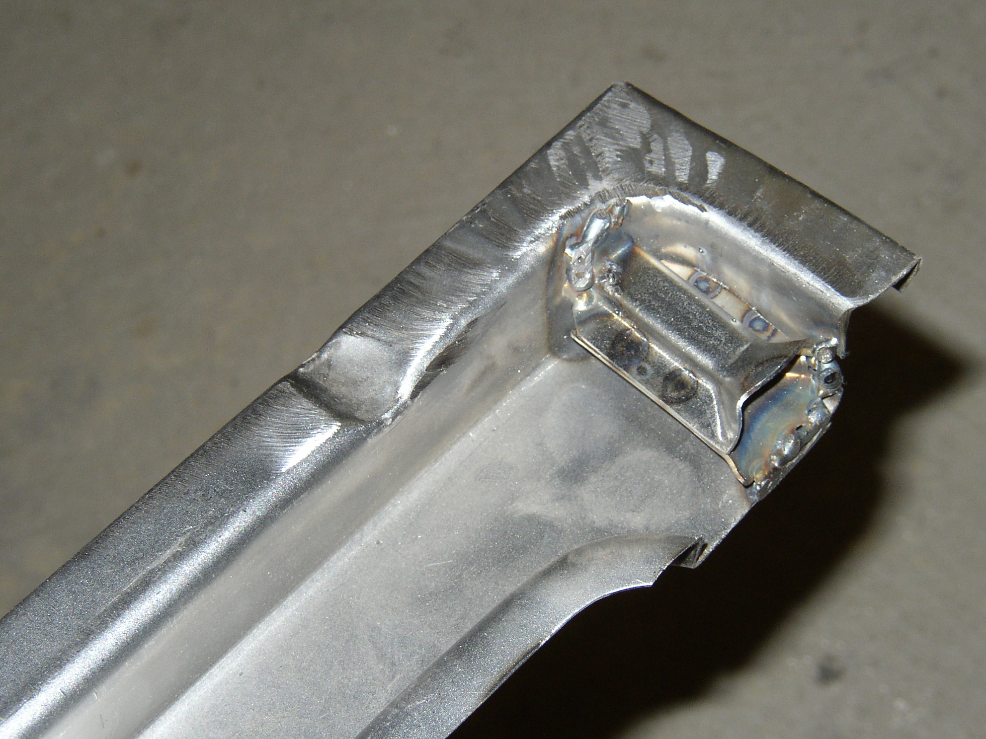

Clamp the guide back in using a hex nut as a spacer.
Weld it in place,
Drill some holes for plug welds, someday I'll buy a spot welder instead of borrowing Chuck's. It's not going to see daylight inside for a long time so shoot it with some weld-through primer.

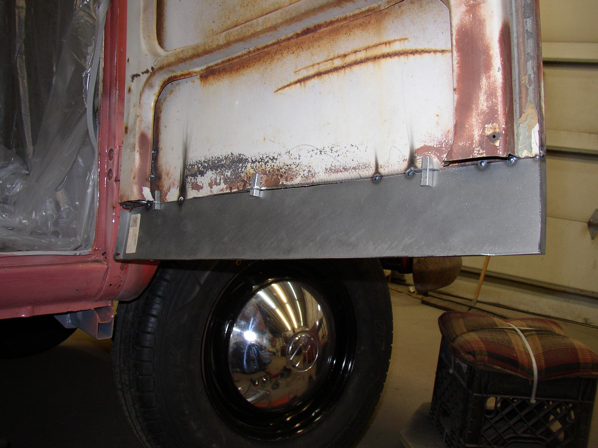

Set your new panel in place and trim the right side where it interferes with the hinge. This will allow it to sit pretty flush in place.
Clamp it in place and set your gaps with stir sticks.

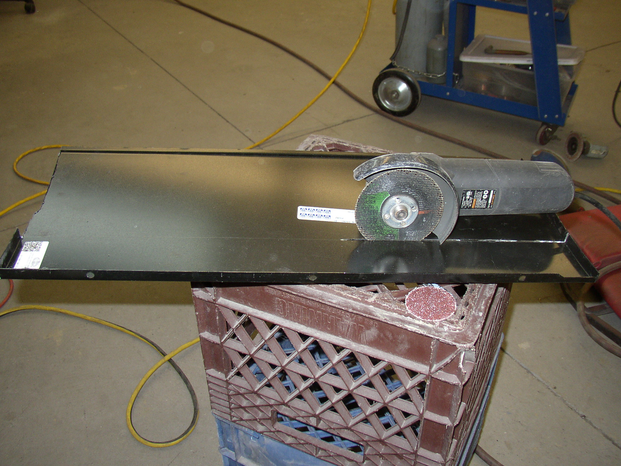

Put the panel in the blast cabinet and remove the "paint". Of the 4 panels I'm using here 3 of them are AutoCraft (England) and this one is WW. All came from WW, they must have been out of the AC front skin. Quality seems to be equal among them, all are .038-.039" thick (one mm). I think I prefer the AC panels over anything. They come lightly oiled, wipe them with brakeclean and go to work.
Clamp it in place using the HF butt panel clamps.
Check your gaps again, this should be at least 100 times.
Tack it.
This edge tack is very important, it sets the location of the lower edge. Make sure you get it right.

Cut it, move it, test fit it, weld it.
Once I'm happy with it's location, prime it and get ready to weld.

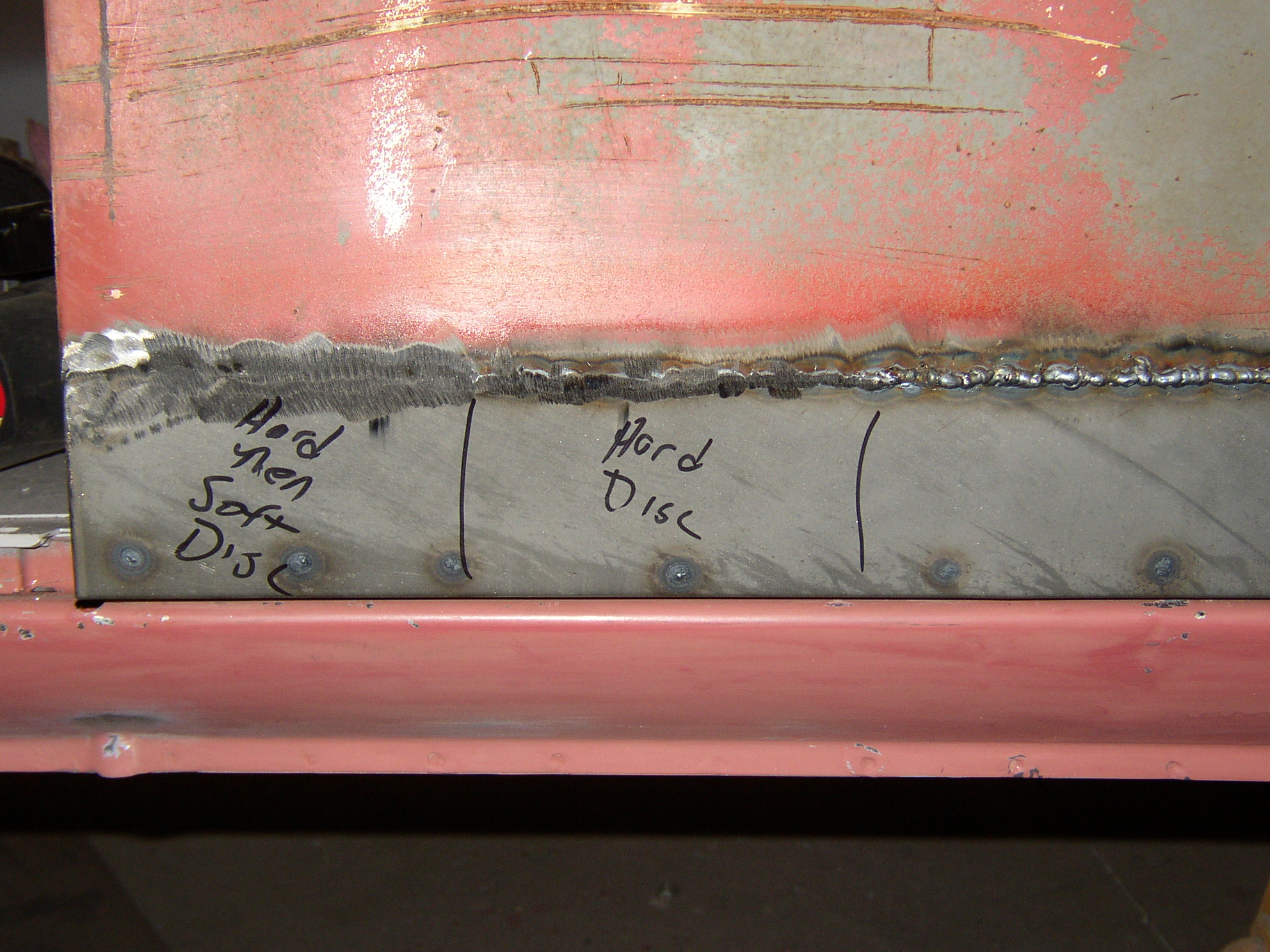

Grind out the buggers. I use a "hard disc" initially to remove the mountains and get the metal level, then a soft flap disc to smooth things out more. If you use a flap disc without the hard disc you'll likely "go through" next to the weld. The hard disc is on a HF 4" grinder, they're cheap and work fine, only about $7-10 with a coupon. The flap disc is on a Mac air grinder, I'm not fond of HF air tools as they're weak.
On the right is the weld, in the middle I've ground it out with the hard disc, and on the left I finished with the flap disc.

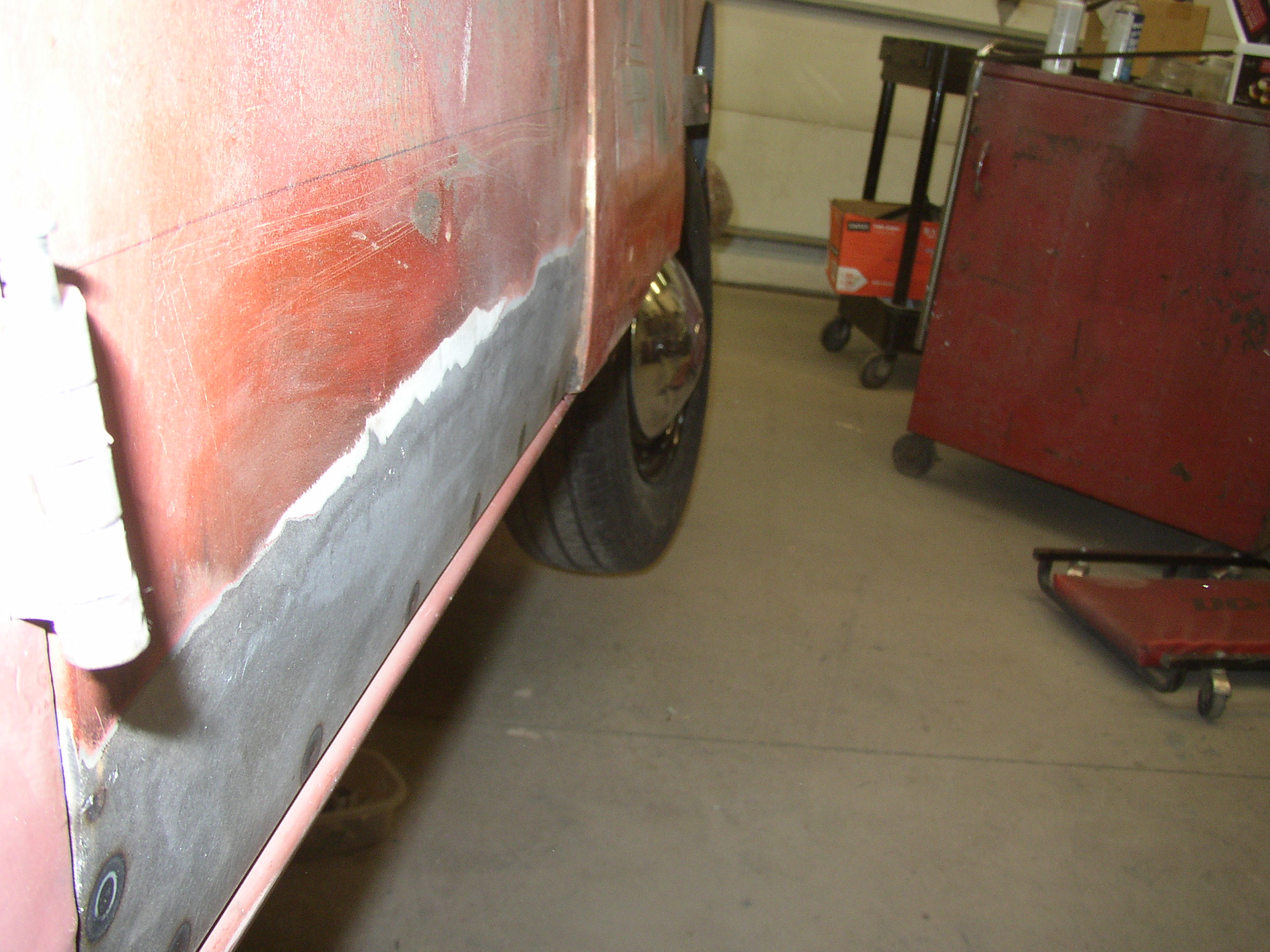

First coat of mud, cheese grated, and hand blocked with 36 grit.
I figured it would be easier off the bus so I popped the pins and worked on a cart. More mud, then 36 grit on an air file.
