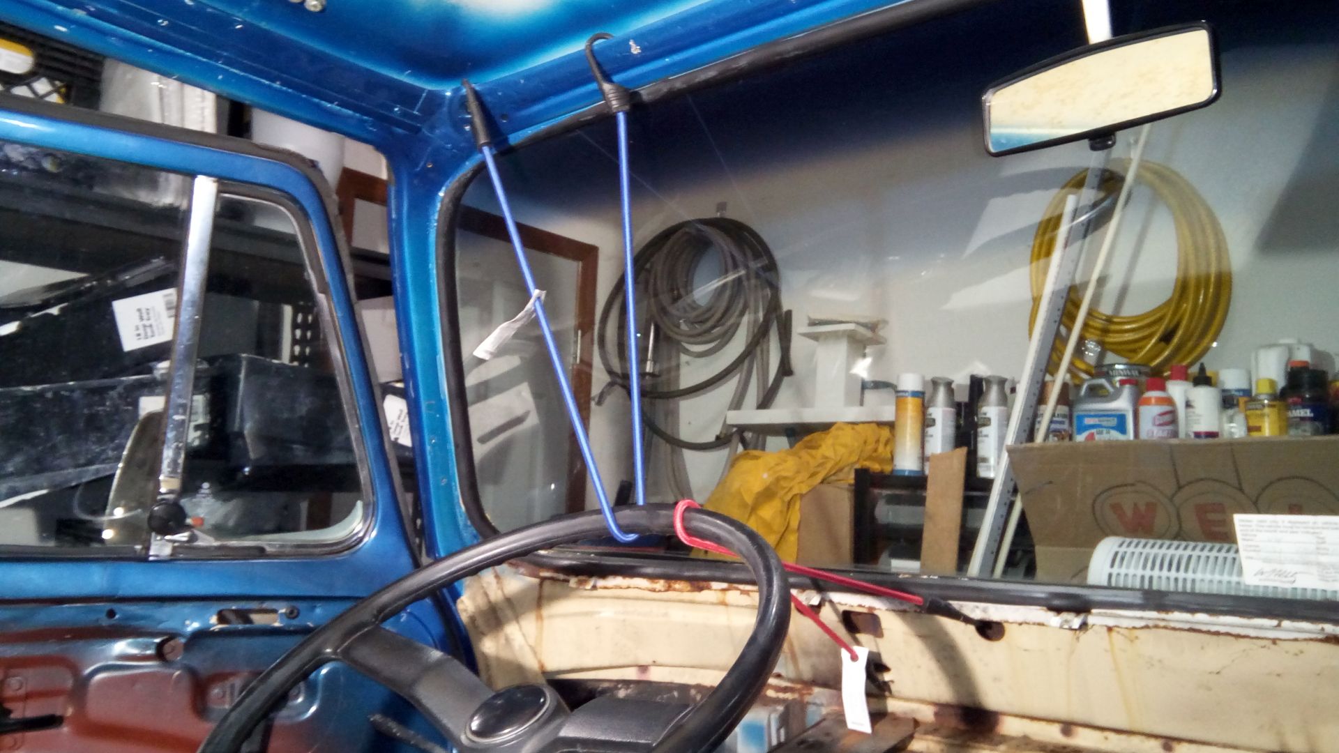

Over the next few days I gutted the bus. I have a big stash of labeled ziploc bags with all the hardware. Removing the dash took a while. bungees came in handy for supporting the steering column
