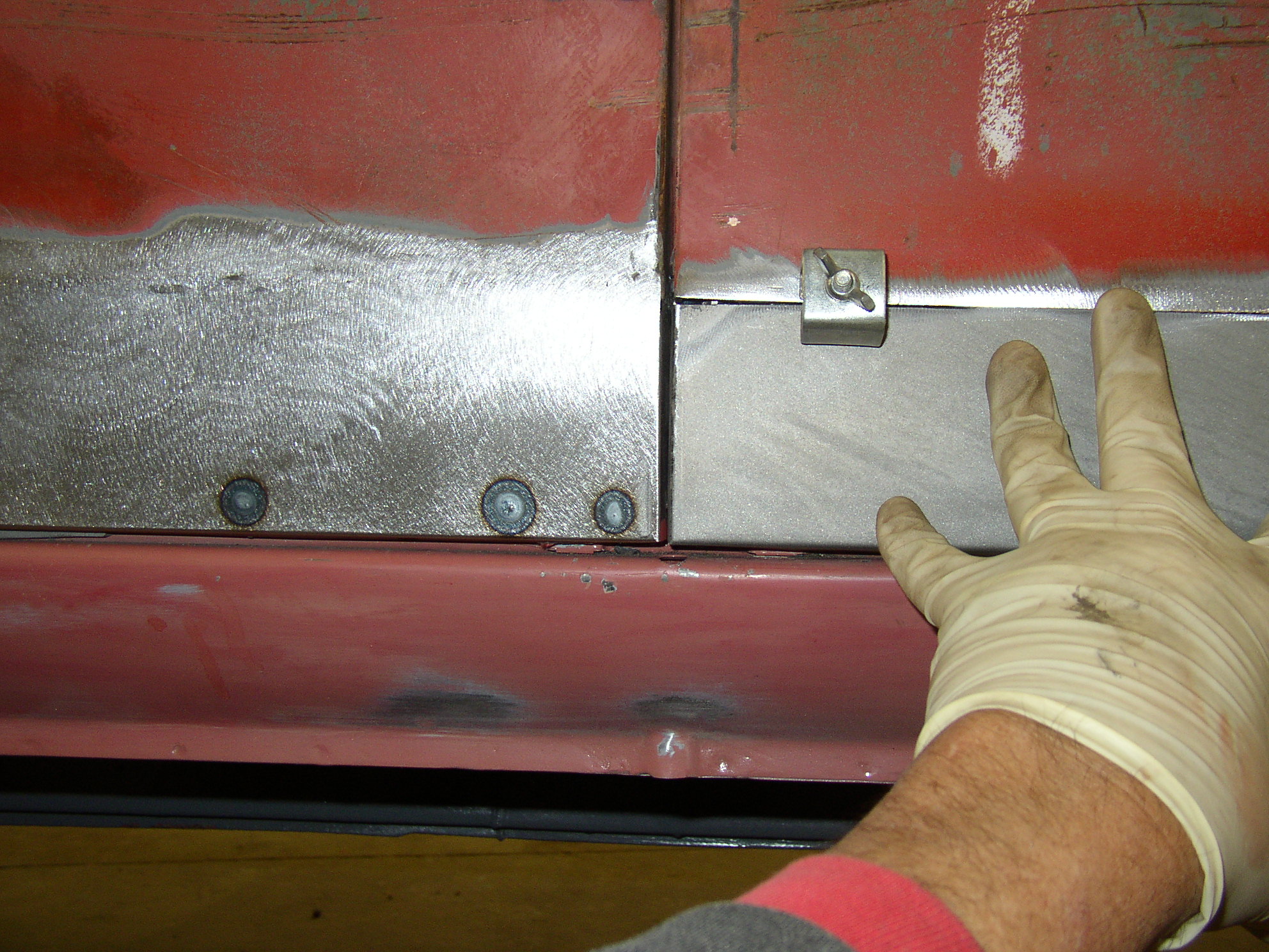

Now grind out the weld buggers so it's ready for mud. All the time I'm fitting/welding, I'm constantly opening and closing the door to check the gaps and for interference to make sure the door operates properly. Note the gaps are nice and even.

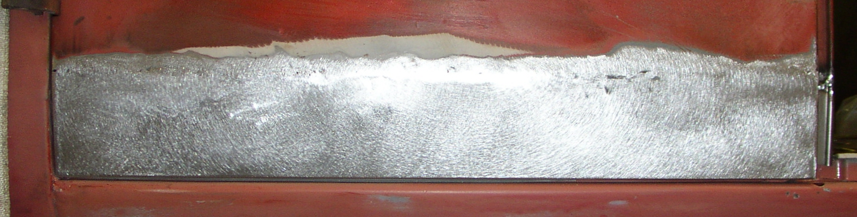

Let's check the warpage with a straightedge. If you're really good, like Kirk, all you need from here is high-build primer and color.
Not me, I need mud, but not bad, less than 1/8" will smooth this out.

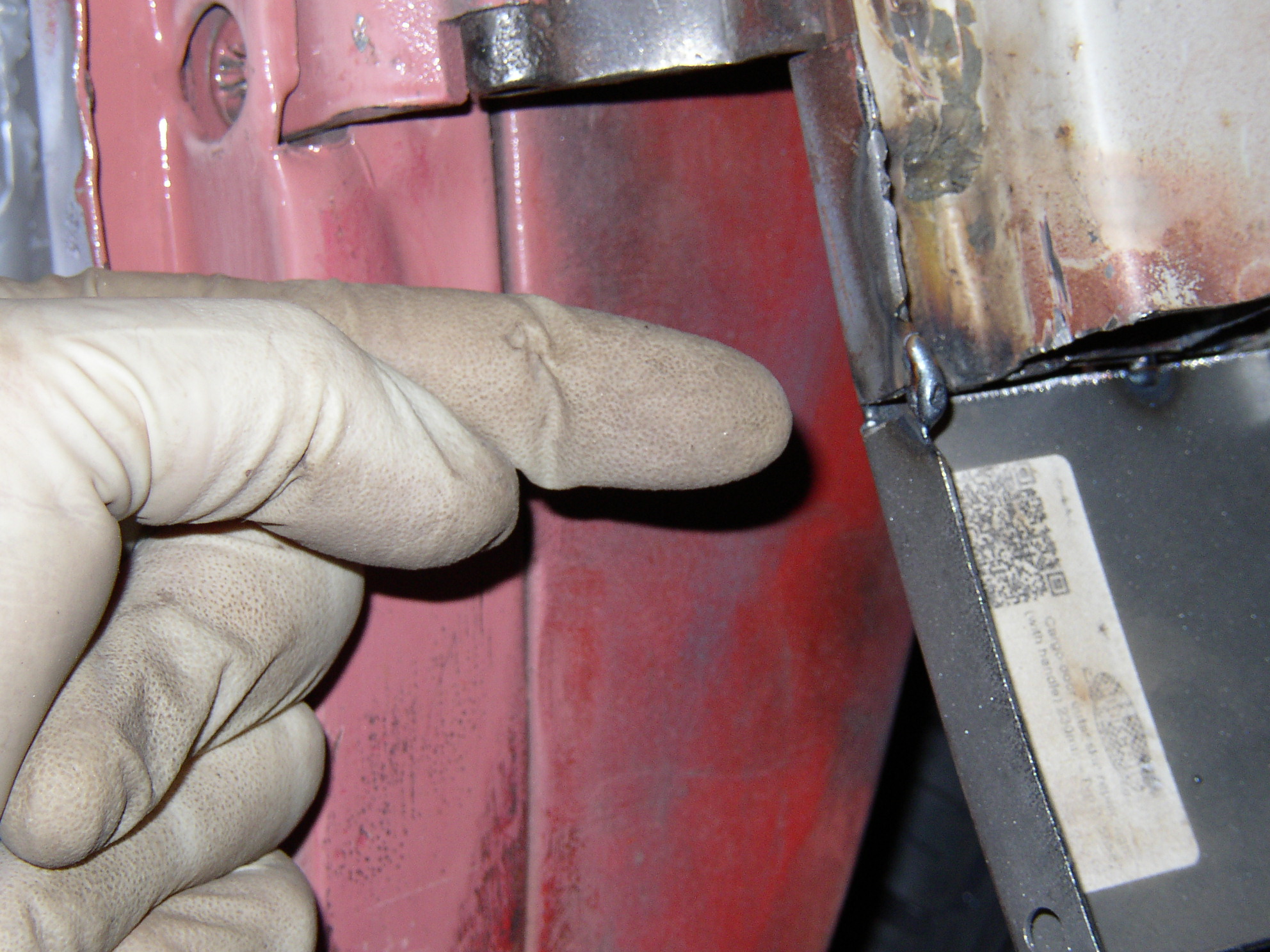

Now size up the inner panel and see how it fits into the floor. So far, so good. Note the red/pink edge of the rocker is even under the panel......

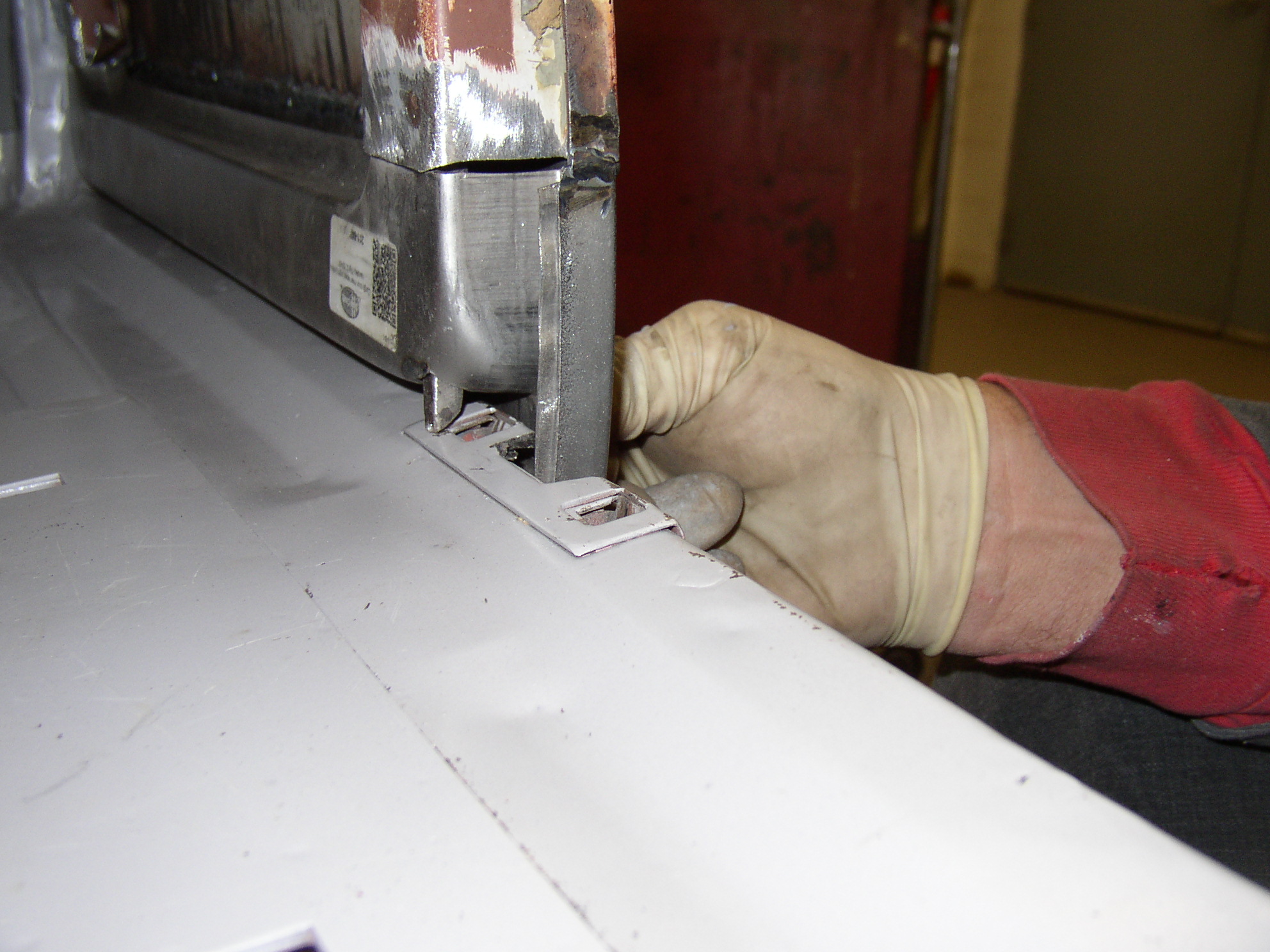

Until you put the lock rod in. Notice the panel is now too far out at the end by the lock rod and the rocker edge disappears. This is going to need some work. I had this issue on Bus 1 also and saw it too late, I ended up cutting the latch plate out of the floor, moving it inboard about 5/8" and re-welding it. I know this is not an unusual problem as I started looking closer at other restored busses and it's not unusual to see the cargo doors "pooched" out at the bottom center where they meet.

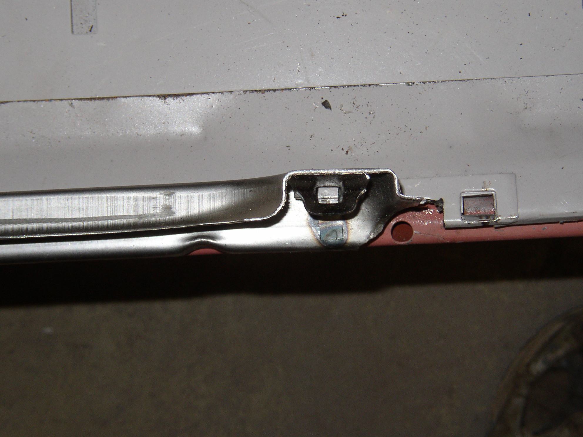

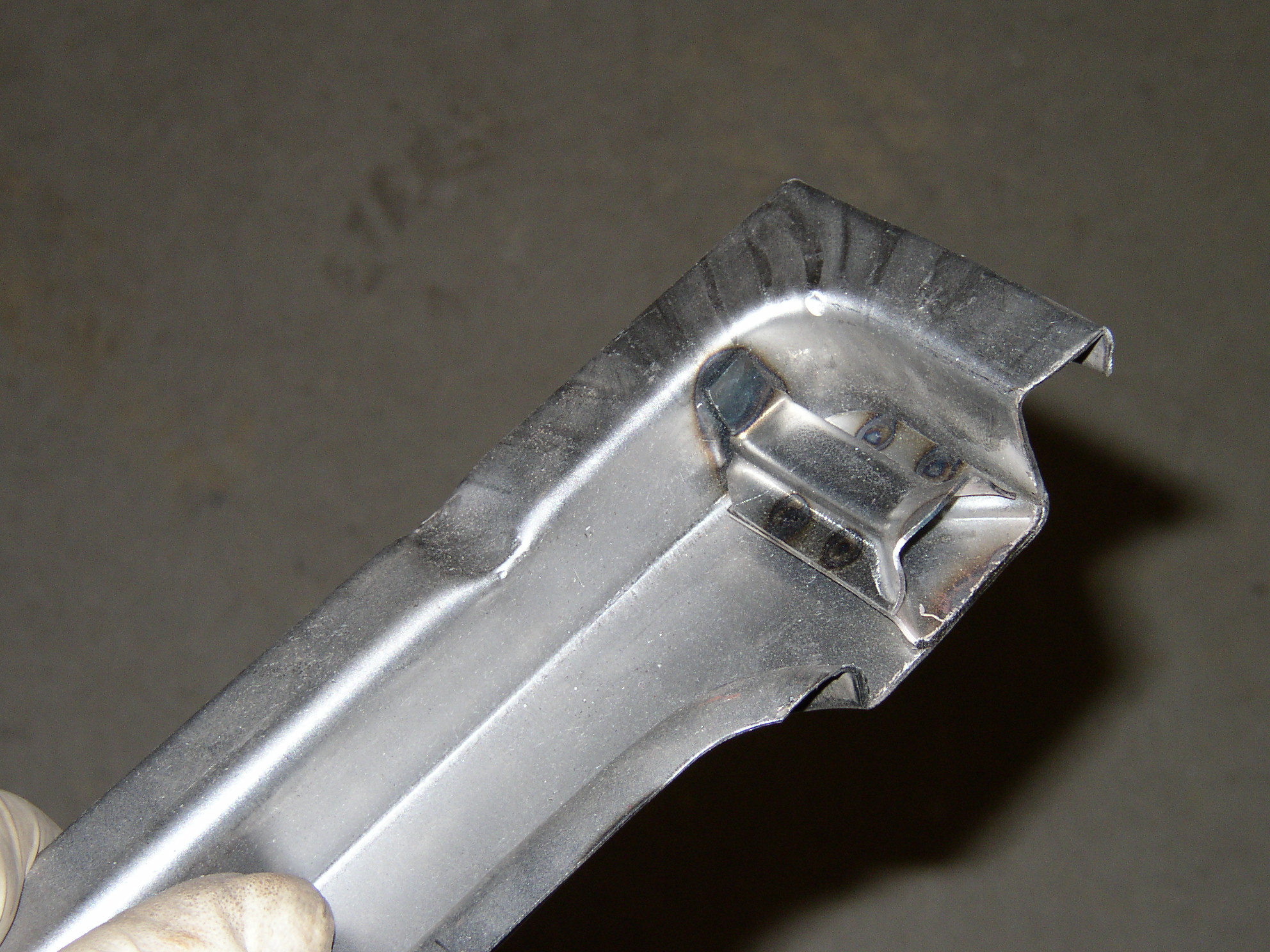

If you look straight down through the lock rod guide you can see how much it's misaligned. Compare it to the right side lock hole.

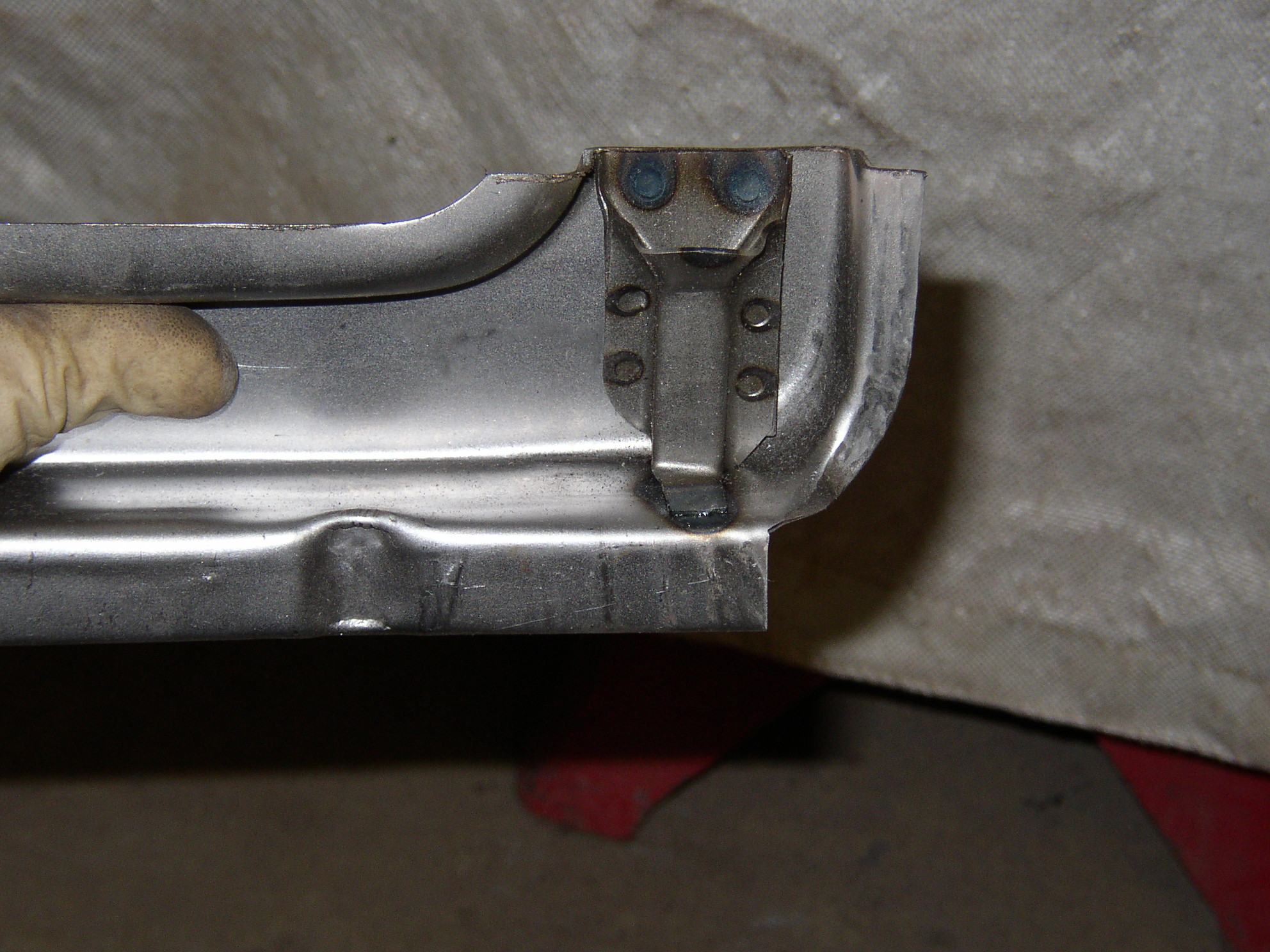

So drill the spot welds partially through to weaken them, then pop them apart with a screwdriver. Here's the bottom, compare it with the rotted OEG- not that much different. Open up the hole with a square file to bring the lock rod about 3/8" outboard. Test fit it. Clamp the guide back in using a hex nut as a spacer. Weld it in place, Drill some holes for plug welds, someday I'll buy a spot welder instead of borrowing Chuck's. It's not going to see daylight inside for a long time so shoot it with some weld-through primer.

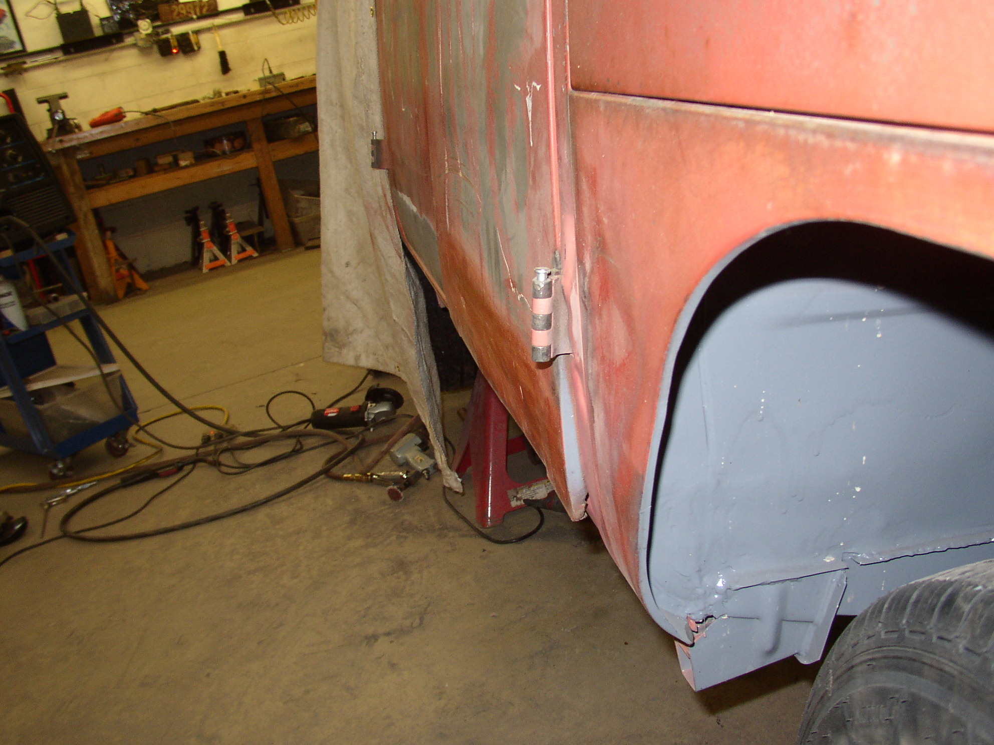

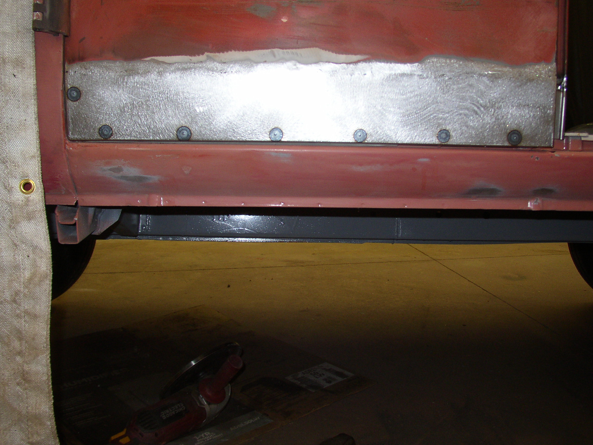

OK, on to the right door. Make your pencil mark where you're going to cut the bottom off. It doesn't have to be even, or level, or in line with the left door. Leave as much OEG metal as you can, mark it just above the rot where there's good metal.
Make your cut.
Grind the sharp edges from the cut line so you don't hurt yourself.

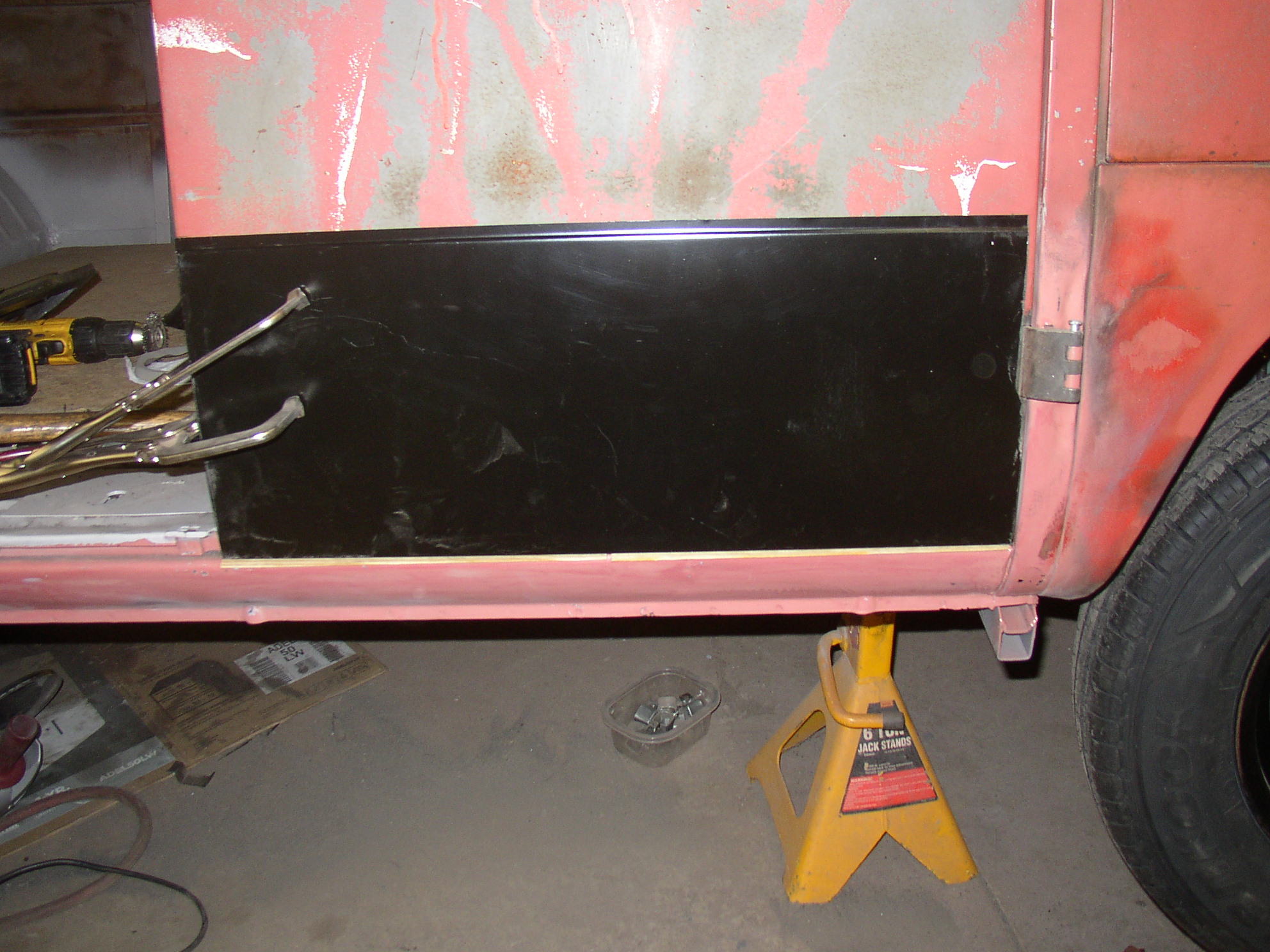

Set your new panel in place and trim the right side where it interferes with the hinge. This will allow it to sit pretty flush in place.
Clamp it in place and set your gaps with stir sticks.

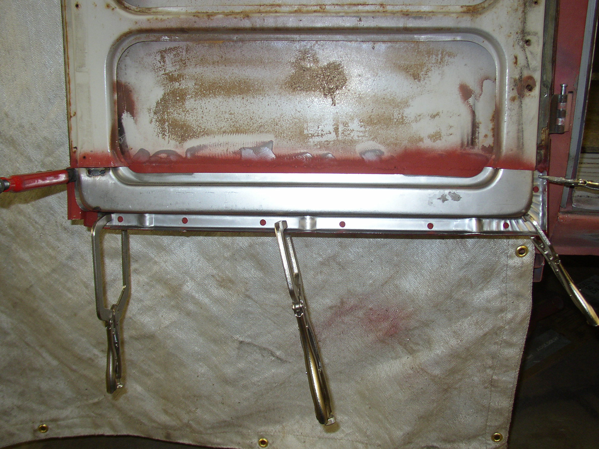

Make your marks for the inner panel.
Cut the panel and test fit it.
