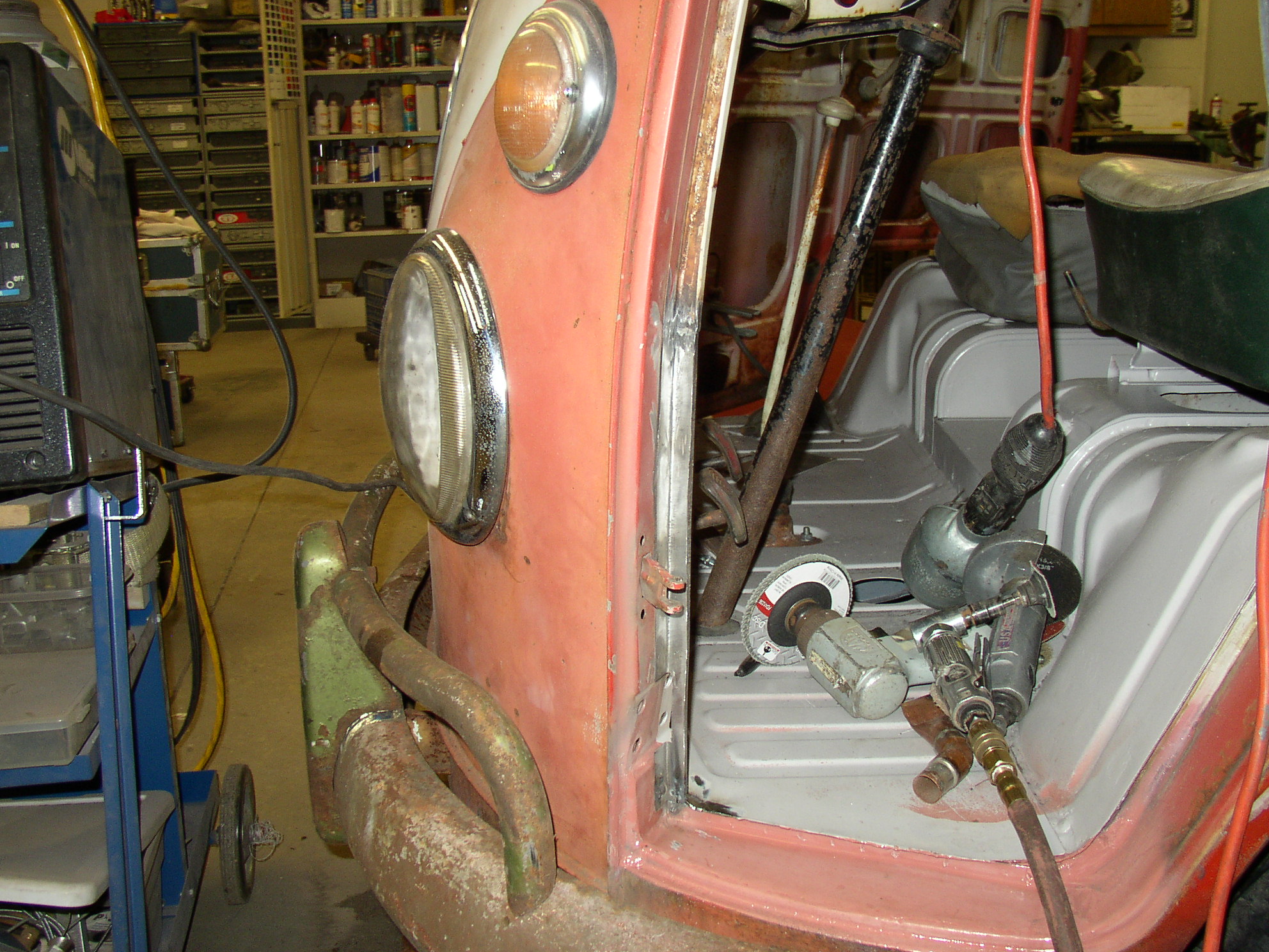

I went to install the front doors and realized I had forgotten/procrastinated to fix a weatherstrip channel. :oops:

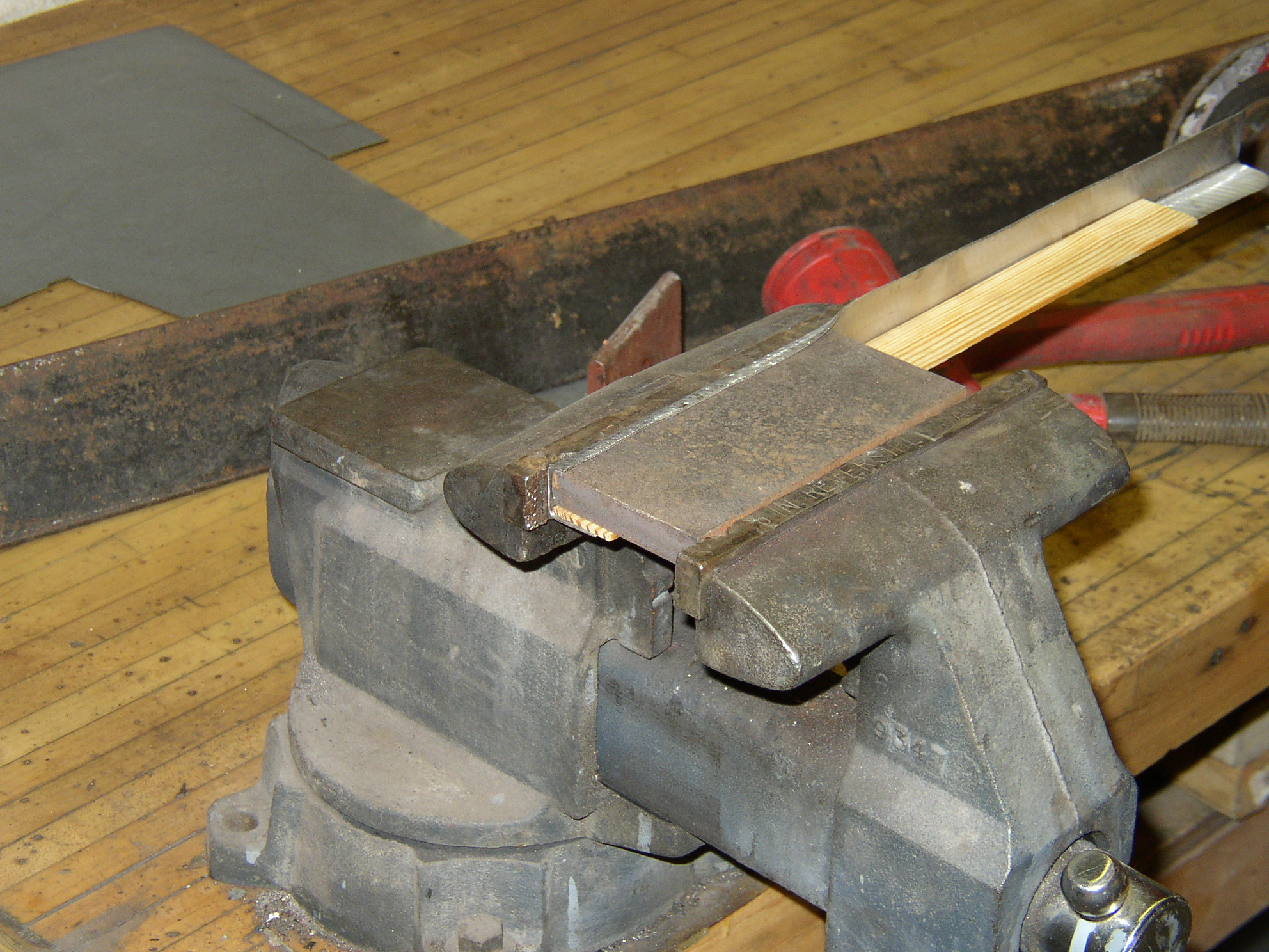

This is pretty simple: Find some .033", grind the galvanize off of it so I don't get sick, cut to size.
Put it in the vise and bend the angles.
Fit it in place.
Drill holes for plug welds.
Clamp.
Plug weld.
Grind out welds.
