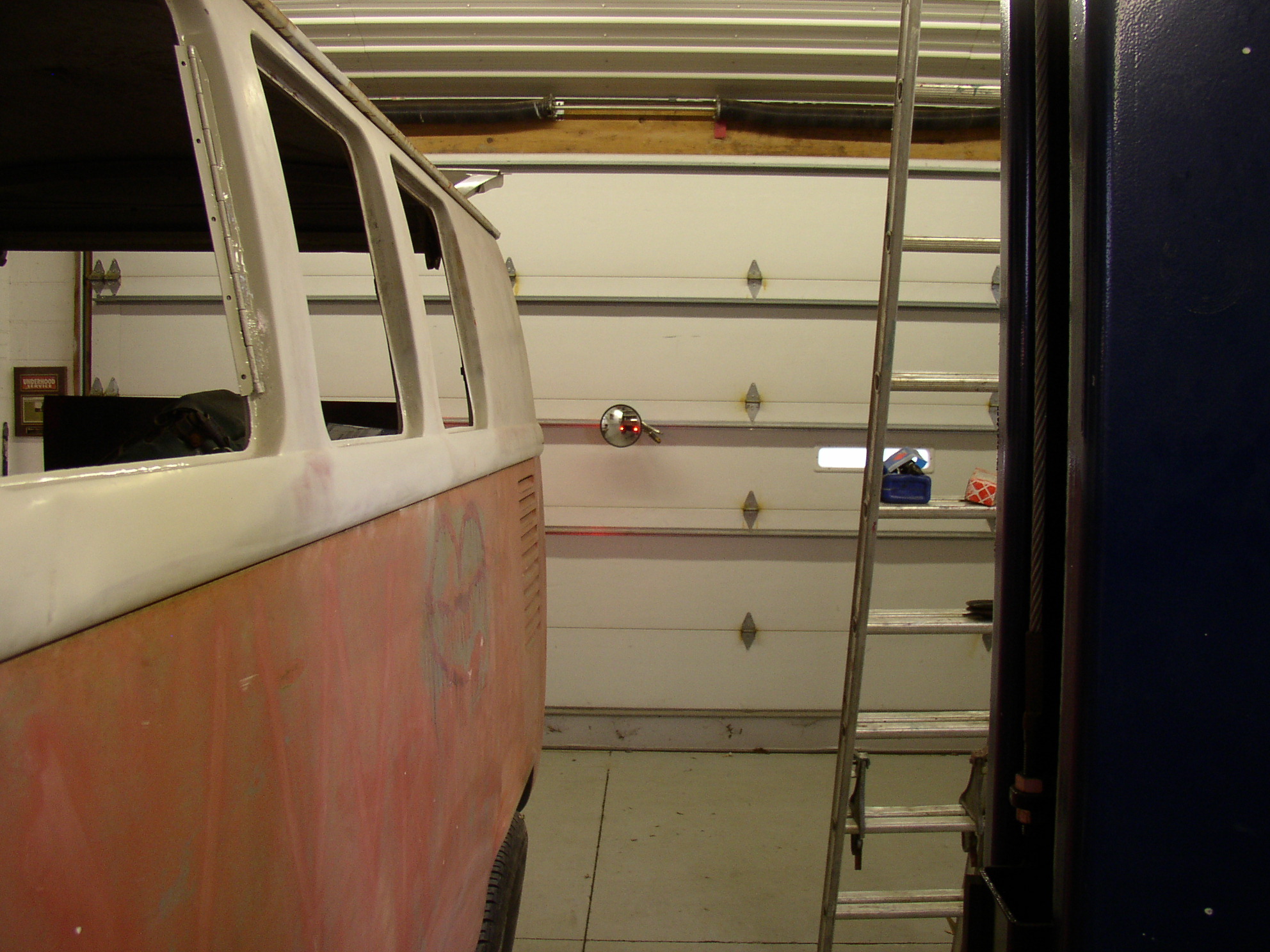

Clamped a bubble mirror to the garage door so I could see the taillights while I was sorting out the electrical.

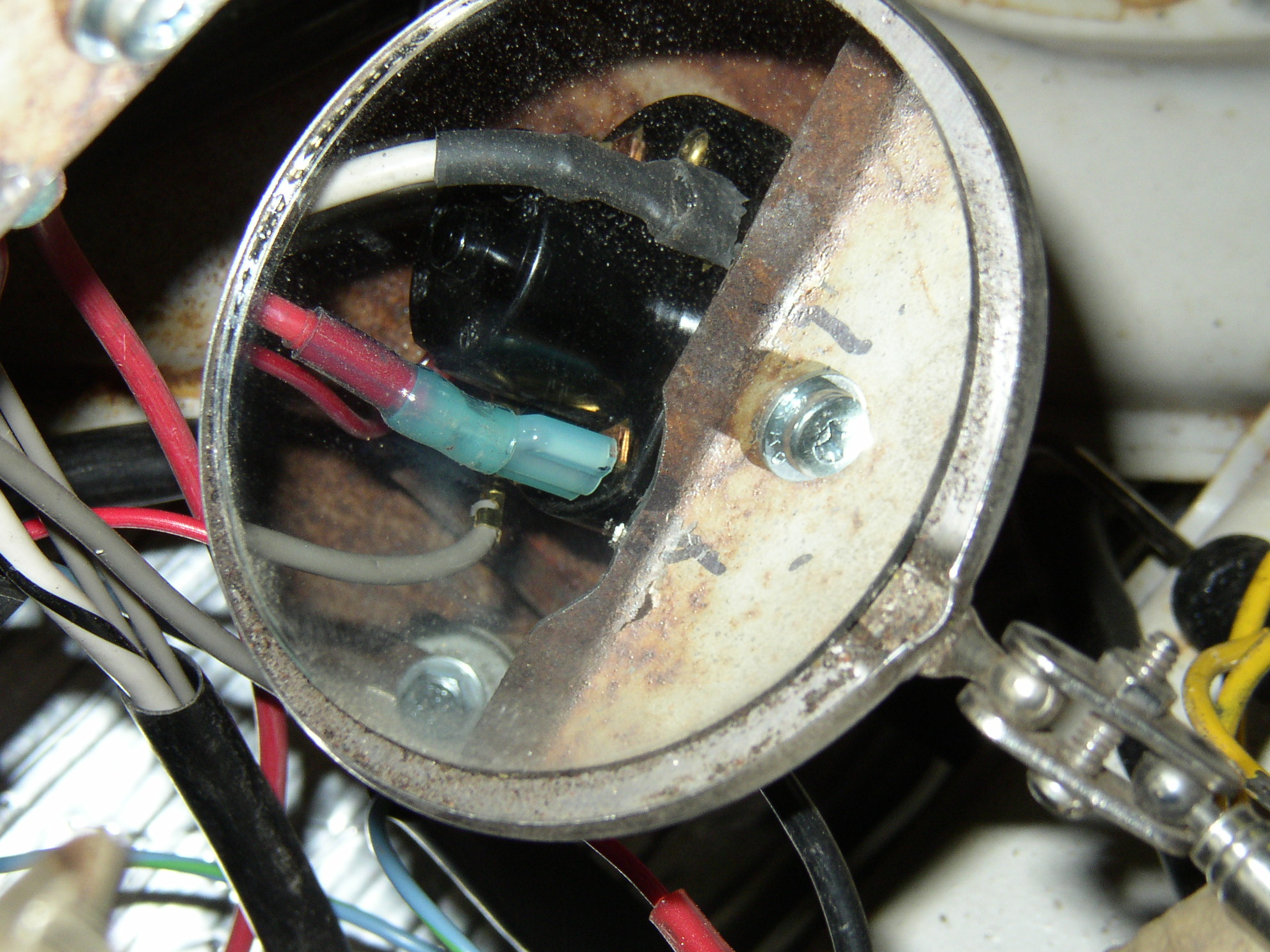

Here's why you need a 40a fuse in the back feeding the dash harness- the aftermarket ignition switch had the hot lead (blue connector) scary close to the lip on the dash. A little wiggle, a good bump, and your red wire turns bright red. :cry:
Quick work with a die grinder fixes that.

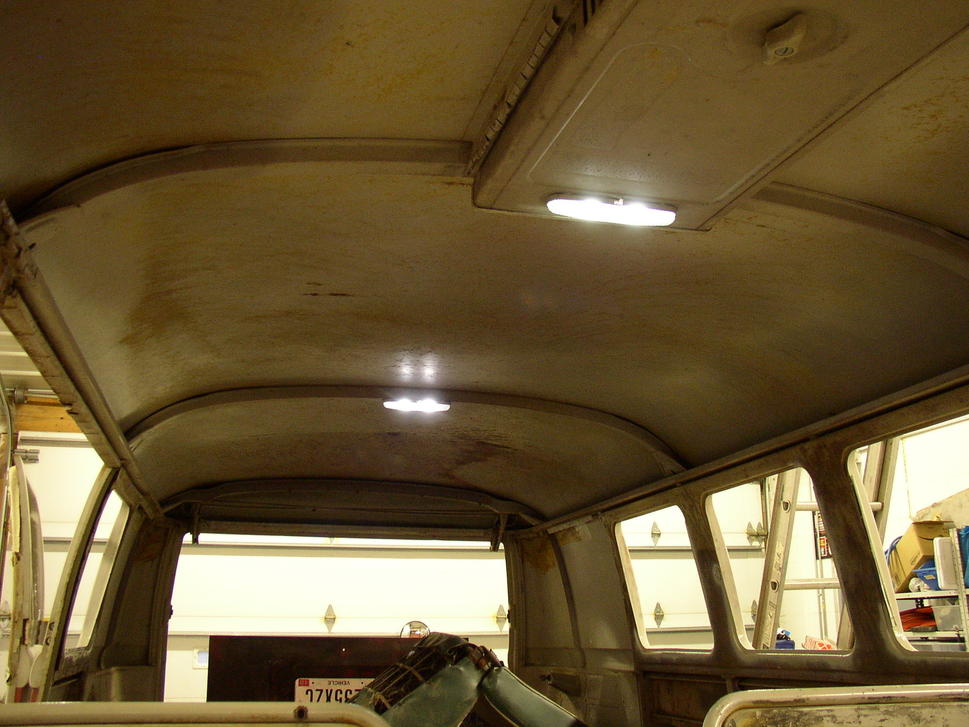

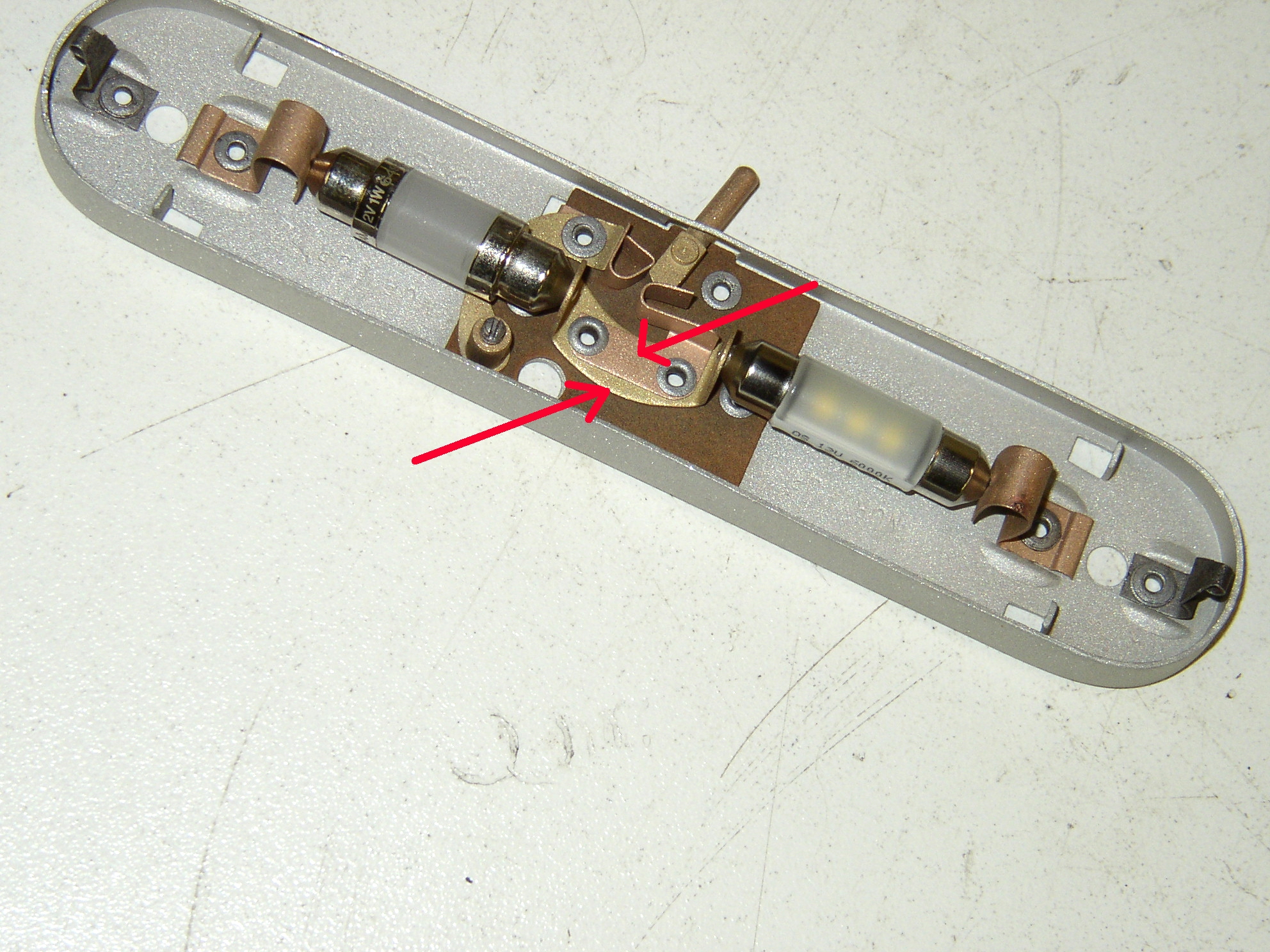

And we have LED interior lights!
Each of the four bulbs draws only 30ma (.030a) so one bulb could be left on for several months before running the battery low. I love these things and am currently converting my home bulbs all over to LED, and am thinking about changing all of the shop fluorescents to LED too. ;)

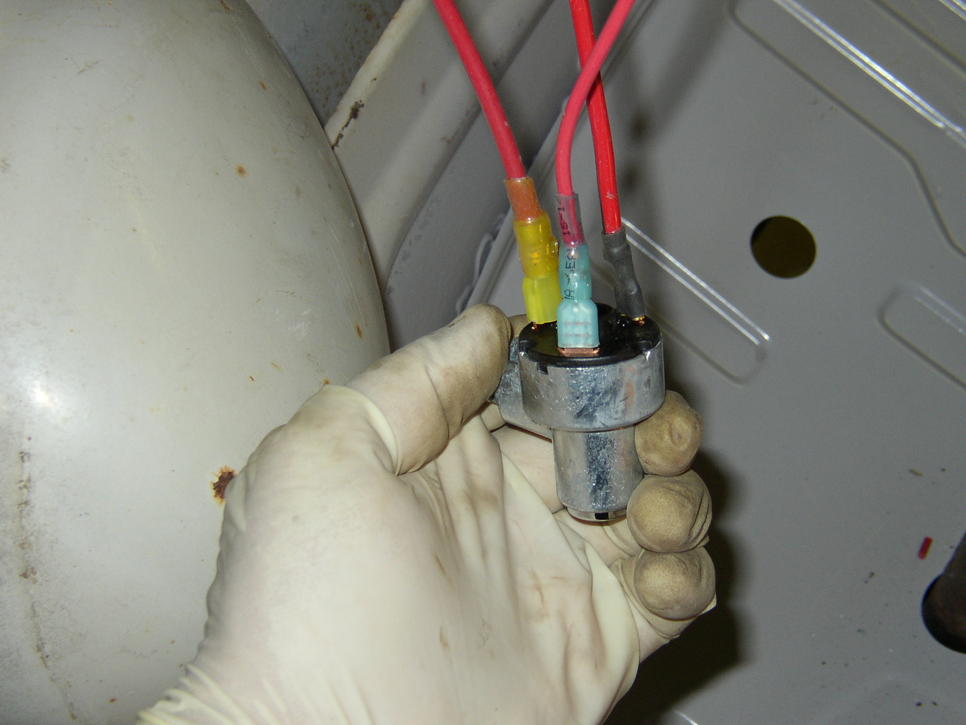

Here's the back of the ignition switch showing the updated wiring and shrink tube, It's kind of important to shield hot leads from accidental grounding, (right, Volkswagen?).

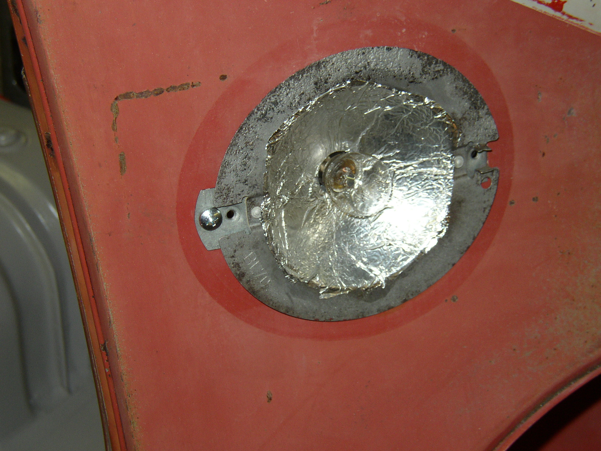

Yes, I did the hillbilly glue-the-foil-to-the-reflector on the front lights. They're really bright, though, I put 1156 bulbs in which might be higher wattage than they should be.

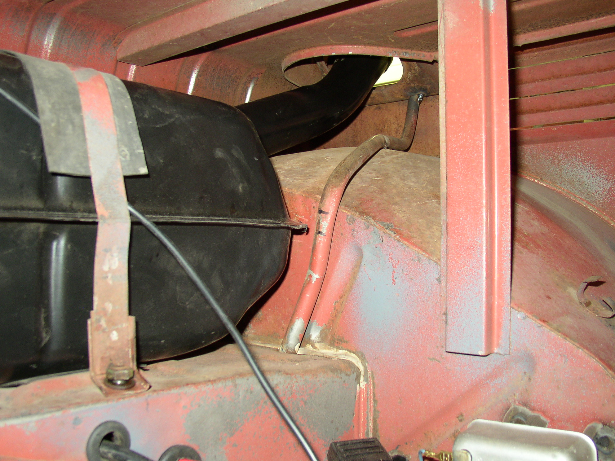

I put a new tank in but it didn't fit as well as the WW tank in Bus 1. Some modification had to be made, cutting a reinforcement off and doing some hammer damage to the drain tube.

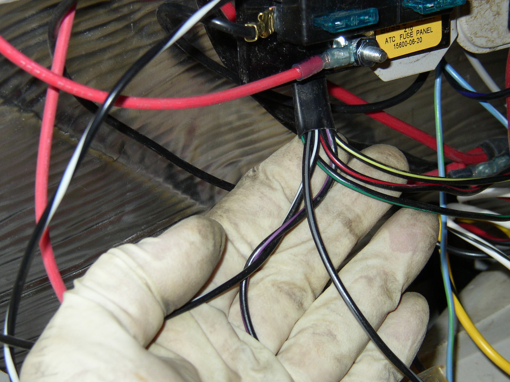

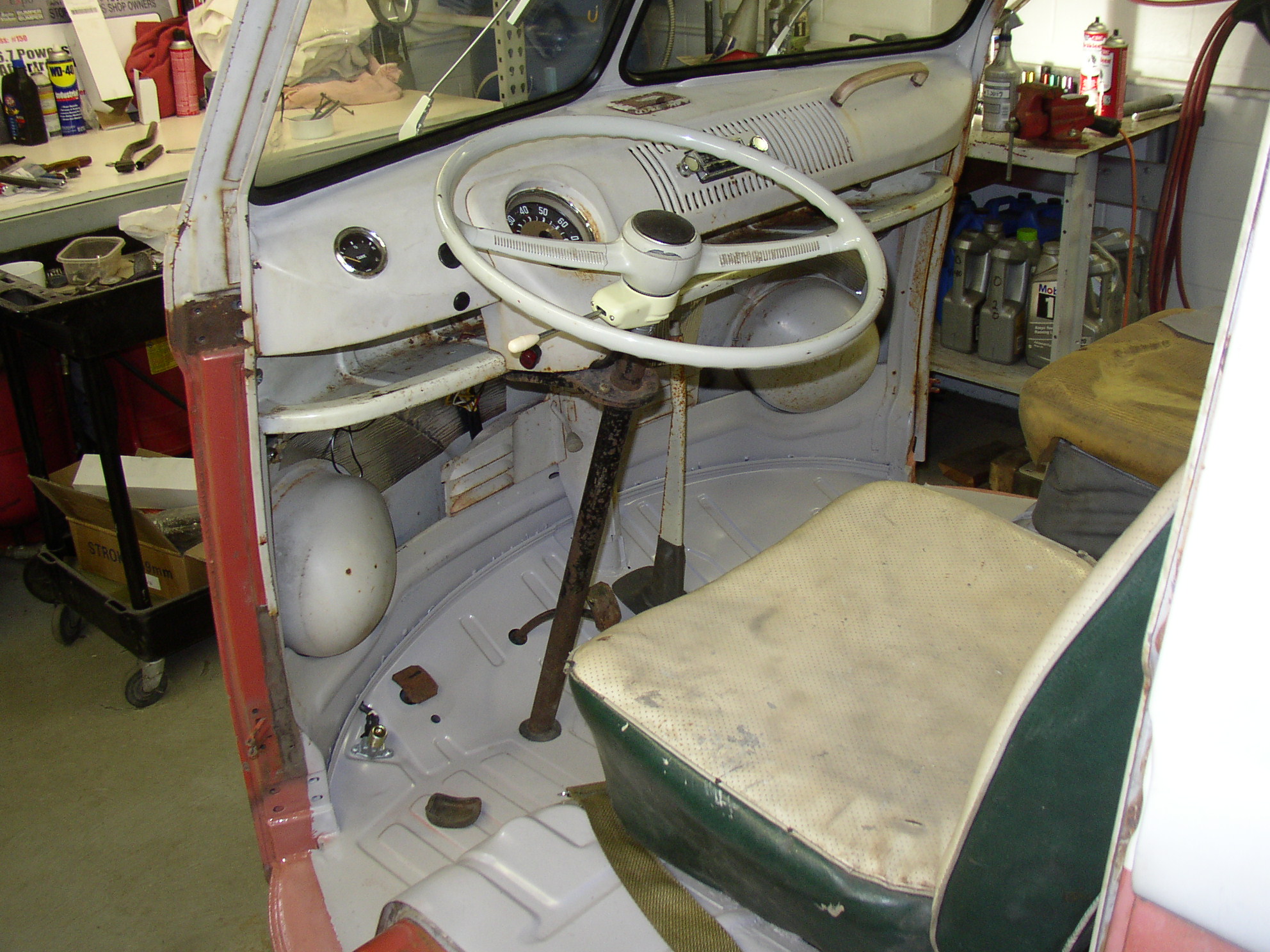

Electrical is done, here's what the dash looks like. Typical of me is putting in an extra fusebox so loads are spread out, this is easier on the wiring as well as making diagnostics easier if it blows a fuse.
It's actually starting to look like a bus again. :D

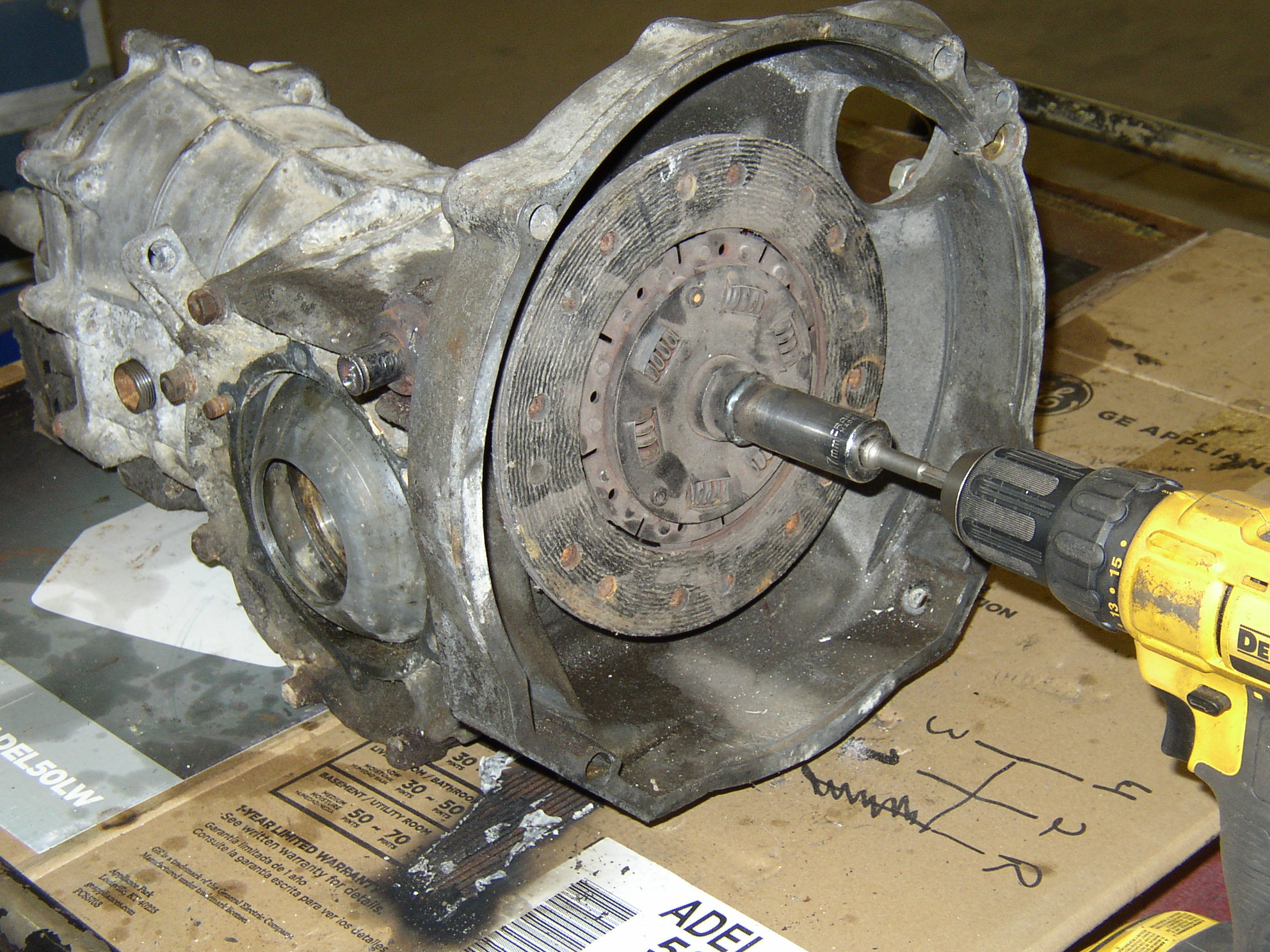

Second, hook up my homemade drill driver tool and see if all five gears are present, check. Note reverse gearshift pattern written on cardboard to help me figure out where I am.

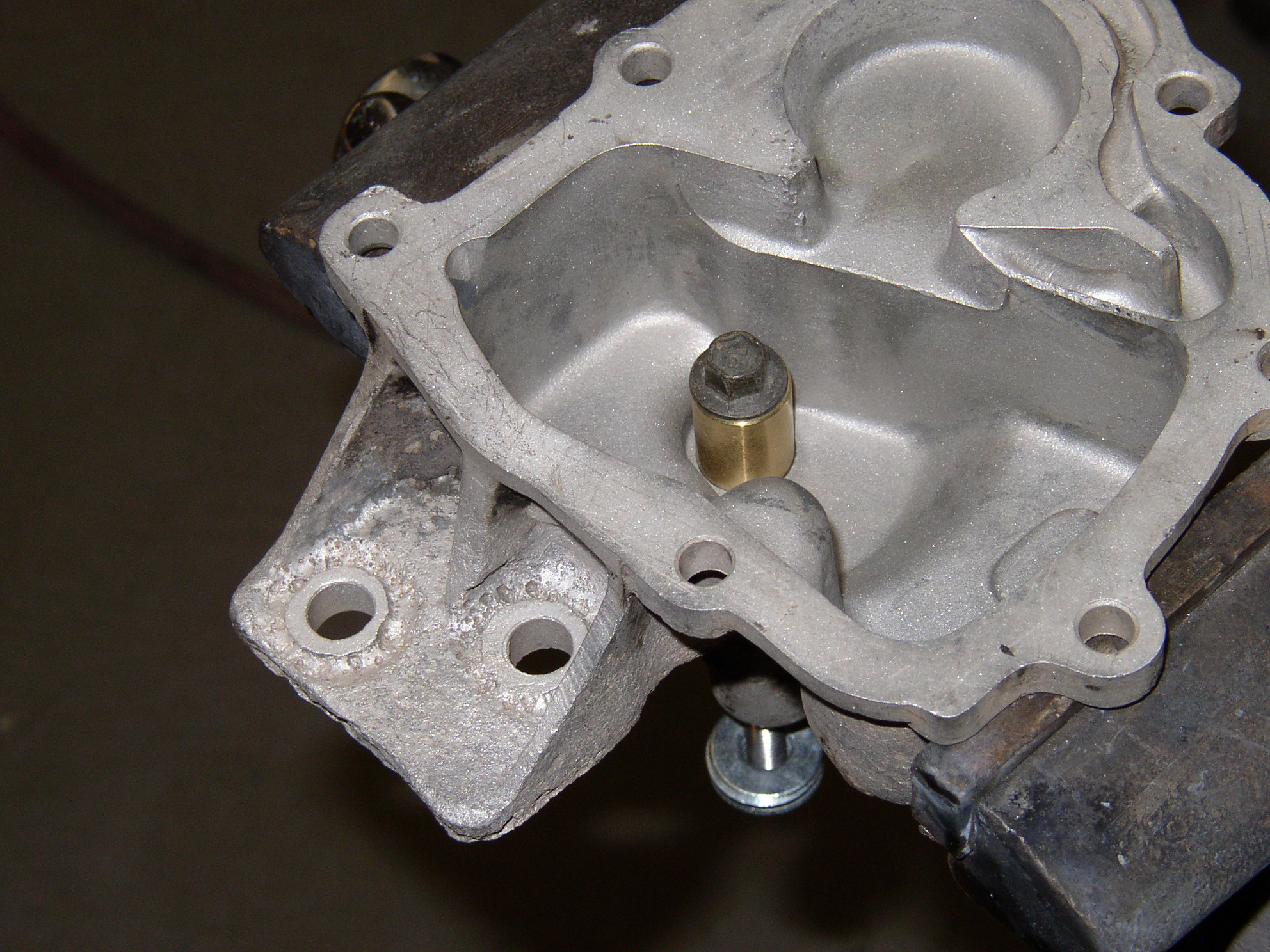

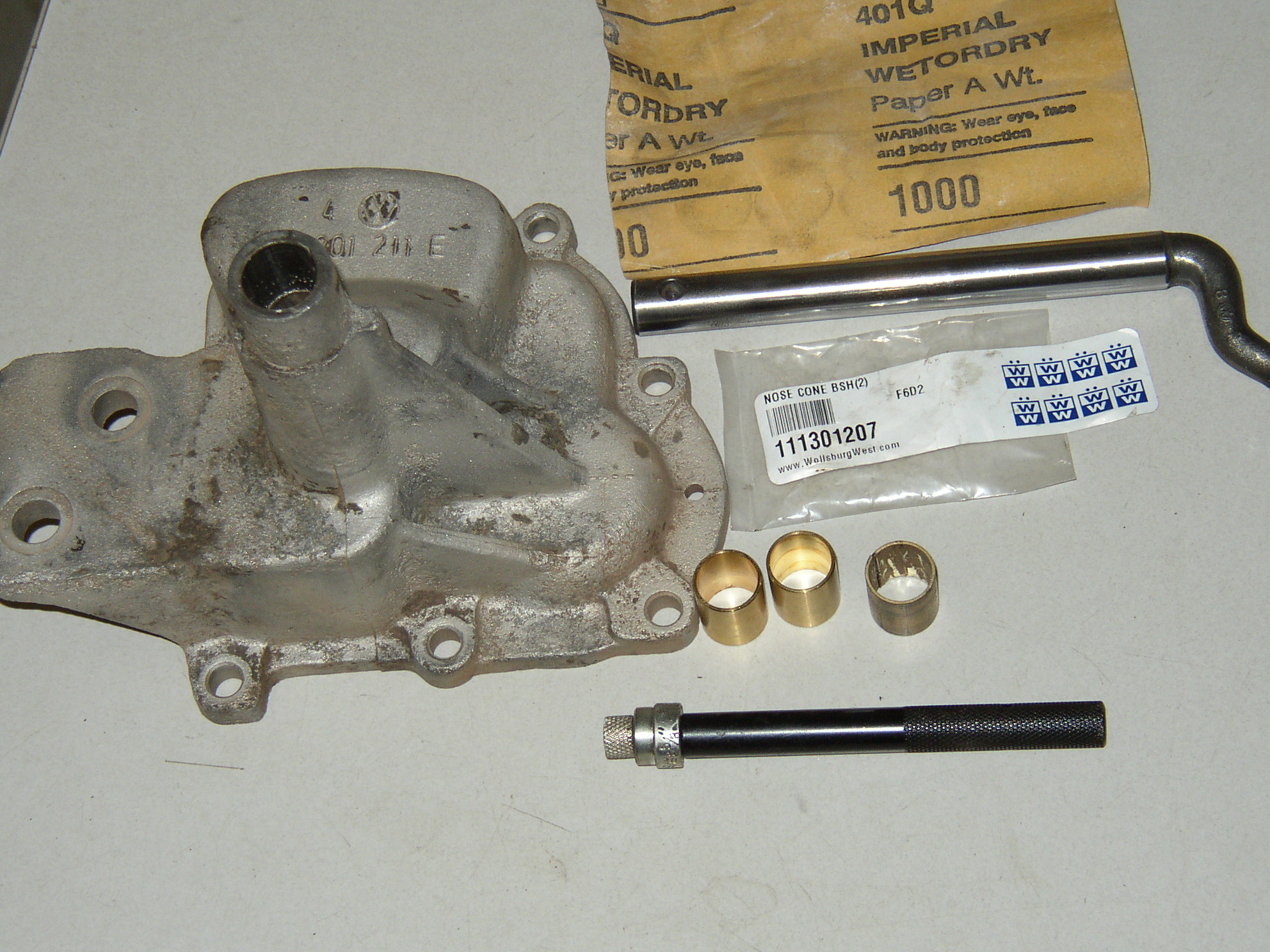

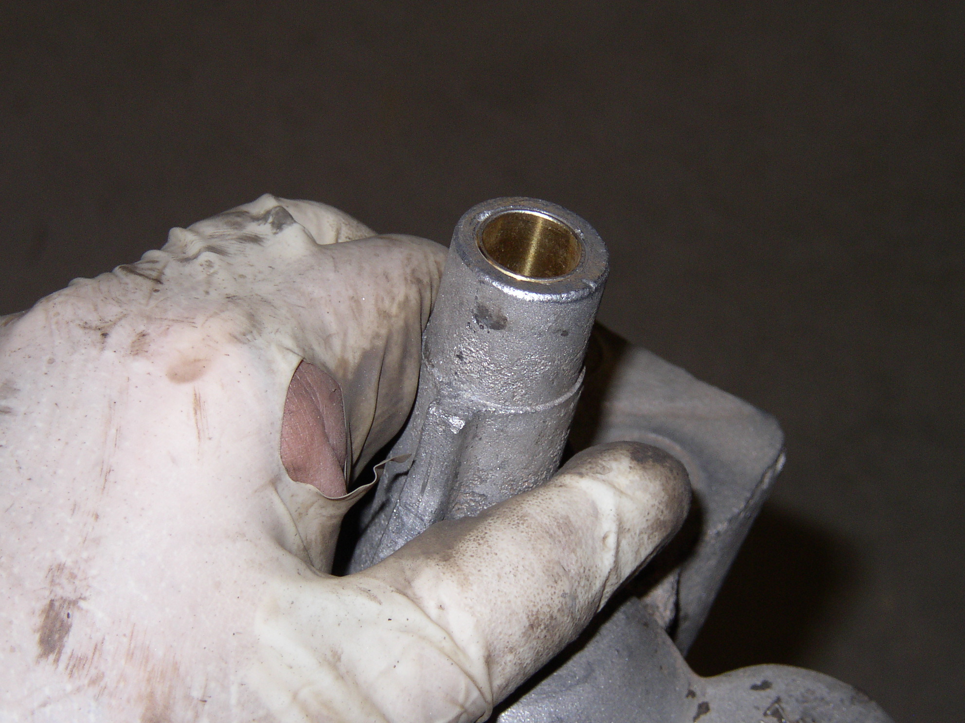

OK, the trans might be OK, proceed with putting new shift bushings in the nosecone. Most people would buy a new $40-60 nose, but not me. :roll: Polish the hockey stick with 1000 grit.

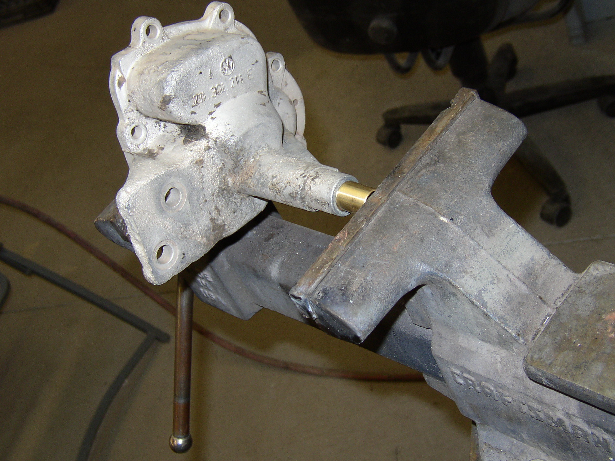

Pull the nose, blast it, drive out the old bushings, push in new bushings.
Use a bolt to draw in the inner bushing.
Looks good.

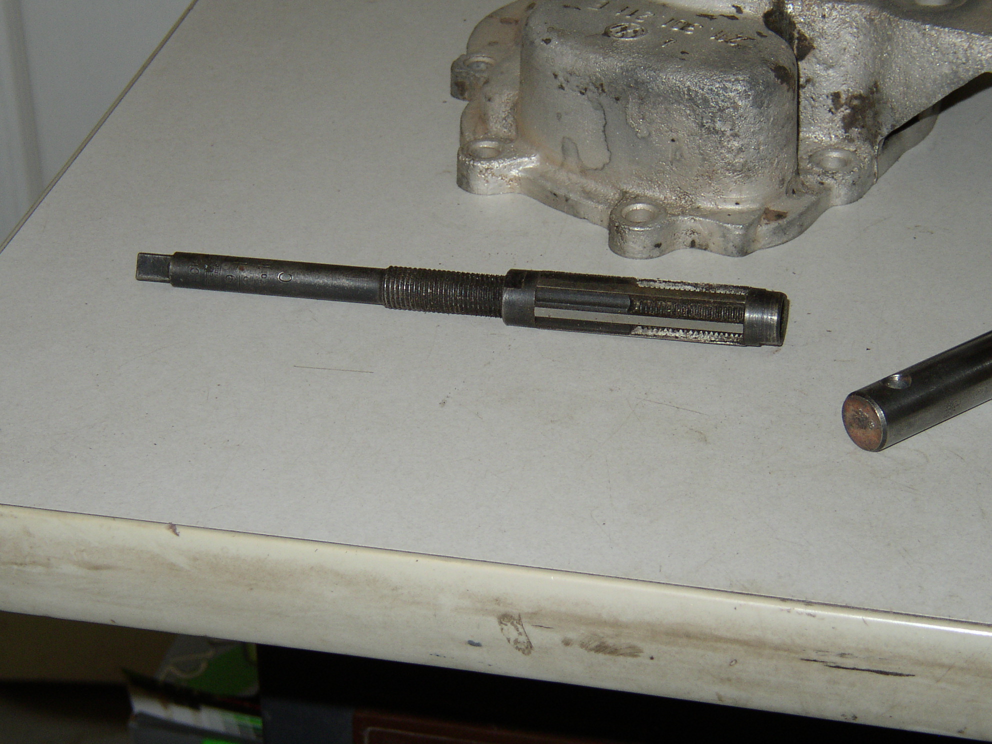

I didn't even need to ream them!
Thin coat of RTV and it works great.

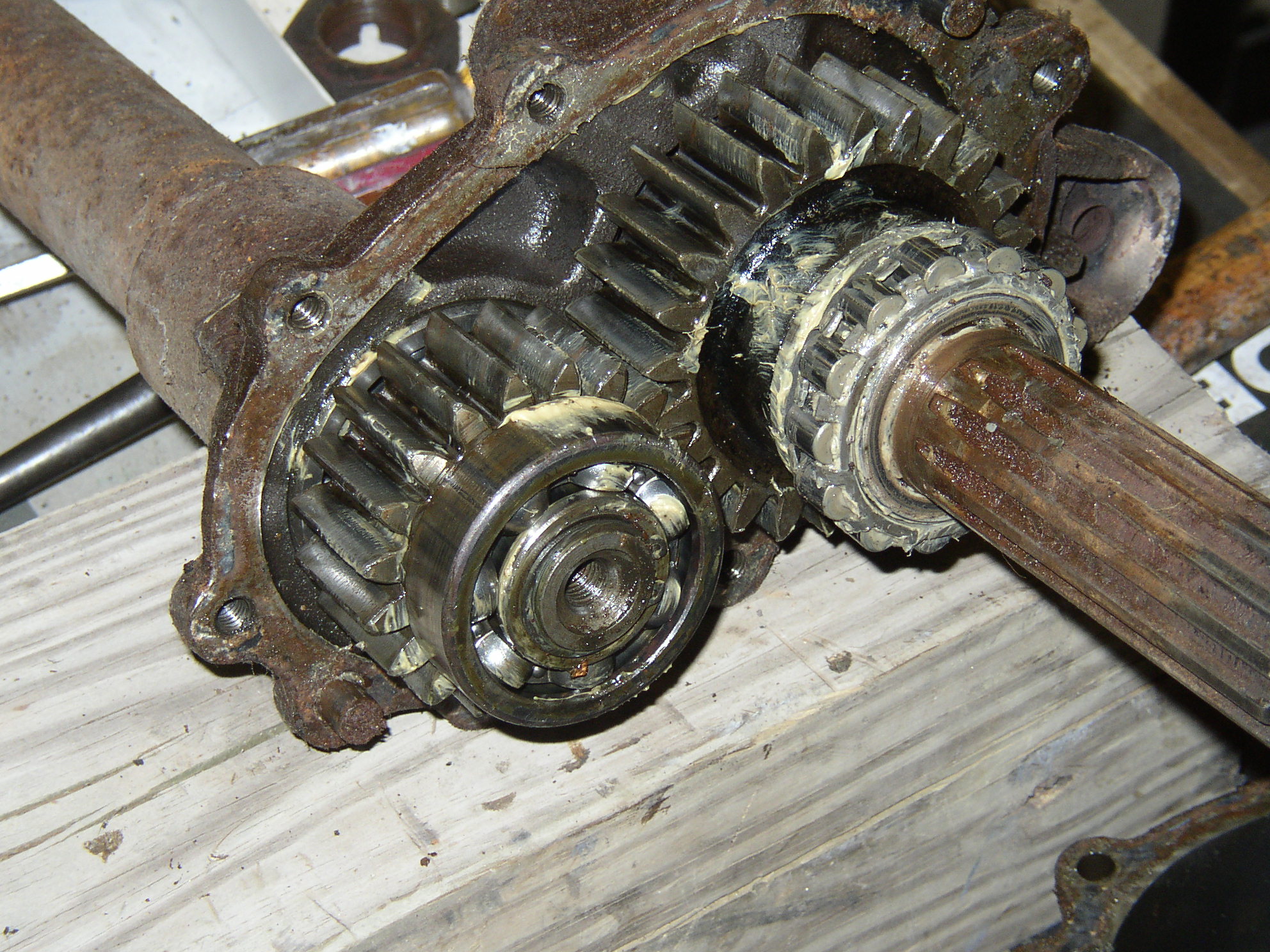

Forensics during disassembly of the RGBs reveals someone was JUST in here- but maybe decades ago. These haven't even seen gear oil yet, they still have lithium grease on the gears.

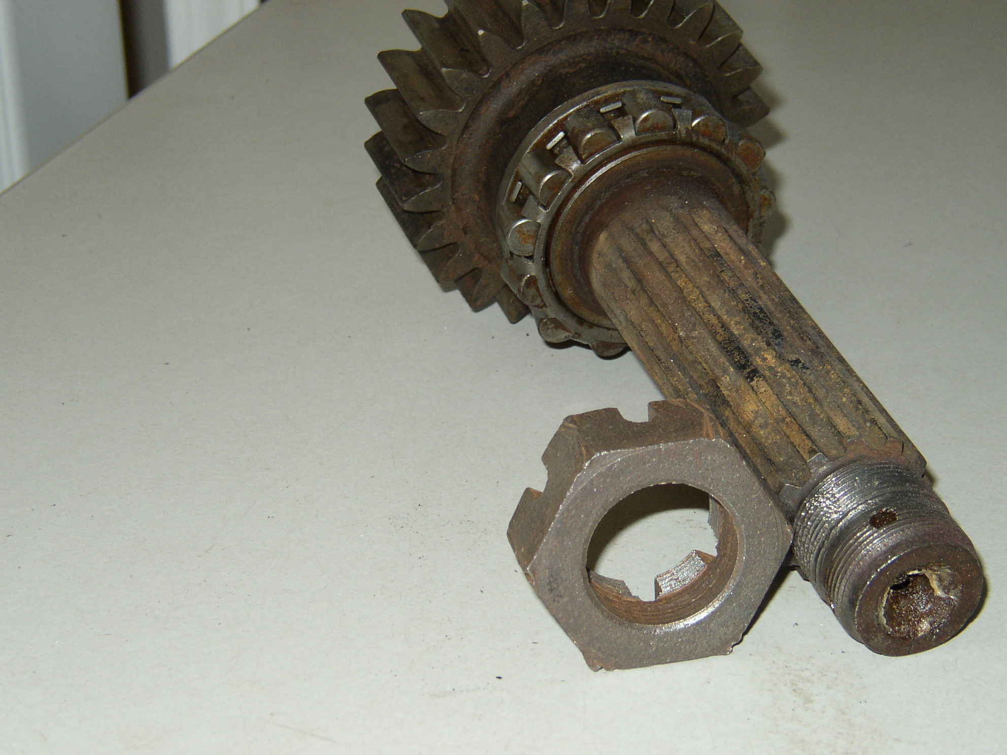

But what's the crime? Putting in this stub axle, and some trashed bearings. Who the F would do this?
Weld the nut, pull the plug.
The inner stub nut can either be a hex or some kind of devilish slotted nut that even VW does not make a tool for.

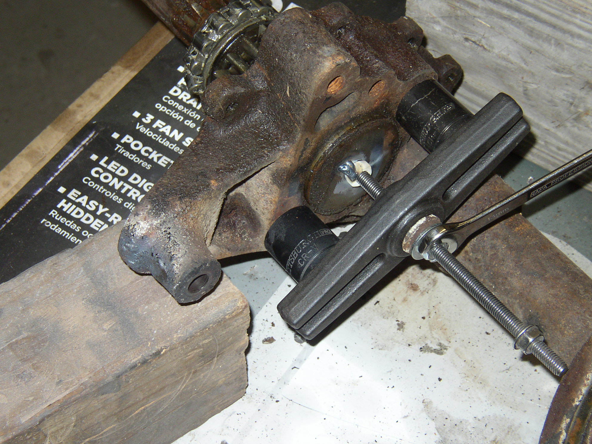

Put the tube on and draw in the bearing with a homemade spacer.
