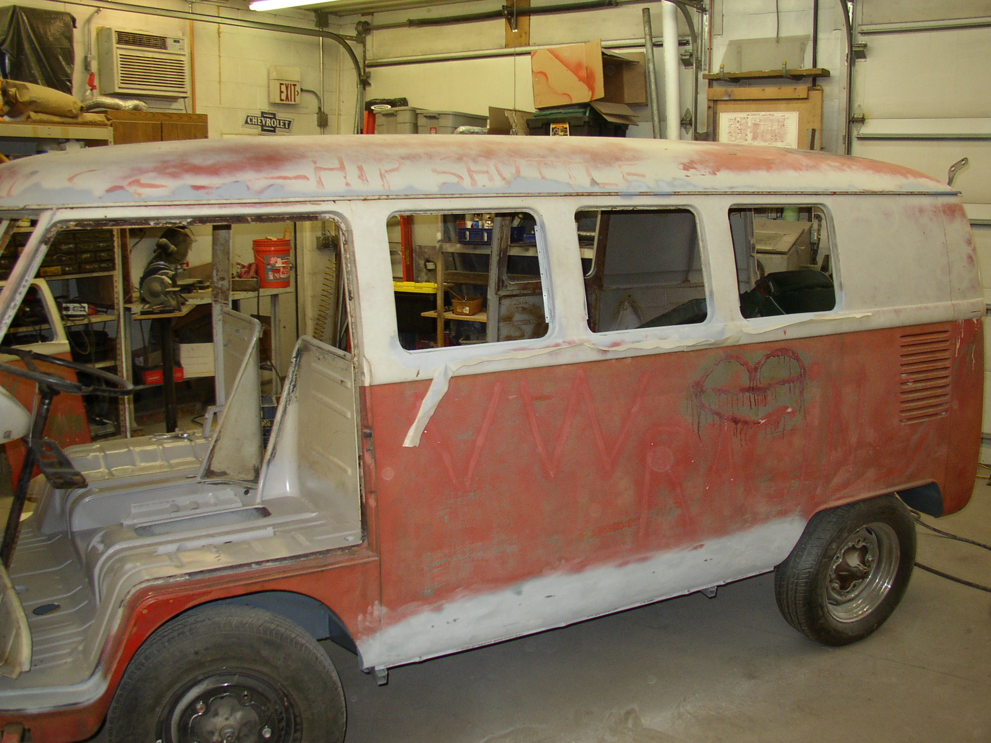

Here's shots of the finished product, the beige gray was dead on. I used a Scotch Brite pad to dull the finish, removing the gloss to blend it in to the old BG.
The forward cargo door is the one the popout hinge was replaced on.
Posts: 1392
Here's the "finished" product, looking as scabby as can be. I'm sure when I drive it people will ask, "Are you going to paint it?"- I don't know what I'll respond. :roll:
Here you go Lurch, this is what you'll be dealing with. :D
I haven't welded in the cargo door bottoms yet, but I will. ;)
This is after shooting the red but before sanding/color blending.
Here's a good before and after shot. There's a piece of paper sitting on the roof, but this is early,
And this is now.
W5 would be proud. On to assembly!

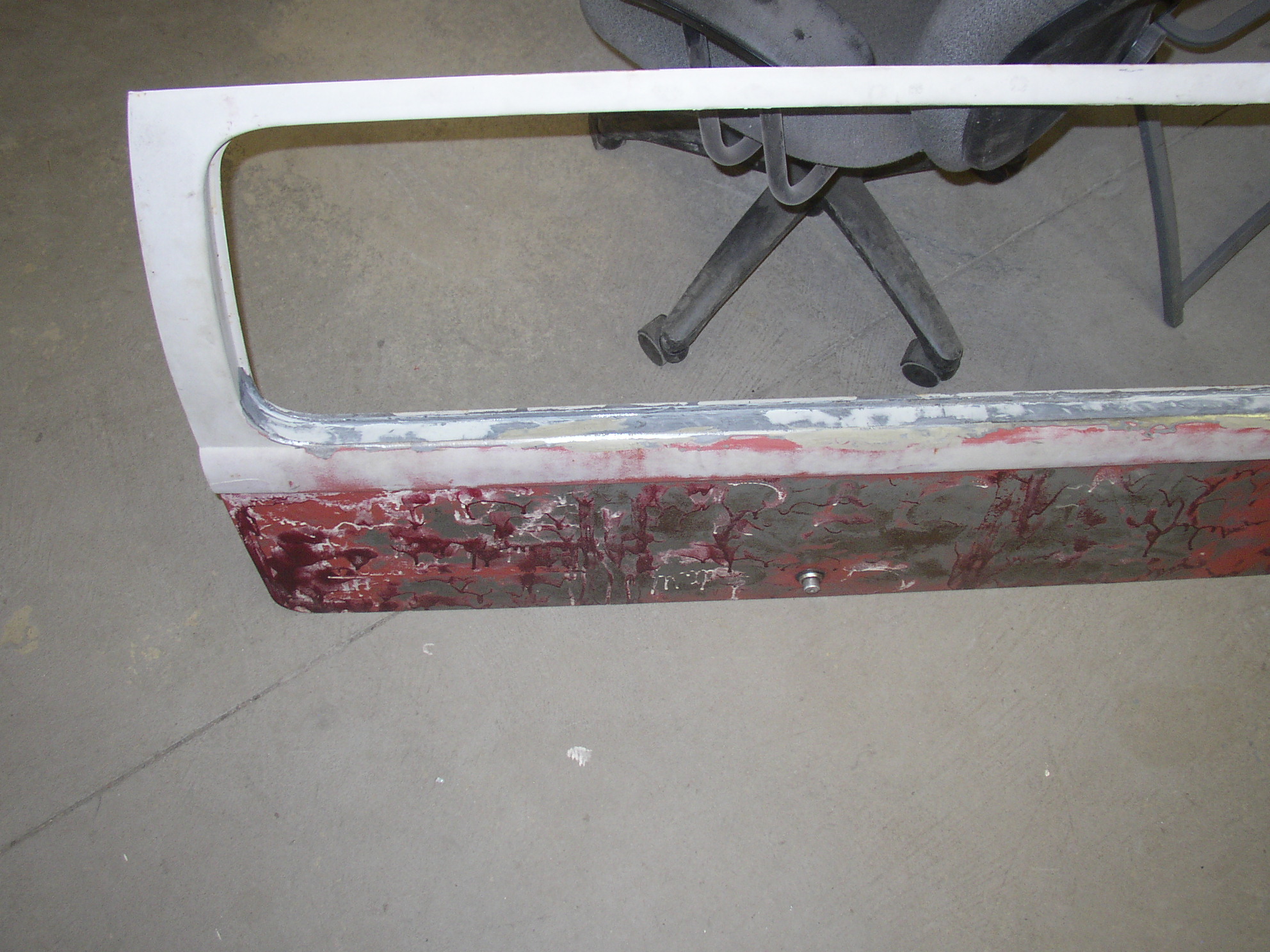

The decklid was a mess and I have a better one. I wanted to keep the one original to this bus but I didn't want to make a weeklong task of welding metal. It was only rotted in one place- just outboard of the glass area (not under the rubber, oddly enough) on the horizontal surface of the window ledge. Looking at it, I wonder if the Texas sun was reflecting off the glass at the right time of day and baking that particular area. The bottom of the decklid is beautiful, but just outboard of the glass it was severely pinholed. I took the shortcut route- sandblast it really well, epoxy up the pinholes, (Swiss cheese), and prep/paint. It actually came out much better than I anticipated. I tried (unsuccessfully) to remove some of the graffiti. I ended up removing as much OE paint as spray can. :roll:
