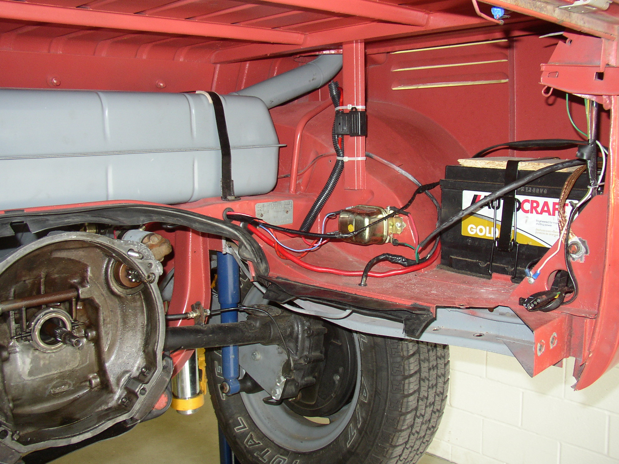

Then the rolling black cloud named 6Volt came down and Marla's luck turned to $hit. I put a timing light on it and the timing seemed like it was off quite a bit but I wanted to verify TDC. I put a wrench on the engine to find TDC and things went really south from there. I had Sean take a video but it's laced with inappropriate language so I won't post it here. ;) The engine will barely turn over with all my might on a crescent wrench. WTF? I thought maybe the starter had bound into the flywheel or the FW/clutch was rubbing on the bellhousing so I pulled the starter out to find nothing. At this point it's starting to look like it's internal which is bad. Really bad.
Out she comes.
Somebody's Beetle was on the rack so here I am, lying on the floor like a dog.
On the bench the engine takes way too much torque to turn but it has a funny little free spot of about 1" at the pulley where it turns free. 80 ft/lb? WTF?
I tell Sean the only time I've seen that is a seized main and mucked up main bearing dowel. Man, I had to open my big mouth. Off to Rizz's it goes.
