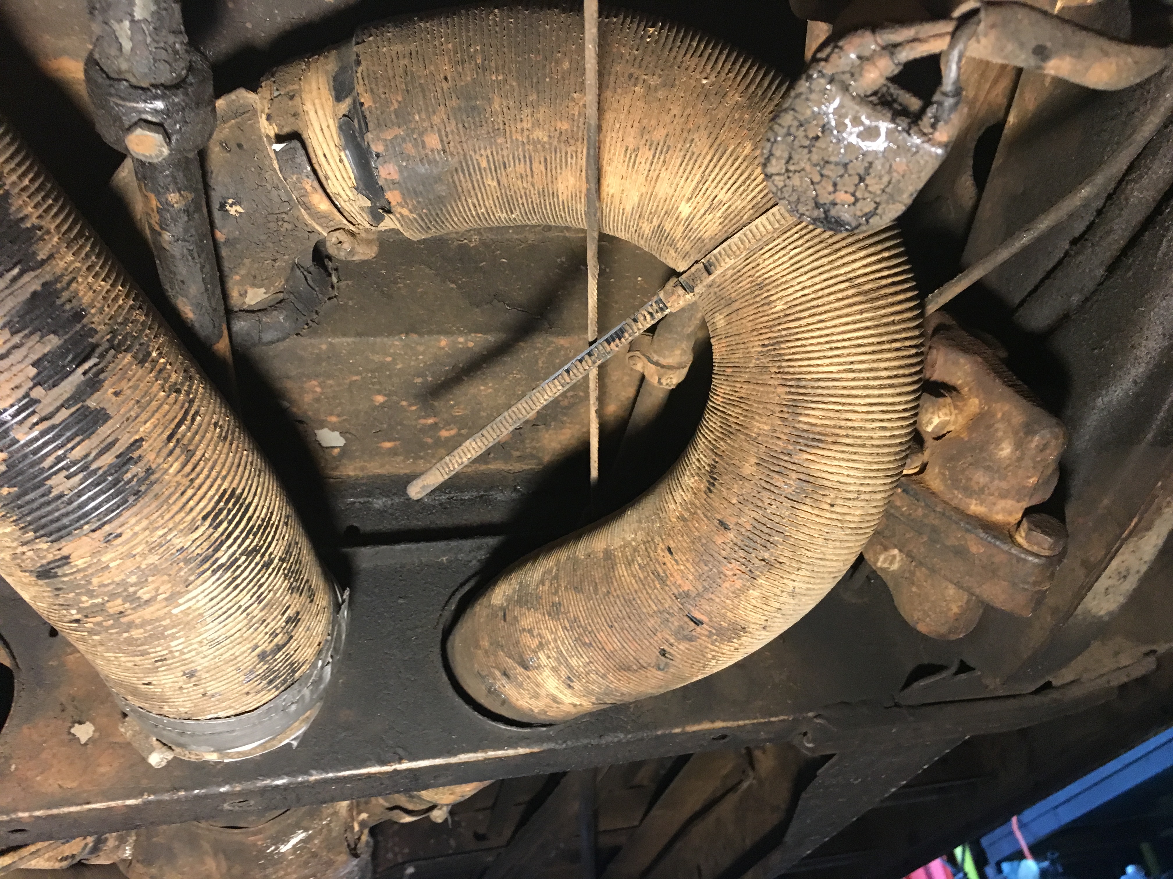

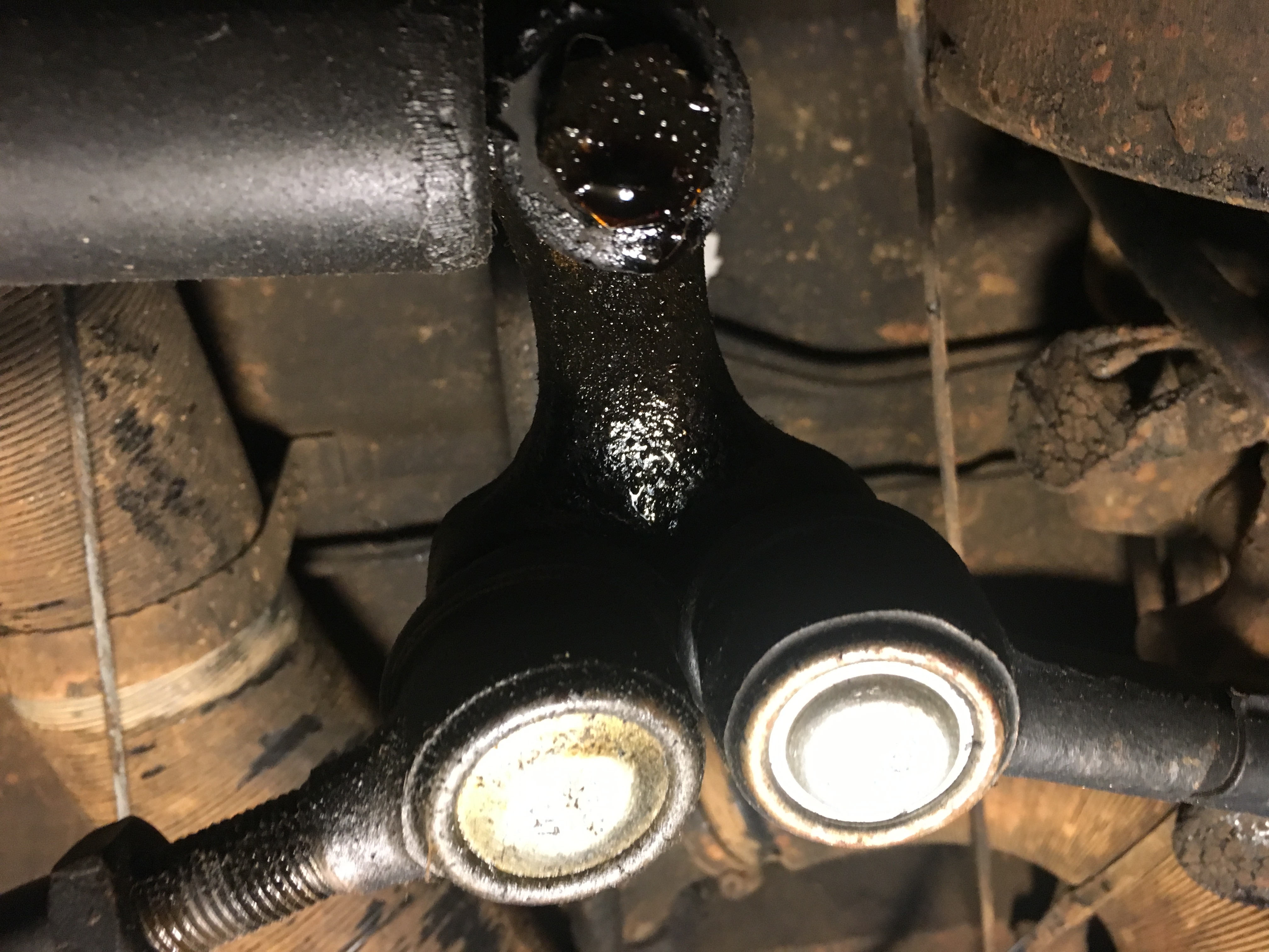

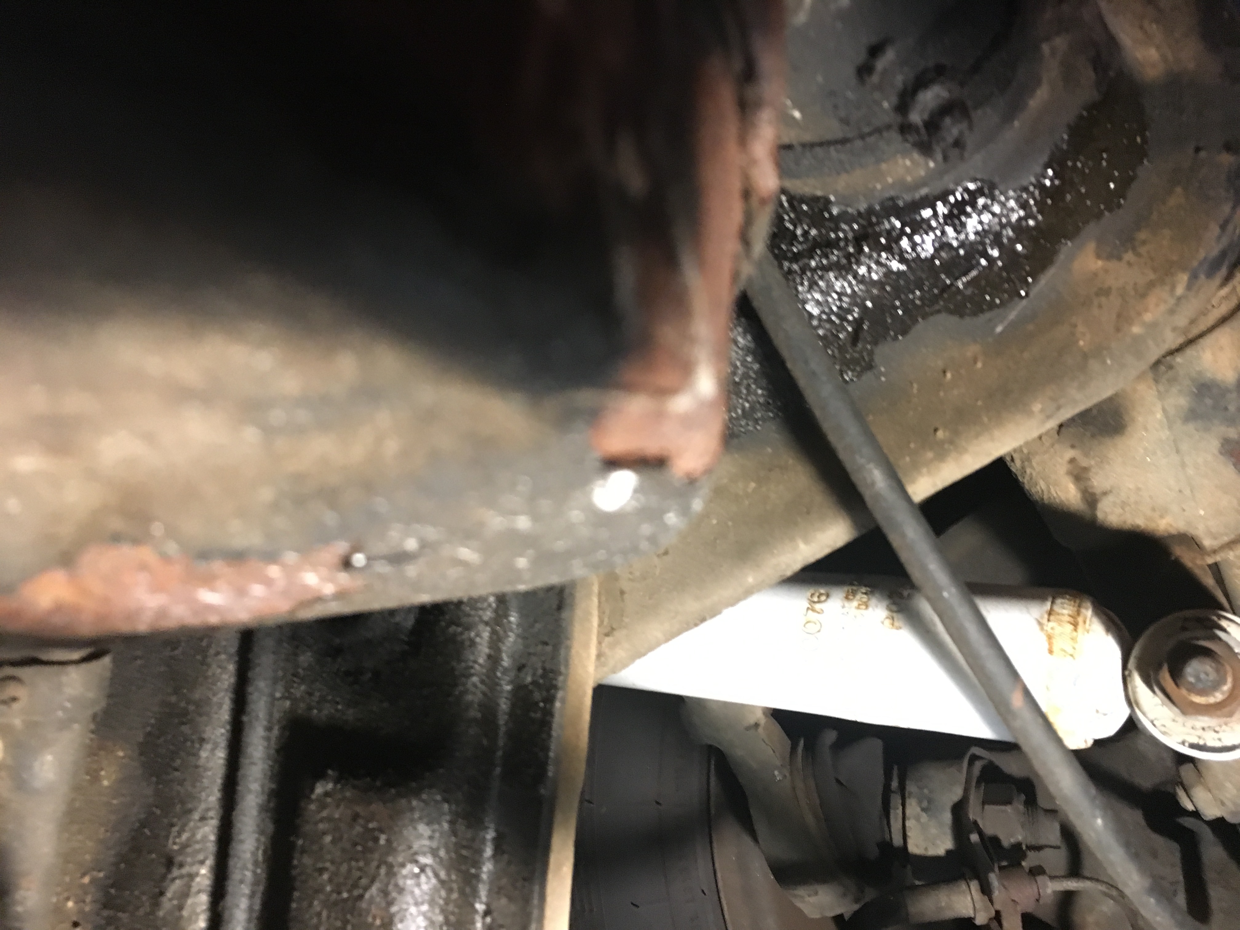

well I'm back. I ventured underneath. I took the pan off but I can't find the brake light switch. I see two black things with wires connected to them but they weren't underneath the pan and they are pretty corroded. They have what I would describe as caps on them so I can't see how the wires are connected. I was a little hesitant to go poking and prodding. I did take a bunch of photos of underneath. I'm not an expert but I think I can safely safe there is definitely some work to be done here. Thoughts?
I have the bentley, just didn't know what I had. Thanks
