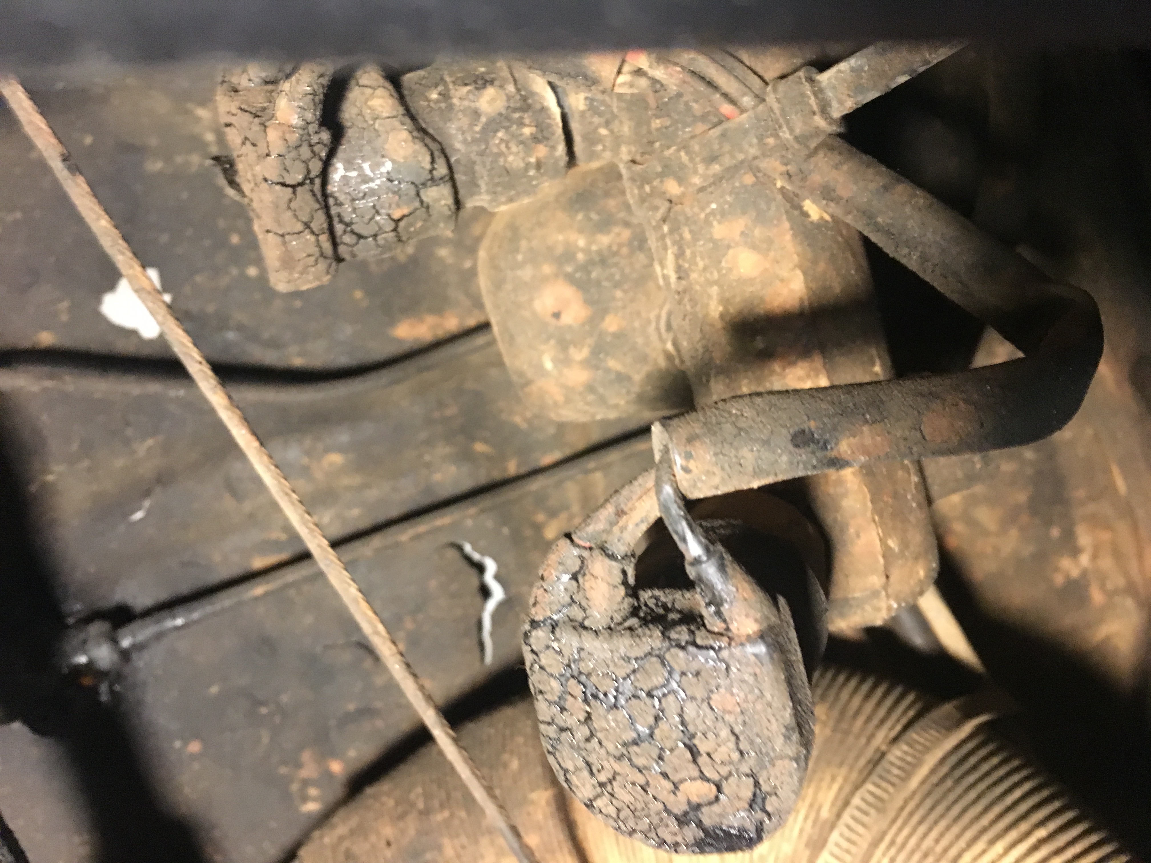

well I'm back. I ventured underneath. I took the pan off but I can't find the brake light switch. I see two black things with wires connected to them but they weren't underneath the pan and they are pretty corroded. They have what I would describe as caps on them so I can't see how the wires are connected. I was a little hesitant to go poking and prodding. I did take a bunch of photos of underneath. I'm not an expert but I think I can safely safe there is definitely some work to be done here. Thoughts?
I have the bentley, just didn't know what I had. Thanks

Get this book too Image
FI replacement means putting the original parts of the fuel injection system back on. The carbs work but if you are not used to working on them they can be a pain, it will also make cold weather drivability an issue without chokes.
