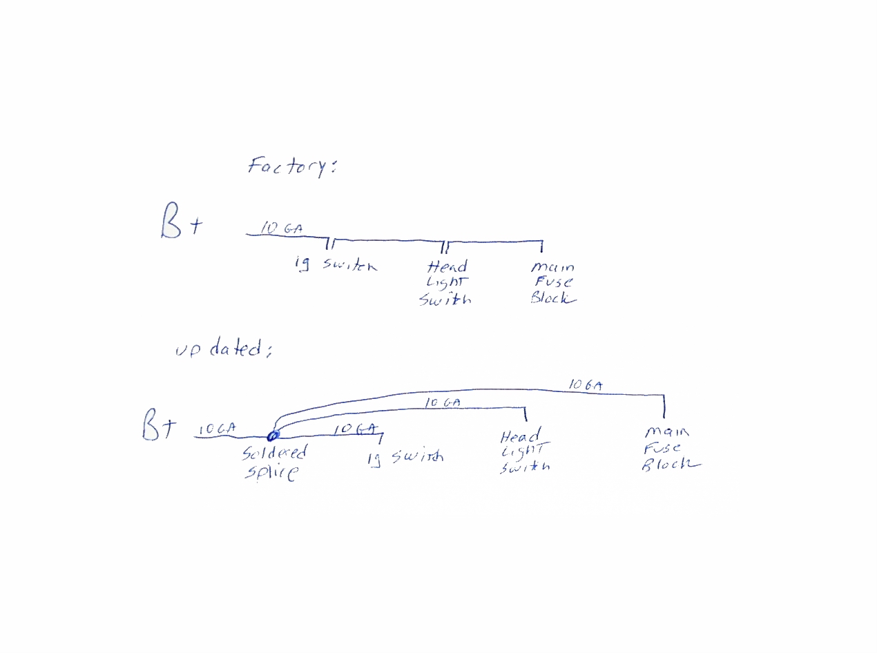

The way these are wired from the factory has the power feed from the battery coming to the dashboard, then piggybacked off the ignition switch to the headlight switch, then piggybacked from that to the fuseblock. This created multiple points for bad connections. My update for this is to make a 4 way solder joint where the 10ga input splits off into 3 10ga outputs, each feeding a component. Obviously this eliminated several potential spots for problems. It's covered with shrink tubing and Polyloom for double protection.

I didn't use the bulb on the left which was mostly done. Here's the final product: The big solder splice is on the left above the ignition switch. Everything is labeled, ty-wrapped or secured and covered with Polyloom. The auxiliary fuseblock on the left came from Columbus last week and makes the job look a little more "period correct" than a replacement blade-style fuseblock. I made a bunch of notes and modified schematics for Sean to put in his big book so the next guy knows what I did. Even without it it's not hard to figure out what changes were made.

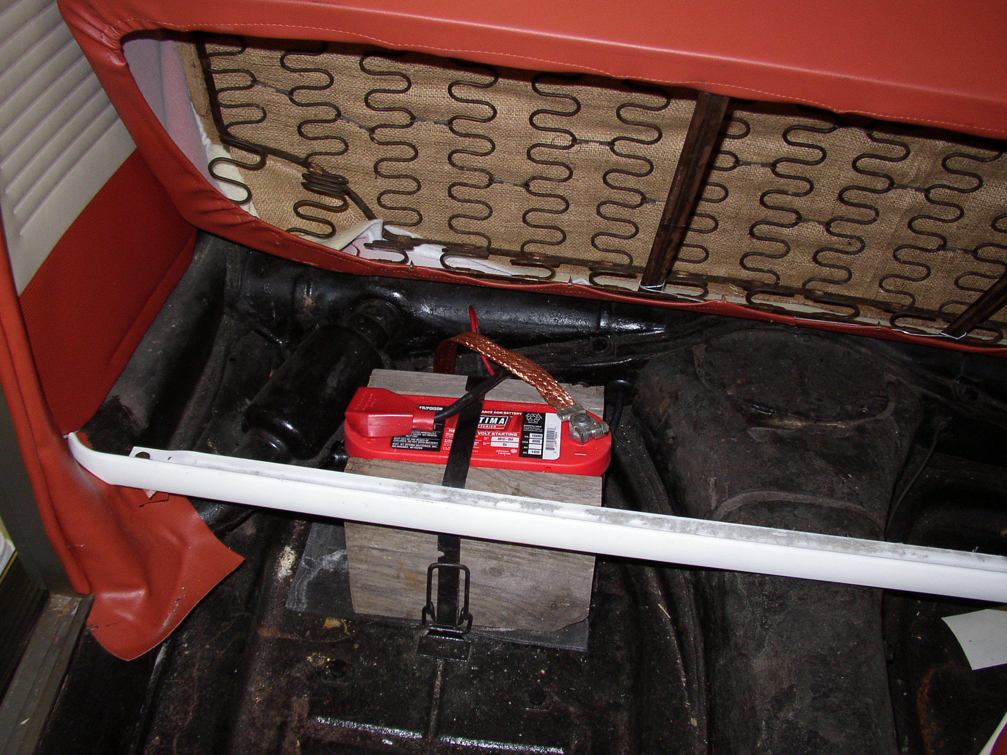

I put a big Maxifuse in the fat power lead that feeds the dashboard. All mfr's do this for the last 30-40 years but VW did not. It prevents burning of the harness if something major goes wrong up front. Then I went to set the rear seat and saw the positive terminal would have been a little too friendly with the seat strap so I flipped the battery around. How do you like those blocks of wood? Pretty hillbilly, eh?
