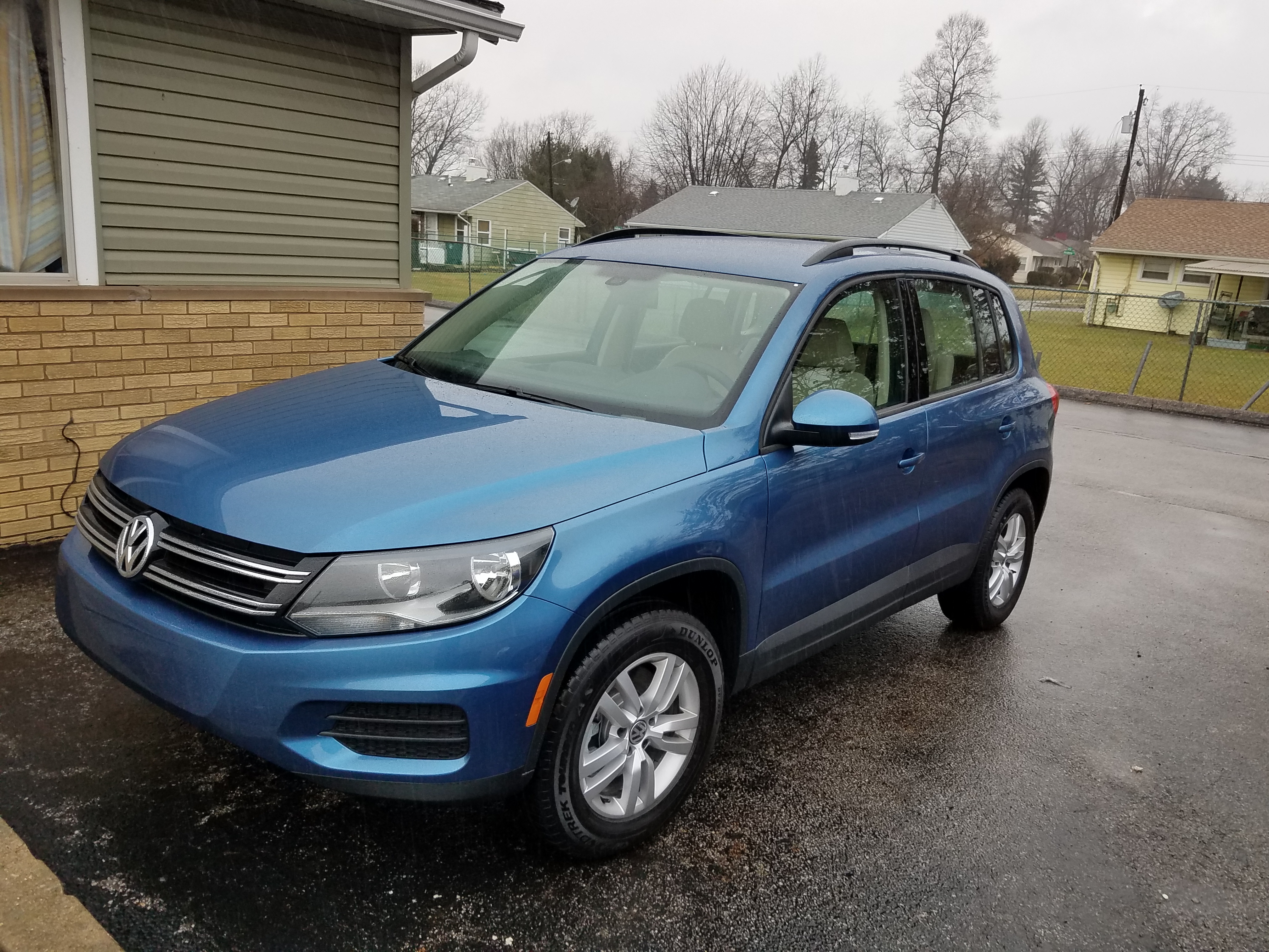

Since I'll be getting rid of the Jetta soon, and my girlfriends parents are in desperate need of a car, I surprised her at work yesterday with her dream car, a 2017 Tiguana and we are giving her parents the Golf...
