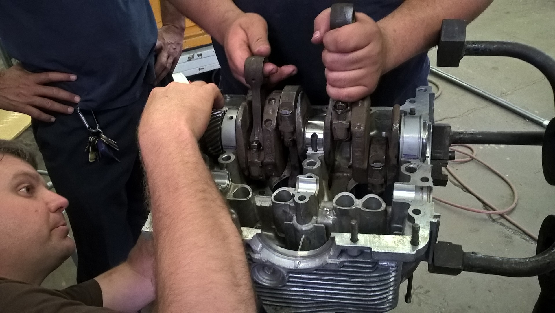

ready for crank shaft work
fitment sorcery
fitment sorcery
Chuck yelling at Rick for rods touching the case and at Mike for not having the cam gear assembled, I think.
