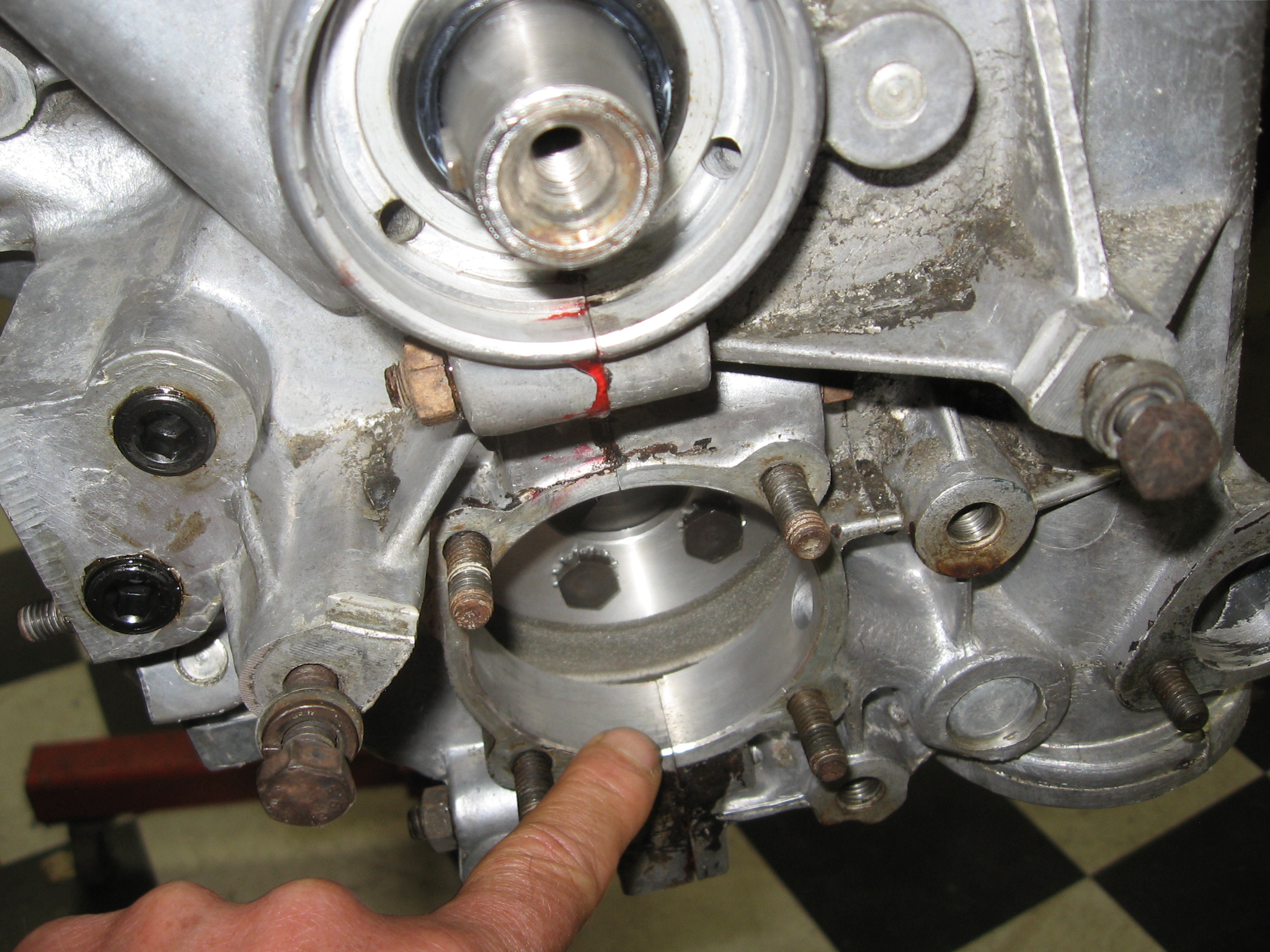

OK,here we go again. Now that we have the crank and case oil passages cleaned and the case,including the mating surfaces. It's time to build the crank assembly. Chuck stopped by one day last week and when I turned my back,they had the crank built up.
T 4 crank build is the same as T 1 whith 2 exceptions. No oil slinger on the end of the crank and the rods are symetrical ie,there is no up and down. We put the rods on with the numbers on the cap and rod up,for no particular reason.
Bruce's crank build shows the pics That I missed.http://www.leakoil.net/forum/viewtopic.php?f=23&t=4227
We did set the crank bearings in the case halves and seated them on the dowels,then marked the center line. This makes it much easier to position the bearings when setting the crank in the case half and considerably lessens the chance of missing the dowel and ruining a bearing. This was done on all 3 main bearings that install on the crank.
Plugs installed where we tapped the main oil galleys
Center main bearings installed in both case halves,along with oil pick up with new o ring from gasket set.
Crank installed in left case half and ready to install cam bearings.
Rotate the crank assembly several times to make sure there are no clearance problems.
Now it's time to install the cam,aligning the timing marks.
This is where we ran into a small problem. The cam would not set down in the bearing at the gear end. This is why.
The outer diameter of the thrust bearing was about 1mm too wide,not allowing the cam to set down.
This was a Kolbenschmidt (Brazil) bearing. I had a German set in my stash,so,we could continue.
Like Art Brow used to say "I know it's a new part,but is it any good?" DON'T ASSUME THAT ANY PART IS CORRECT
With that issued solved,the cam setting like it should,and timing marks aligned,rotate the assembly several times to make sure every thing clears and there is no binding and the timing marks still line up. Now is a good time to install the distributor drive at TDC for #1 and hold it in with the distributor. Makes it easier to know where you are at as you continue with the build. Rotate a few more times.
Now install the oil pump (test fit) to check clearance.
Since we re used the cam gear and bolts from the cam that was in the motor on the new cam,we were fairly certain that there would be no problem. It is close,but no clearance issue.
Just a note here. ALL replacement cams come with bolt on gears. Most all replacement oil pumps will have clearance issues with the cam bolts and the pump. Note the low profile heads on the cam bolts. If you do not check this clearance,THIS WILL HAPPEN.
Now we are ready to stick the case halves together in the next installment ;)

Now that we know that we can rotate the innards with no binding,we can go about sticking the 2 cse haves together.
I have used several different sealers for this and they all work. I have used Locktite 518 the last several times and so does Chuck.
a thin bead,then smear it with your finger.
Don't forget the cam plug. concave side faces the cam on all engines except T1 auto stick. we used permatex 3H around the outside of the cam plug.
Set the right case half over the studs.
There are 20 case bolts on the T4 motor along with washers.Three of them are easy to overlook.1 at the bottom front in the bell housing area,1 in the deep recess on the bottom,this is the 71mm one that holds the oil pick up,and one below the oil cooler in the left case half. the 6 main ones around the crank get torqued first ,from the center out.
It is best to give the engine a few revolutions at this time,to make sure there is no binding. Then the rest of the case hardware on the outer sides of the case. Wipe any excess sealer from the crank seal holes on both ends of the case. Also around the sump cover area and the oil pump area.
Before we install the flywheel seal,it's time to check the end play.
spec is .003-.005 We were at .005. Good to go.
a few more rotations,everything is looking good.
Install the front and rear crank seals. (T4 has one on the fan end also.)
Put a little lubricant around the inside of the seals,install the oil pump. Installing the flywheel now makes it easier to turn the engine over for the installation of the pistons.
