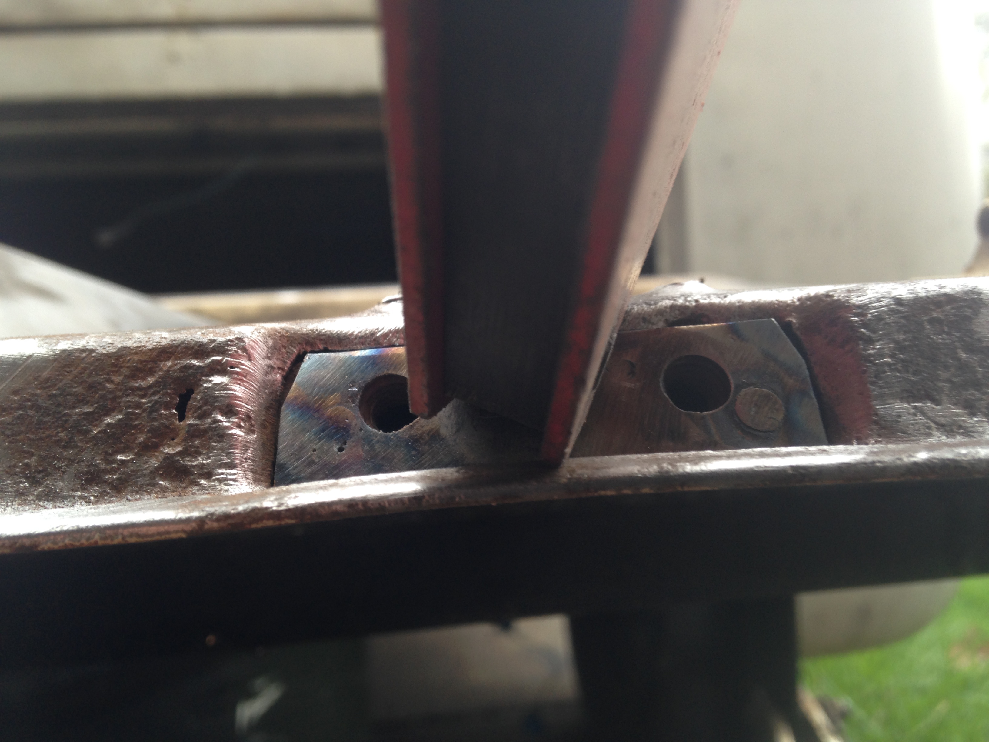

Still at it
1
Started with this piece of bent metal screwed to hinge
2
Missing piece of og metal
3
New piece of 22g sheet spotted to 18g spreader and nuts tacked
4
Welded in
Welded in
5
Some duraglass and it's a wrap
