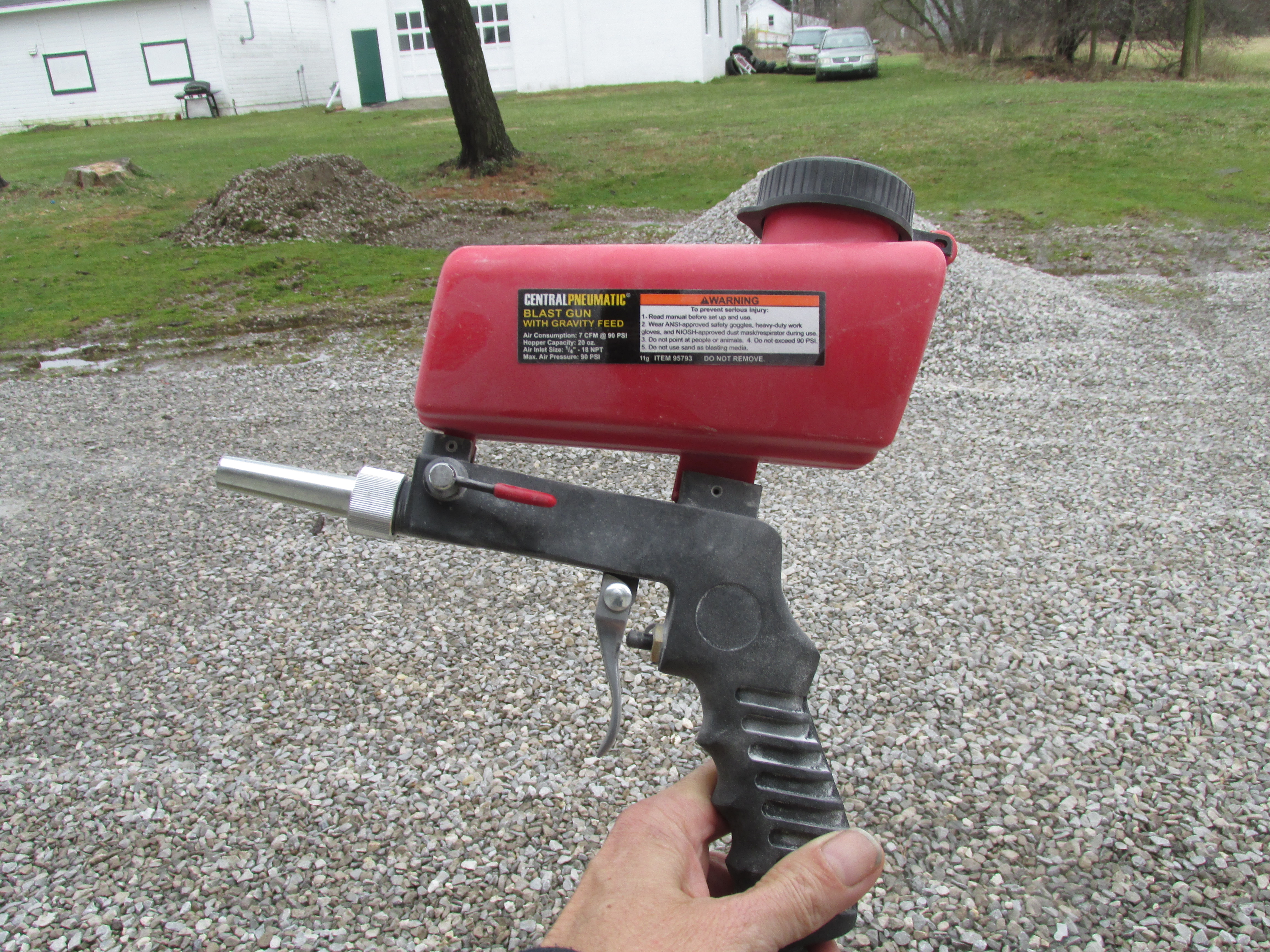

I stopped at a not so local H.F. and picked up a G.F.B. gun ,then I stopped at a little more local G.S. and picked up 6lbs of B.S. Took these items home and tried B.A.'s cleaning method on my pistons , T.B. and some nuts and bolts, werked very well, it took the carbon build up off the pistons like NOW. also tried on the fan shroud butt B.S. it is not a paint remover. butt it werks well on greasy fingers.
