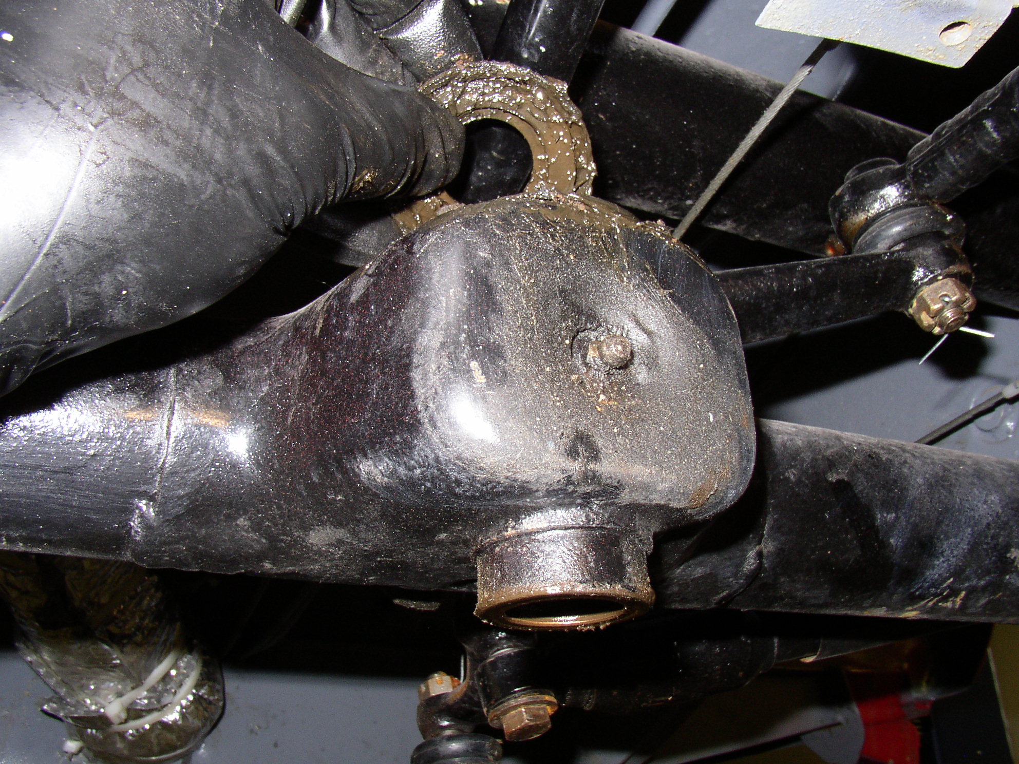

I "cheated" when I did the resto- the front end checked out as tight, so I cleaned it, painted it and figured I'd address any problems later. Well, later is here, and 3k miles proved the center pin to have a slight bit of slop in it along with one slightly sloppy tie rod end. Well, it's time to do the center pin. The Samba gang has a huge thread on this so I'll just post the details.

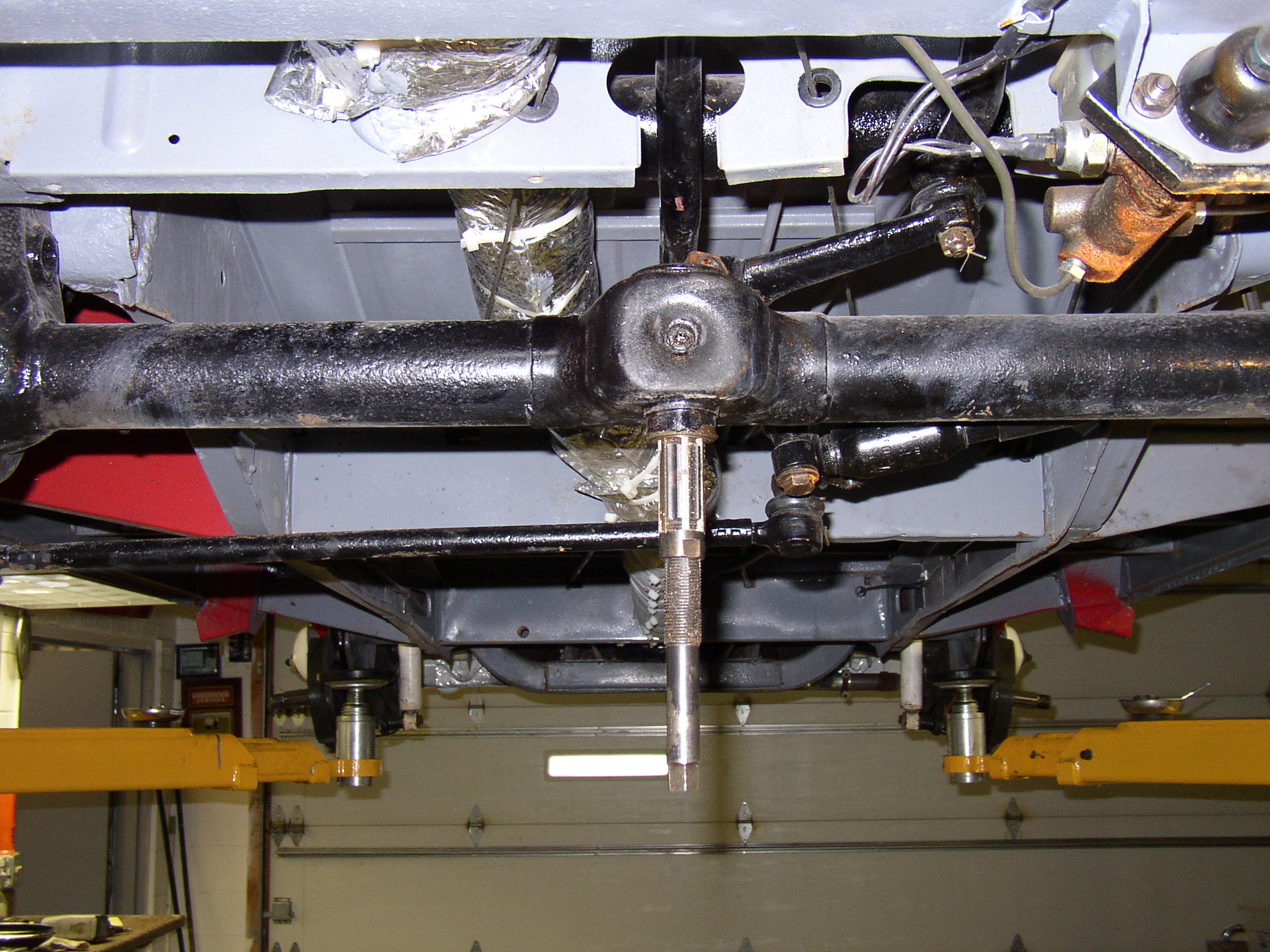

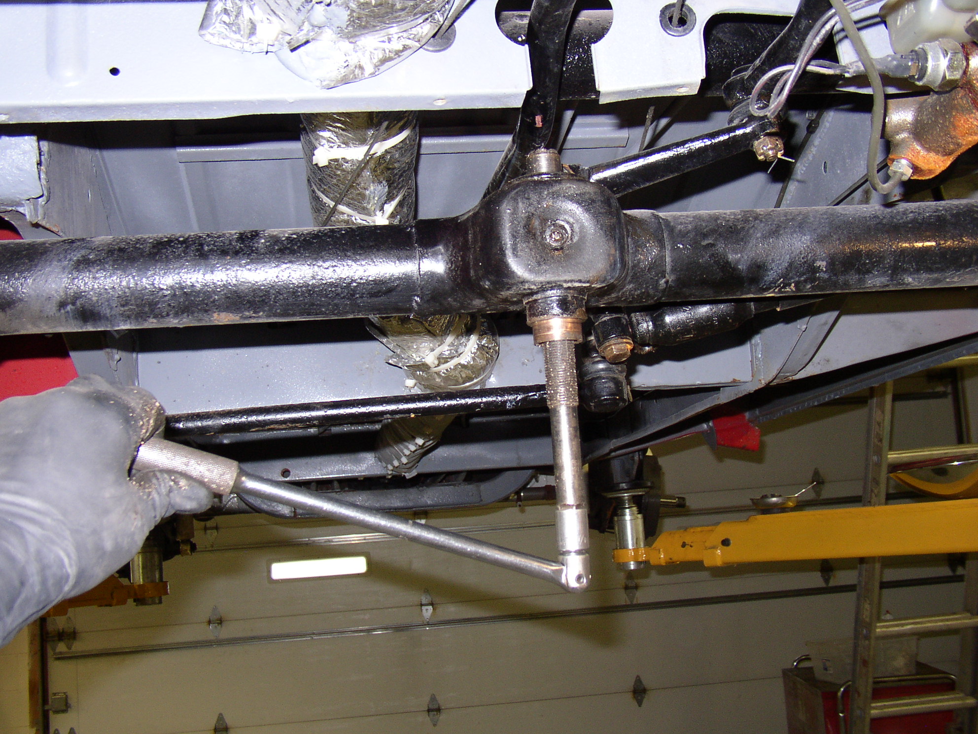

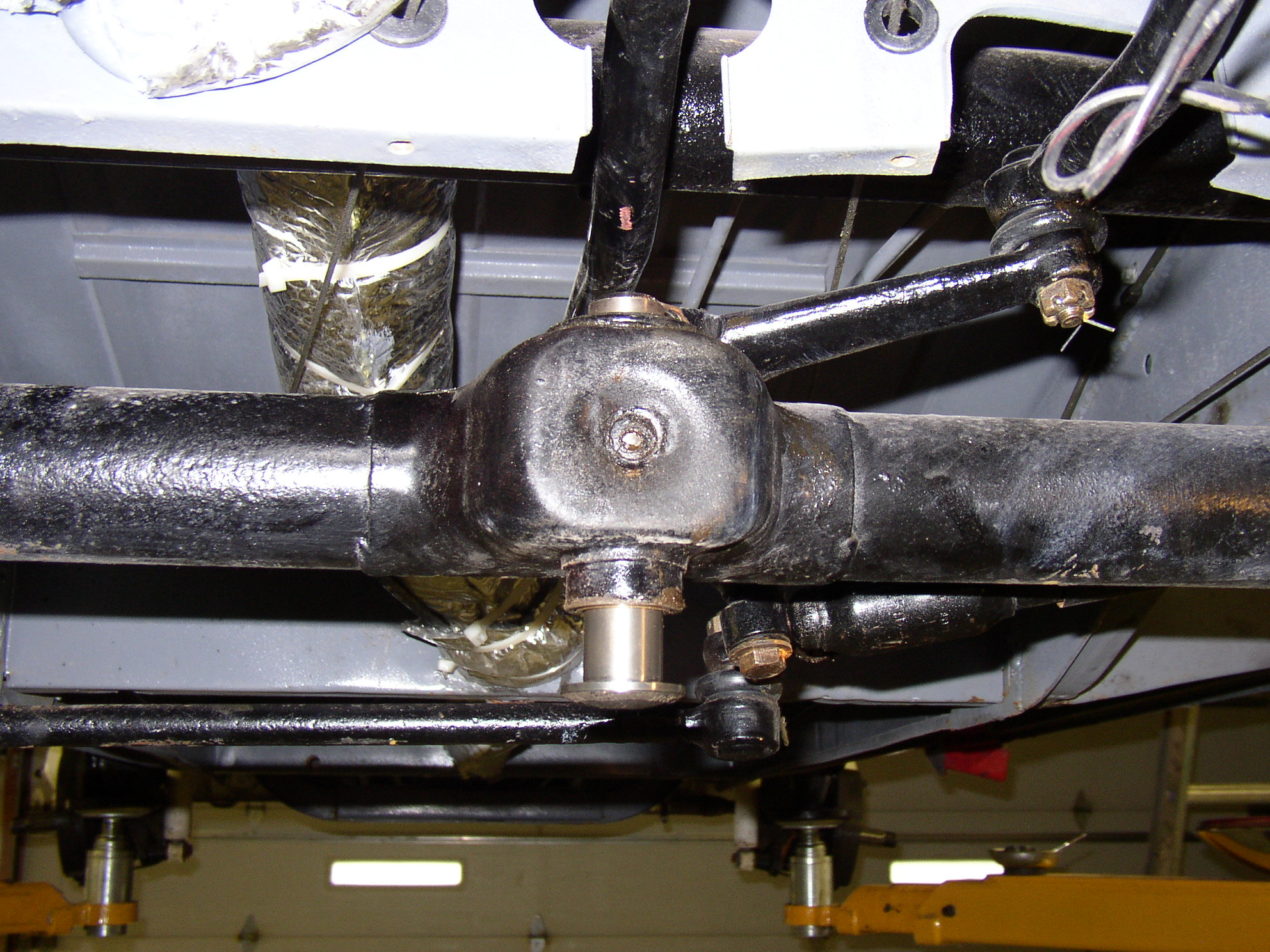

Undo the bolt lock, wrench the pinch bolt from the swing arm, remove it, and slide the arm off the top. Push it out of the way, tie rods and all, taking everything off of it is not needed. The shift tube is right overhead and looks like it will be in the way but it doesn't.

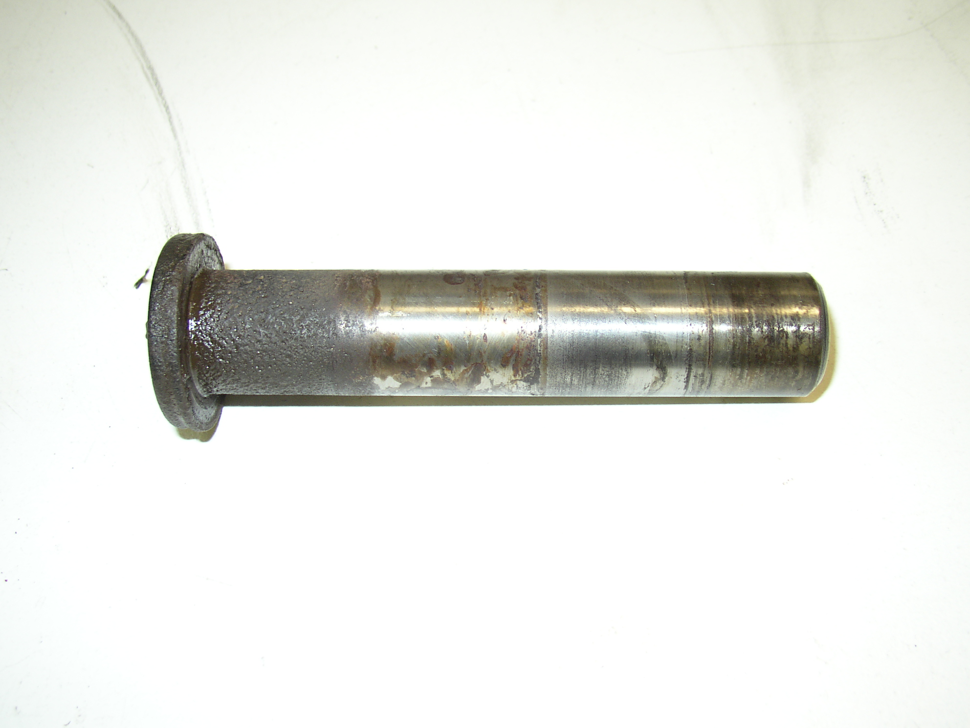

Slide that nasty ass pin out the bottom, mine came apart like greased whaleshit.
Pull the seal, washer, and wave washer from the top.
Definitely had moisture in there which rotted the surface of the pin where it rides in the lower bushing
Probably original with the VW logo, the bushings and everything looked like OEM and it had less than 30 thou wear. This adds to the thought that this is the original mileage on this bus and the odo hasn't been around once. The front end was tight and the brake drums had never been cut until I cut them, I really think it's original 89K. And, besides, the title says 89K so it must be original, right? :lol:

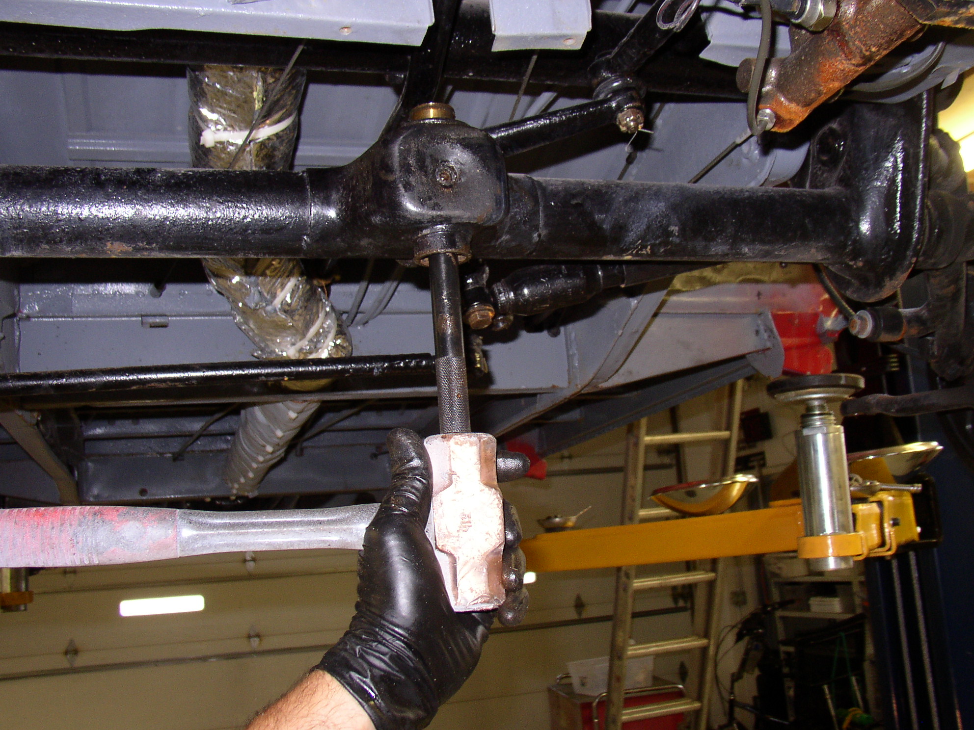

Pull the grease fitting out because it blocks the bushings, and knock the bushings out using my trusty HF bushing driver kit and HF brass hammer. :) I have lots of Snappy stuff but my DDs are HF.

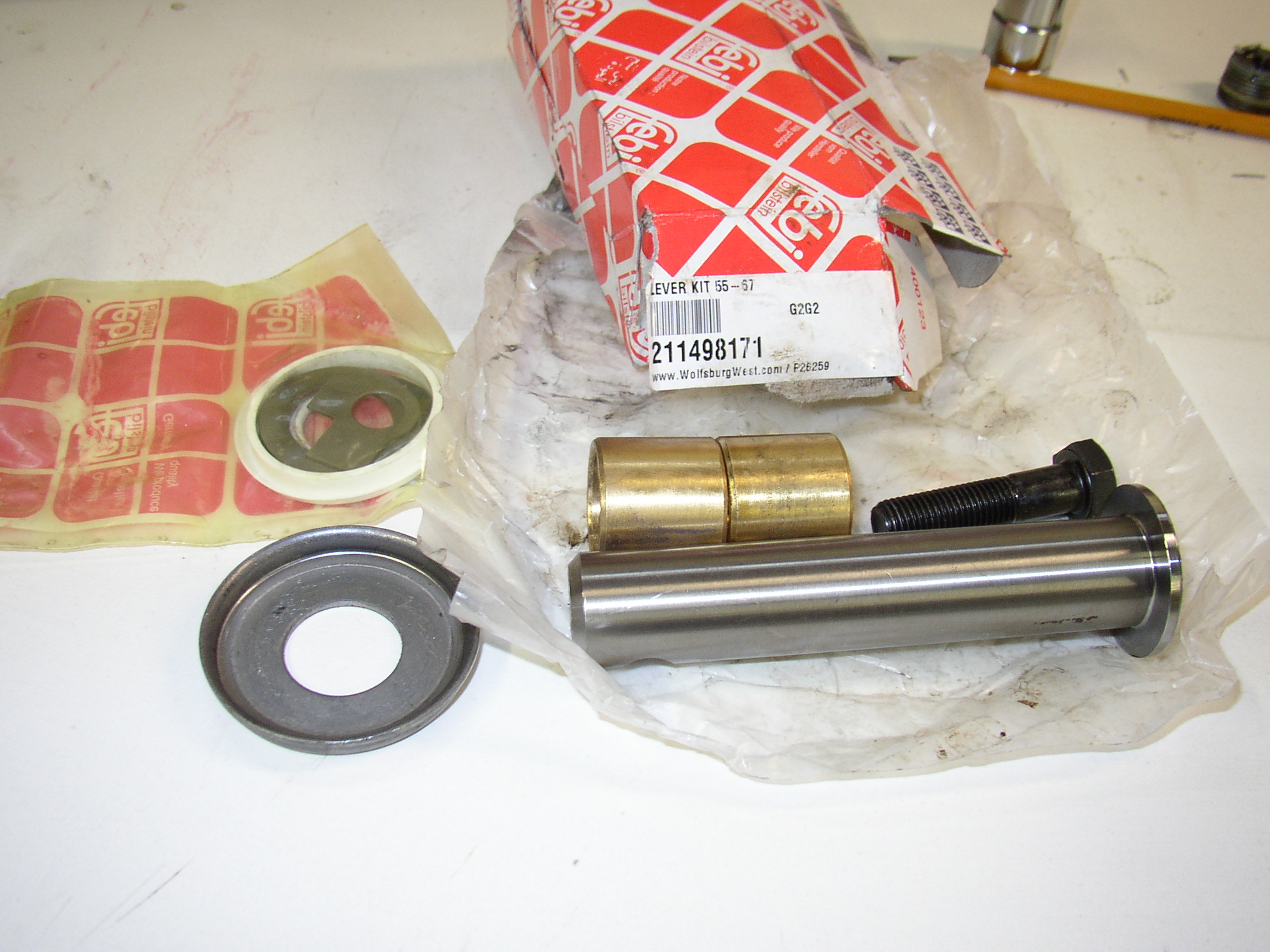

Get the WW kit that I ordered a while back when I saw the slop.

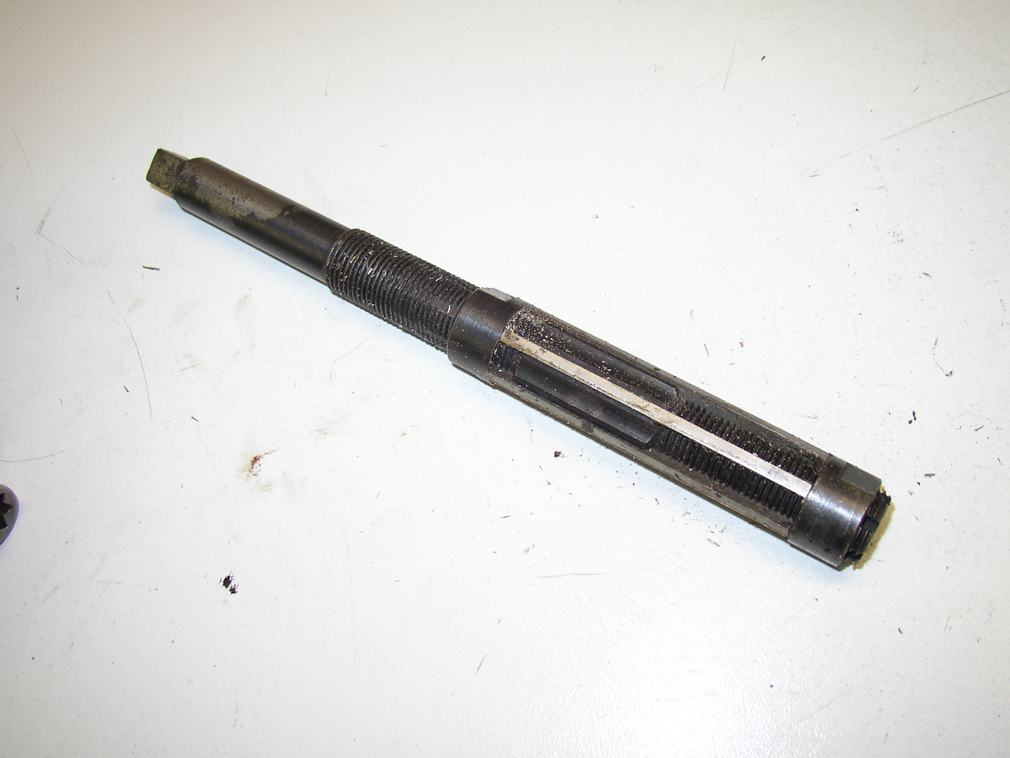

I have a set of adjustable reamers that go from about 3/8" to 1 1/16" inch. Luckily, 24mm is just under an inch.
I set an old bushing in place in the lower part of the tube to keep the reamer centered and gently/carefully reamed out the upper bushing until the new pin would just sneak through. Turning the upper and lower collars on the reamer moves the blades up and down angled ramps which makes the reamer larger or smaller in diameter.

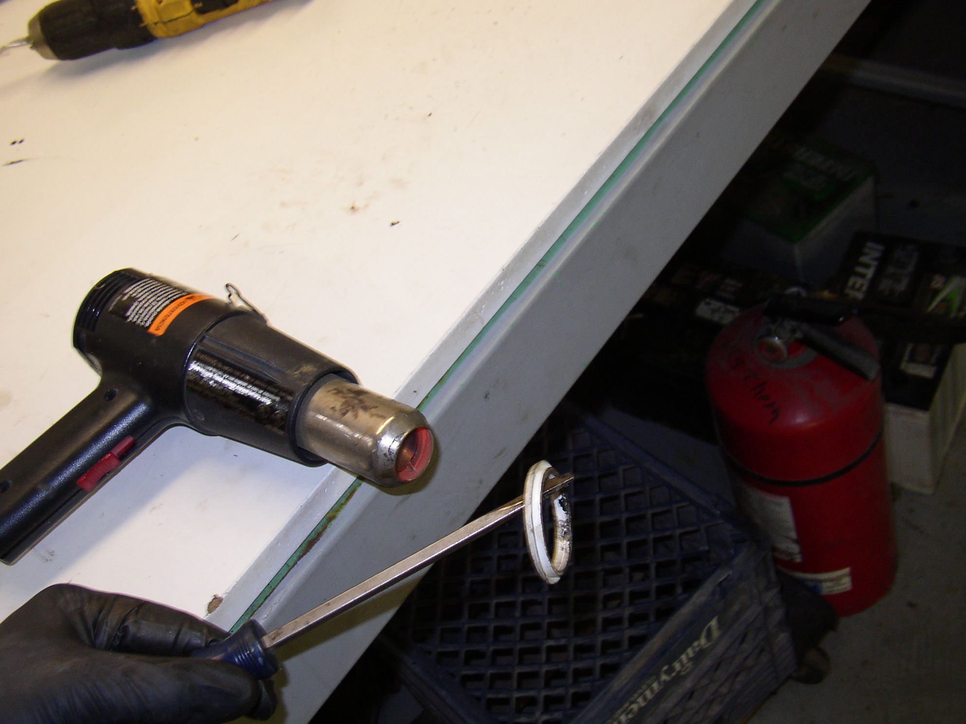

Heat the upper seal with a heat gun to soften it and
Stretch it over the tube.
Put the lower thrust washer on the pin and slide it into the bushings. Put the wave washer, o-ring, and steering lever into place. To align the groove on the pin to the steering arm I used a tapered punch. This works great not only to align the holes but also to compress the wave washer, which preloads the pin to prevent end play.
Now for the bolt- the Samba gang doesn't like the new bolt because the shank is shorter and I agree. I used the old bolt.
But if you pull the tapered punch out the arm pops up and closes the hole. No problem, a beat up C-clamp holds the wave washer compressed while I thread the bolt into place. Put the lock tab on the bolt and install it, mine threaded in the whole way by hand.
Torque to 50.
Put the fitting back in, grease it and the rest of the zerks. Yes, I did wipe them off.

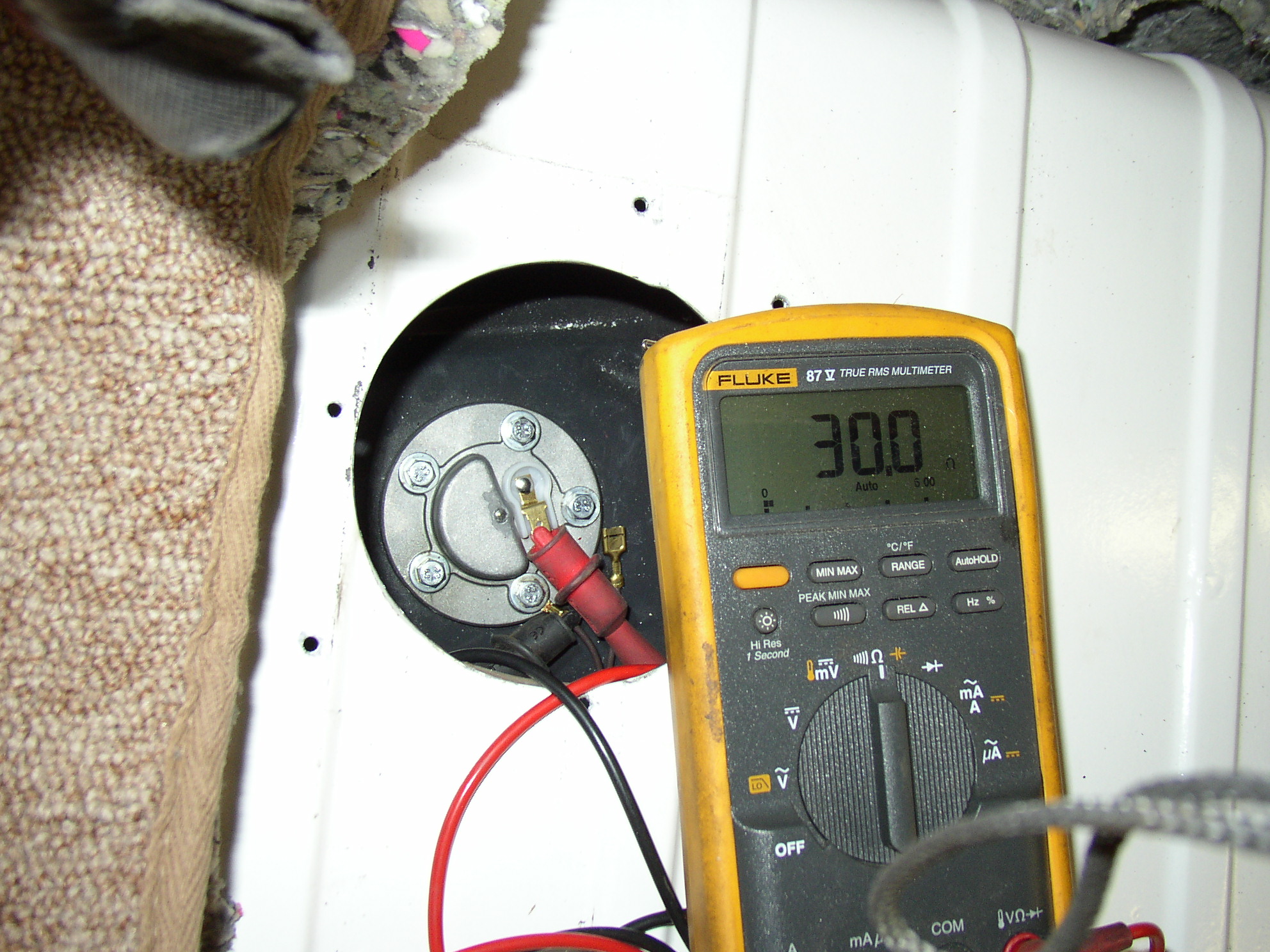

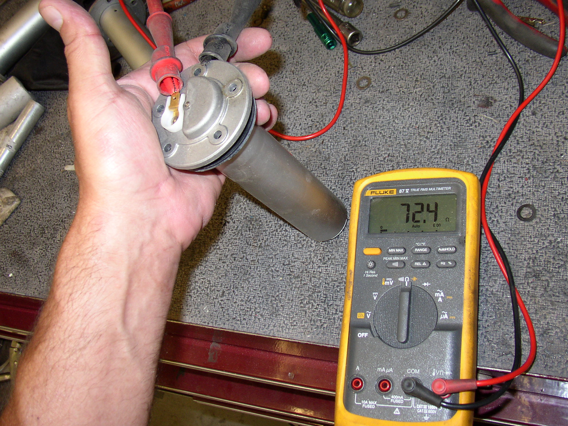

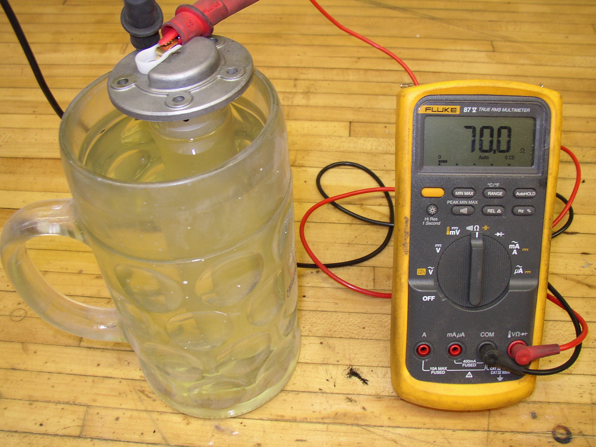

I know my sender is junk, but I thought I'd walk you through the diag process, this is a very simple circuit- nothing fancy at all. First, fill the tank. With the tank full, the sender should read only a few ohms, like under 5. Here it is reading 30 ohms with the tank full with the Chinese sender.

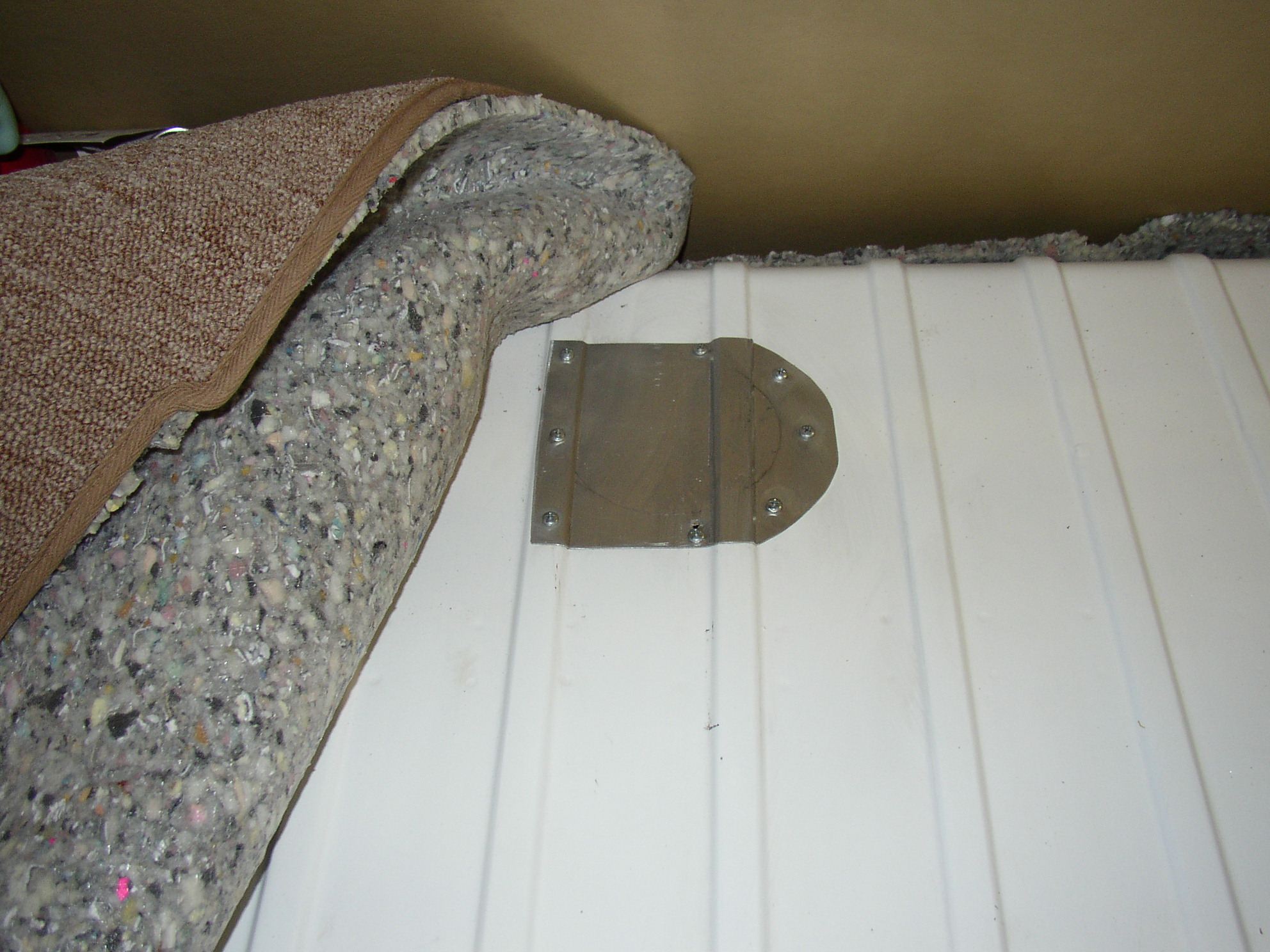

I guess I could have a ground loop, so better check it at the sender itself. Knowing this sender was likely going to be a repeat issue, I cut a BFH in the parcel tray and made a cover for it. :shock: Otherwise, it's out with the engine and the tank to replace the sender. Ugh!
Pull the cover and check the resistance. Duh, it's the same.

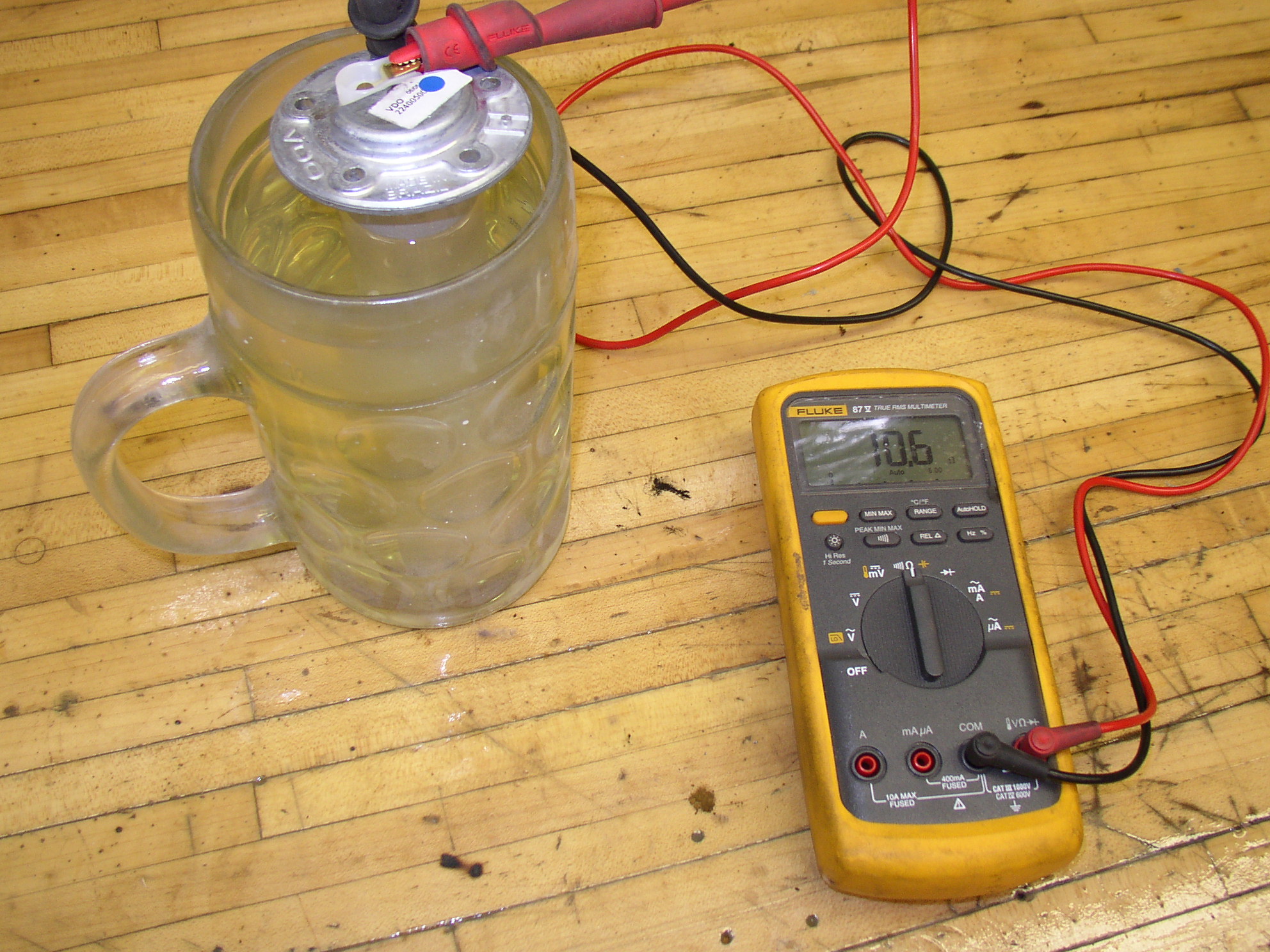

Pull the stupid thing out and verify it's junk (like I don't already know that). I'm not much of a beer drinker, so the beer stein sitting on my toolbox doesn't get used often. Here's a new use for it- fill it with gas and check the sender. The stein is full so the sender should read low. :roll:
If I test it using gravity, it works fine:

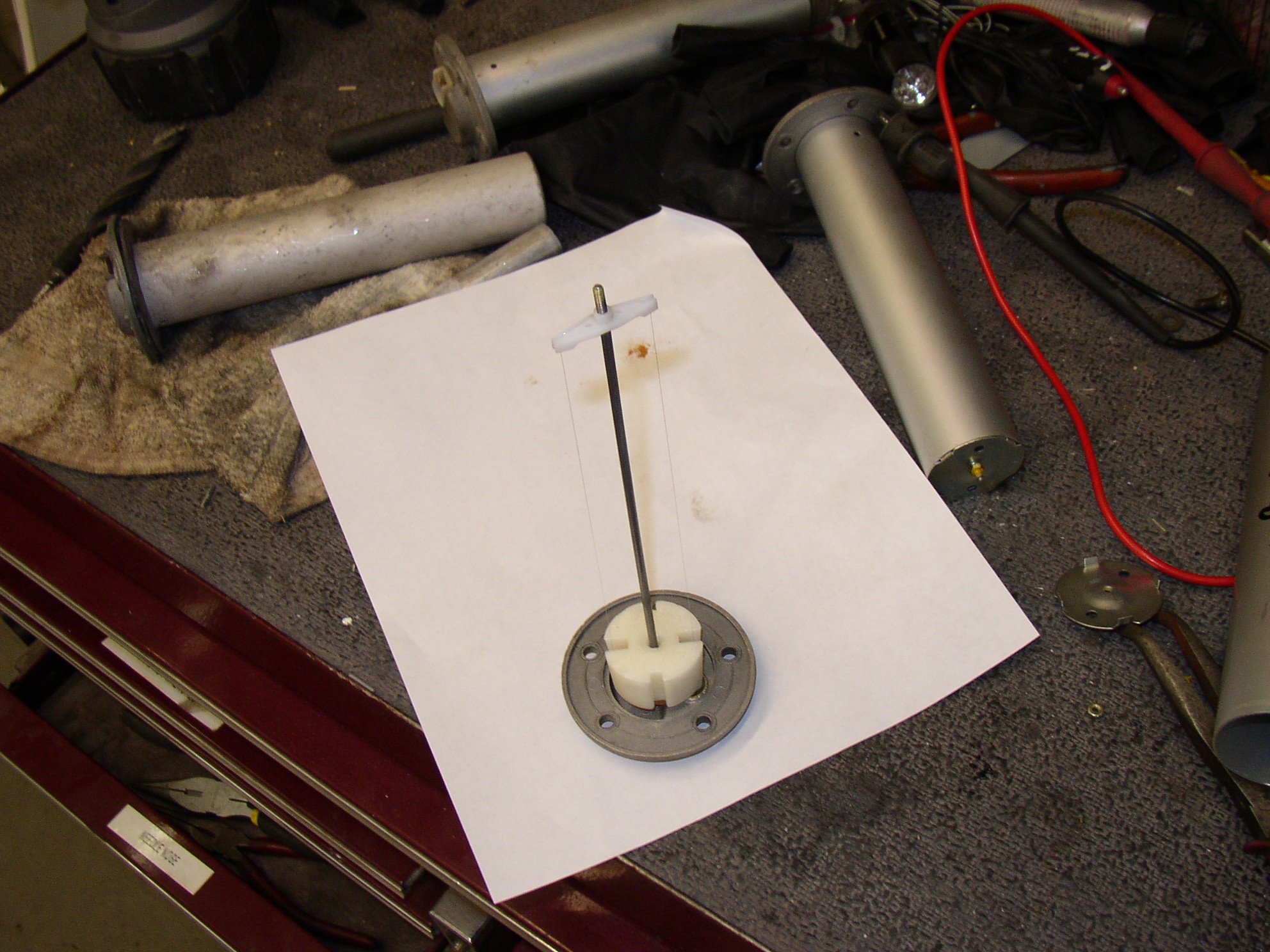

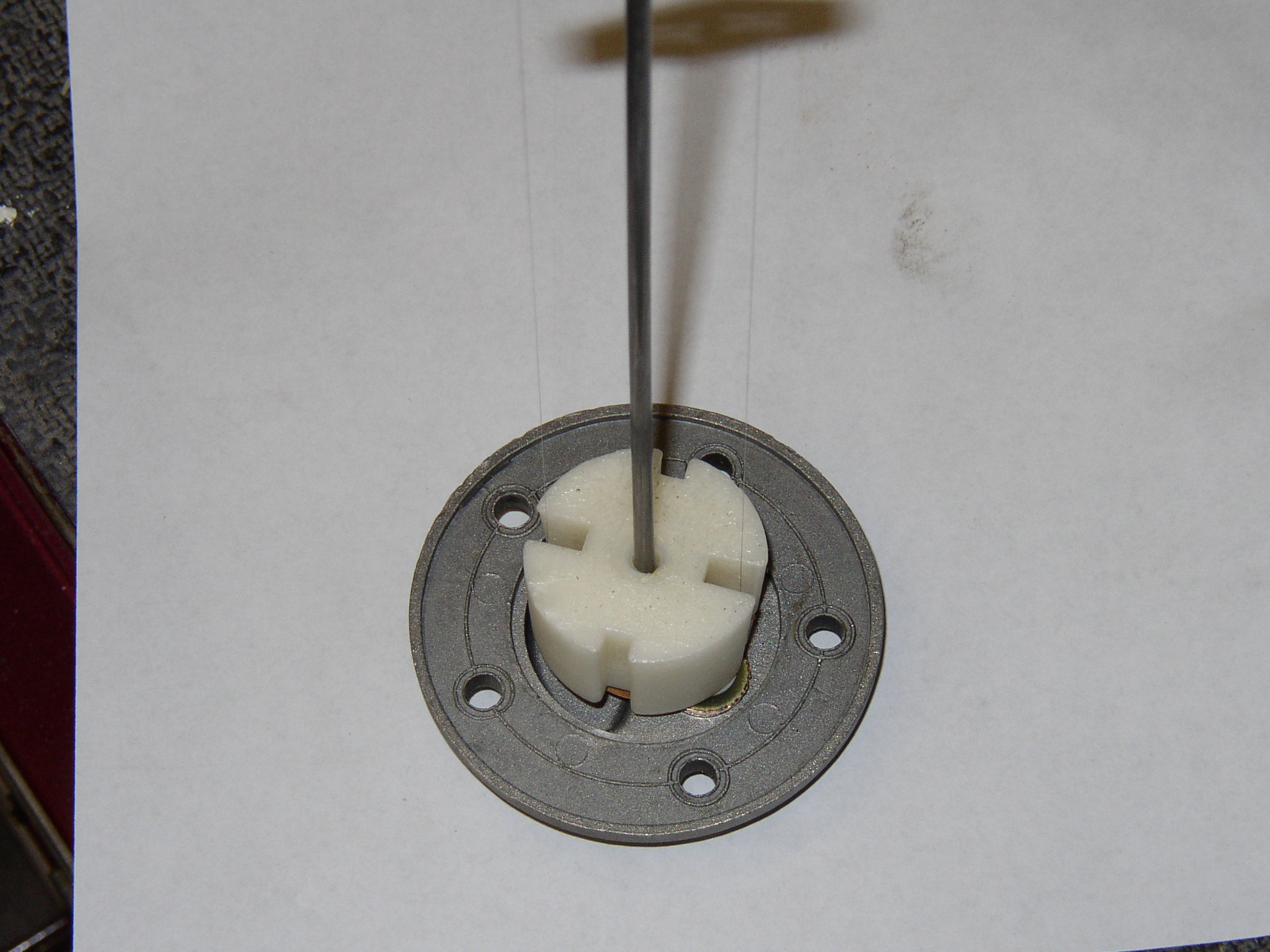

I took the tube off and had a look, there's nothing I can really do to help this. I've tried messing with these before and that stupid .003" wire is as delicate as it looks. I've broken several trying to fix them.
Now let's test the new VDO sender.
The fuel is not quite to the top of the glass here, it's reading 10.6 ohms.
The important thing is this- if I move the sender 1/4" in the fuel the ohmmeter immediately reacts.
I think my fuel gauge problems are behind me.
