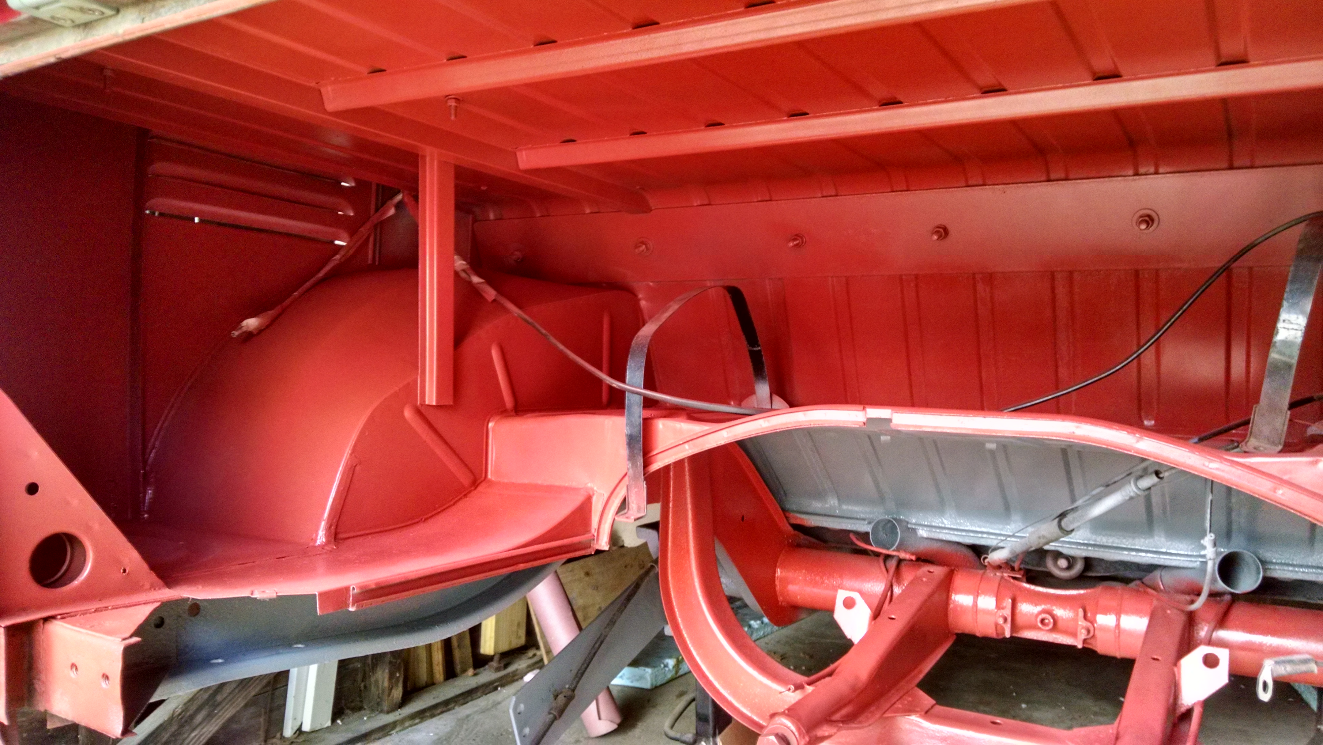

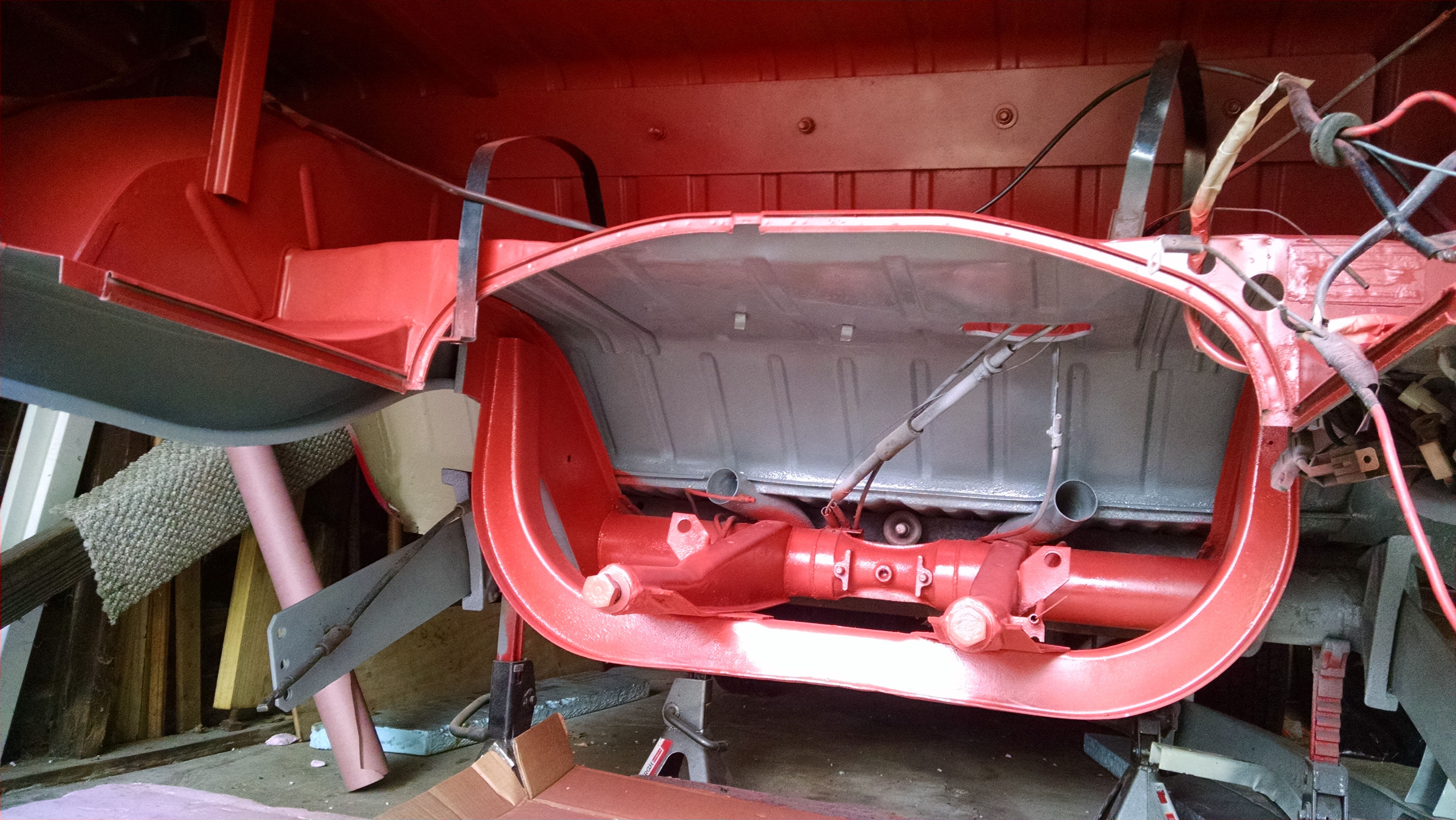

Almost done with cleaning and painting the underside of the rear and the engine compartment. Still need to put the finish on the wheel wells and hit some areas that are light. I have been collecting and buying parts as well. I think I have almost everything.
One step closer to reinstallation. :D
Nice work Marla looks great!

Very Nice!
What's that metal plate on the firewall? something Westfalia related?
Posts: 1789
A previous owner put that in to install seat belts. I took out the seat belts but left the plate and bolts. I didn't want holes.
