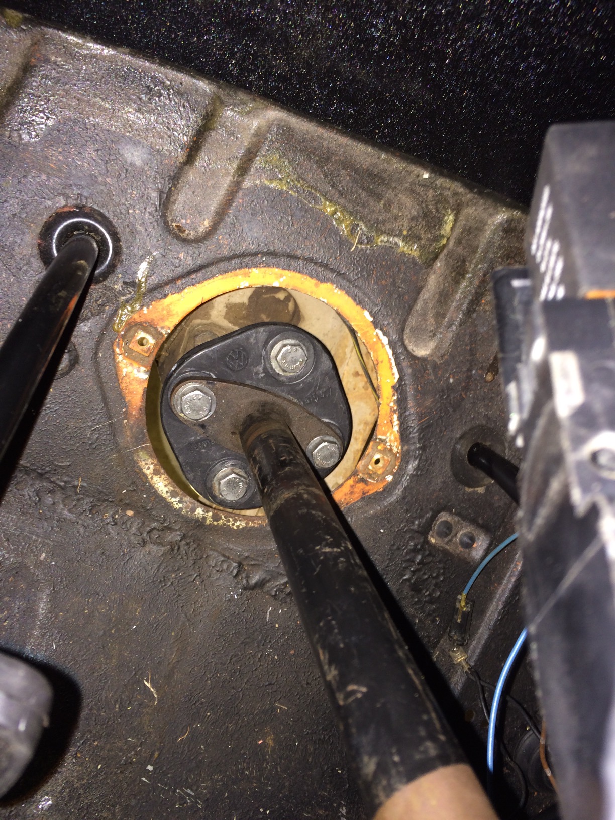

Replaced the steering coupler last night so I could mount the steering column and ignition housing. Ran new wire for the horn which had been missing. Finished hooking up the emergency brake and put in the new floor mat. Still a lot of wiring to do. Ignition, emergency flasher, turn signals (not hooked up in photo) and headlights all work. Cannot get the taillight or brake lights to work yet.

Should there be a ground jumper across the coupler?

Re: 1974 Double Cab Project
You mean for the horn? I ran it through the hole in the shaft and then through the hole in the coupler and its secured by the nut underneath. Was not sure how it was originally routed.
Rob wrote:You mean for the horn? I ran it through the hole in the shaft and then through the hole in the coupler and its secured by the nut underneath. Was not sure how it was originally routed.
There should be a short wire across the coupler. This grounds the upper shaft to the steering box/chassis. The horn might work, but not all the time because you are pulling ground through the steering bearings.
Thanks, for catching that before I attached the turn signal, wiper switch and steering wheel. The way I attached the ground wire isolates it to the bearing which is encased in rubber and a terrible ground (It all seemed so clear at midnight :( .) If I understand correctly the ground wire coming through the steering shaft should attach at the point where the steering box is attached to the coupler, this way it is grounded through to the chassis. The other ground wire runs from the horn to the domed plate at the base of the steering column which when your press the horn ring completes the circuit. Please correct me if I am wrong.
