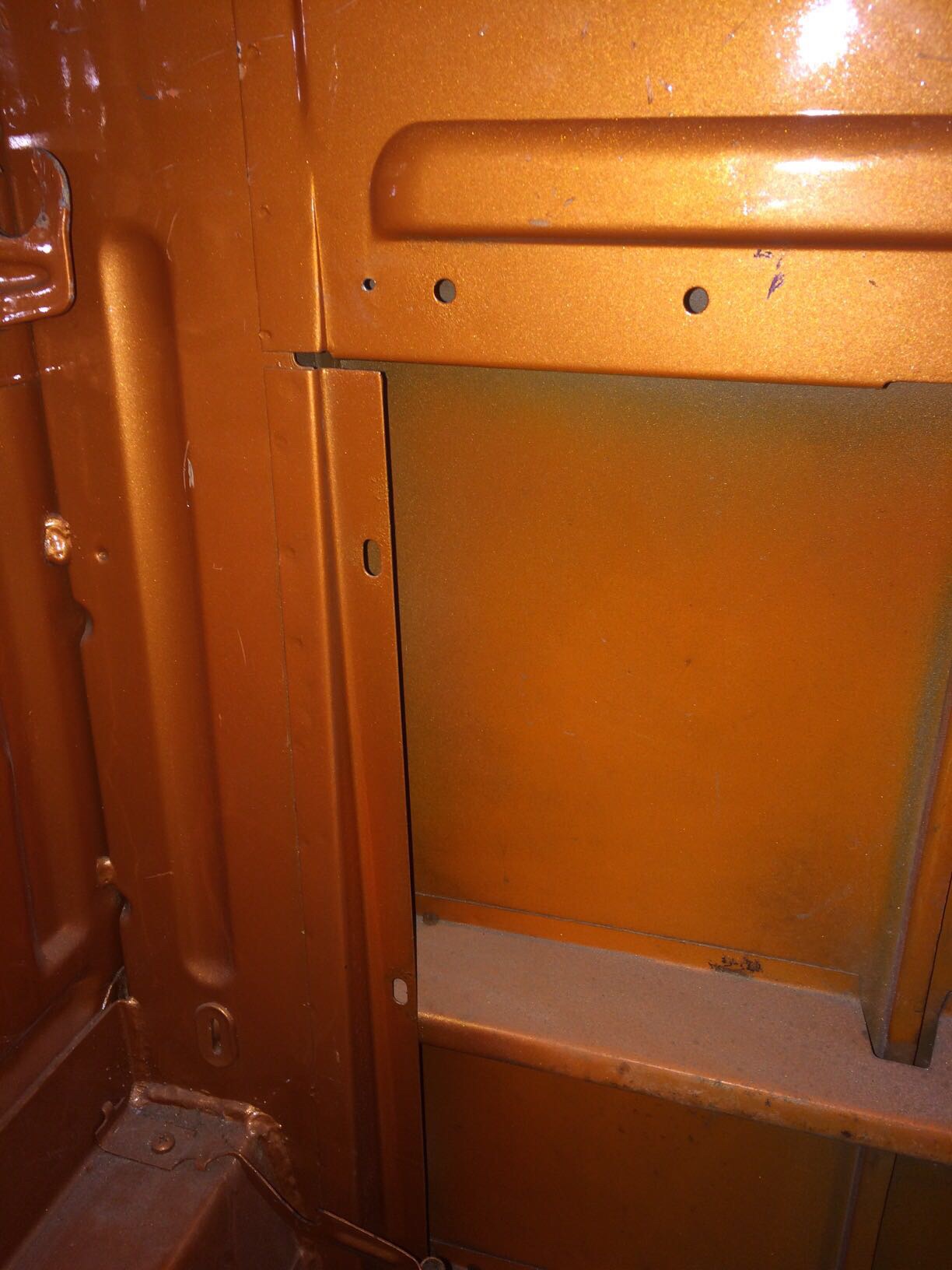

I do have a question. Does anyone know what if any special clips are needed to attach the rear panels. There are some round holes which appear to be the same as those in a door that accept a grommet etc... However there are oblong holes too where I would expect to see round ones. If they do require special clips do you know where I could get some?

This is the best photo of Chuck's DC. Looks like it used the chrome buttons like a Split to hold the rear panels in.
Re: 1973 Double Cab Project
I have been doing automotive upholstery for over 50 years. Have never seen a "clip" that fits into an oval hole, except on much newer vehicles. However, I have seen inserts,plugs like the ones pictured that accept a trim screw. I have seen these "oval" shaped,but don't have one to show. Try an automotive body shop supply store along with size of the hole. also search Auveco products.
Re: 1974 Double Cab Project
Thanks for the photo Ted and for the suggestions Bill. Did some research online and looked at a lot of photos. Seems that the majority of DC's after 71 are secured with fasteners that look like the ones that secure the rear hatch panel in a bus (chrome button head). However, there also appear to be some, mostly 68 to 70) that are secured with something not visible. I am guessing the panel kit I bought is for for the Early Bay American Model with a slightly fancier interior and my DC was originally fitted with a more spartan interior.

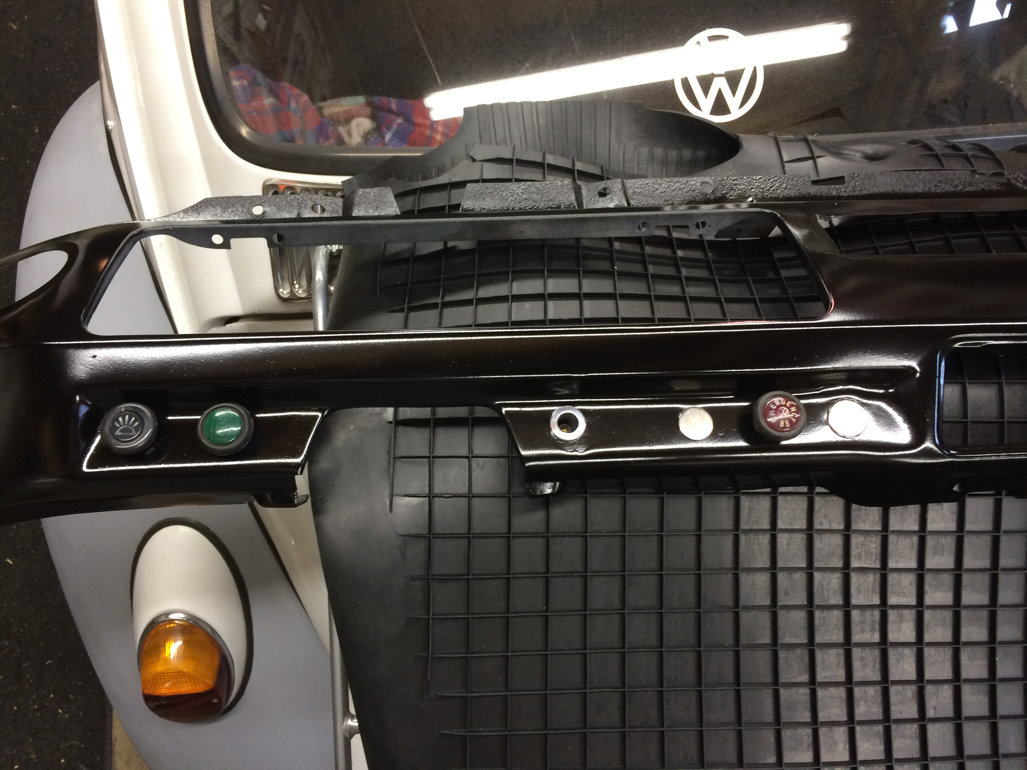

Took a break from the wiring to sort out all the holes in the dash. Being that I cannot weld I needed to figure out a way to make the holes look better. I stripped and primered the dash. Smoothed out the holes with a dremel. Mounted the Headlight Switch and the Emergency Flasher Switch in their stock locations (I think) and then added a power supply port from a Westfalia and a defroster switch I will use for fog lights (ordered a new bezel). Then I used some chrome hole plugs from the hardware store to fill the other holes. Painted the dash satin black. I think it looks pretty good.
