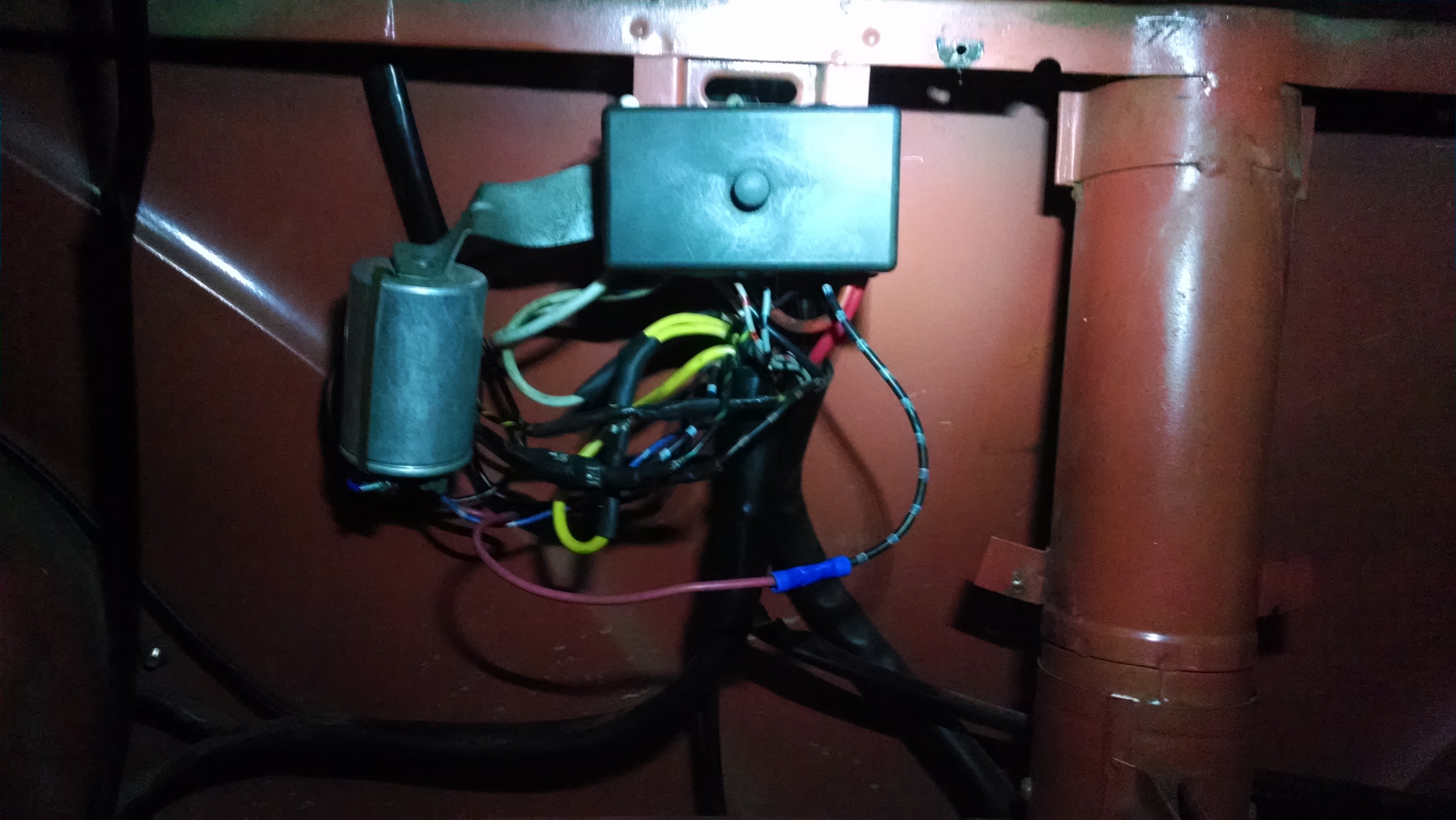

Mike came over and helped me out with some electrical work last weekend. We replaced the double fuse panel and flat fuses from the previous owner, with an original 6 fuse panel (according to owner's manual). We followed the wiring diagram and re-did all of the connections. I still have an issue with my right rear turn signal, nithing I can't trace down with some time. But, I now have brake lights that work the correct way! ;)
I learned a lot by doing this. Mike was a huge help - Thanks Mike!
Here are some before, during and after photos....
Before...
Before...
Without the cover
Without the cover
With the cover on
With the cover on
Did you pull your turn switch appart and check the solderd connections? I had a problom with one of my blinkers it was a wire in the switch the solder let loose and lost contact...
Posts: 1773
Thanks Ed. We did have the switch apart. It looked looked pretty good, but I am going to have to take another closer look. I will start with the light and work my way back to the panel and check all of the connections.
Someone told me that good connections and grounds are pretty important, especially in a 6 volt system. :?

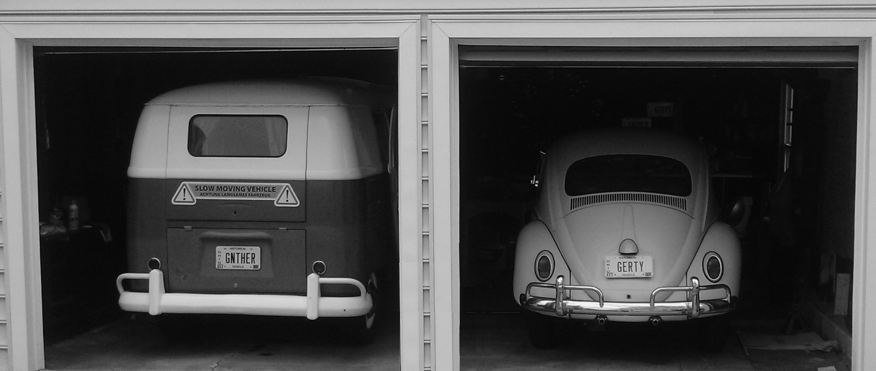

I took this photo over the weekend and thought I would share.
Together again....
Together again....
