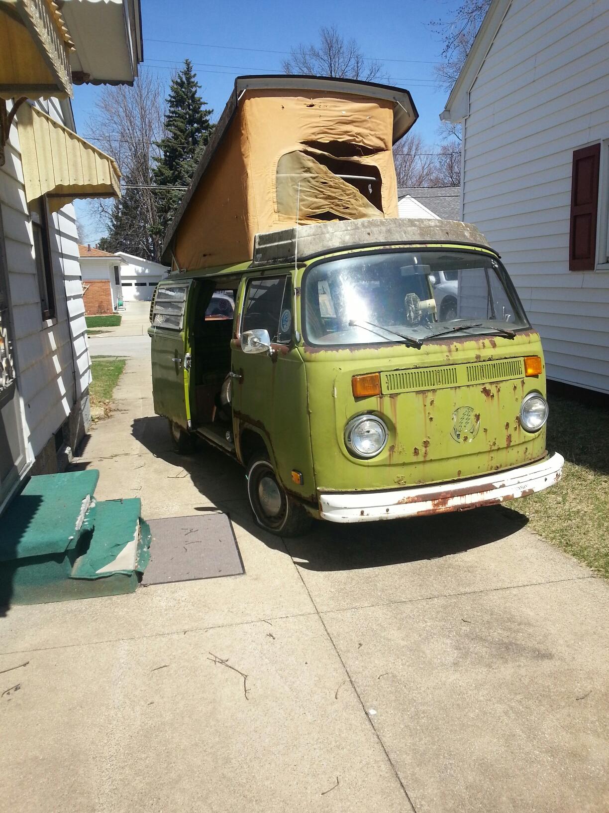

I am also ready to start selling / trading parts off of the doner Camper.
Let me know how we can help each other out.
Thanks
Eric
